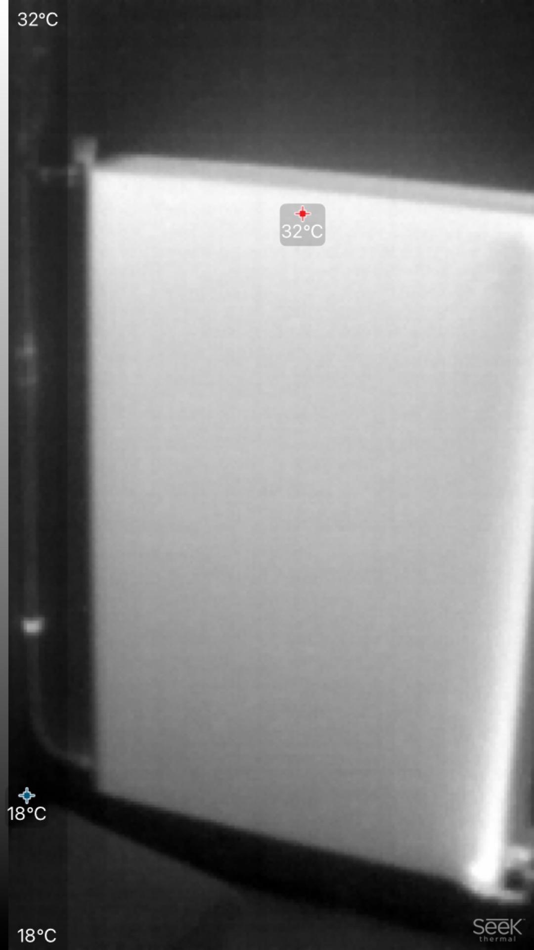

HughF Posted October 28, 2023 Author Share Posted October 28, 2023 I need to throttle the flow to get the delta-t across the rad up, so I need the lockshield on the outlet, don’t I? This is on a heat pump system, open loop, no buffer. My rads are running at a delta-t of about 1.5 and a thermal camera shows the flow is short-cutting between flow and return across the rad. Link to comment Share on other sites More sharing options...
HughF Posted October 28, 2023 Author Share Posted October 28, 2023 All the rads in the system are heating up, even ones further away, it’s just the flow through the rad is high. Downstairs rads have standard valves so I can throttle the flow on the outlet, but my engineering head says the upstairs ones need to be the right way round. Link to comment Share on other sites More sharing options...
markocosic Posted October 28, 2023 Share Posted October 28, 2023 If dT is too low *everywhere* dial back the pump before you throttle valves. If a radiator that's been piped backwards and has the return at the top then hot, buoyant, water, is always going to piss off down the return in preference to staying in the rad. Plumber needs to change that for the rads not to act as bypasses with the flow looking like an "r" shape. Link to comment Share on other sites More sharing options...

HughF Posted October 29, 2023 Author Share Posted October 29, 2023 The plumber is also my builder mate, who’s doing our extension/kitchen. I don’t really want to lump him with another job at the moment, nothing I can’t take care of (I do plumbing anyway)…. I’ve identified that the rad in the above photo is plumbed correctly (inlet at the top), and I’ve managed to get delta-t 2 ish…. Need to pop the front off the fan coils and set the ball-o-fix valves down on those first I think. Link to comment Share on other sites More sharing options...
markocosic Posted October 29, 2023 Share Posted October 29, 2023 19 minutes ago, HughF said: I’ve identified that the rad in the above photo is plumbed correctly (inlet at the top), and I’ve managed to get delta-t 2 ish…. Need to pop the front off the fan coils and set the ball-o-fix valves down on those first I think. It looks - from the thermal camera - like the flowrate is too high for stratification to happening. A dT of 2 on the heat pump side isn't a catastrophe (will cause increase pumping cost but meh); it's the fact that most of the water "isn't in use" because only a small part is running around in bypass that's causing your cycling. Link to comment Share on other sites More sharing options...

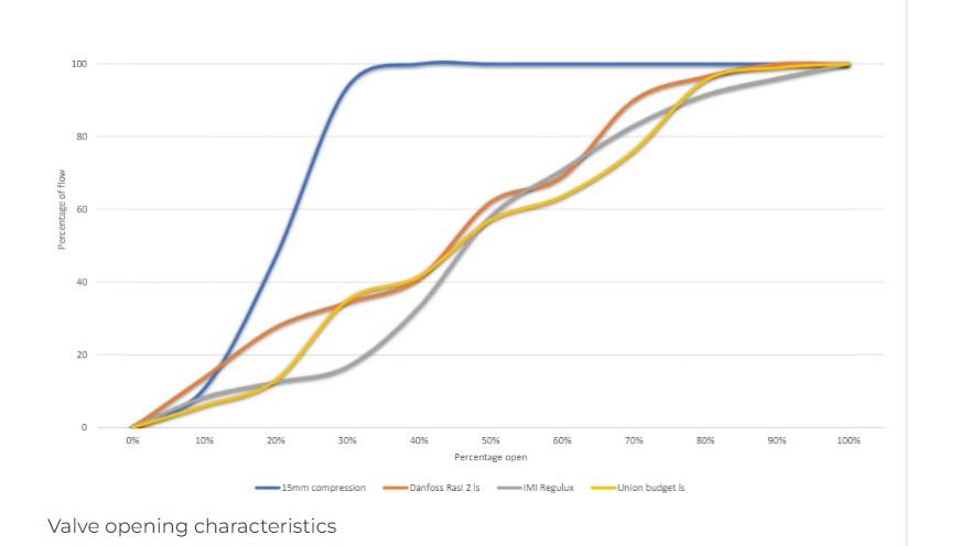

HughF Posted October 29, 2023 Author Share Posted October 29, 2023 (edited) Yep, I get that, but I’d expect them to be a bit more granular, it’s all the same for 95% of the range, then it’s off…. I upped the bottom end of the pump pwm from 20 to 30, it seems to overshoot it’s temperature setpoint by 5 degrees or so at such a low pump pwm. Give me air2air all day 🤣 Edited October 29, 2023 by HughF Link to comment Share on other sites More sharing options...
SimonD Posted October 29, 2023 Share Posted October 29, 2023 8 minutes ago, HughF said: Yep, I get that, but I’d expect them to be a bit more granular, it’s all the same for 95% of the range, then it’s off…. What brand of lockshield valves do you have? Some of them are total sh!te when it comes to adjustability. However, given the nature of hydronic systems, sometimes you find curious behaviour with valves at certain settings too. Link to comment Share on other sites More sharing options...

billt Posted October 29, 2023 Share Posted October 29, 2023 58 minutes ago, HughF said: Yep, I get that, but I’d expect them to be a bit more granular, it’s all the same for 95% of the range, then it’s off….🤣 Have a read of https://www.heatgeek.com/what-you-dont-know-about-lockshield-valves/ which includes this graph. I've just gone through this with my new system. I used IMI valves which are supposed to be reasonably good, but I still found that they had to be practically closed before the adjustment started. Link to comment Share on other sites More sharing options...

HughF Posted October 29, 2023 Author Share Posted October 29, 2023 5 hours ago, SimonD said: What brand of lockshield valves do you have? Some of them are total sh!te when it comes to adjustability. However, given the nature of hydronic systems, sometimes you find curious behaviour with valves at certain settings too. Cheap ones from Screwfix, unfortunately…. Link to comment Share on other sites More sharing options...

marshian Posted October 29, 2023 Share Posted October 29, 2023 7 hours ago, billt said: Have a read of https://www.heatgeek.com/what-you-dont-know-about-lockshield-valves/ which includes this graph. I've just gone through this with my new system. I used IMI valves which are supposed to be reasonably good, but I still found that they had to be practically closed before the adjustment started. Over sensitive lock shield valves is why I went for drayton EB bodies for the TRV's - 6 available presets does all the coarse adjustment and if you need to fine tune you can use the lock shield (only had to do that on towel rails) Link to comment Share on other sites More sharing options...
