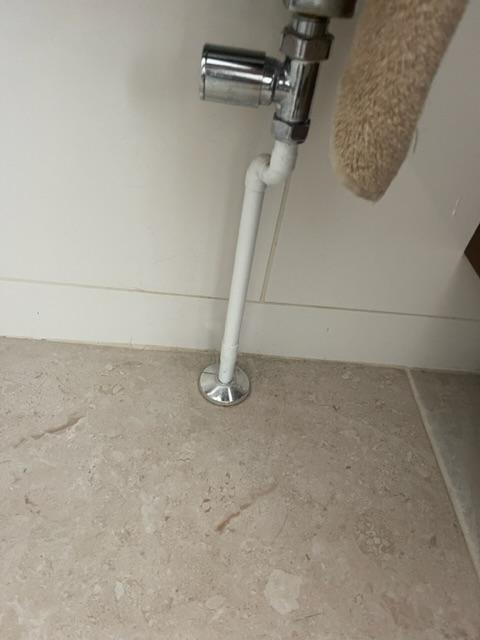

I read you only need it if it’s an electric one. This is connected to the gas pipes like so
Sorry if you are connected to the CH system, that will have corrosion inhibitors in it ,so you don't need to add anything. If it was electric only you would.

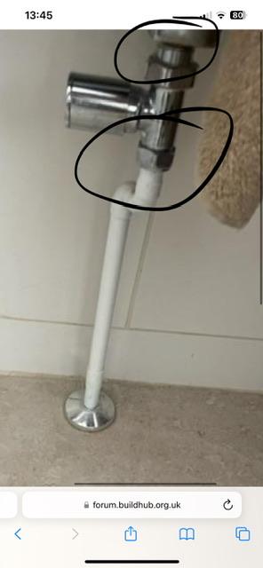

Proper newbie query here but want to do it once and do it right.
Presumably I detach it at the bottom circled area then remove the connector at the top circled bit to attach it to the new one?
