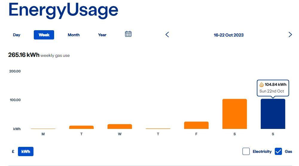

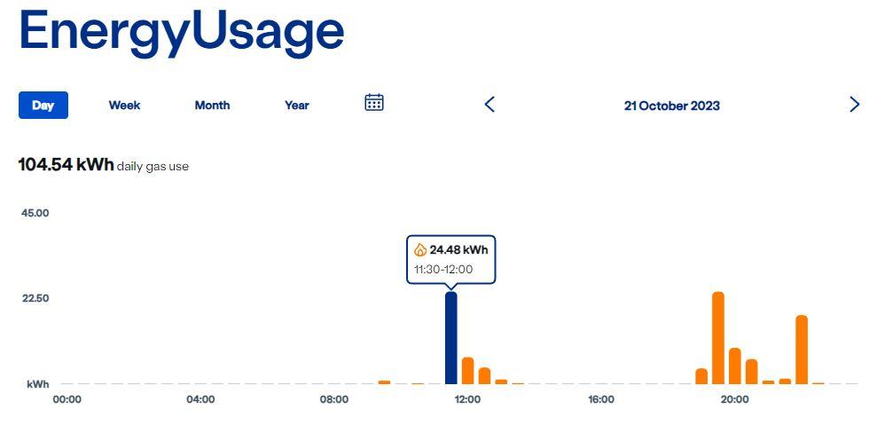

Super_Paulie Posted October 25, 2023 Posted October 25, 2023 hi gents. Just got my radiator system up and running for the first time. 7 Rads, 2 bed semi, just me and the missus living there. Boiler is a new last year Baxi 830 combi, 24w i believe. Set at 60 for the heating system. Looking at my "Energy usage" its excessive, 105kwh a day and the rads were only on for a couple of hours. Looking at one of the spikes it was nearly 25kwh for a half an hour, that doesnt even seem possible? Am i misreading this or is this just normal these days? house has all new insulation, and it does hold the heat nice so i found that the heating on for an hour was enough for the evening pretty much. But 100kw?! doesnt seem possible. I expected this to be at least half that.
SimonD Posted October 25, 2023 Posted October 25, 2023 24.5kWh for half an hour with a 30kW combi boiler does seem rather wrong. Best way to check is by taking readings directly from your gas meter. Then calculate actual readings. BTW what heating controls have been installed? For a 2 bed semi, the heating output of this boiler is minmum about 6kW which is probable double your actual heat requirement on a mildish autumn day.

Temp Posted October 25, 2023 Posted October 25, 2023 My guess is a dodgy connection... Does that 24.48kwh come after a time slot with apparently zero usage ? My guess is the meter wasn't able to update the system for awhile even though the boiler was running. So when it was able to send an update the system incorrectly assumed the calculated change in consumption all occured in the previous time slot instead of say averaging it over the time slots that were missed. I guess the same might happen for longer outages? 1
Temp Posted October 25, 2023 Posted October 25, 2023 (edited) What do grey bars mean? There are some grey and some orange the same size. Does grey mean no data received or similar error? Edited October 25, 2023 by Temp

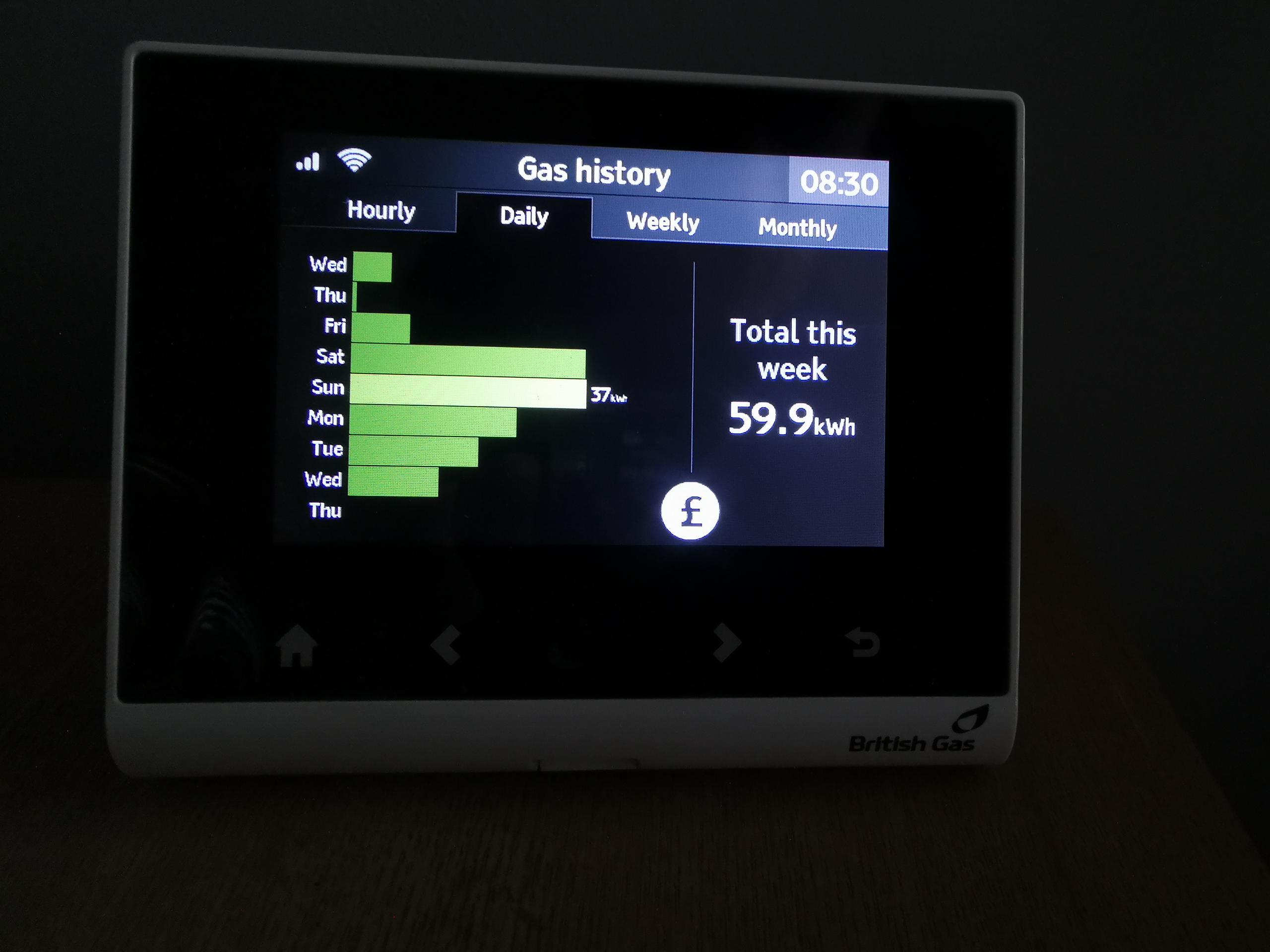

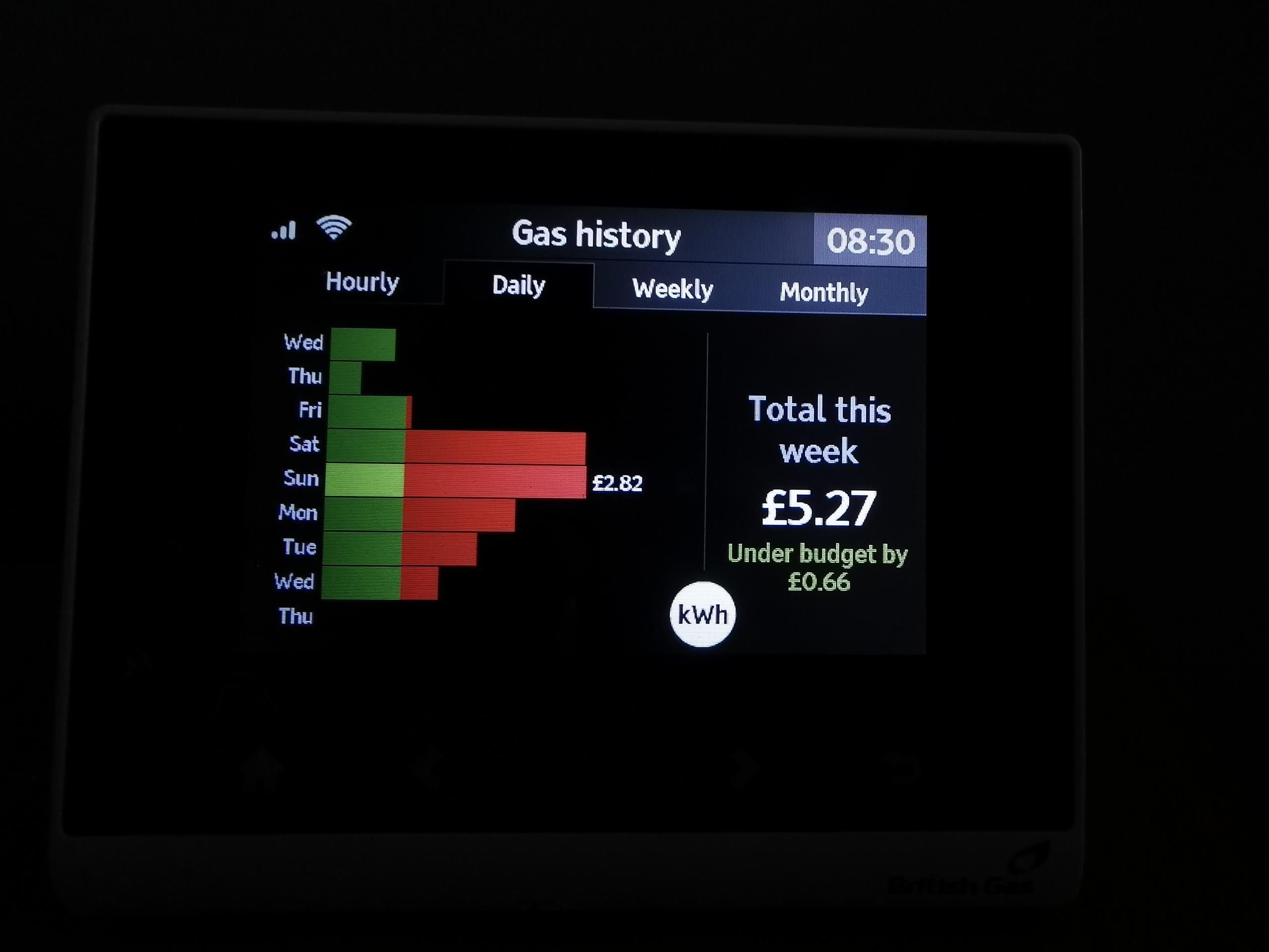

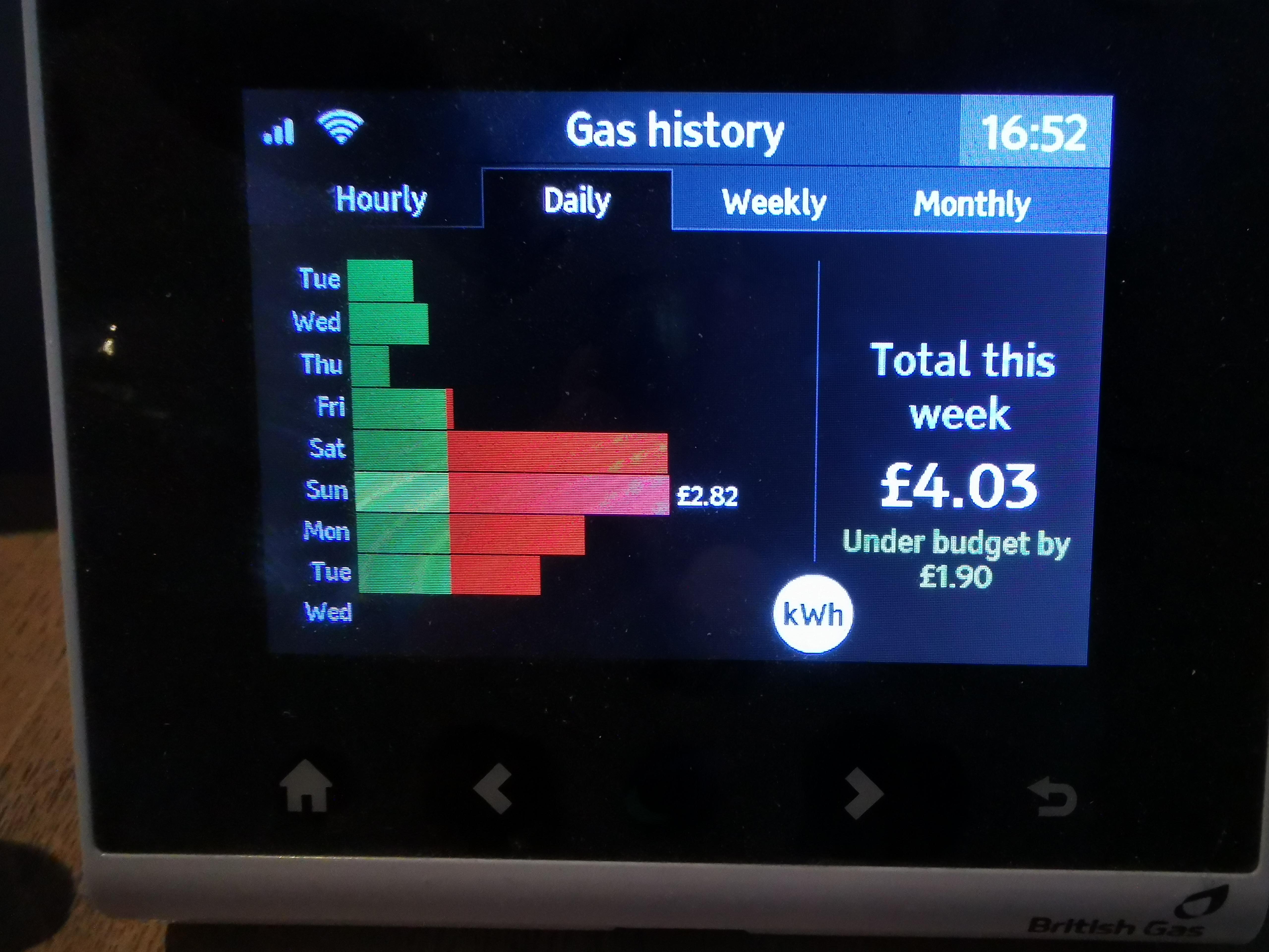

Super_Paulie Posted October 25, 2023 Author Posted October 25, 2023 Got home and checked my smart meter. The 21st was Saturday and the recorded usage was pennies, like £2.80. Honestly man, why is everything just a chew on. I hope the smart meter is correct rather than my British gas account...

ProDave Posted October 25, 2023 Posted October 25, 2023 2 hours ago, Super_Paulie said: Got home and checked my smart meter. The 21st was Saturday and the recorded usage was pennies, like £2.80. Honestly man, why is everything just a chew on. I hope the smart meter is correct rather than my British gas account... Are you saying your in home display attached to the smart meter is giving different readings to your on line account with your energy supplier? That would worry me and I would want to get to the bottom of it, by taking dailiy readings from the meter itself, not the in home display, and comparing that with what your on line energy account says. So much for smart meters, I will stick to a dumb meter and a once a month reading submitted to my provider.
S2D2 Posted October 25, 2023 Posted October 25, 2023 My bet would be British gas are using the same values as the smart meter but the smart meter tariff is out of date therefore showing a lower actual cost. Can you check the tariff or compare kWh instead?

Super_Paulie Posted October 25, 2023 Author Posted October 25, 2023 (edited) How on earth would I have used 25kw in 30 minutes as in the picture earlier. I mean I've got the heating on right now at 60°. Sack it all off for a log burner I say, at least I'll know for sure how many logs I've got. Edited October 25, 2023 by Super_Paulie
S2D2 Posted October 25, 2023 Posted October 25, 2023 17 minutes ago, Super_Paulie said: How on earth would I have used 25kw in 30 minutes as in the picture earlier 4 hours ago, Temp said: Does that 24.48kwh come after a time slot with apparently zero usage ? My guess is the meter wasn't able to update the system for awhile even though the boiler was running 1 hour ago, S2D2 said: Can you check the tariff or compare kWh instead? kWh for the day in question to compare against the app figures, that is.

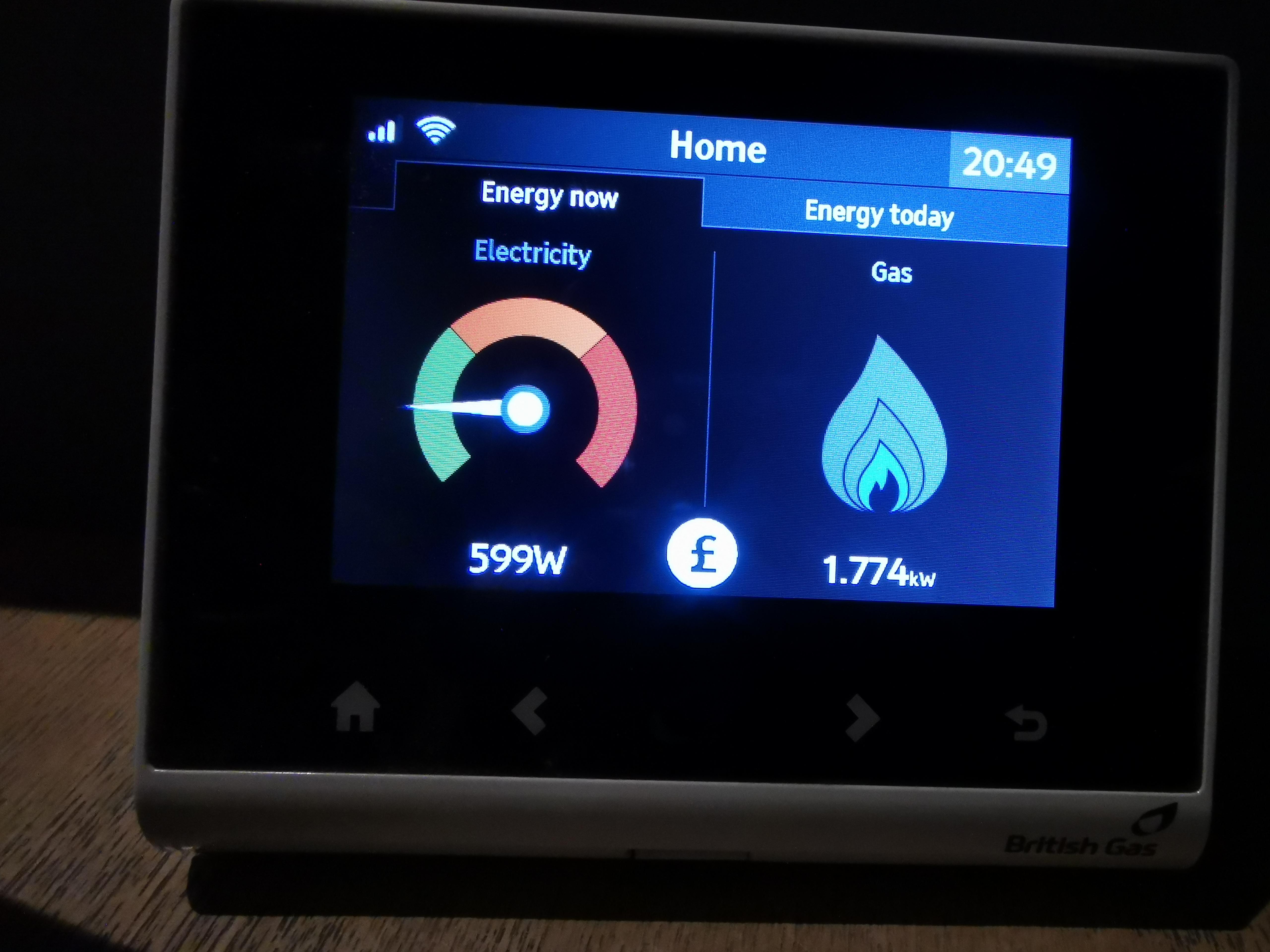

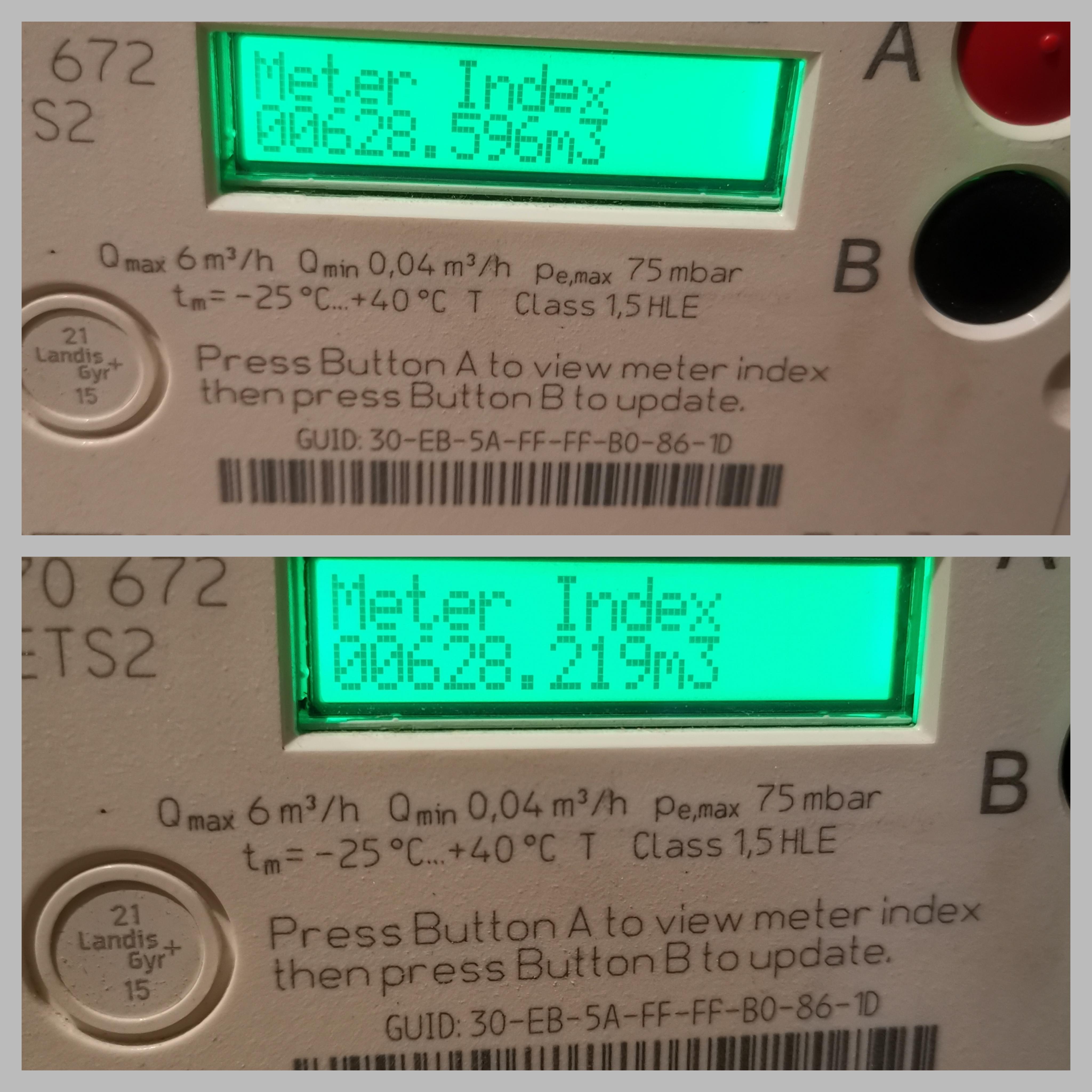

Super_Paulie Posted October 25, 2023 Author Posted October 25, 2023 This is what I've used in an hour. Any gas monkeys know what the hell I'm looking at here?
S2D2 Posted October 25, 2023 Posted October 25, 2023 9 minutes ago, Super_Paulie said: This is what I've used in an hour. Any gas monkeys know what the hell I'm looking at here? ~4.2kWh
ProDave Posted October 25, 2023 Posted October 25, 2023 Gas meters measure in cubic metres of gas. but it is billed in kWh. One of the boffins will be along soon I am sure with the conversion factor.
Super_Paulie Posted October 25, 2023 Author Posted October 25, 2023 1 hour ago, S2D2 said: ~4.2kWh Significantly less than what the app suggested the other day at 50Kwh! I'll record it at the meter the next few days and make a spreadsheet.

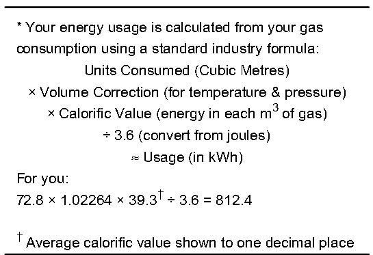

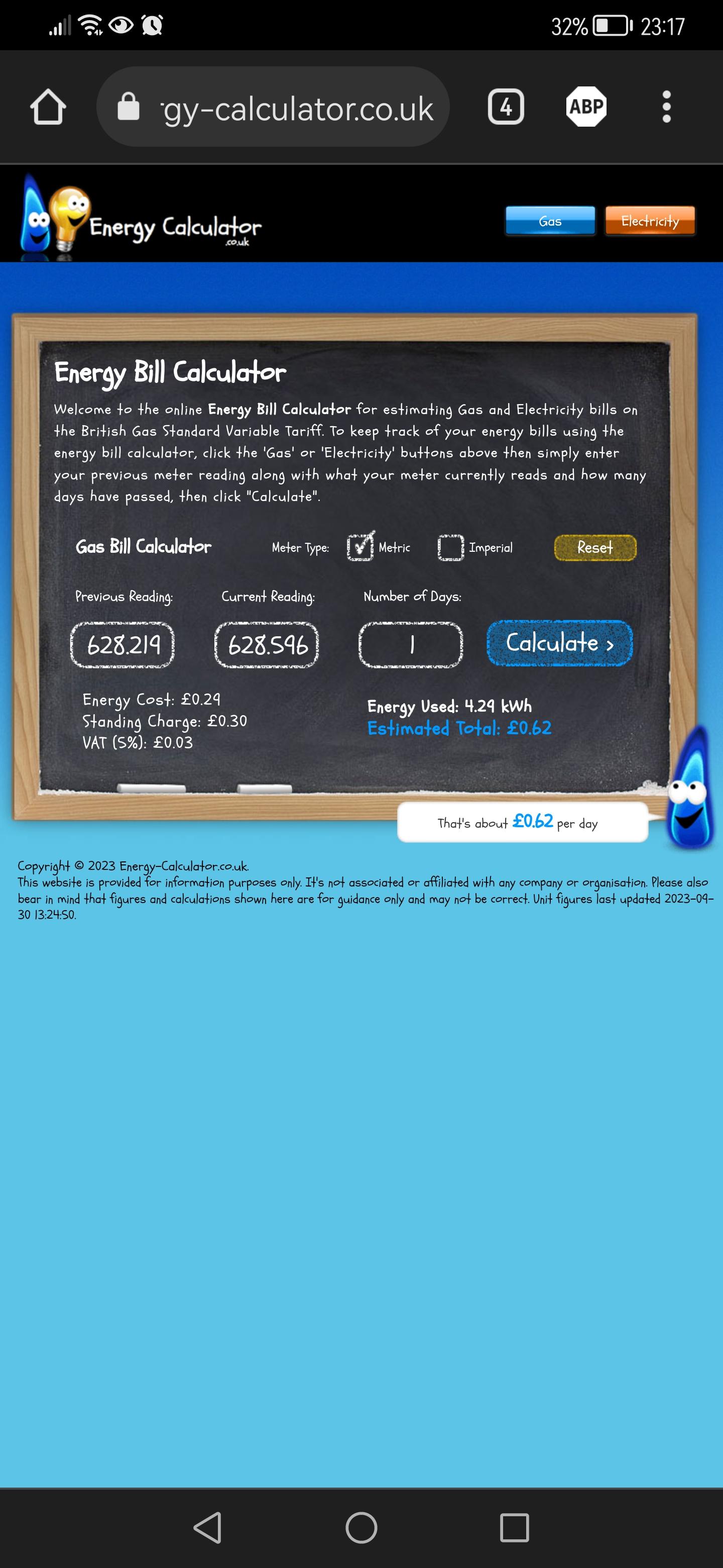

billt Posted October 25, 2023 Posted October 25, 2023 The conversion method is shown on your gas bill; theoretically it varies slightly from time to time. Multiply cubic meters by 11.16 is about right. 1
Super_Paulie Posted October 25, 2023 Author Posted October 25, 2023 It's crazy complex, I wonder why British Gas don't offer up a calculator... Actually I do know, they are a bunch of *****. I found this website which seems to work based on what S2D2 offered up. How my smart meter says a few quid but the official app and website suggest a fortune I have no idea.
S2D2 Posted October 26, 2023 Posted October 26, 2023 13 hours ago, Super_Paulie said: Got home and checked my smart meter. The 21st was Saturday and the recorded usage was pennies, like £2.80. Honestly man, why is everything just a chew on. I hope the smart meter is correct rather than my British gas account... Press the "kWh" button on this screen and show us what it says.
Super_Paulie Posted October 26, 2023 Author Posted October 26, 2023 2 hours ago, S2D2 said: Press the "kWh" button on this screen and show us what it says. this is as of this morning. Pretty different results depending where you look. 1
