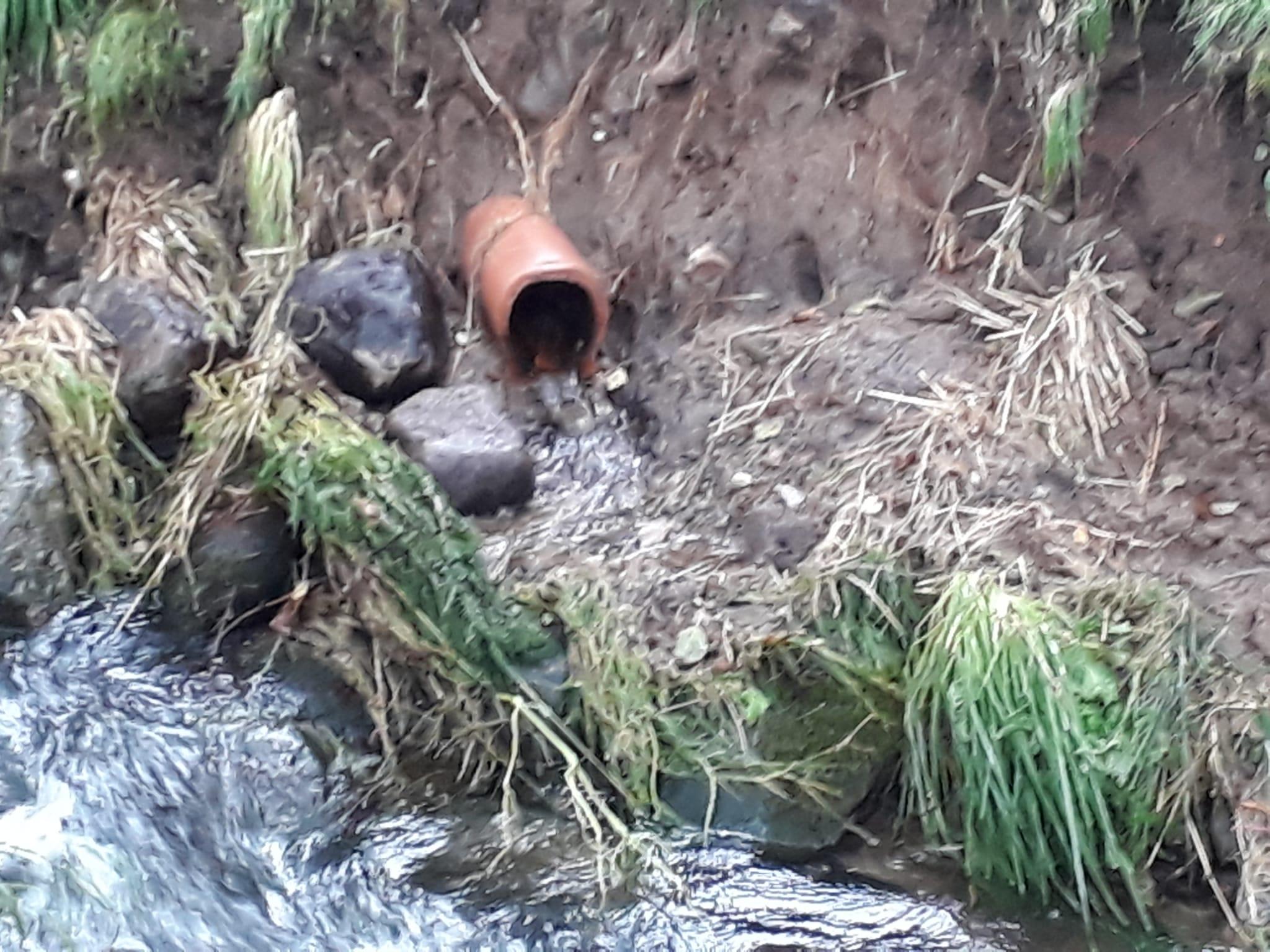

ProDave Posted October 25, 2023 Posted October 25, 2023 the recent storm and a minor bit of garden flooding eroded part of the bank of our burn. It is easy enough to rebuild it and I am already collecting large rocks to build in as reinforcement. But my question is what to do with this old clay land drainage pipe? It has always been there, sticking out from the bank, but until the recent storm has been dry. Now it is running water, which is good, it is doing it's job. But where the bank eroded a whole section of this clay pipe has come off. It would appear the sections are short, about 18" each, and they just butt together, not even a male / female socket at the joint. I want to re fit the detached bit of pipe or otherwise extend it so I can rebuild the bank back to about where it was. So I thought I would try and see if any standard size pipe is a snug fit inside. No such luck. That is a bit of standard 110mm drain pipe. Way too small. but it also shows this clay pipe is not round, a sort of egg shape about 130mm wide and 160mm high. Any ideas how to either join some modern pipe into it, or re fit the original clay pipe. the problem I see with fitting the original flay pipe is needing it to dry out thoroughly (i.e wait until next summer) as it will need a solid base laid, probably concrete, to set the detached piece on a bed of concrete and encase at least the joint in concrete. Any ideas please?
crispy_wafer Posted October 25, 2023 Posted October 25, 2023 Think I'd try one of those rubber clay to plastic adapters and tighten up to see if it will deform to the oval shape. Might work, might not!

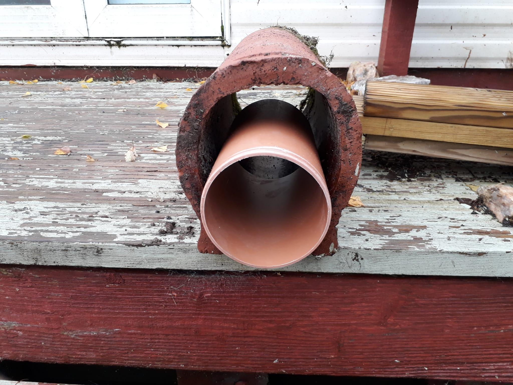

ProDave Posted October 25, 2023 Author Posted October 25, 2023 It may not be clear from the pictures but the outside of this clay pipe is a very irregular shape with a flat bottom. Presumably for laying it on, which would work fine if laying it onto the bottom of a nice flat dry trench. So I can't see any form of sleeve over the outside working. It might be worth trying 160mm drain pipe if I can find a bit, but it would have to be squashed to go in, and I can't see that happening. Anything to do with concreting, will require it to be dry, i.e. burn lower than present and nothing running out of the land drain pipe. Can you see the dilemma?
saveasteading Posted October 25, 2023 Posted October 25, 2023 1 minute ago, ProDave said: Can you see the dilemma? As you are building a head wall, you could transition to a new pipe within it and concrete all around and behind. Then pretty stone work on show. Or take one more out. 18" is likely. Or build a concrete channel instead of using a pipe, to any shape. Looks fun to me.
IanR Posted October 25, 2023 Posted October 25, 2023 36 minutes ago, ProDave said: But where the bank eroded a whole section of this clay pipe has come off. It would appear the sections are short, about 18" each, and they just butt together, not even a male / female socket at the joint. Looks like an old land drain. The butt joint with no connection is intentional, to let the water get into the "pipe" and guide it out to the ditch/burn. It probably started off roundish, but has become misshapen over time. You can just build back up the earth around it and lay the displaced pipe back into its position. Then reinforce the band with what ever you plan.

Conor Posted October 25, 2023 Posted October 25, 2023 Slide a length of 180mm twinwall drain pipe over it and be done. 1

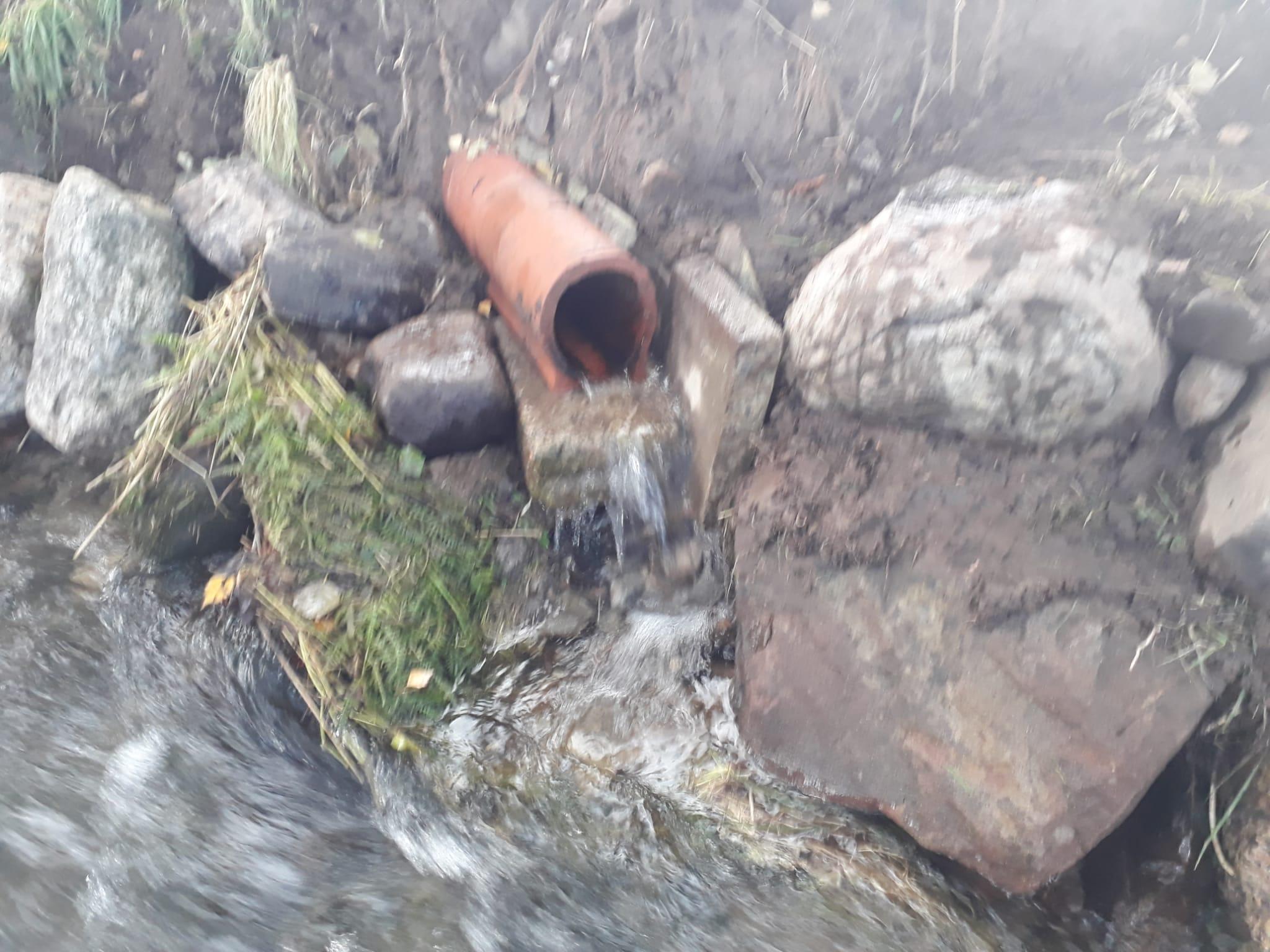

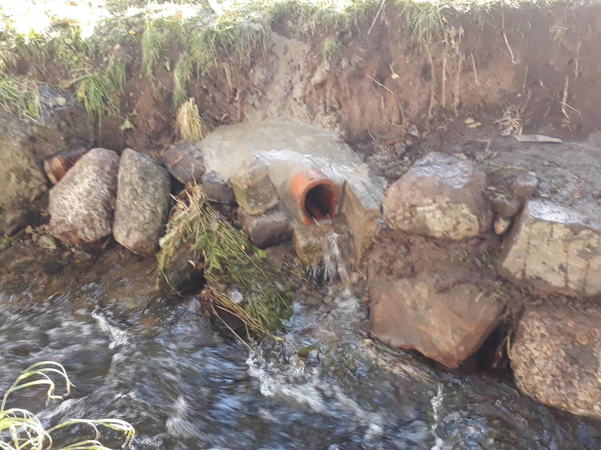

ProDave Posted October 31, 2023 Author Posted October 31, 2023 Well I failed to find any suitable pipe to go in it or outside it, so I set about trying to connect the detached bit, as it was now holding up my rebuilding of the bank. So first I set an ordinary concrete block in, in front of the piece of pipe still embedded in the bank. I offered the detached piece up to it and it seemed to sit okay and stable. So I "fixed" it in place with stixall,. which is one of the many glue / sealants that claims to work when wet. A Very generous bead all around the end of the detached piece and then push them together quickly. It seemed to seal okay with no water leaking from the joint. That's okay, but it would soon get knocked out of place when rebuilding the remainder of the bank. So I mixed a barrow load of muck and encased the whole lot. Once that has had a chance to set and harden I can continue rebuilding the bank. 2
FarmerN Posted November 2, 2023 Posted November 2, 2023 Looks good. Drain is shifting good amount of water, has to be worth the effort. Better than my bodge jobs.

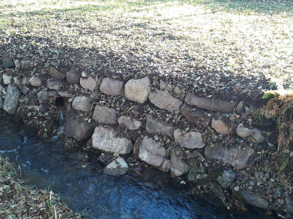

ProDave Posted November 13, 2023 Author Posted November 13, 2023 And the repaired section of the bank completed. Land drain pipe still flowing. 4
