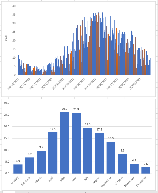

I'm one day shy of a full year with panels and it's amazing how generation varies. Not just by month but by day. I know it's kind of obvious but one day can be three times the previous day very easily. My system is 12*410w panels at only 10 degrees on a flat roof, so bad for winter but it was an easy install and I can clean myself etc.
The chart shows the amazing May and crappy July/August that we had!
@MrTWales' bar chart is very characteristic and similar to what we have experienced over 12 years with our first 3.7 kW of panels, July and August have often been poor compared with May.
