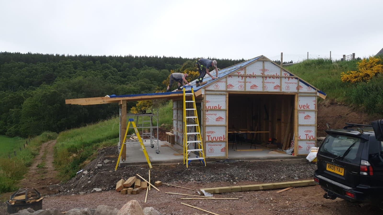

joe90 Posted October 18, 2023 Share Posted October 18, 2023 (edited) I have just erected one of these, you can get some of their cabins in twin wall for insulation so maybe they will do you a garage in similar. Better priced than most and timber good quality. Dead easy to DIY. Mine was built on a 150mm slab, no foundations so cheaper again. Mine is for a classic car and motor bike and I think it looks pretty. (Just waiting for a bespoke classic looking up and over door to arrive) https://www.quick-garden.co.uk/single-wooden-garage-4m-x-6m-13x20-ft-44-mm.html. For other types Edited October 18, 2023 by joe90 Link to comment Share on other sites More sharing options...

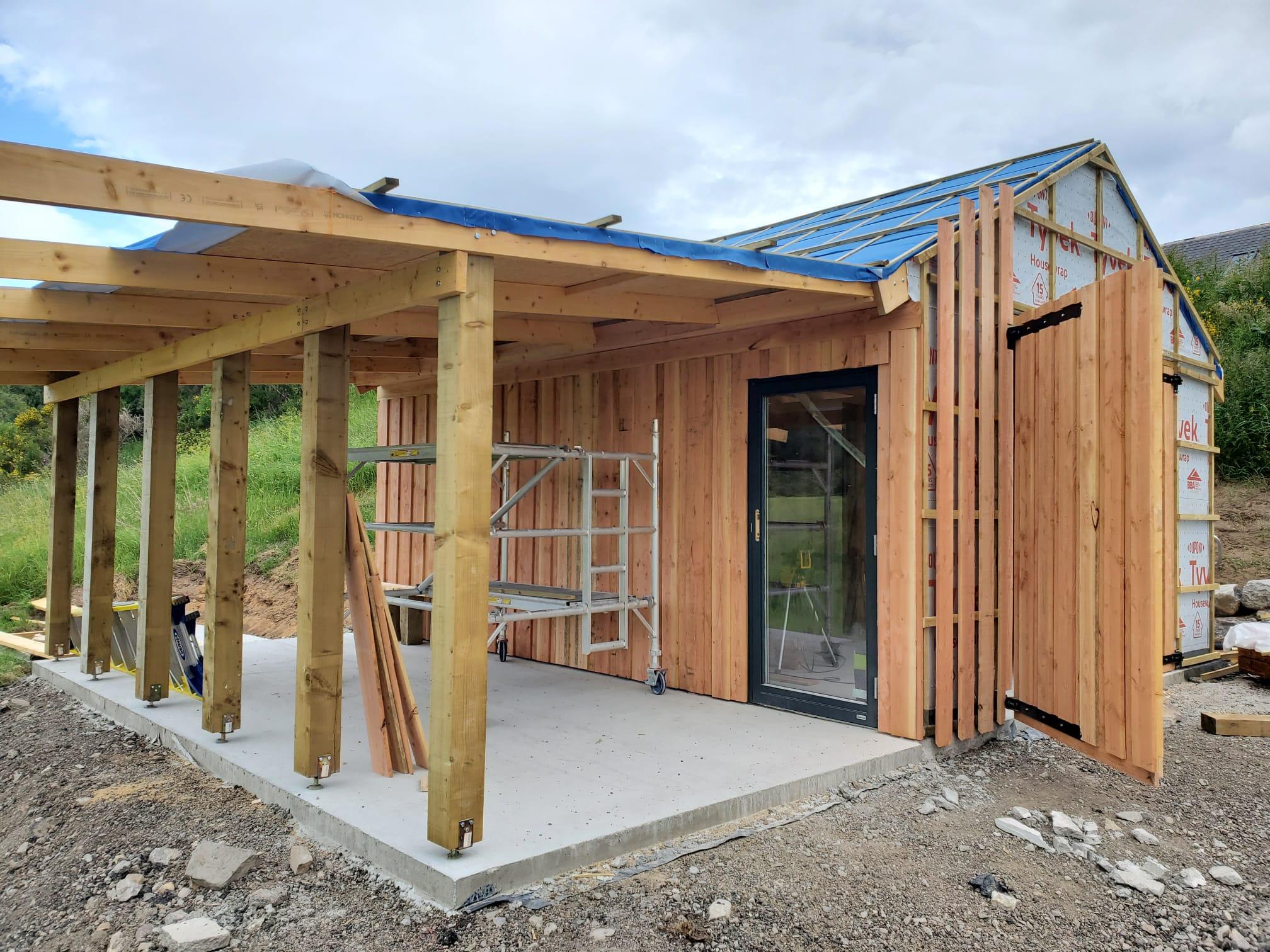

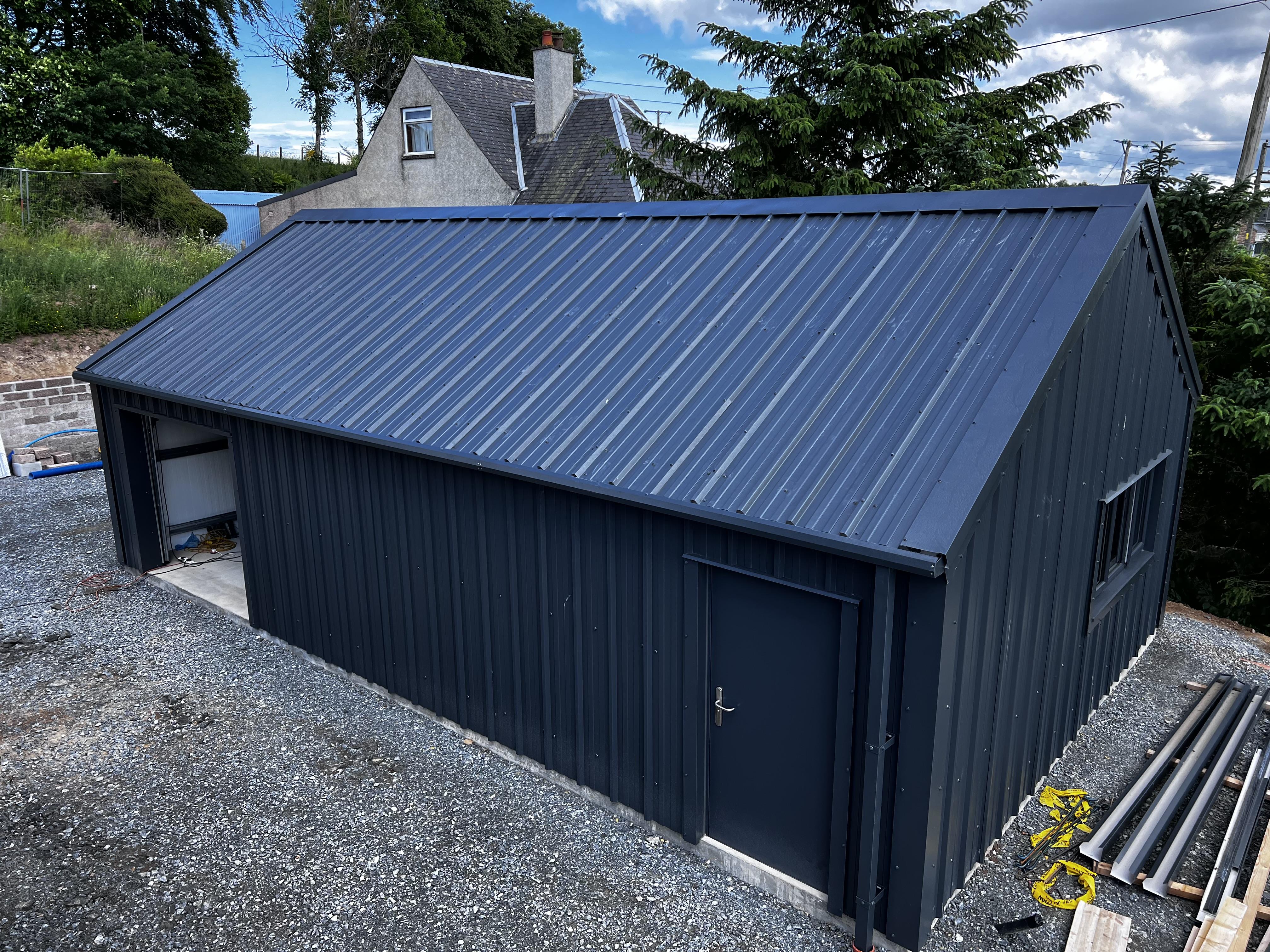

Kelvin Posted October 18, 2023 Share Posted October 18, 2023 How much is insane? Stick built on-site or block built will be cheapest traditional build method or do what I did and build an insulated steel building. Mine has 80mm insulation in walls and ceiling with insulated doors. 100mm insulation under the slab. 2G window. 10m x 6.5m 1 Link to comment Share on other sites More sharing options...

saveasteading Posted October 18, 2023 Share Posted October 18, 2023 @joe90s is optimum for cost I'd say, as a diy project. I looked at this and similar suppliers. @Kelvin steel kit can be good value, esp for bigger areas because steel jumps big spaces very efficiently. Ready made timber kits can be quite expensive. Timber stud built on site is stronger than a t & g kit, but needs designing, and much cheaper than a kit of parts. Here's ours using free family labour and newfound skills. No contractors or designers engaged at all ( except that i looked at the sketches and said ok). The bco agreed that it was below his threshold area and that the canopy isn't a building. NB the pin jointed column bases and home made garage doors. The pedestrian door is unnecesarily flash as was free, as supplied wrong for the house. Cost? I'd have to check but about £4k materials. Labour say 30 man days. Commercially then that is about £10k, and add oh &p. Plus vat. Total £18k. @Saul your turn. What cost range are you getting? 1 Link to comment Share on other sites More sharing options...
joe90 Posted October 18, 2023 Share Posted October 18, 2023 I would agree with T@G but mine was 44mm thick timber, not going to bend/shrink much, in fact the building is designed to shrink slightly as the timber dries, no vertical timber, the building is designed to shrink in height. By up to 35mm and so no gaps in the boards like most T@G. Also 44mm should give some insulation value, mine was less than £6k all in, including wood treatment 👍 Link to comment Share on other sites More sharing options...
Kelvin Posted October 18, 2023 Share Posted October 18, 2023 I originally wanted an insulated timber kit garage built to a similar spec to the house in the same cladding and roof material. When I looked at it 5 years ago it was all quite affordable. However fast forward to this year and it was going to cost £70,000 which was more than twice the cost and way over my budget. The steel building came in well under my budget including the foundation and was up and usable in two days. Aesthetically it’s matter of taste but I really like the look of it. Link to comment Share on other sites More sharing options...

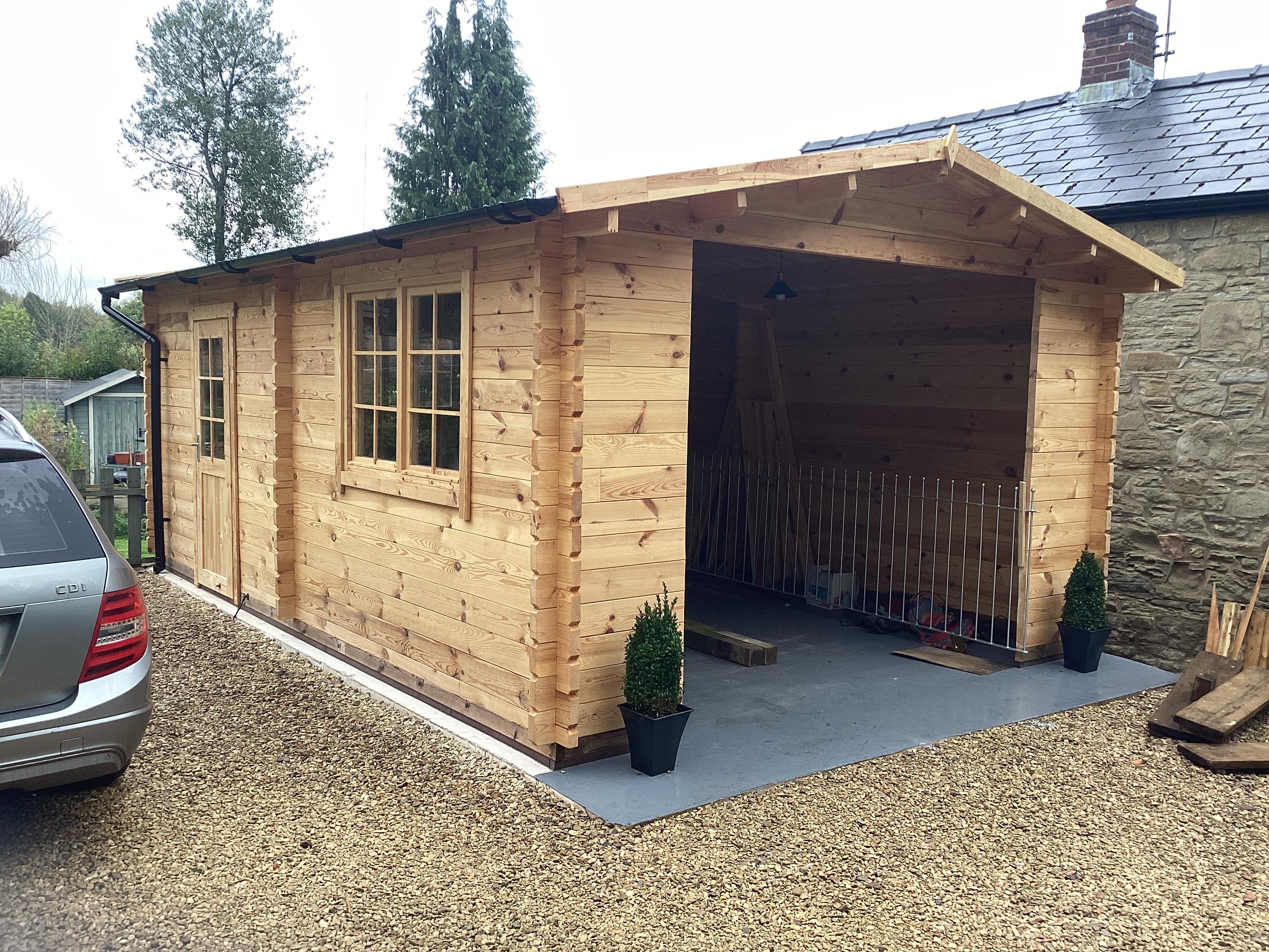

Iceverge Posted October 18, 2023 Share Posted October 18, 2023 6 hours ago, joe90 said: I have just erected one of these, you can get some of their cabins in twin wall for insulation so maybe they will do you a garage in similar. Better priced than most and timber good quality. Dead easy to DIY. Mine was built on a 150mm slab, no foundations so cheaper again. Mine is for a classic car and motor bike and I think it looks pretty. (Just waiting for a bespoke classic looking up and over door to arrive) https://www.quick-garden.co.uk/single-wooden-garage-4m-x-6m-13x20-ft-44-mm.html. For other types Floor paint look smart. Do you have any issues with rainwater blowing into the garage? Link to comment Share on other sites More sharing options...
joe90 Posted October 18, 2023 Share Posted October 18, 2023 24 minutes ago, Iceverge said: Floor paint look smart. Do you have any issues with rainwater blowing into the garage? Yes, my man shed 😎, only till the door arrives 1st Nov 👍 1 Link to comment Share on other sites More sharing options...
