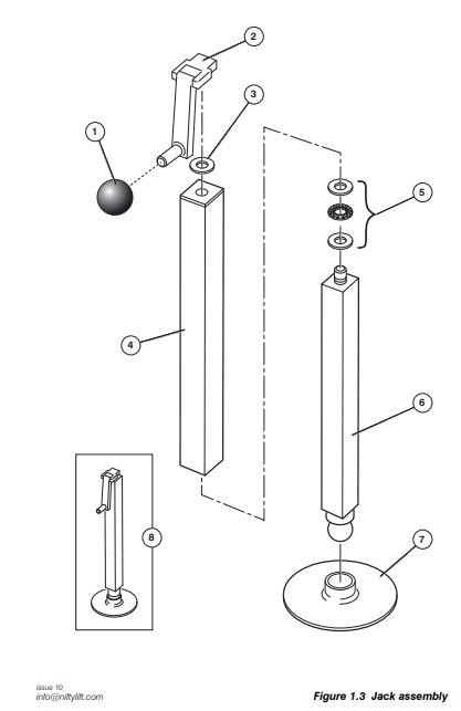

joe90 Posted October 16, 2023 Posted October 16, 2023 https://www.rentalex.com/wp-content/uploads/2020/10/TM34MG-Parts-Manual.pdf
Danthebuilder Posted October 16, 2023 Author Posted October 16, 2023 43 minutes ago, joe90 said: https://www.rentalex.com/wp-content/uploads/2020/10/TM34MG-Parts-Manual.pdf It doesn't say in the manual what is inside the jack. Like it is a seal unit or something.

joe90 Posted October 17, 2023 Posted October 17, 2023 It looks like part no 6 is at fault, if it won’t come apart (have you tried.) then price up new ones.

Temp Posted October 19, 2023 Posted October 19, 2023 Page 1-10 has the parts list just for the jack. .part 6 is P70072 but Google could only find that in the USA at $160 !

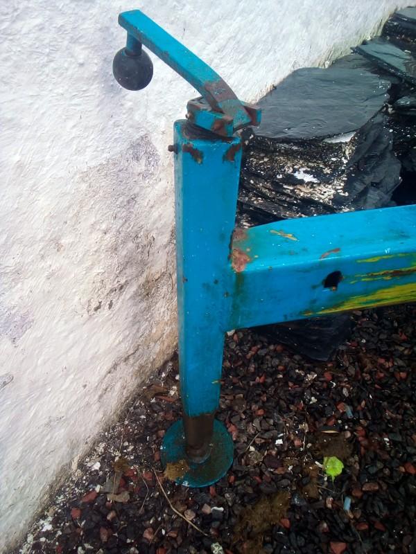

Danthebuilder Posted November 10, 2023 Author Posted November 10, 2023 So here is a picture. Now three legs have failed which is a problem.

joe90 Posted November 10, 2023 Posted November 10, 2023 (edited) Will it come apart? Have you tried? It’s obviously a thread device hence the winding handle on top, if it’s like a similar trailer leg it will unscrew completely and drop down so you can see what it’s like (if you can get the chassis high enough.) then you need to get the handle assembly out of that square tube, I can see any fixings on your photo 🤷♂️ just looked at the diagram above, if you can get part no 2 off, the jack assembly should fall out. Edited November 10, 2023 by joe90
Danthebuilder Posted November 10, 2023 Author Posted November 10, 2023 Thanks. Yes, I was all along wondering if I could lift the chassis high enough for the leg to drop out, then I'd see some sort of mechanism and maybe a hint why it has failed. The fact that three have all done the same suggests to me it's not a complex issue. The handle appears not to be held on in any obvious way. I think I'll try to tip the chassis and see if a leg will come out. Cheers.
