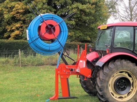

joe90 Posted October 18, 2023 Posted October 18, 2023 If you only want water (no trench) ring around farmers, one will have a mole plough that fits on their tractor..
Amateur bob Posted October 18, 2023 Author Posted October 18, 2023 6 hours ago, joe90 said: If you only want water (no trench) ring around farmers, one will have a mole plough that fits on their tractor.. that looks handy, is that def allowed because usually scottish water have to inspect the laid pipe before theyll connect?
Amateur bob Posted October 18, 2023 Author Posted October 18, 2023 7 hours ago, IanR said: My experience in England, was that I had to be on my own meter, and the meter was at the road, so had to run a new connection to the main, install a new meter at the road, and a new pipe from meter to property (130m for me). Since I was running power, broadband and data to the road as well, I dug a trench. If you are doing water only and crossing mostly fields, could you find someone local that offers a mole plough installation. As an example from a google search: https://www.pe100plus.com/PE-Pipes/Technical-guidance/Trenchless/Methods/Installation/Mole-Ploughing-i1303.html strange that you needed to have a metre for the house i was under the impression that water to residential houses was free and only businesses need a metre?

joe90 Posted October 18, 2023 Posted October 18, 2023 New build connections require a water meter. Farmers use mole ploughing for water connections all the time, yes my connection trench was inspected but it was dug by hand, as long as you can show it starts at the right depth I don’t think they would argue. 1
