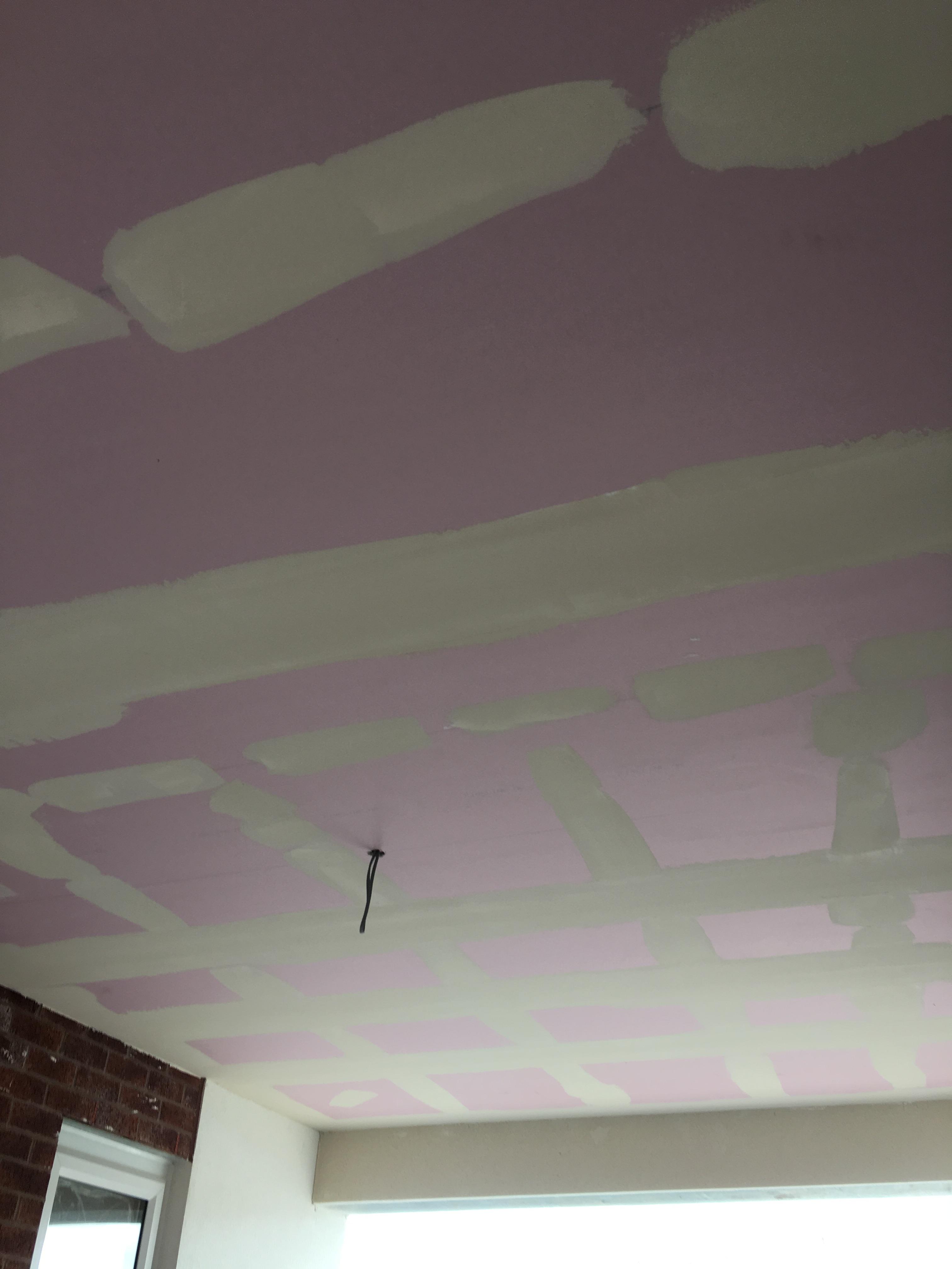

jack Posted June 6, 2018 Author Share Posted June 6, 2018 Just returning to this (September last year? Jaysus!) and now about to order the materials for this job. In addition to the fermacell walls, I also have to tape and join some TE boards on the ceiling. Given the amount I have to do, for price reasons I'm going to use some sort of Gyproc filler. Their joint filler is cheap, but it says in this guide that you can't use joint filler as a final coat. Is that an installation issue (eg, too hard to sand) or just an aesthetic one? For TE boards, any preference to using Easi-fill for both, or Joint Filler first with, eg, Joint Cement over the top? @nod - any thoughts? Thanks Link to comment Share on other sites More sharing options...
PeterW Posted June 6, 2018 Share Posted June 6, 2018 All my Fermacell I filled with Alabaster filler and it’s never moved or cracked. Tend to use Easyfill 20 now for most things - you can use it to tape too 1 Link to comment Share on other sites More sharing options...
nod Posted June 6, 2018 Share Posted June 6, 2018 1 hour ago, jack said: Just returning to this (September last year? Jaysus!) and now about to order the materials for this job. In addition to the fermacell walls, I also have to tape and join some TE boards on the ceiling. Given the amount I have to do, for price reasons I'm going to use some sort of Gyproc filler. Their joint filler is cheap, but it says in this guide that you can't use joint filler as a final coat. Is that an installation issue (eg, too hard to sand) or just an aesthetic one? For TE boards, any preference to using Easi-fill for both, or Joint Filler first with, eg, Joint Cement over the top? @nod - any thoughts? Thanks Use the joint filler sparingly Hard work to sand if you get any high spots quiksand for top coat Build up in several coats sponge the edges 1 Link to comment Share on other sites More sharing options...

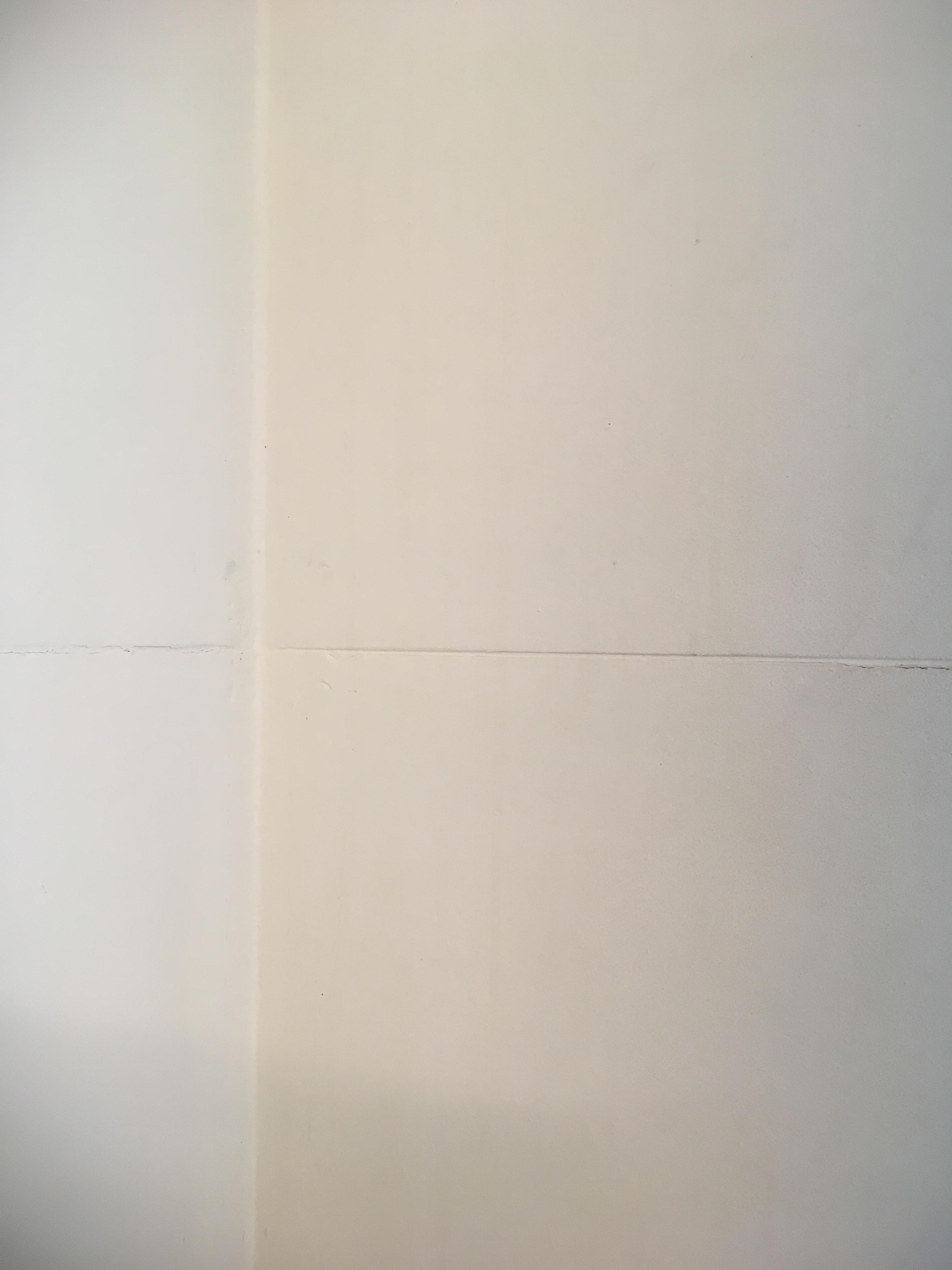

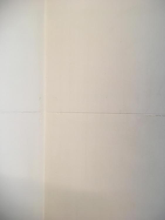

nod Posted June 6, 2018 Share Posted June 6, 2018 Here’s one I did earlier? 1 Link to comment Share on other sites More sharing options...

Nickfromwales Posted June 6, 2018 Share Posted June 6, 2018 For absolute final filling, easifill normally will suffice if your painting ( then rubbing down the paint as a fine filler ) Toupret is the best I've used so far. You can accelerate the drying times with a hairdryer without compromising the filler and it feathers out to nothing ( unlike the joint filler which is coarser by comparison which 'maps' around the edges sometimes. 1 Link to comment Share on other sites More sharing options...
nod Posted June 6, 2018 Share Posted June 6, 2018 3 hours ago, Nickfromwales said: For absolute final filling, easifill normally will suffice if your painting ( then rubbing down the paint as a fine filler ) Toupret is the best I've used so far. You can accelerate the drying times with a hairdryer without compromising the filler and it feathers out to nothing ( unlike the joint filler which is coarser by comparison which 'maps' around the edges sometimes. Yep but don’t get joint filler and joint cement confused joint cement is very fine 1 Link to comment Share on other sites More sharing options...
Nickfromwales Posted June 7, 2018 Share Posted June 7, 2018 14 hours ago, nod said: Yep but don’t get joint filler and joint cement confused joint cement is very fine Agreed, but what does it say in the bag ? If it doesn't say finish / filler then you need a product that can be feathered out to nothing ( if it's on display for eg ). Link to comment Share on other sites More sharing options...
jack Posted June 7, 2018 Author Share Posted June 7, 2018 Gyproc QuickSand Joint Cement: "A new easy to sand air-drying powdered jointing material. For the finishing stage over Gyproc Joint Filler." Link to comment Share on other sites More sharing options...
Nickfromwales Posted June 7, 2018 Share Posted June 7, 2018 9 minutes ago, jack said: Gyproc QuickSand Joint Cement: "A new easy to sand air-drying powdered jointing material. For the finishing stage over Gyproc Joint Filler." Well shut my mouth Link to comment Share on other sites More sharing options...
