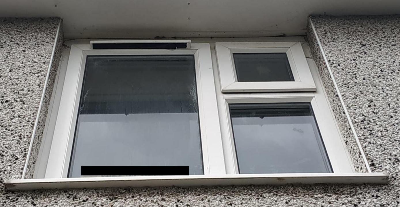

JohnBishop Posted October 9, 2023 Author Posted October 9, 2023 This is the window I am talking about. I reckon there is about 12mm of plaster on each side and above I have to get rid off.

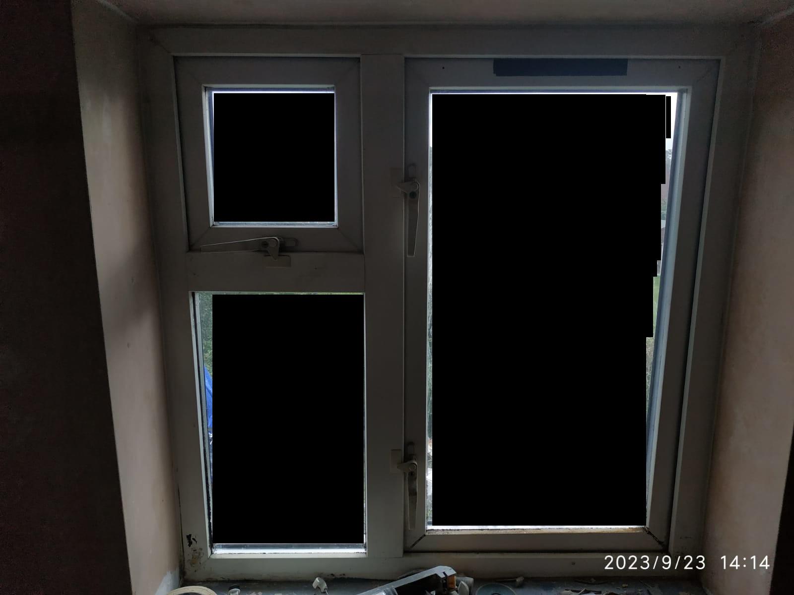

JohnBishop Posted October 10, 2023 Author Posted October 10, 2023 (edited) 14 hours ago, Crofter said: There will be a way of doing it from the inside. A reciprocating saw is your friend. I get that I can use the saw to help to remove it but I still need to hack off the plaster to put one in. Just wondering how much do I need to hack off not to overdo. Edited October 10, 2023 by JohnBishop

gaz_moose Posted October 11, 2023 Posted October 11, 2023 looks like the external sill is now built into the walls, which makes it interesting as the sill is usually screwed into the bottom of the frame (from the bottom). open a window and look to see if they have screwed through the sides of the frames into the walls when fitting them, if not then they have probably been fitted with straps that will be buried under the plaster. looks like they have fitted trim up the sides of the frame on the outside, so hopefully it is a bit undersize which will give you some wiggle room getting it out and the render is stuck to the trim and not the frame, although the trim will be superglued to the frame. externally glazed too just to add to the fun. probably just been foamed in LOL. a multi tool will cut through the frames. i think my plan of attack would be to cut the plasterboard off the top and one of the sides about 2" away from the corner bead then about 2" away from the frame on the other side. measure the size of window needed aiming for a looser fit than normal 😆. id be tempted to just cut the old sill out with a multitool and make the 'horns' of the new sill slightly bigger to cover over what's been buried in the EWI. then just screw and foam the new one in. 1
