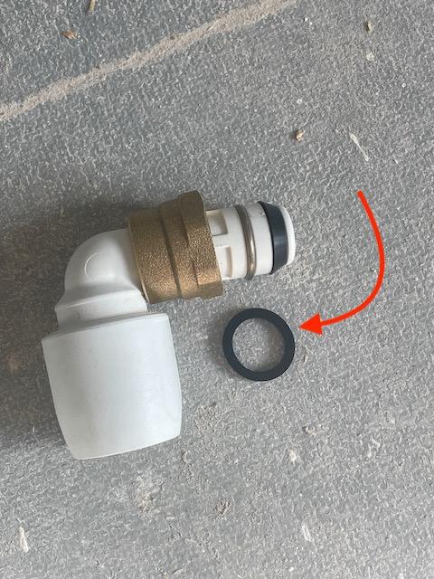

Thorfun Posted October 8, 2023 Posted October 8, 2023 greetings. I am using hep2o 90° tap connectors to connect my toilet cisterns to the water supply. they come with a rubber washer and I can't figure out what it's for! can anyone shed any light please? it's the bit with the red arrow pointing to in the image below:
joe90 Posted October 8, 2023 Posted October 8, 2023 (edited) “The reason for the two washers is to cover all types of tap tails, some have a square end (flat washer) others have a tapered internal bore (tapered washer).” Edited October 8, 2023 by joe90 2 1
Thorfun Posted October 8, 2023 Author Posted October 8, 2023 so how does one know when it's required?
joe90 Posted October 8, 2023 Posted October 8, 2023 22 minutes ago, Thorfun said: so how does one know when it's required? 40 minutes ago, joe90 said: , some have a square end (flat washer) others have a tapered internal bore (tapered washer).” Look at the tap end you are connecting too

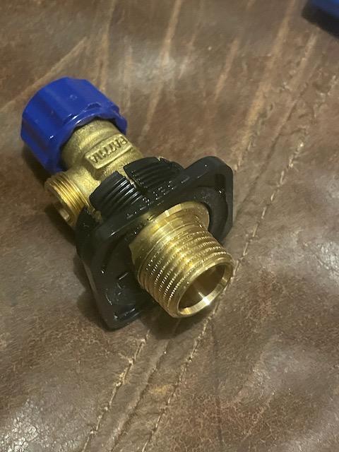

Thorfun Posted October 8, 2023 Author Posted October 8, 2023 (edited) 17 minutes ago, joe90 said: Look at the tap end you are connecting too errr....there's no washer I can see! have I used the wrong connector? or do I just ignore that rubber washer as it's not required in this situation? ps. I used Loctite 55 as I prefer it to PTFE Edited October 8, 2023 by Thorfun added the Loctite bit
joe90 Posted October 8, 2023 Posted October 8, 2023 (edited) That’s tapered as far as I can see so the spare washer is not required. The tapered rubber washer on the connector fits in the tapered end on the tap. Lock tite or PTFE is not required as the thread is not relied on to give a seal like an olive. I see so many people put ptfe tape on threads when not required 🤷♂️ Edited October 8, 2023 by joe90
Thorfun Posted October 8, 2023 Author Posted October 8, 2023 11 minutes ago, joe90 said: That’s tapered as far as I can see so the spare washer is not required. The tapered rubber washer on the connector fits in the tapered end on the tap. Lock tite or PTFE is not required as the thread is not relied on to give a seal like an olive. I see so many people put ptfe tape on threads when not required 🤷♂️ thank you. I didn't know it didn't need tape! it can't hurt though, right?
joe90 Posted October 8, 2023 Posted October 8, 2023 9 minutes ago, Thorfun said: thank you. I didn't know it didn't need tape! it can't hurt though, right? Just a waste of time, if the thread leaks the rubber washer has failed.
Thorfun Posted October 8, 2023 Author Posted October 8, 2023 27 minutes ago, joe90 said: Just a waste of time, if the thread leaks the rubber washer has failed. ok. but not worth wasting more time undoing it and taking it off again! 😉 1
ProDave Posted October 8, 2023 Posted October 8, 2023 Tap connectors are supposed to be a square edge. If you need the tapered one, you are probably joining onto a fitting that is supposed to have a nut and an olive? @Nickfromwales ?
joe90 Posted October 8, 2023 Posted October 8, 2023 8 minutes ago, ProDave said: supposed to have a nut and an olive? Makes sense but why does the hep connector have a tapered o ring? Common Nick, where are you when we need you?
ProDave Posted October 8, 2023 Posted October 8, 2023 Every "tap" I have joined to, which includes the inlet to say a WC fill valve has had a flat end and so would need the flat washer in this case. So I don't know why they would fit the tapered one as the default. A proper plumber will be along I am sure to advise.

Nickfromwales Posted October 9, 2023 Posted October 9, 2023 19 hours ago, ProDave said: Tap connectors are supposed to be a square edge. If you need the tapered one, you are probably joining onto a fitting that is supposed to have a nut and an olive? @Nickfromwales ? The Hep2o tap connector is what I use on these, and the spare / alternative ‘square’ washer goes in the bin. Sorry to be late to the party, just crazy busy atm. 1
Nickfromwales Posted October 9, 2023 Posted October 9, 2023 20 hours ago, Thorfun said: errr....there's no washer I can see! have I used the wrong connector? or do I just ignore that rubber washer as it's not required in this situation? ps. I used Loctite 55 as I prefer it to PTFE Use zilch here, these go on dry, or the rubber washer displaces and you are Donald Ducked.
Thorfun Posted October 9, 2023 Author Posted October 9, 2023 (edited) 1 minute ago, Nickfromwales said: Use zilch here, these go on dry, or the rubber washer displaces and you are Donald Ducked. do i undo and take off the Loctite 55 tape? don't want @joe90 to accuse me of being a bodge again. 🤣 Edited October 9, 2023 by Thorfun 1
Nickfromwales Posted October 9, 2023 Posted October 9, 2023 37 minutes ago, Thorfun said: do i undo and take off the Loctite 55 tape? don't want @joe90 to accuse me of being a bodge again. 🤣 If the rubber isn’t covered with it then you’re ok, but I never ‘lube’ these up as the idea is for the rubber to take against the brass and stay put.
Thorfun Posted October 9, 2023 Author Posted October 9, 2023 4 minutes ago, Nickfromwales said: If the rubber isn’t covered with it then you’re ok, but I never ‘lube’ these up as the idea is for the rubber to take against the brass and stay put. what rubber?! 1
