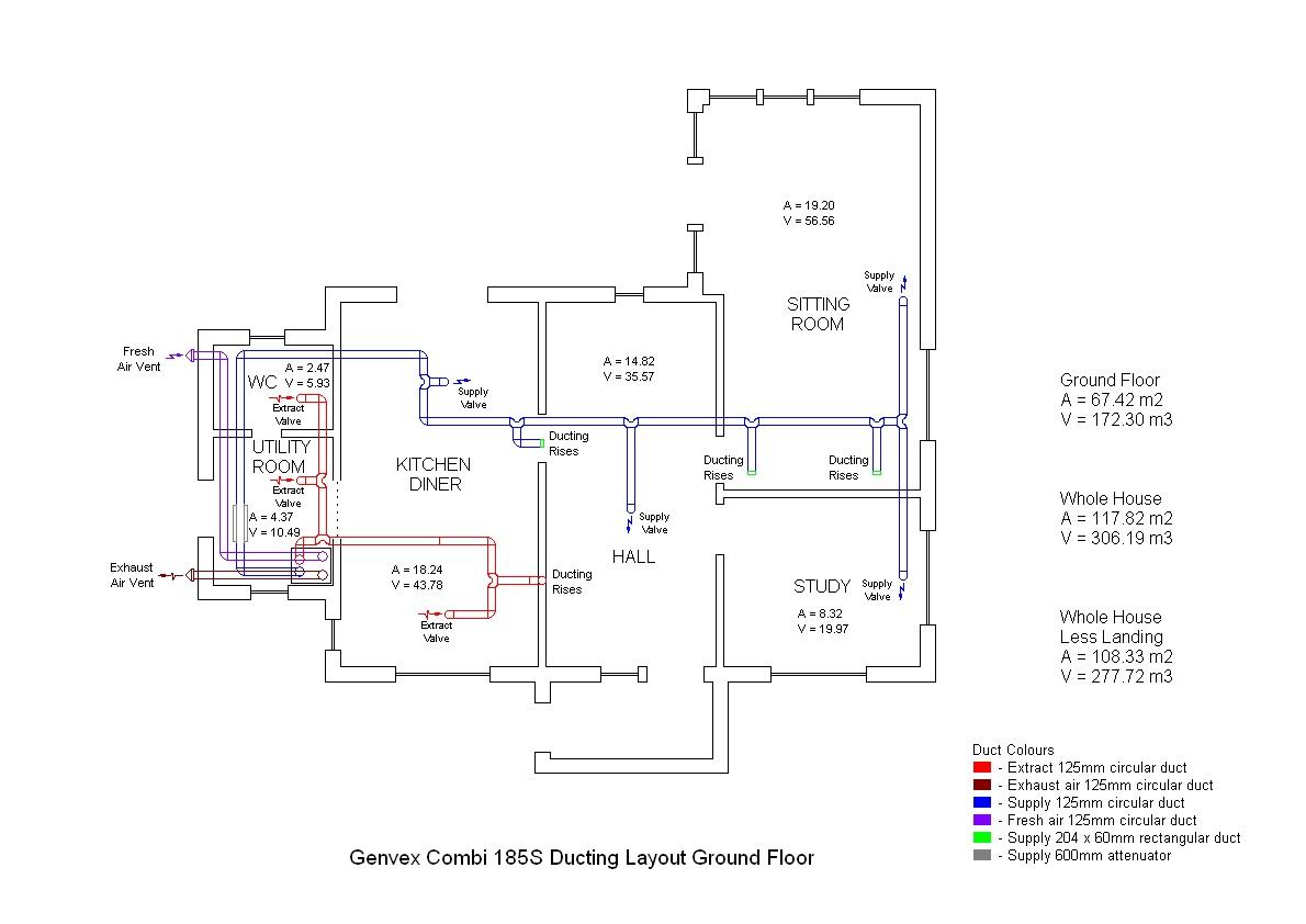

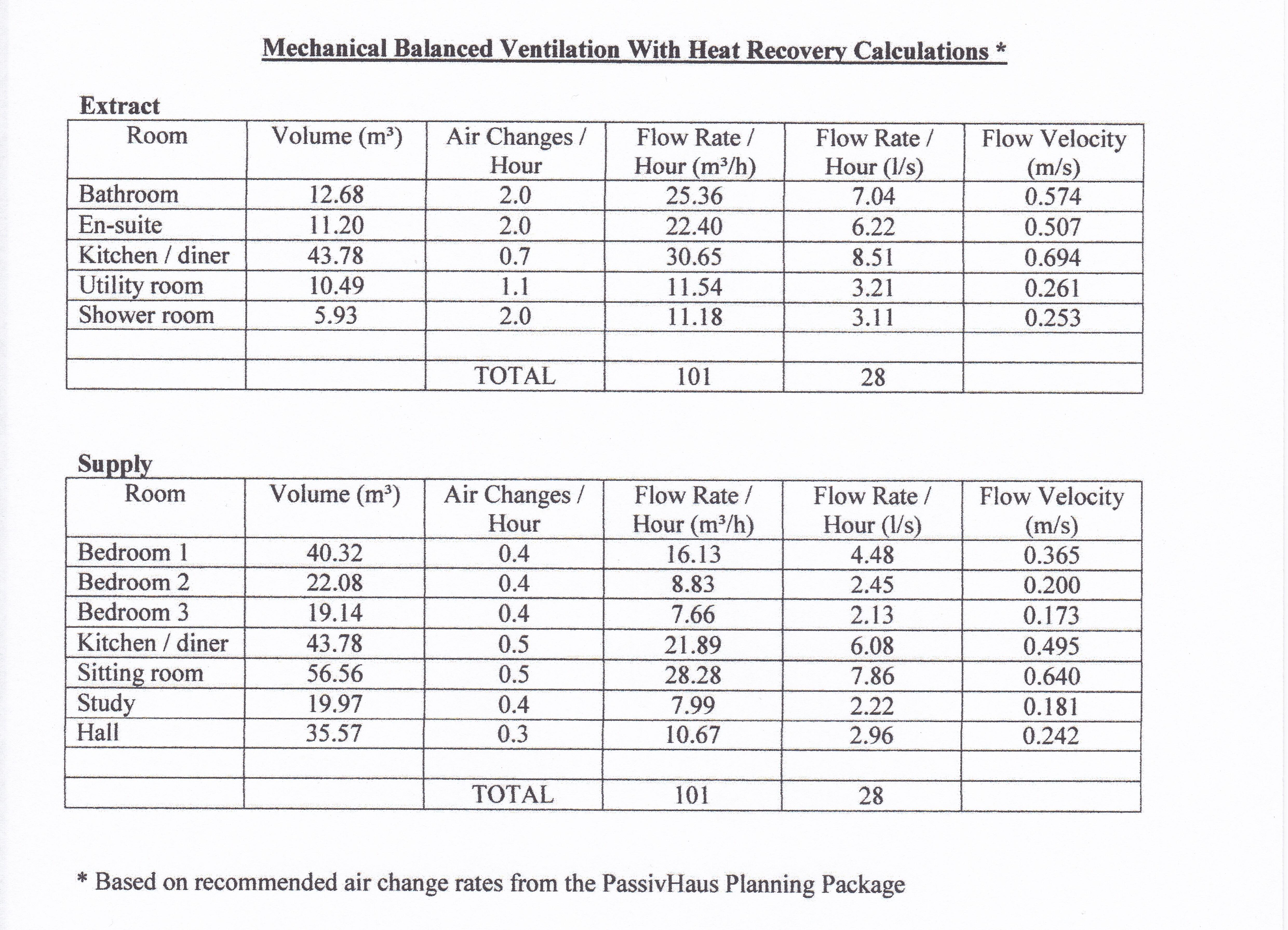

It's pretty straightforward, seems like you've got it mostly sorted. I used 125mm branched ducting in my house changing to 204mm x 60mm for the rooms with vaulted ceilings. After it was all installed I set it up roughly to test it and then bought a Testo 405i anemometer to set it up more accurately.
That’s neat, thanks for that

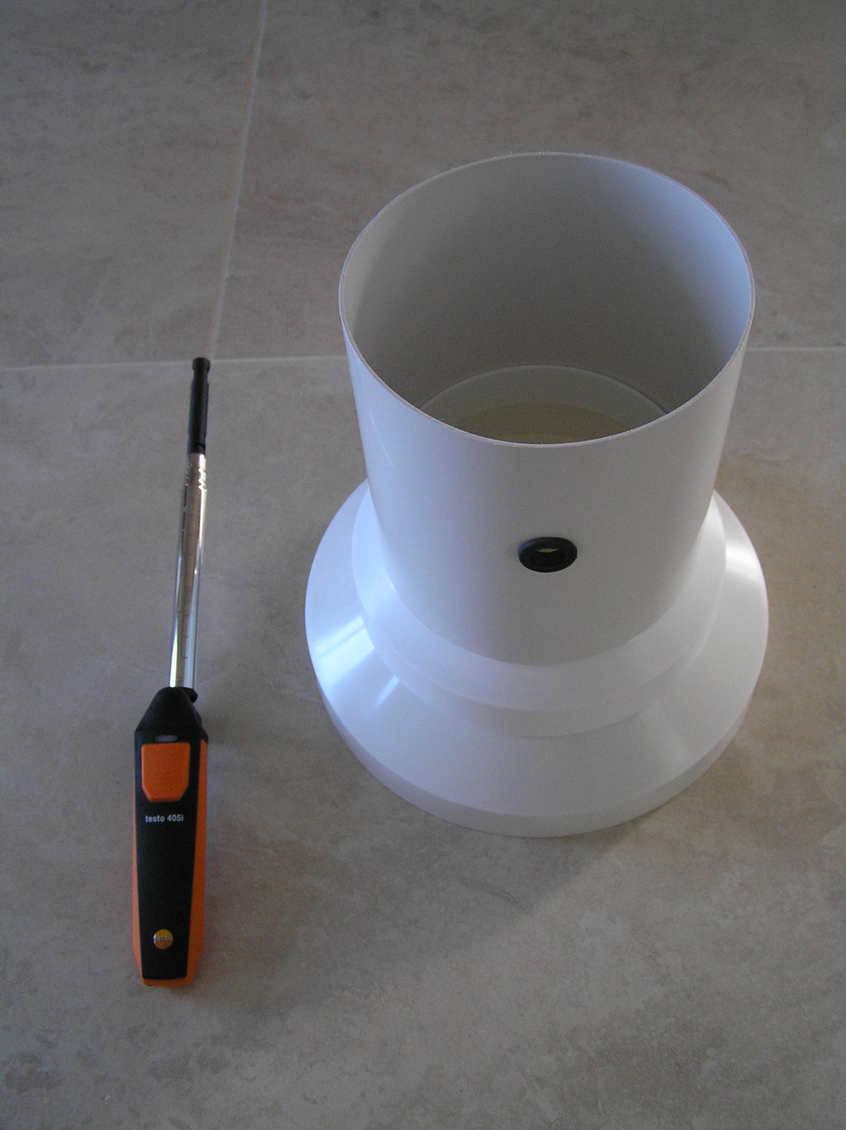

Goes into a duct, I used a Testo 425 (it will read in flow rate also), used a 150 to 125 adapter and some 125mm duct and secured the probe in the center of the duct with a cable gland.

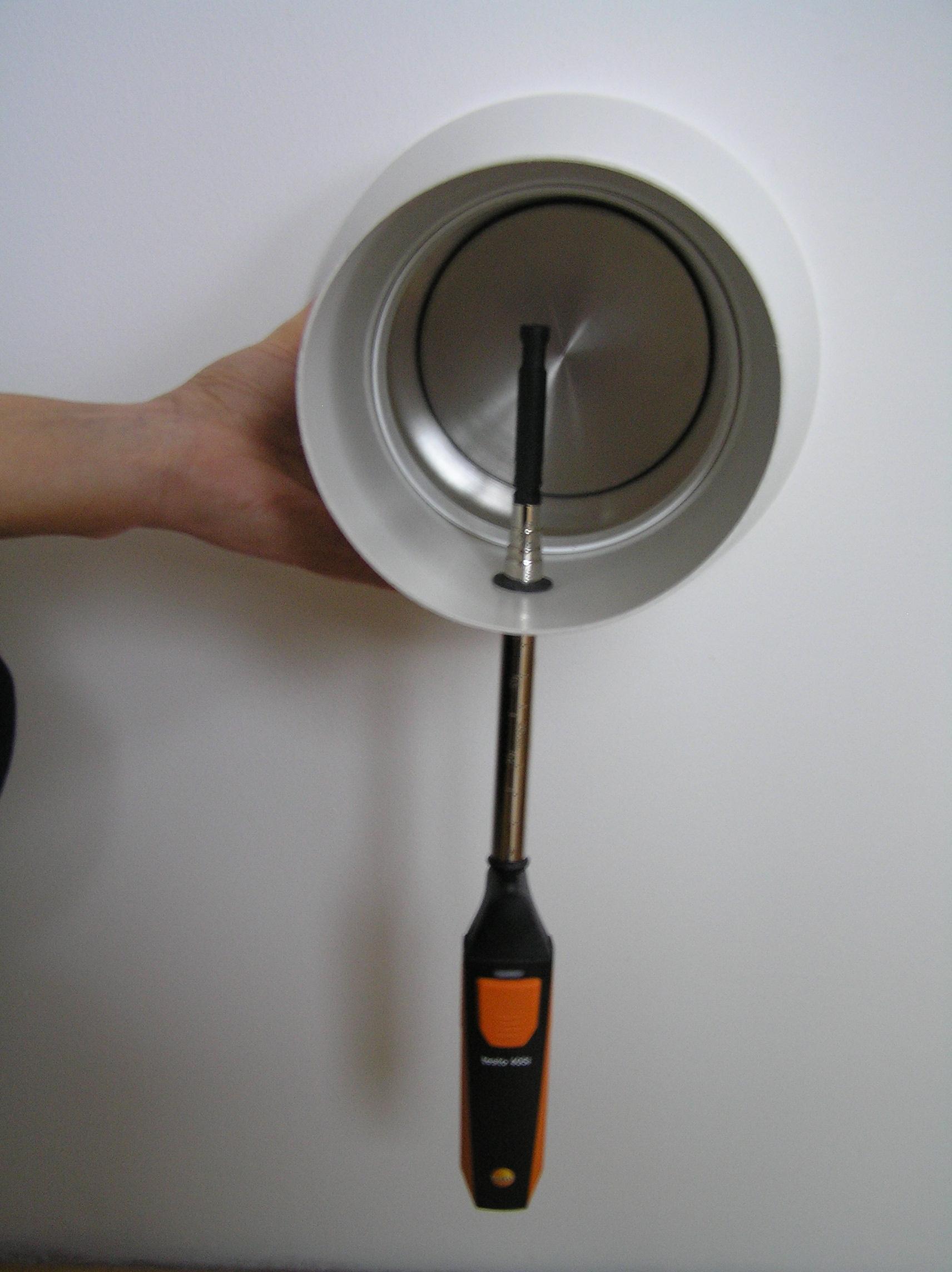

12 hours ago, Deniance said:
I’ve just googled the testo you mentioned , how does that work?
I made a cone to put over the vent and the Testo sends the readings to my phone and I print them out.
Snap.. we used the same set-up
I saw a youtube video on this that I cannot find now, but it is best to use an average, by setting to average and going across the whole cross section.
Also we cut a small hole in the outside inlet and outlet, and tested so we could ensure the whole system was balanced.
