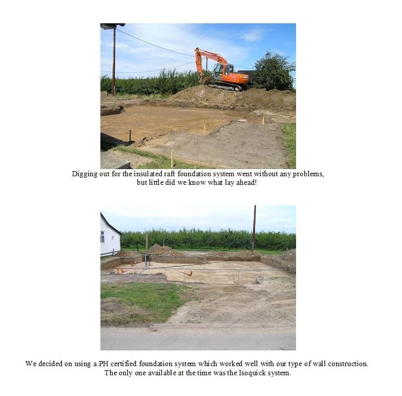

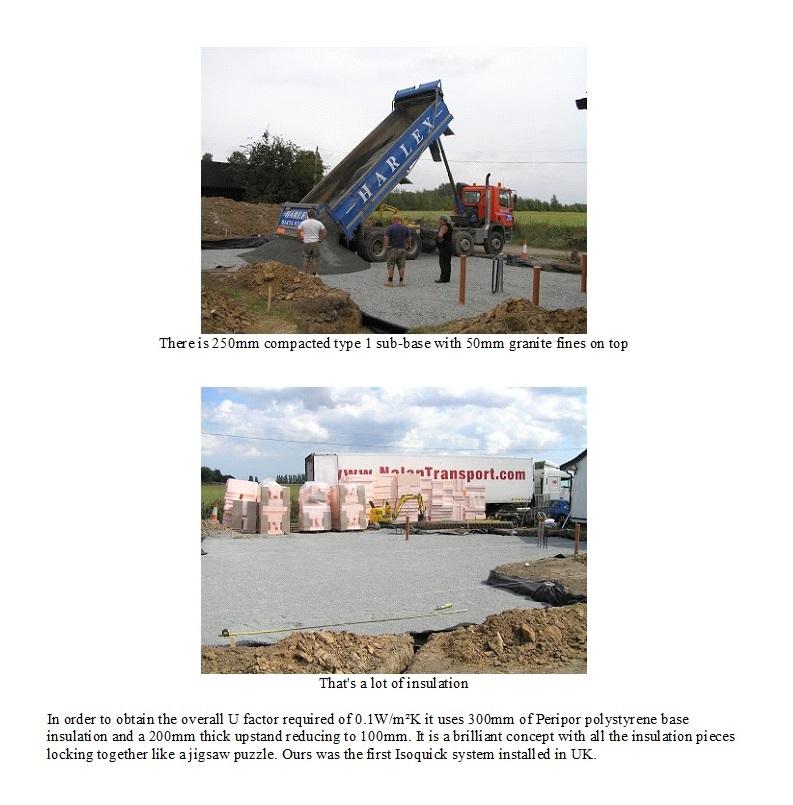

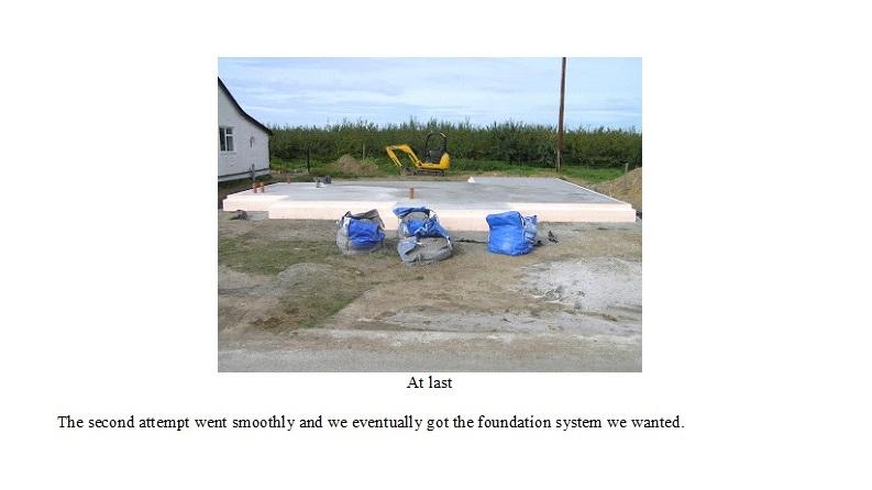

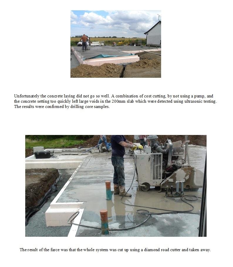

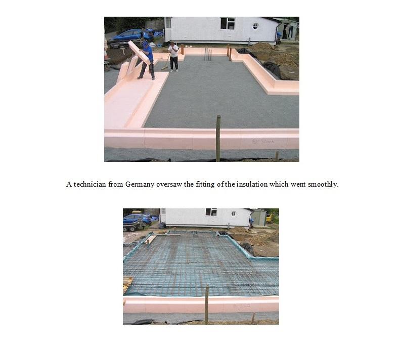

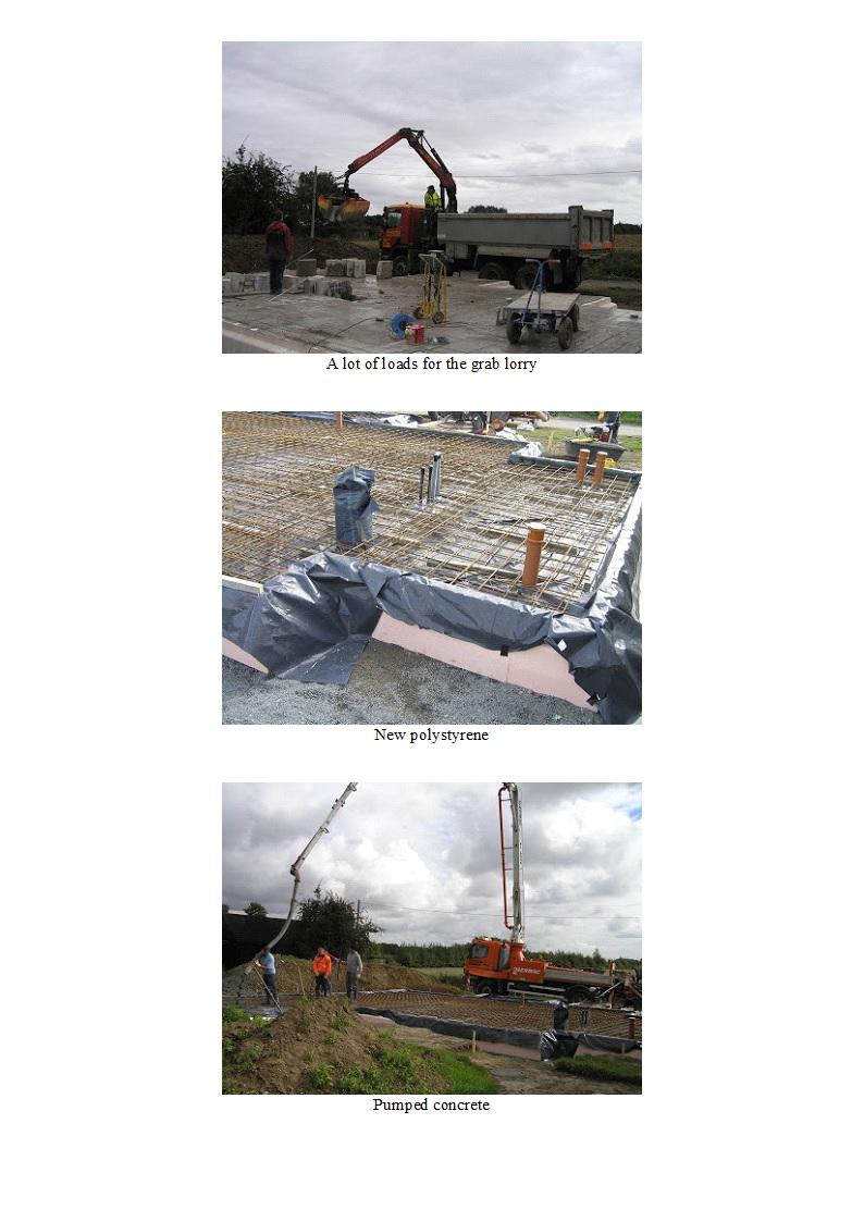

Gone West Posted October 18, 2023 Posted October 18, 2023 On 17/10/2023 at 12:46, saveasteading said: Quality is a huge issue. Even with known and generally trusted groundworkers, they are not as knowledgeable or caring as is desirable. Expand We had the first Isoquick system installed in the UK in 2010. It didn't initially go to plan. We fortunately videoed the whole thing. We had the type1 and fines extending out 750mm beyond the edge of the insulation all the way around the slab. These are entries from my blog at the time. Sorry about the quality of the pictures. 1
gavztheouch Posted October 18, 2023 Author Posted October 18, 2023 Thanks for your post @Gone West That does indeed sound like the nightmare scenario. Did you replace all the isoquick insulation? are you happy with the isoquick system now? I’m thinking about pouring the slab anytime after next week maybe. This includes some cold months. I’ll prob need to wait until it is dry which normally means it will be cold. To get better weather I would need to wait until March at least. Has anyone poured concrete slabs like this in cold weather. Did you take any precautions?
saveasteading Posted October 18, 2023 Posted October 18, 2023 On 18/10/2023 at 08:32, Gone West said: had the type1 and fines extending out 750mm beyond the edge of the insulation Expand I appear to have been confused then, type 1 is near solid rock and not porous like single sized gravel which was my concern. This is sensible.

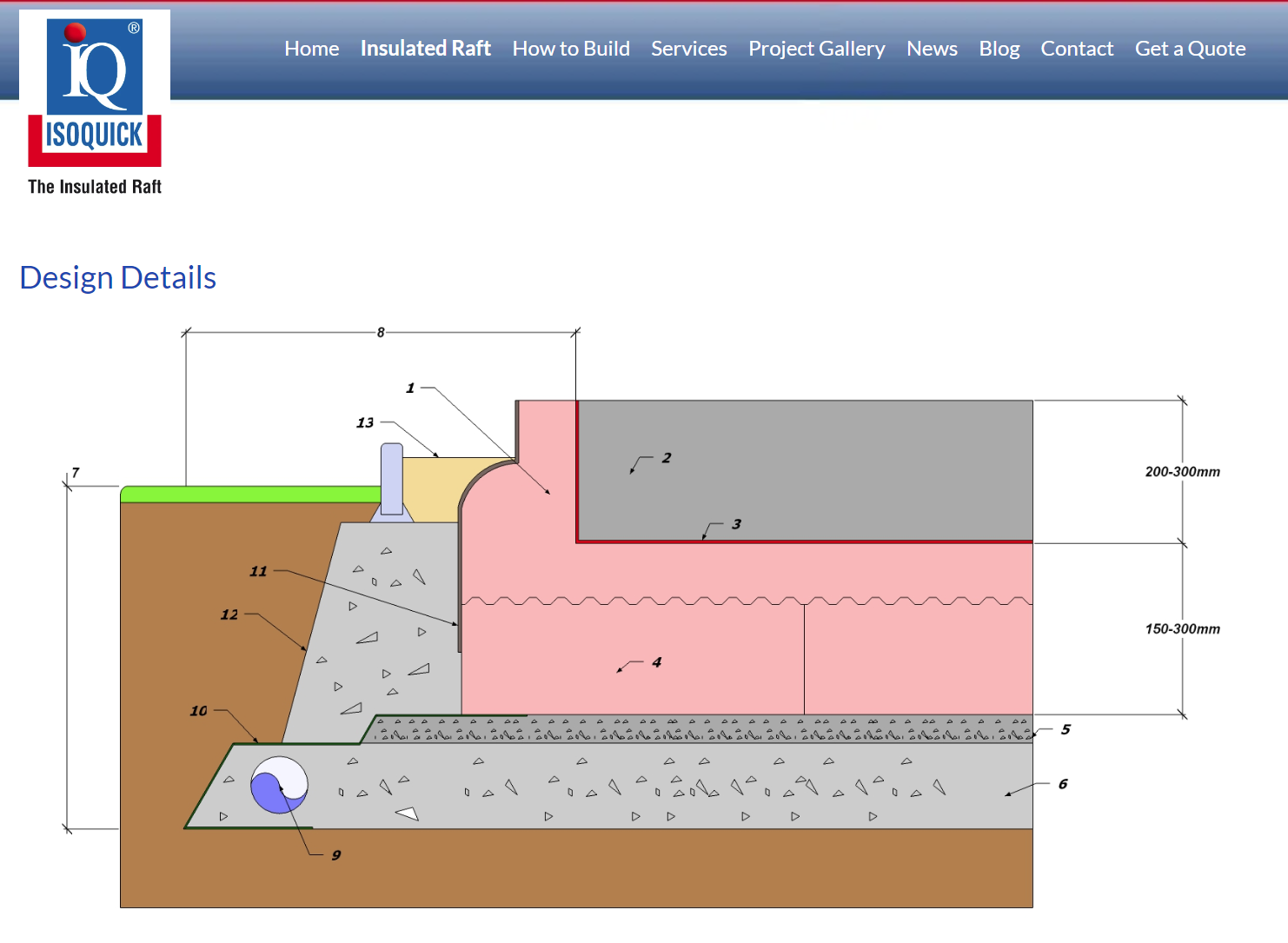

saveasteading Posted October 18, 2023 Posted October 18, 2023 Thanks for the drawing. I see the note. But type1 isn't free draining and it does contain fine particles. It has a formula of stone sizes such that it is as near solid rock as can be. Puddles form on it if well laid. Back to my original point: I would not want water being encouraged to flow under my house, as single sized, free draining gravel, would. I still find this very strange, and can't see why there isn't a polythene dpm. All that aside. You have type 1 so that's perfect. Water won't reach your eps. Even if it did, nothing would happen to it.
saveasteading Posted October 18, 2023 Posted October 18, 2023 Typically this style of design will use between 1/2 and 2/3rds of the concrete that would have been used in strip footings for the same building, That is a bold statement for a system where the slab might be 300mm thick. 1/2 I doubt. 2/3 sounds feasible if the footings in the comparison are mass concrete. It's obv much more complicated than that. I'd love to see that, and reinforcement, calculated. I'm not about to do it. In any case, you were choosing a proven system for control reasons, not cost.
IanR Posted October 18, 2023 Posted October 18, 2023 (edited) Layer 5 isn't Type 1, it's a "no fines" shingle/granite chippings layer and is typical for an insulated raft foundation and is only 30mm - 50mm thick. Layer 6 is more similar to what you refer, although in this case is Type 3. Water is not being encouraged to move under the foundation, it will do that if not mitigated against. Type 1 and Type 3 are porous. On Isoquick the DPM is between EPS and concrete. I assume at ~200mm thick they're not expecting the UFH to be pinned to the EPS, as tied to the mesh would position it closer to the surface. While Isoquick tend to go with a constant ~200mm thick raft, most others reduce this to 100mm thick for the majority and only go to +200mm at the ring beam, saving more concrete and further reducing the dig. Personally, my choice was cost & performance. Edited October 18, 2023 by IanR
saveasteading Posted October 18, 2023 Posted October 18, 2023 I like the others even less in that case. They aren't using the structural raft principle, so are loading the eps more, locally. They will need to be thicker at internal support walls as well as the perimeter. Type 3 is indeed reduced (not zero) fines for a bit of drainage Layer 5 is blinding, for level control. Industry standard is to use sand, but fine stone is much better. 'No fines' again is wierd it can't be laid smoothly to levels, but I guess the eps compresses into the sharp and protruding stones. As long as it works. Excuse me when I mix up the parallel postings above Sometimes type 1, sometimes type 2. I'm happy with either, then dpm, just not with gravel or no fines. And why no dpm on the stone? That escapes me. Perhaps designed for different climates.
IanR Posted October 18, 2023 Posted October 18, 2023 On 18/10/2023 at 14:29, saveasteading said: I like the others even less in that case. They aren't using the structural raft principle, so are loading the eps more, locally. Expand No they're not. The 100mm thick areas are where there are no load bearing walls. Rafts constructed to take high loads everywhere are over-engineered and wasting the client's money. It's an optimised product for cost and performance. No DPM on the Type 1 is to avoid potential damage the DPM. You need the no-fines layer (which is just 30mm - 50mm thick) to stop water from thermally bypassing the EPS, as mentioned previously.
Gone West Posted October 18, 2023 Posted October 18, 2023 On 18/10/2023 at 11:21, gavztheouch said: Thanks for your post @Gone West That does indeed sound like the nightmare scenario. Did you replace all the isoquick insulation? are you happy with the isoquick system now? I’m thinking about pouring the slab anytime after next week maybe. This includes some cold months. I’ll prob need to wait until it is dry which normally means it will be cold. To get better weather I would need to wait until March at least. Has anyone poured concrete slabs like this in cold weather. Did you take any precautions? Expand IIRC all the insulation was replaced. Ours was laid in July 2010 so we had the opposite problem of higher temperatures, we were in Kent. We found the Isoquick system to be fine and it matched our wall construction well.
Gone West Posted October 18, 2023 Posted October 18, 2023 (edited) On 18/10/2023 at 12:24, saveasteading said: I appear to have been confused then, type 1 is near solid rock and not porous like single sized gravel which was my concern. This is sensible. Expand The 50mm layer of 3mm granite gravel just under the EPS should allow drainage if required. I was told the Peripor, which is made of very small granules, was more resistant to water absorption than standard EPS. Edited October 18, 2023 by Gone West changed fines to 3mm gravel

Gone West Posted October 19, 2023 Posted October 19, 2023 (edited) On 18/10/2023 at 16:24, saveasteading said: Was this a package contract for the whole slab to that stage? Ending up at 3x the cost, and the delay. Expand Yes, it was a package contract from laying the type1 to power floating the concrete. We knew we were the first Isoquick installation in the country and so were guinea pigs to a degree, although we did have company technicians on site. We paid a fixed price, and all the extra costs due to the cock ups were covered by the company, who didn't quibble. There was a couple of weeks delay. On 18/10/2023 at 16:24, saveasteading said: Concrete setting too quickly was presumably because they were taking too long to barrow it? Expand Yes, and the fact the concrete was coming from too far away in warm weather. It came down to a good system, being let down by poor UK concrete laying. Edited October 19, 2023 by Gone West grammar 1
