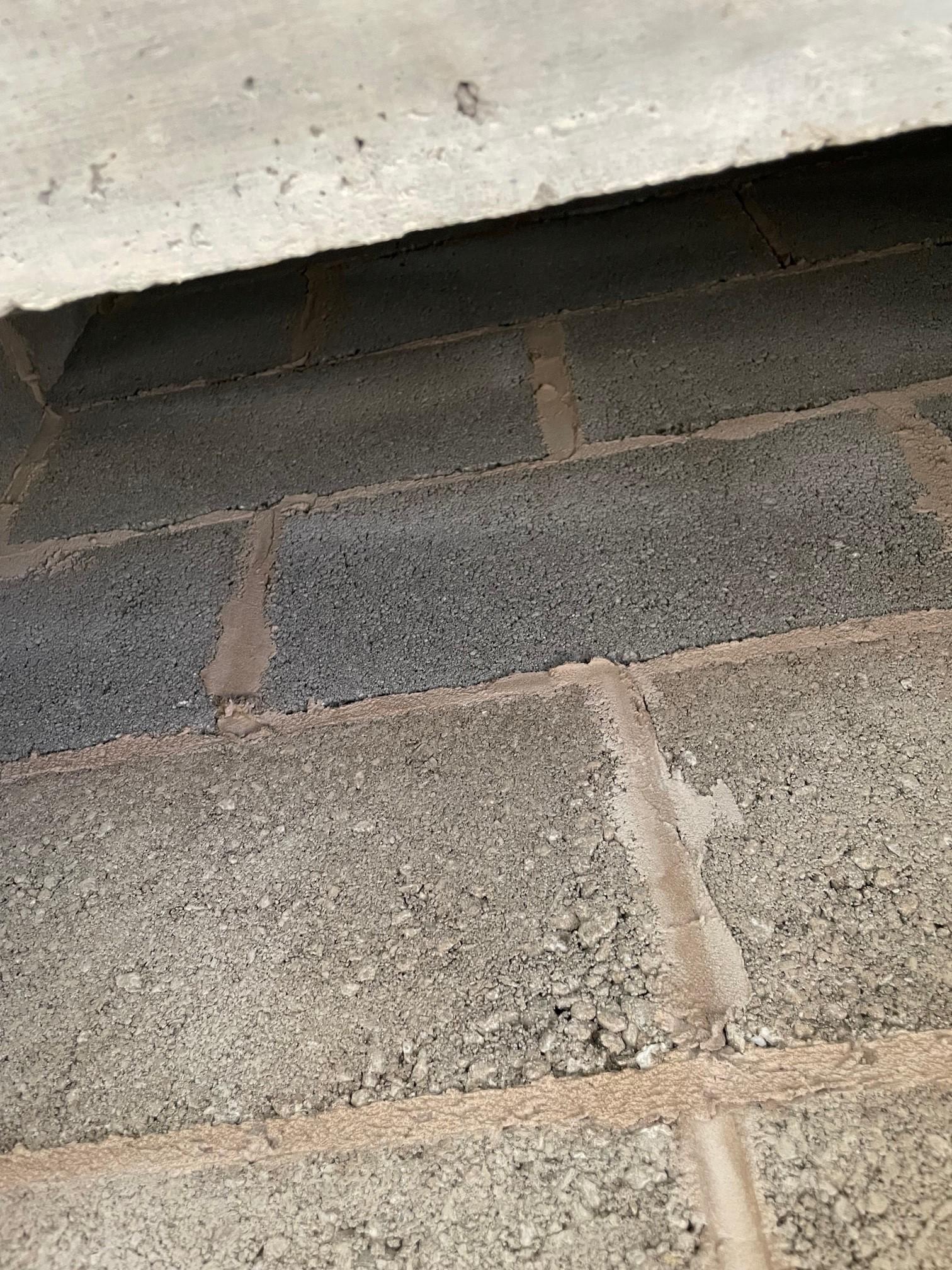

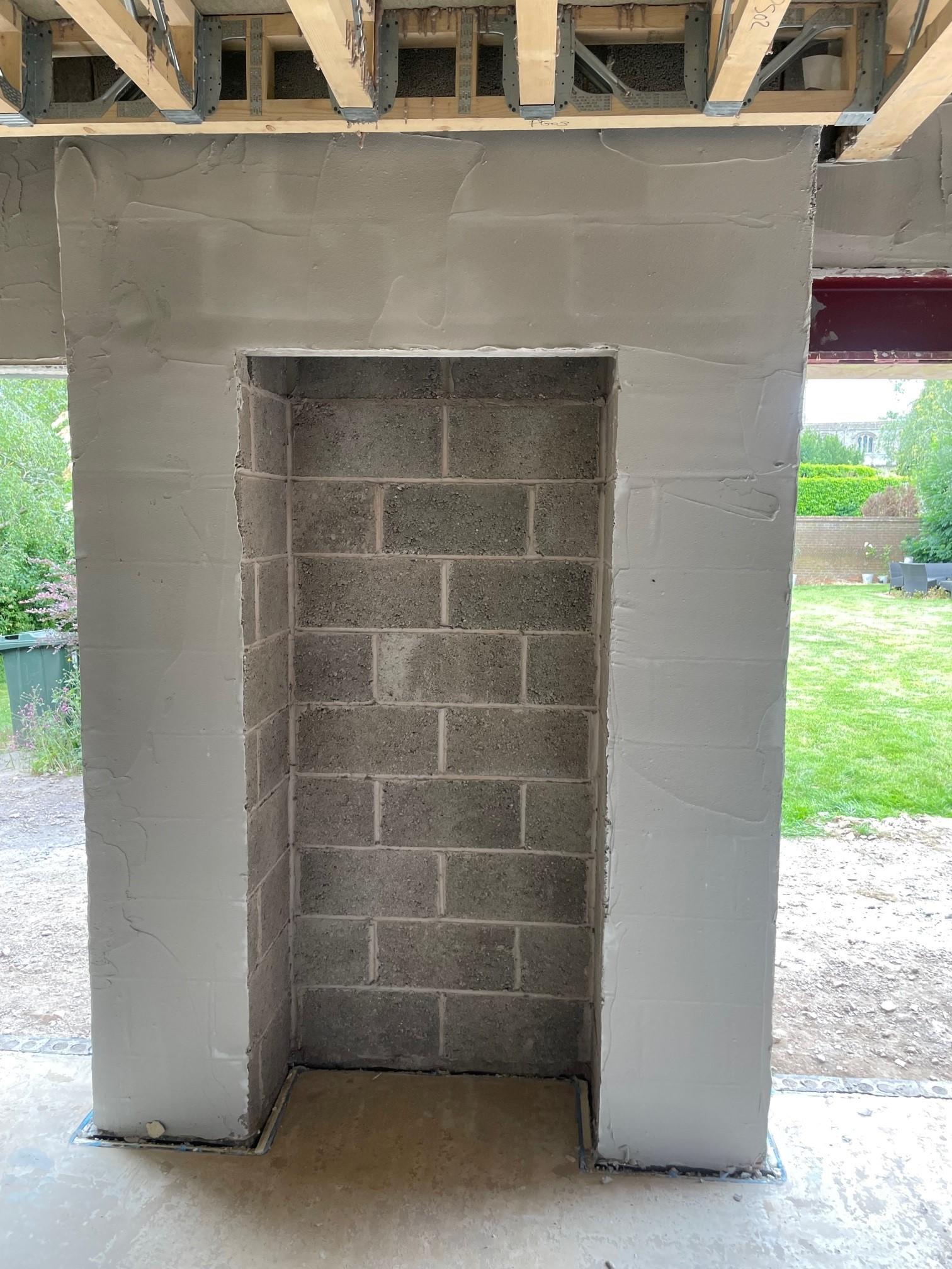

richo106 Posted September 29, 2023 Share Posted September 29, 2023 Hi All We will be installing a log burner at some point (few years down the line at least) but have got a chimney built in preparation etc.. Please see attached photos of it currently As this will not be used for a while what is the best way to 'Seal' just above the visible chimney line in regards to heat insulation and air tightness Also what is best way to finish inside the recess in regards to plasterboard/plastering... is special board required etc.. I amp planning to use air tight paint to seal the block work (have a bit left over) Basically any information that will be useful when completing this section would be very much appreciated Many Thanks Link to comment Share on other sites More sharing options...

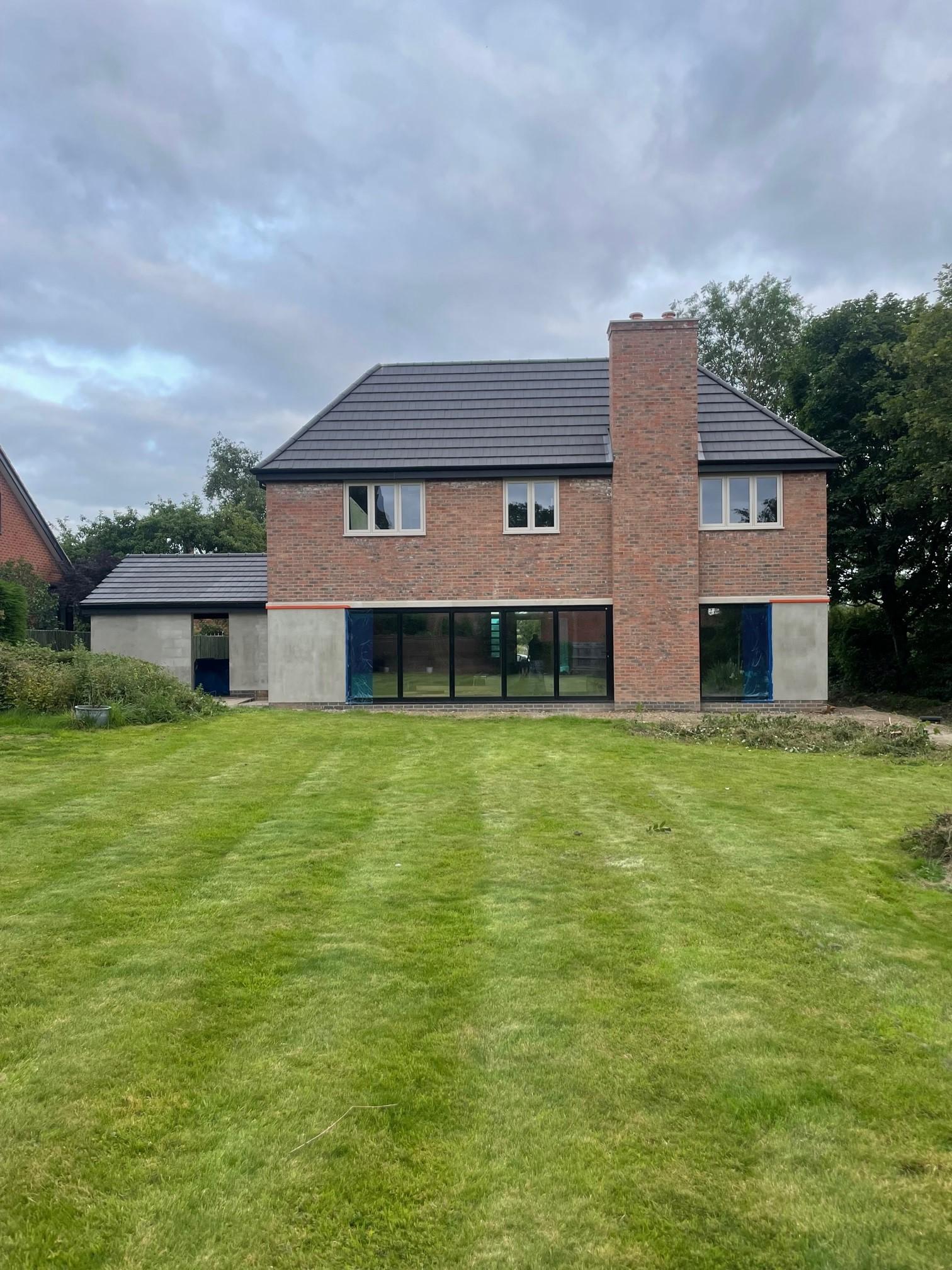

ProDave Posted September 29, 2023 Share Posted September 29, 2023 I am not seeing a "chimney" there (do I need to look harder?) I see the chimney breast formed but I don't see a masonry chimney coming out of the top and up through the roof structure? Link to comment Share on other sites More sharing options...
richo106 Posted September 29, 2023 Author Share Posted September 29, 2023 7 minutes ago, JohnMo said: Not sure a chimney is a wise choice. Ideally with modern well insulated and assuming a reasonable airtightness, the chimney goes against all that. Your log burner, stove, really needs to take primary and secondary air from outside the building, so an air duct will be required, otherwise your are adding air bricks etc. I would assume whatever you have done may not be suitable for a stove, I think you really need to talk with stove installer now rather than later, making changes now is easy, later you are pulling your finished house apart. Yes agree with comment regarding that chimney's are not ideal but we wanted to keep a balance between modern and traditional. It will be taking air from external when installed (through the back) I have attached a picture of the back of the house, there is no liner currently installed just a space for it to go. As you can tell I have never done anything like this before, the air tightness concept was something i decided on after the build had started so trying to make it the best it can be for my build. 2 Link to comment Share on other sites More sharing options...
JohnMo Posted September 29, 2023 Share Posted September 29, 2023 I would talk with a stove installer, get the correct liner installed now and blanked off. Then discuss how to insulate, you may need to fill with vermiculite or similar. Not sure how you get access? Link to comment Share on other sites More sharing options...

richo106 Posted September 29, 2023 Author Share Posted September 29, 2023 I honestly think we won't ever bother doing it but i just wanted to be a little prepared if we were to, can i just use normal plasterboard and plaster or do i need to use cement board and plaster? Regarding the insulation, i have attached a couple of pictures One is a cavity in my chimney, its 100mm cavity with 90mm thermclass The other picture is my original idea in regards to insulating it 'temporarily' I was going to stick a bit 150mm PIR in and Air tight tape the edges to the block Link to comment Share on other sites More sharing options...

richo106 Posted October 1, 2023 Author Share Posted October 1, 2023 Thinking of a floor standing one, but a tall one to suit the opening. Am I ok to dot and dab normal plasterboard on the inside of the breast and then skim? I am guessing I am not so any advice on this would be great Many Thanks 1 Link to comment Share on other sites More sharing options...
