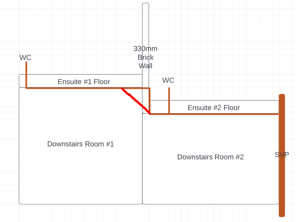

jayc89 Posted September 27, 2023 Share Posted September 27, 2023 We're going to have 2x ensuite's back-to-back, one stepped approx 200mm below the other. The lower void being the nearest to the SVP. I need to figure out the best way for the internal soil pipe to navigate this step down. 2x 90 degree bends might work (not sure if I have the clearance for that within the void), but are two bends and two changes of direction in quick succession suitable? Don't fancy any blockages! Any suggestions? Link to comment Share on other sites More sharing options...
Conor Posted September 27, 2023 Share Posted September 27, 2023 (edited) Use 2x45s and create a void at the juncture between room #1 and room #2 if required. We had to do this but luckily all hidden above kitchen units, just built a bulkhead above right to the ceiling. What's your floor structure and do you have a suspended ceiling for services? Edited September 27, 2023 by Conor Link to comment Share on other sites More sharing options...
jayc89 Posted September 27, 2023 Author Share Posted September 27, 2023 4 minutes ago, Conor said: Use 2x45s and create a void at the juncture between room #1 and room #2 if required. We had to do this but luckily all hidden above kitchen units, just built a bulkhead above right to the ceiling. What's your floor structure and do you have a suspended ceiling for services? Ensuite #1 floor is solid joists, Ensuite #2 floor will likely be pozi joists. In both cases the joists will run the "right" way. I.e. left to right in the diagram. Neither have suspended ceilings below. I could probably box in within ensuite #2 to avoid anything in the rooms below. Link to comment Share on other sites More sharing options...
ProDave Posted September 27, 2023 Share Posted September 27, 2023 If the 330mm brick wall is not built yet, build in an opening, bridged at the top with a lintel, to create a space for the pipe to rise between rooms. Link to comment Share on other sites More sharing options...
jayc89 Posted September 27, 2023 Author Share Posted September 27, 2023 1 minute ago, ProDave said: If the 330mm brick wall is not built yet, build in an opening, bridged at the top with a lintel, to create a space for the pipe to rise between rooms. Unfortunately it's already there. It was once the external wall of the original part of the property, which is probably why the floor is stepped after that, but doesn't really explain it! Link to comment Share on other sites More sharing options...
jayc89 Posted September 27, 2023 Author Share Posted September 27, 2023 Secondary question, do I need any sort of AAV to the left of Ensuite #1, or is the vent on top of the external SVP enough? (The vent is already higher than any new W/C I'll be fitting) Link to comment Share on other sites More sharing options...
