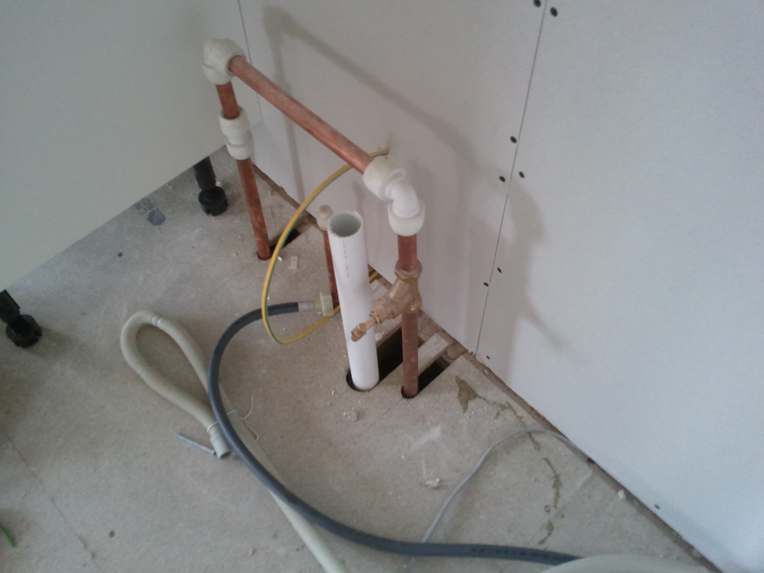

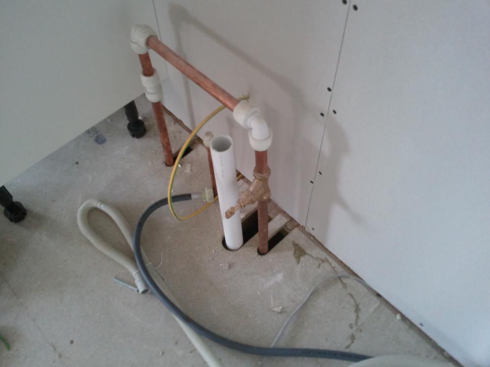

ProDave Posted September 1, 2017 Share Posted September 1, 2017 Don't employ the joiners that are doing the extension I am currently working on. This is a sun room extension and new kitchen on a 1980's bungalow. The joiners took up the kitchen floor because it was sagging and put extra supports under the inadequate sized joists. The original floor had no insulation under it, and it staggered me when they put the new floor down with no insulation and no thought it might be a good idea to put some there. Then this is how they fitted the flooring around the pipes, so not only is the floor not insulated, there's huge gaps for a howling gale to enter. The lack of thought is truly staggering. Link to comment Share on other sites More sharing options...
Barney12 Posted September 1, 2017 Author Share Posted September 1, 2017 1 hour ago, ProDave said: Don't employ the joiners that are doing the extension I am currently working on. This is a sun room extension and new kitchen on a 1980's bungalow. The joiners took up the kitchen floor because it was sagging and put extra supports under the inadequate sized joists. The original floor had no insulation under it, and it staggered me when they put the new floor down with no insulation and no thought it might be a good idea to put some there. Then this is how they fitted the flooring around the pipes, so not only is the floor not insulated, there's huge gaps for a howling gale to enter. The lack of thought is truly staggering. Surely the plumber could have soldered those two 90's and one straight too? Hardly much of a chore? Link to comment Share on other sites More sharing options...
Crofter Posted September 1, 2017 Share Posted September 1, 2017 1 hour ago, Barney12 said: Surely the plumber could have soldered those two 90's and one straight too? Hardly much of a chore? Yes, why would you use copper pipe and plastic fittings? I've actually gone for the opposite- brass compression fittings onto Hep20 pipe. Seemed like the best mix of avoiding joins and having small enough fittings to fit into my 25mm service void. Although I think I'm going to manage to arrange it so that all of the fittings are accessible anyway, with nothing boxed away behind the PB. Link to comment Share on other sites More sharing options...
PeterW Posted September 1, 2017 Share Posted September 1, 2017 Copper and plastic fittings is fine - nothing wrong with it but it's not pretty .... I do wonder looking at that if they are temporary - odd way to pipe something up from a stopcock. Link to comment Share on other sites More sharing options...
ProDave Posted September 1, 2017 Share Posted September 1, 2017 1 hour ago, Barney12 said: Surely the plumber could have soldered those two 90's and one straight too? Hardly much of a chore? That's just temporary until the sink unit is in and he comes back to plumb the sink. Probably just a temporary loop to ensure the rest of the house gets some water. The plumber doing it doesn't solder any more. He has one of those very expensive copper pipe crimp tools. Link to comment Share on other sites More sharing options...
PeterW Posted September 1, 2017 Share Posted September 1, 2017 13 minutes ago, ProDave said: He has one of those very expensive copper pipe crimp tools. They aren't too expensive when you buy the Wavin system as if you talk to the rep you can get about £300 off the tools when you buy £300 of fittings. I don't do enough to warrant getting one as I can't use that many fittings on this build ..! I also don't like the idea of not being able to demount the fittings in future without having to put new pieces of pipe in. Link to comment Share on other sites More sharing options...
