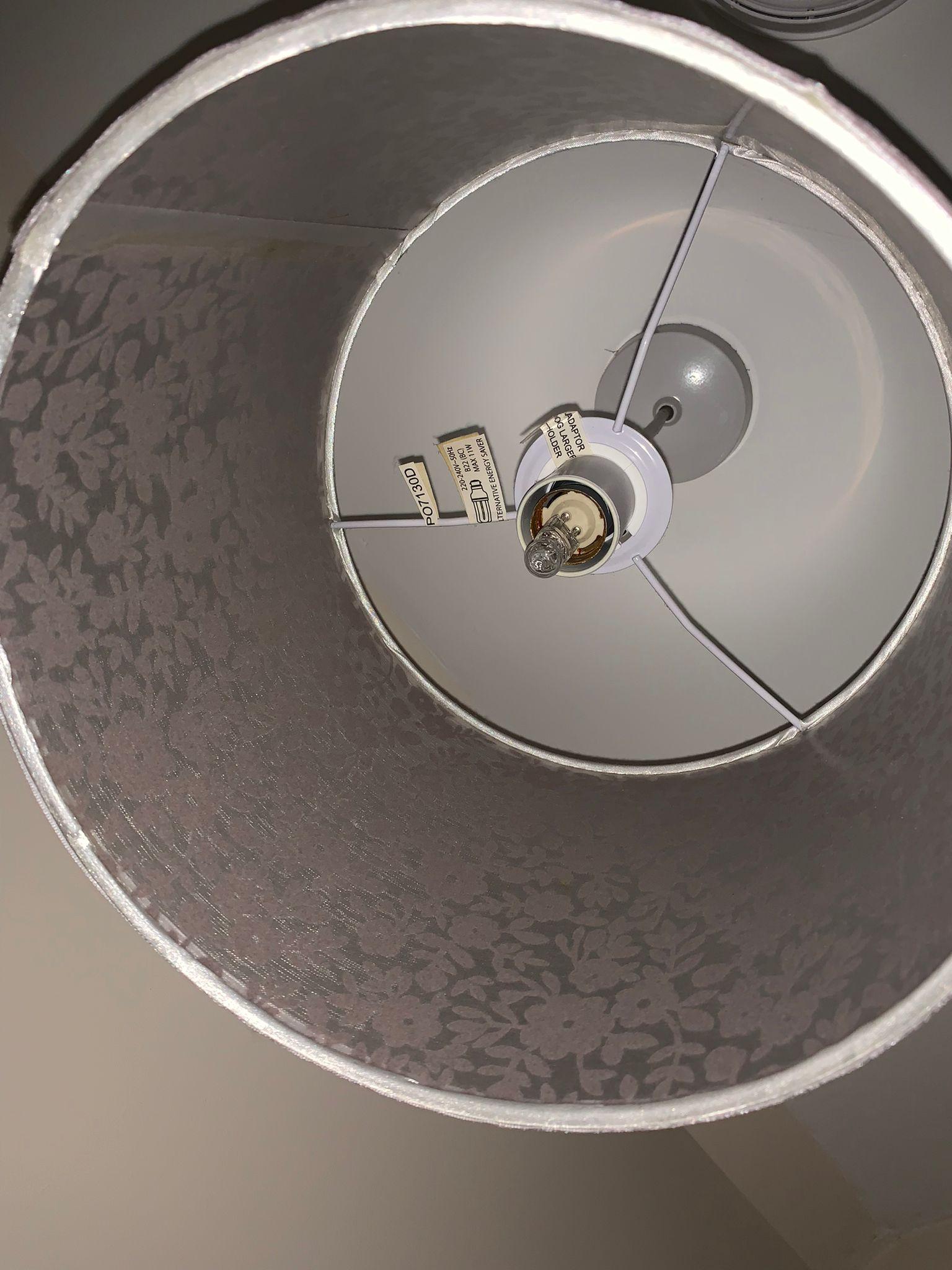

Pocster Posted September 19, 2023 Posted September 19, 2023 Can’t get to tenant . Bulb blown - but I don’t understand what’s going on here . I can see a b22 fitting but the bulb has no cover ? ( I.e glass covering gone ) This make sense to anyone ?
Mattg4321 Posted September 19, 2023 Posted September 19, 2023 Yeah the glass has fallen off or been smashed off. Just needs a new bulb and possibly a pair of pliers to remove the old one. 1 1
Pocster Posted September 19, 2023 Author Posted September 19, 2023 31 minutes ago, Mattg4321 said: Yeah the glass has fallen off or been smashed off. Just needs a new bulb and possibly a pair of pliers to remove the old one. Yeah - that’s what I thought . Tenant claimed no glass anywhere though 🙄🙄🙄🙄🙄🙄
FuerteStu Posted September 19, 2023 Posted September 19, 2023 33 minutes ago, Mattg4321 said: Yeah the glass has fallen off or been smashed off. Just needs a new bulb and possibly a pair of pliers to remove the old one. If you use pliers, And it's live, it goes boom. If you stuff in a potato and twist, it's safe and you don't cut your fingers, or damage the lamp holder 1
Pocster Posted September 19, 2023 Author Posted September 19, 2023 34 minutes ago, FuerteStu said: If you use pliers, And it's live, it goes boom. If you stuff in a potato and twist, it's safe and you don't cut your fingers, or damage the lamp holder Tenant with pliers or tenant with potato - either way feels like an accident 🫤🤣
Temp Posted September 19, 2023 Posted September 19, 2023 Sure looks like one of those "halogen bulbs inside a regular bulb" but with the regular glass bulb missing. Might have been like that for ages as it will work without the outer glass. 1
Pocster Posted September 19, 2023 Author Posted September 19, 2023 8 minutes ago, Temp said: Sure looks like one of those "halogen bulbs inside a regular bulb" but with the regular glass bulb missing. Might have been like that for ages as it will work without the outer glass. Ah ; I assumed it was recent I.e it wouldn’t work without the bulb . Probably got broke during some extreme sex and alcohol party I wasn’t invited to 😞
