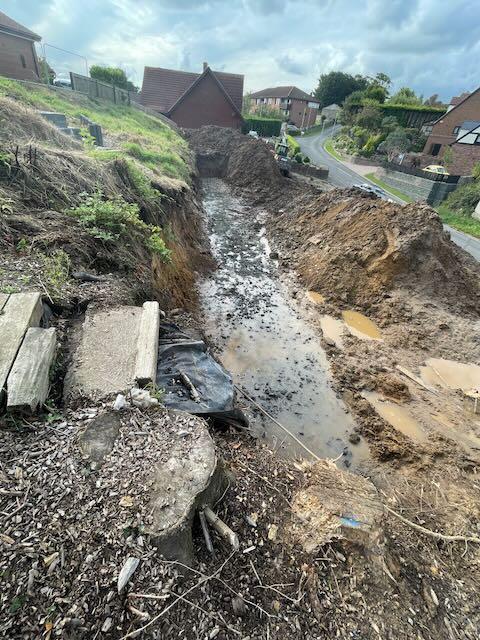

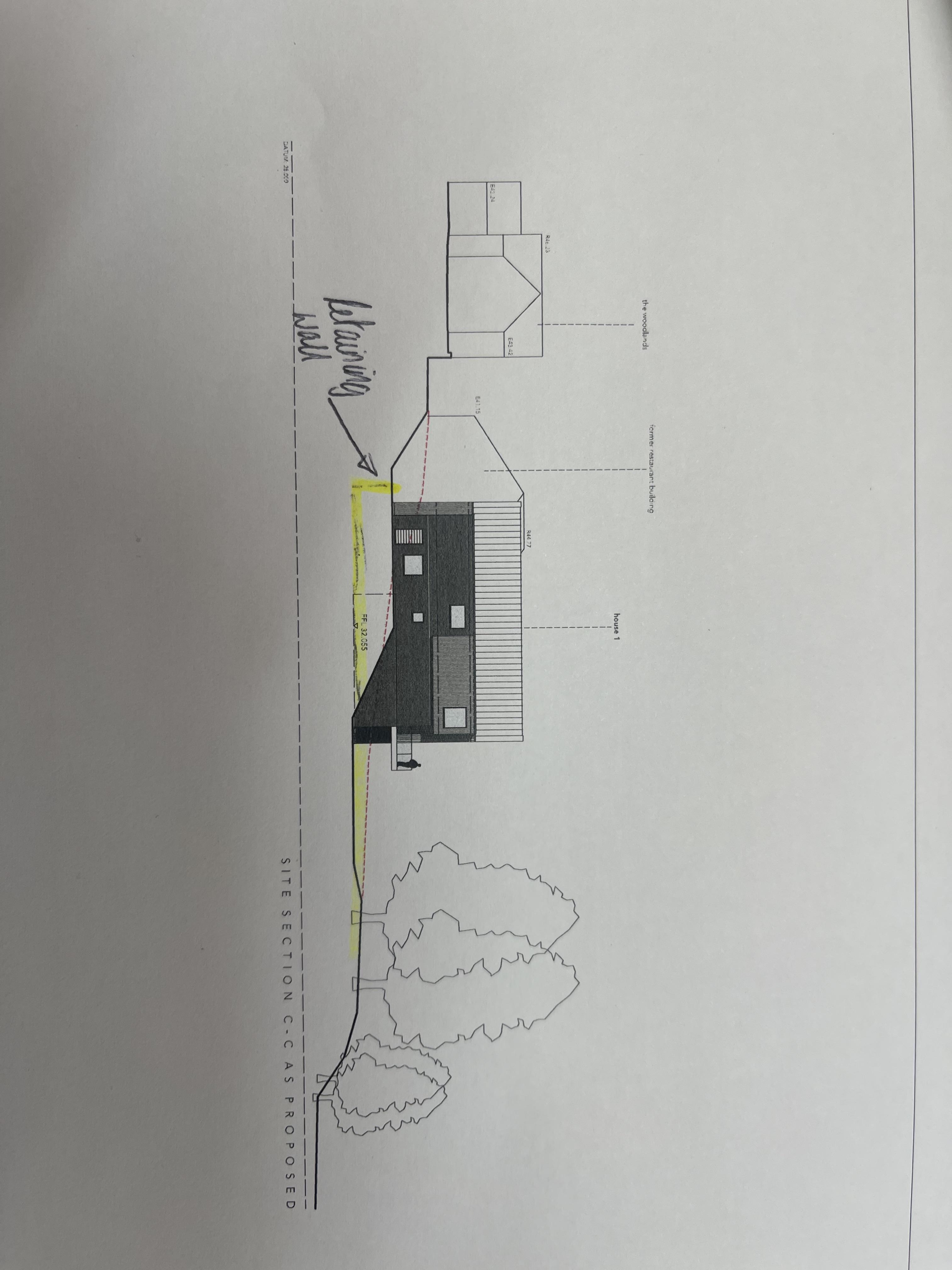

Hi All, been lurking in the background having planning permission for the next build. We're now starting to move the soil ready to build a retaining wall, which brings me to the first question. I've had a SE design the retaining wall, and several people I have spoken to believe this to be overkill from experience. I know a few basements/hillside builds have been done on here so looking for a some inputs or maybe a suggestion for a good SE so I can get a second opinion (for reference the retaining wall will be separate to the house structure). My quick calculations put me at 2.5m3 if concrete per linear meter of wall, and circa 3.5m of wall heel that I would have to dig out and then backfill. It had been suggested to me that a multiple thickness of gabion baskets might be an alternative option (which would be both cost saving and far easier to install).

No, I think they are reasonable for their heights. Our 2.4m high wall has a 1700mm toe and 1200mm heel, all 200mm thick with two layers of reinforcement.
If they were part of the building structure, where the ground slab and other corrected walls, your concrete would be reduced by about half. But building abasement comes with other Complications and costs.

Yes, gabion is currently what I am looking to explore just to see if it is viable and more cost effective. I have looked into sheet piled steel but that was way way over the concrete/rebar route (even if much simpler to install) For both properties it's circa 100 linear meters of wall required so not insignificant. On the plus side, once this is sorted the build becomes more straightforward.

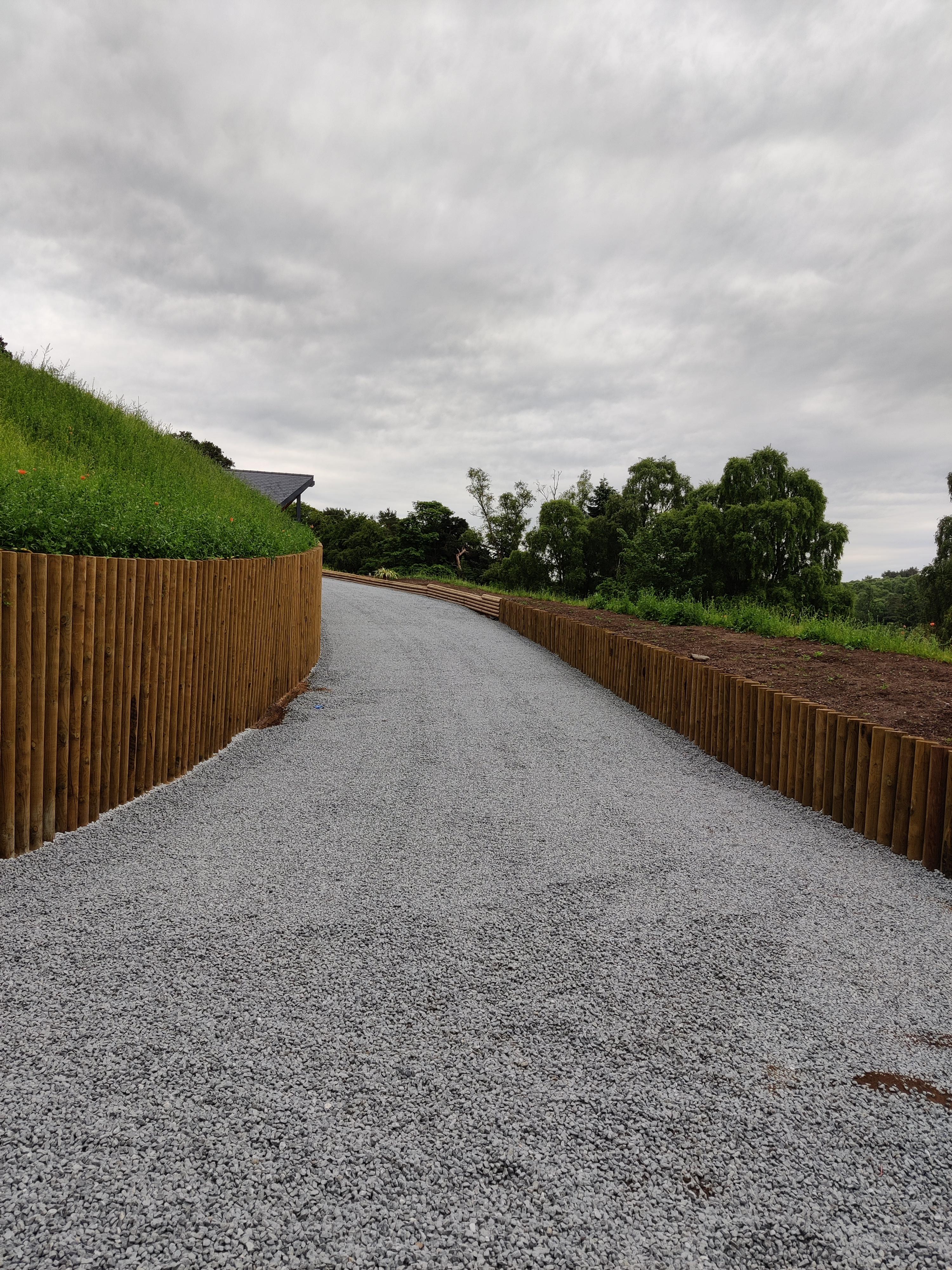

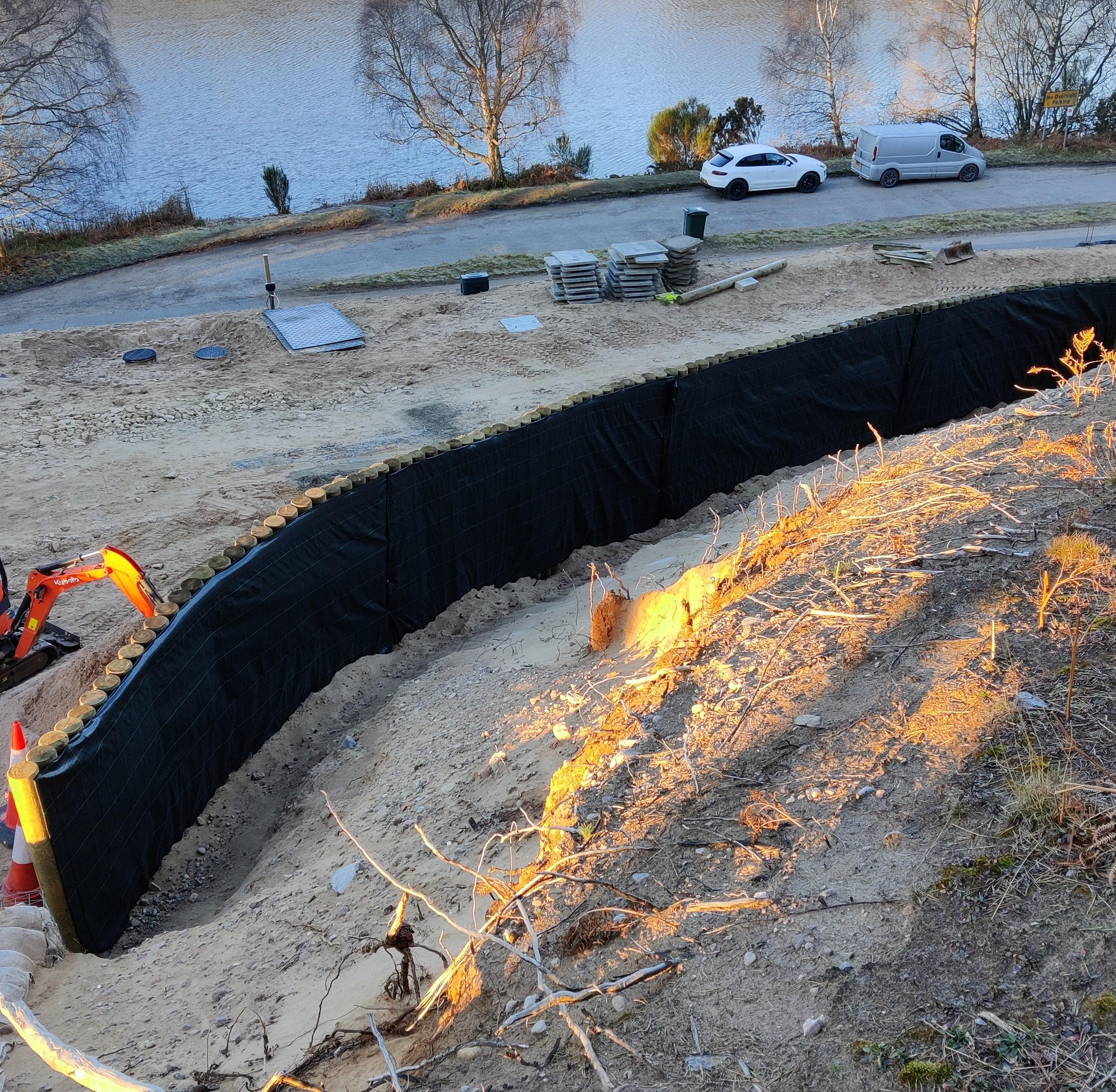

We used wood strangers, basically 240mm dia by 4m long wooden posts. Dig trench circa 1.5m deep, concrete in posts.

You'll need to factor in the additional cost for excavation / muck away if using gabions. At the base they could be 3-4m deep. That's a lot of digging.

@JohnMoYou’ve posted a picture of your retaining wall before. It’s really nice and I’m likely to do something similar. My concern with wooden posts concreted in is the likelihood of them rotting just above ground level. Have you done anything to mitigate that?

They are pressure treated. They guy that did the work said he did one 20 years ago and it's still ok. The odd post has been replaced. But on our side the bank is free draining sand, so water doesn't sit for long if at all, with a layer of top soil on the top.
