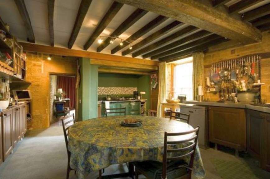

Ferdinand Posted August 29, 2017 Posted August 29, 2017 (edited) We had an Electric Aga (vintage perhaps 1998). Big one - 2 oven traditional electric ovens in the 'storage heater' but, with an add on with 2 more ovens and with an add on with 2 more ovens and a propane gas hob. Cost something like 14-15k (fitted !). Running costs were ££ but we were off mains gas and annual energy etc bills were the best part of £3-4k anyway in 2010 even being economical - the AGA was probably £600 of that. Was a 500sqm house going back up to 400 years. The traditional AGA ovens work well for some things that are surprising, such as using cast iron pans on the oven floor (far cleaner for a fried breakfast since all the splatter self-cleans off the oven wall rather than landing in your kitchen). They do a 3-pin plugin version. I can see an Aga working well with PV solar if your house needs the heat. I do not think we had *any* vent pipes or cooker hoods. Just a stonking iron sheet blocking off the old chimney above. Incidentally, the beam directly above the front of the Aga is made of fibreglass - cosmetic covering for a steel. Ferdinand Edited August 29, 2017 by Ferdinand
