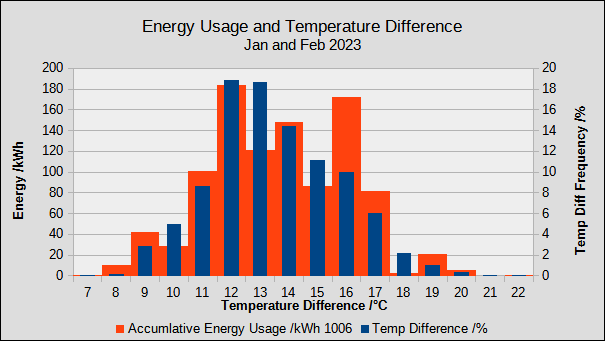

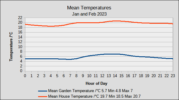

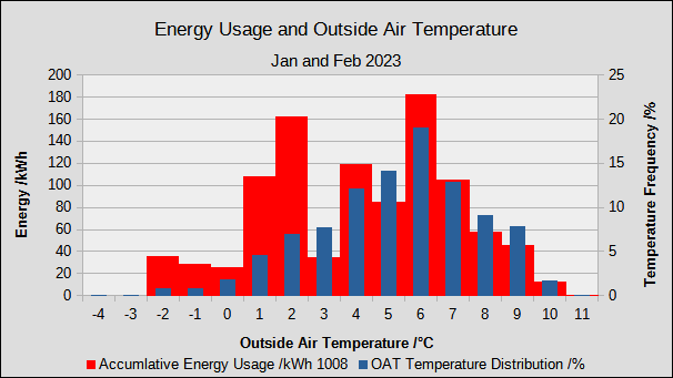

SteamyTea Posted August 31, 2023 Share Posted August 31, 2023 As we are approaching the heating seasons after one of the most miserable Augusts in recent years, and spurred on by a few comments about when it is best to run a heat pump i.e. night time on the cheap, day time on the not so cheap, I thought I would have a look at my energy and temperature data for last January and February. These are two months when I know my heating is always on as if the mean outside air temperature goes above 9°C, I can turn my heating off, and that usually happens sometime in March down here. I also do not have a heat pump, but that does not make any difference to the house heat load, it just changes the magnitude of what is used. I am though, on Economy 7, which I have modified to Economy 4, even though I usually have all my usage in a 3 hour period from 3 AM to 6 PM, with the occasional on/off for the final hour as the DHW cylinder settles out. Being all electric means that it is very easy to monitor what is happening and when, which I do at the 1 Wh level. This first chart is to just give some context as to the house and outside air temperature. It is not greatly transferable as different houses will be at different temperatures, and local weather, mainly sunshine hours, can make a big difference. But it is useful as it shows the variations in temperatures over the period monitored. It is worth remembering that I have averaged the many thousands of readings down to hourly readings, and the mean, min and max temperatures shown on the chart are taken from the time period analysis rather than the base data, so the real minimum will be a little lower, and the maximum a little higher, but over an hour, they will be right. This next chart, to me, is much more interesting as it shows how often things happen and the magnitude of the events. Really cold times, -3°C and up to 0°C only happened for a total of 24 hours (1.7% of the time). These where probably the two frosty mornings I had (Cornwall is mild, but I am at 200 m altitude and 4.1 kM from the sea). So these times are rare events. Even 0°C up to 5°C is only 470 hours out of the 1410 hours (33%) of the period monitored. The bulk of the time is therefore 5°C and over, 916 hours (65%). Looking at the mean energy usage during those times, -3°C up to 0°C my house used 64.3 kWh, 0°C up to 5°C was 452 kWh and above that 491 kWh. The total for the period was 1008 kWh. Taking the temperatures below 5°C, 35% of the time, the energy usage was 517 kWh, near enough half of the total energy used. The very extreme low temperature though of -3°, only lasted 2 hours and used 0.1 kWh. I am not sure, without looking at the two 'heaviest' times when the OAT is 1°C and 2°C why the usage is disproportionately higher. The most likely reason was that I was away 'up country' just before and this is the house and DHW reheating (I turn the water off and the heating right down when away for more than a night). I think it does show that there may be some merit in using an ASHP during the day if you can store the energy in water or a concrete slab. This will depend on what the price difference between time of use tariffs and a standard tariff is. I currently pay 40.86p/kWh for day rate and 15.05p/kWh night rate before VAT. 7% of my usage was during the day (68 kWh for Jan and Feb), that works out at £28. Pretty low for two winter months. Link to comment Share on other sites More sharing options...

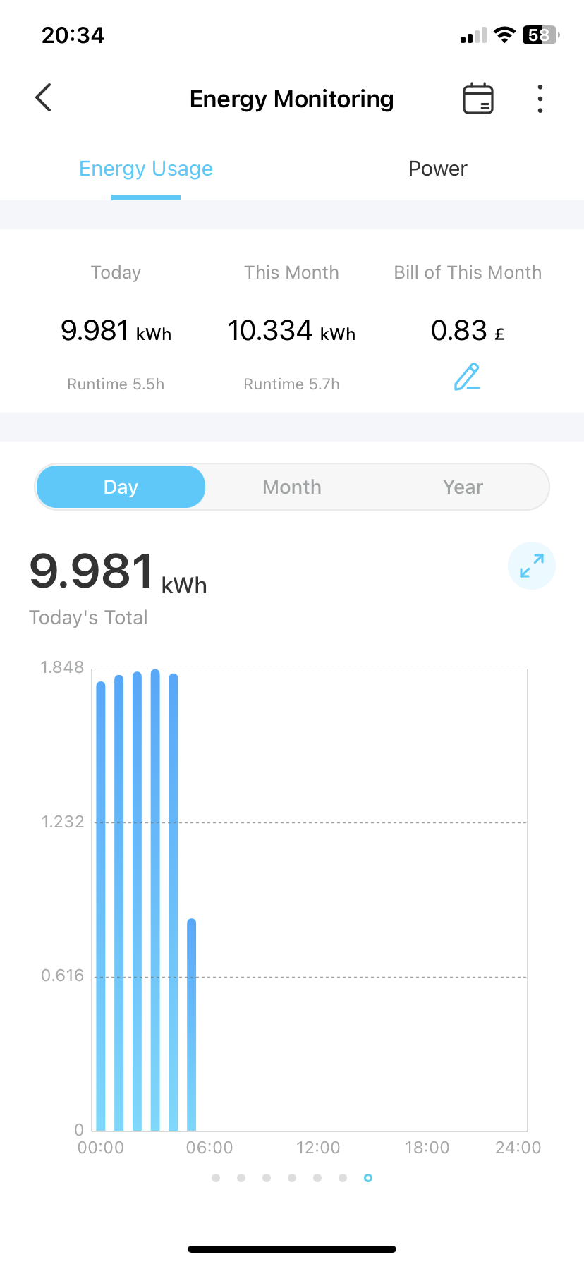

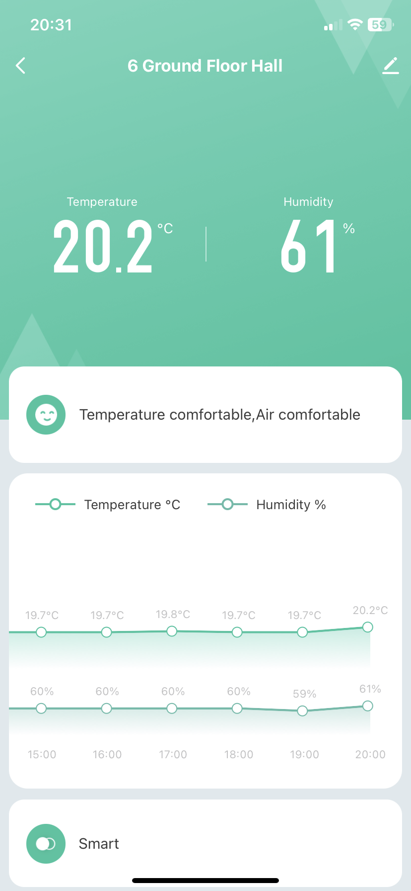

TonyT Posted August 31, 2023 Share Posted August 31, 2023 My day rate is just shy off 4 times more expensive than the night tariff, so a no brainer for charging the EV, storage heaters etc.. dishwasher Hall Storage heater used 9.981kWh last night for the first time in months Hall temps looking ok. Link to comment Share on other sites More sharing options...

SteamyTea Posted August 31, 2023 Author Share Posted August 31, 2023 @TonyT It is still August, why is your heater on? My whole house is heated on about 12 kWh/day when it is the coldest time if year. Link to comment Share on other sites More sharing options...
TonyT Posted August 31, 2023 Share Posted August 31, 2023 Remember everyone has different temps they like to heat their homes too and different size of homes so no point in comparing what you use against my consumption. it’s the first time the heating has been on in months Link to comment Share on other sites More sharing options...
SteamyTea Posted August 31, 2023 Author Share Posted August 31, 2023 1 hour ago, TonyT said: Remember everyone has different temps they like to heat their homes too and different size of homes so no point in comparing what you use against my consumption Why on the face of this it may seem to make sense, you and I probably heat our houses to similar temperatures, and out OATs are probably quite similar, maybe shifted along the x-axis a °C or 3. To put some more light on the matter I have looked at energy use and temperature difference (house temp minus outside temp). Like the previous energy chart, the bulk of the energy usage is in the middle. From Δ12°C to Δ17°C, there is 73% of the total heat load, 712 kWh. Δ17°C to Δ22°C, the coldest periods, 10% of the heat load is used, 112 kWh. The warmest part, Δ8°C to Δ12°C, which accounts for 17% of the time, is 366 kWh This may seem odd that more energy is used to heat the house when it is warmer, but as I said above, it is probably accounted for by being away for a few days. DHW usage will also skew the figures a bit, but they are pretty constant at 3 kWh/day, so about 120 kWh for the period. Another thing that may skew the figures is the amount of winter sunshine and the associated clear nights that cause a larger variation in temperature range, even if the mean temperature is the same. Link to comment Share on other sites More sharing options...
TonyT Posted August 31, 2023 Share Posted August 31, 2023 I like the storage heater as it’s still pushing the heat out now, after the power was switched off at 05:30 am this morning and the temperature at the front vent is 53deg C at 11 pm. Tomorrow will be interesting as last night was heated from cold, so interested to see energy consumption for a consecutive night Link to comment Share on other sites More sharing options...
SteamyTea Posted August 31, 2023 Author Share Posted August 31, 2023 4 minutes ago, TonyT said: Tomorrow will be interesting as last night was heated from cold, so interested to see energy consumption for a consecutive night Mine generally take a couple of nights to get up to temperature, but then I do limit the hours they can charge to the last 4 hours of the E7 window. This reduces the amount of standing losses during the early morning when the temperature does not need to be so high. Do you have fancy fan assisted smart storage heaters, or dumb, government issue Credit ones like mine. Link to comment Share on other sites More sharing options...
TonyT Posted August 31, 2023 Share Posted August 31, 2023 Dumb creda units. 2x2 brick wide units 1x1 single wide units Think each element is 850 watt controlled via a smart energy plug Link to comment Share on other sites More sharing options...

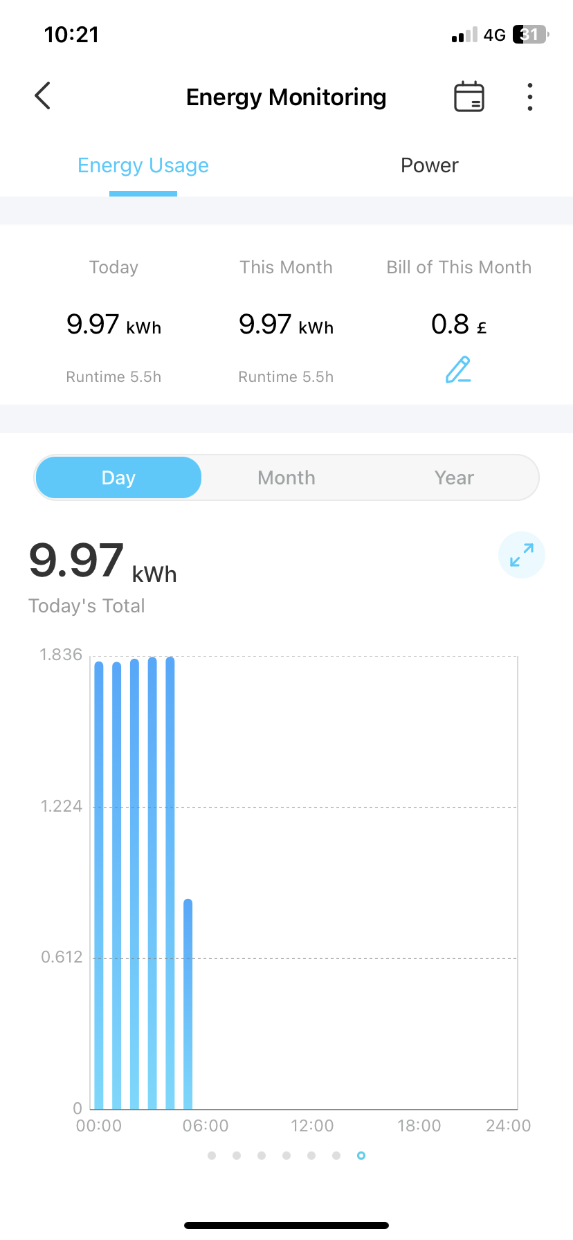

TonyT Posted September 1, 2023 Share Posted September 1, 2023 Not much difference in consumption for the the second day, 7am IR thermometer was reading 138deg C on the internal part visible through the front grill Link to comment Share on other sites More sharing options...

SteamyTea Posted September 1, 2023 Author Share Posted September 1, 2023 @TonyT I am still amazed that you have turned one one. Is there a reason the hall is cold? Where in the country are you? Was the usage half of what is was night before last? Link to comment Share on other sites More sharing options...
