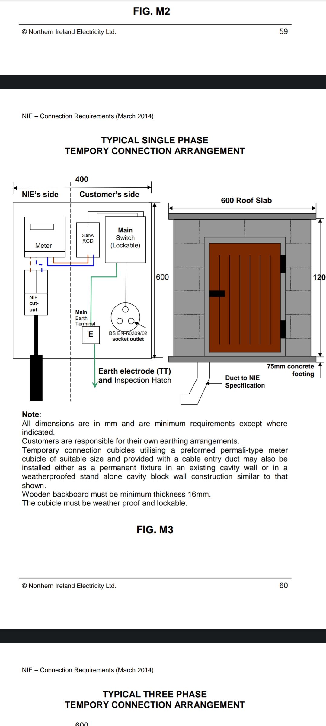

nod Posted August 30, 2023 Posted August 30, 2023 Due to the power run being to far from the house I’m having to build a waterproof electrical box to house the meter Has anyone any pictures or diagrams they could share I remember seeing one posted a while back Brivk with doors at the front

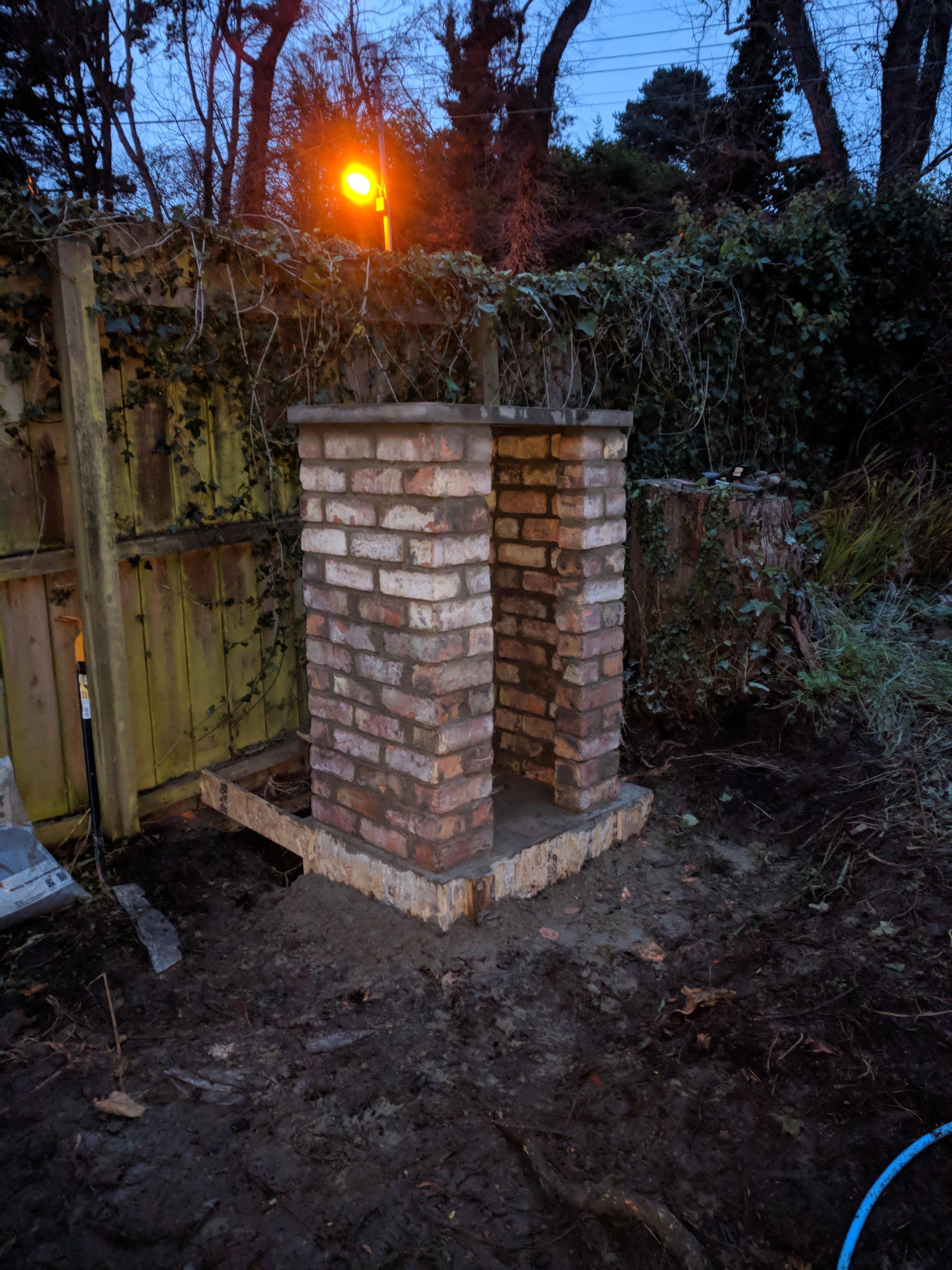

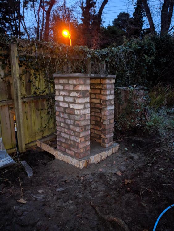

Conor Posted August 31, 2023 Posted August 31, 2023 Brick on 100mm concrete base with 100mm duct innolace.. I put a simple osb door on with sliding bolt.
nod Posted August 31, 2023 Author Posted August 31, 2023 19 minutes ago, Conor said: Brick on 100mm concrete base with 100mm duct innolace.. I put a simple osb door on with sliding bolt. Perfect Is that a flag on the roof ? Do you have the dimensions?
Conor Posted August 31, 2023 Posted August 31, 2023 (edited) 23 minutes ago, nod said: Perfect Is that a flag on the roof ? Do you have the dimensions? Yeah. 600x900 flag. Mine is 900mm wide and 600mm deep, you can get away with a 600x600x slab but doesn't leave much room inside for your 110v transformers etc. Brickwork slightly short of this. Other DNOs may vary. Edited August 31, 2023 by Conor

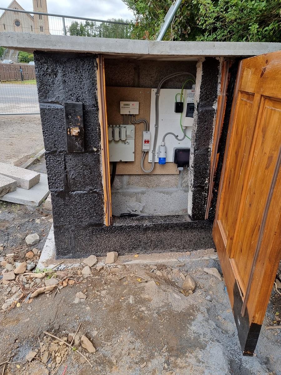

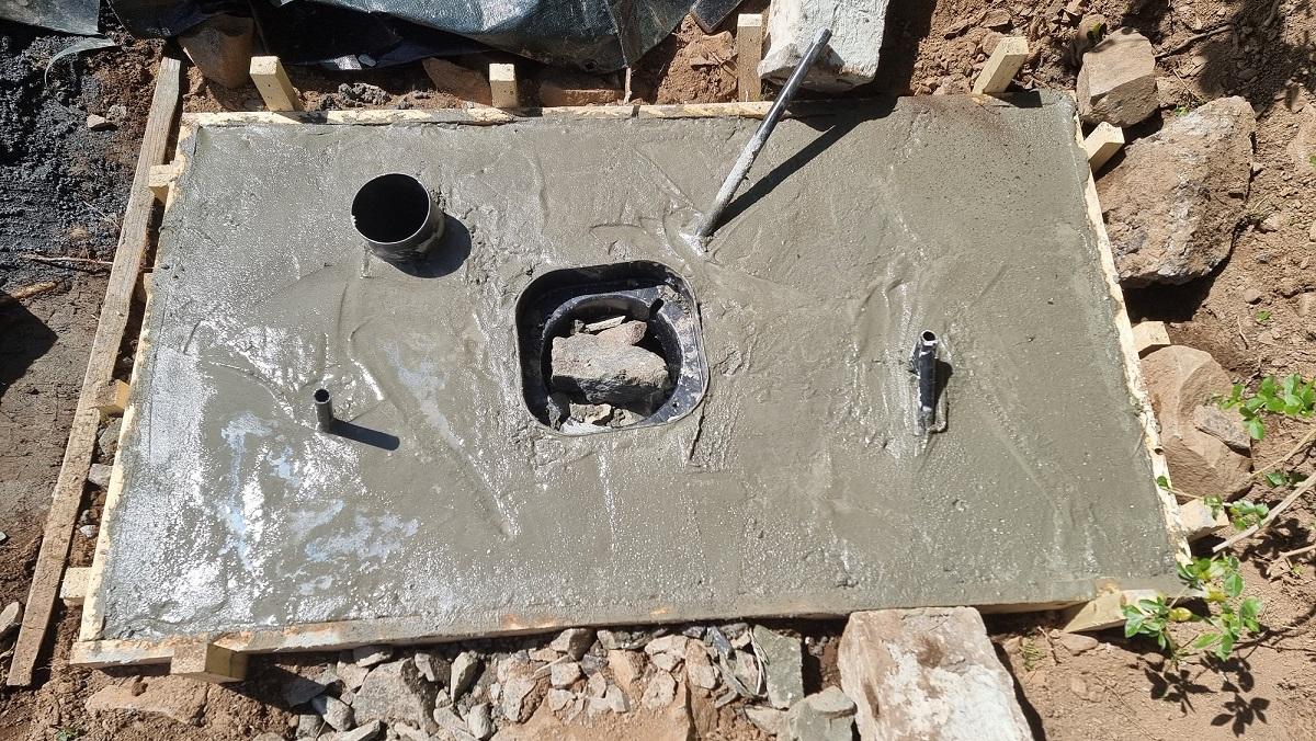

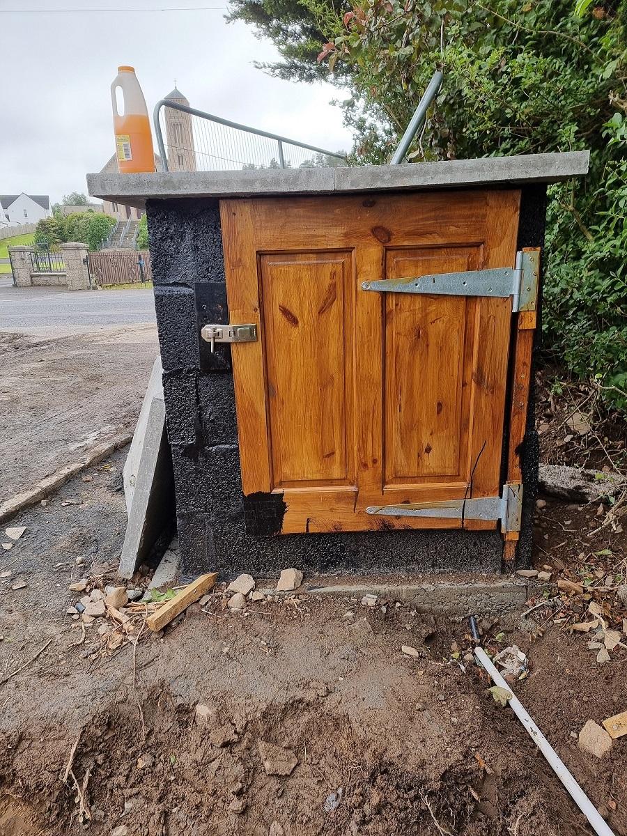

Mr Blobby Posted August 31, 2023 Posted August 31, 2023 (edited) Here's mine, made out of spare bits mostly. The structure is only temporary because NIE only allow permanent meters in permali boxes on the house wall. NIE also prohibit metal meter boxes for temporary supplies, they must be brick. If I was in GB I would have bought a metal meter cabinet off the shelf and kept it as a permanent supply. This tmeporary box is right next to where the EV chargers will be installed so routing to the house and back out is infuriating. NIE insist a 3-phase temporary supply requires a bigger enclosure (even though they split off a single phase for the temp supply) hence the two slabs on the top with some silicone sealant between them. Its painted with bitumen paint to give it some extra waterproofing. The big problem I had was getting an earth rod in the ground. I built the box on top of the rock of gibralter and had to get a digger in to dig a hole near to he cabinet to sink a rod. If I were doing this again I would get the earth rod in before installing the cabinet. Edited August 31, 2023 by Mr Blobby 1
