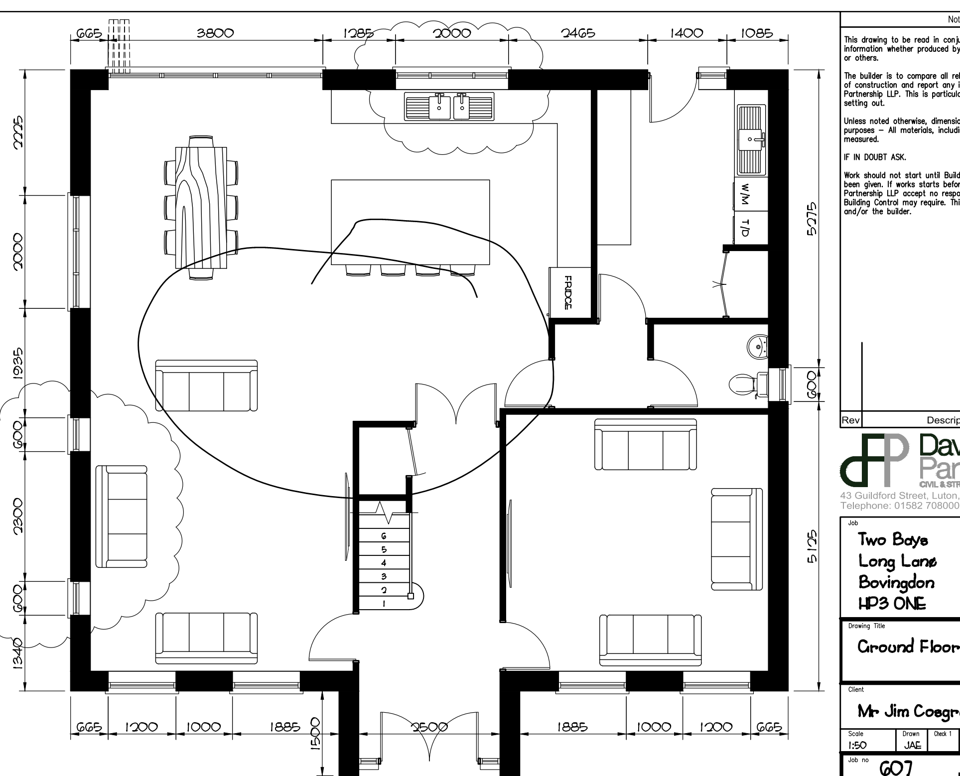

Big Jimbo Posted August 29, 2023 Share Posted August 29, 2023 607-02-2.pdf607-01-2.pdf final floor plans. They have been tweaked, and twisted. Not sure what more I can do. Plan is for Hot water tank under the stairs, with coats and shoes. Electrics in that bit in the utility room. Mvhr in the landing cupboard. Link to comment Share on other sites More sharing options...

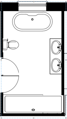

Dave Jones Posted August 29, 2023 Share Posted August 29, 2023 brick or render ? small tweak to the master ensuite, doors opening out cant make mspaint do it ! 1 Link to comment Share on other sites More sharing options...
ProDave Posted August 29, 2023 Share Posted August 29, 2023 Not a design criticism, but if you have the HW tank under the stairs, and you are having an unvented tank, you WILL need a drain for the D2 discharge, so you will need to provision a drain under the stairs. That will need thinking about and planning at floor slab laying time. Just pointing out as it may not be immediately obvious you will need a drain and will be a bitch to add later. 1 Link to comment Share on other sites More sharing options...
Big Jimbo Posted August 29, 2023 Author Share Posted August 29, 2023 You will be impressed @ProDave I did remember, and have told the guy doing the drainage plans. I can't see anywhere better to put the water tank. Not a bad distance from the hot water outlets. Fingers crossed i can get Mvhr in the upstairs landing cupboard. Link to comment Share on other sites More sharing options...

Dave Jones Posted August 30, 2023 Share Posted August 30, 2023 kitchen could be made nicer as well you have masses of wasted space that could be made interesting. Needs a decent kitchen designer to have a look, surely can do better than a bog standard L shape! 1 Link to comment Share on other sites More sharing options...
Dave Jones Posted August 30, 2023 Share Posted August 30, 2023 in fact thinking about it id be inclined to put the kitchen in the front of the house and have a glass slider the length of the back wall where the sinks currently are. make the lounge at front the dining room then have a massive lounge at the back open to the rear garden via the slider. Link to comment Share on other sites More sharing options...
Big Jimbo Posted August 30, 2023 Author Share Posted August 30, 2023 I used to run a small, bespoke kitchen company for 20 odd years. I totally agree. The kitchen badly needs to be sexed up. I will be attending to that. Women buy houses IMO, so a great kitchen is a must. What is shown there was just bunged in, Link to comment Share on other sites More sharing options...
Big Jimbo Posted August 30, 2023 Author Share Posted August 30, 2023 @Dave Jones I did have the kitchen at the front left when i started. I am hoping that if i plan sockets etc well, the dining table, and the family area could be swapped around. I think the lounge is to big for a dining room. I think that if there is a disconnect, people just don't use them. I also think that a second, quiet sitting tv area is important. It's a decent size at about 4.5 x 4.5m The kitchen at the moment is an area that i know needs some serious work, but i do intend dealing with that. The other thing is that i did not like the disconnect between the kitchen, and utility. Because i am rural, but within 10min drive to Two London underground stations, the chances are it will be Professional London workers who i will end up selling the place to. The utility will contain larders for food storage so needs to be close to the kitchen. The sad truth is that young professionals just don't cook. They do, but not like the traditional stay at home housewife from 40 years ago. They just want the kitchen to look great, so their friends say "OOOOHHHHH nice. there is also a separate annex for live in home help/Gym/Guests/home office/teenage hang out, so i am hoping i have got most things covered. Link to comment Share on other sites More sharing options...

torre Posted September 8, 2023 Share Posted September 8, 2023 I like a lot about this layout. I'd be tempted to push the main hall wider and also allow yourself a generous 1000mm staircase,losing the bullnose stair that interrupts the hall flow a bit. I'd consider making more room on the landing by pushing the wall with the master's ensuite back ~750. That does away with the awkward doorway corridor into the master bedroom and gives more space for say, a console table and better people flow on the landing. These are spaces you pass through a lot. You could think about entering the master bedroom via the dressing room - landing door into the dressing room and then double doors from dressing room so you enter the bedroom looking out towards the bifolds / french doors with a juliet balcony. Bifolds are shown as 4+0, you might find 3+1 with a traffic door more practical. I like the lounge/kitchen swap idea to sit looking out to the rear, it'll probably enhance the view through from front to back as you enter the house - lower furniture, no sink & taps. Link to comment Share on other sites More sharing options...
