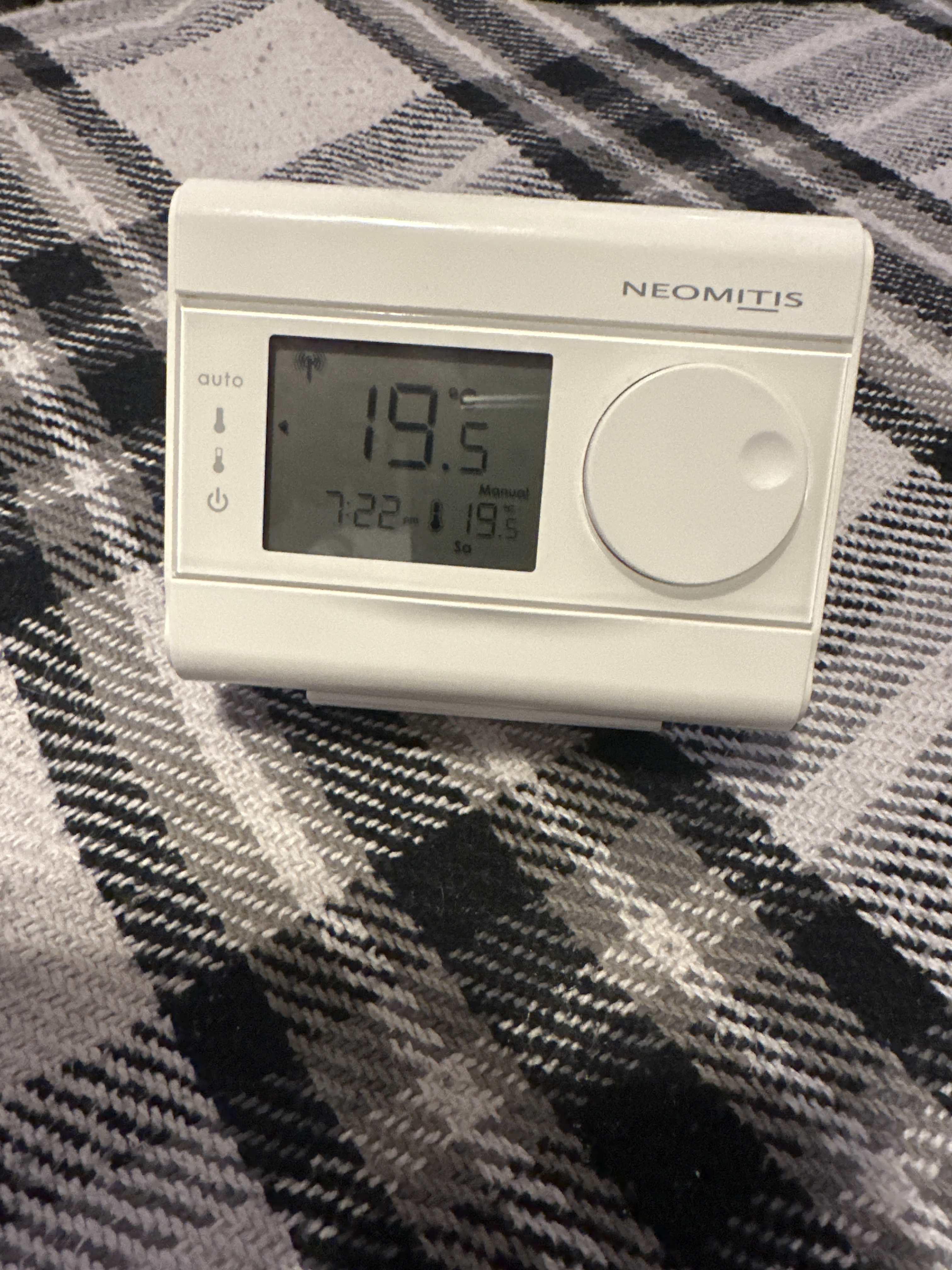

5 minutes ago, Nickfromwales said:
Why not go and buy a wireless room stat, from Screwfix or Toolstation, and ask them to fit it whilst they are there, then you can leave the other one where it is and zero cables to run. If he says no, just take it back and refund it.
I don't understand Nick apologies. How could such a screwfix thermostat trip the system on & off-?
Posted
Gents, i hate to say this, but, There is no way on earth, that Zoot is going to get the above for much less than i quoted above.
We have to understand that a large proportion of Old people, only on a state pension, have to chose, between heat and eat.
Expecting to cover the cost of the above for £70 per month is living in cloud cookoo land.
I now live in my posh shed, as my bungalow will be pulled down in the near future. It's about 250 square foot. I have a kettle, a microwave, and air fryer, and a two ring electric hob. I have a 10k/w instant water heater which is a bit crap, but that provides water for a shower, and the sink. The walls, floor, and roof, all have 100mm of pir. Well fitted. Double glazing, and although not tested would be quite good for airtightness. (i built it) I have One, in wall heat recovery ventaxia fan, and an extraction fan in the shower room which comes on with the light. The heating is taken care of by a very small panel heater in the bathroom set to 18, and a larger one in the main room set to 18 at night, and 21 during the day. The heaters are on 24/7 switching themselves, on an off as required.
I spend On average £68 per month on electricity to run the gaff. Frankly, it's a lot nicer that my crappy bungalow.
Unless the Zoot, is in the position, and if he is, wants to.............. Unless he he willing to spend considerably more money on a monthly basis, he is not going to be able to move forward.
I said to all my 3 girls. It's great having the big house, with the great kitchen, and the almost new car on the drive. All your friends will be jealous..... However, it will be shit, to have that, but have to shop in the dented tins isle, and not to be able to afford the petrol for the car.
Zoot is going to either have to spend a lot of extra money to live comfortably
Put up with very cheap bills, but being bloody freezing most of the time.
consider moving, to perhaps a smaller, cheaper, better built property. Where he can be warm at a reasonable cost.
Zoots house might be utter shite. We don't know because we have not been there. There is a possibility that the engineer did some heat loss calcs, and basically thought, It's effing pointless trying to heat this place. I will set this up, so he can at least get some hot water.
Now, we all know that it can be heated. However if it really is as shite as Zoot says, that might cost £1000 a month.
We can all offer advice, but i think there needs to be a commitment to spend more than £70 per month on energy when you live in a shite, old, welsh cottage, that is surrounded by it's own doom and gloom micro climate system .
Posted

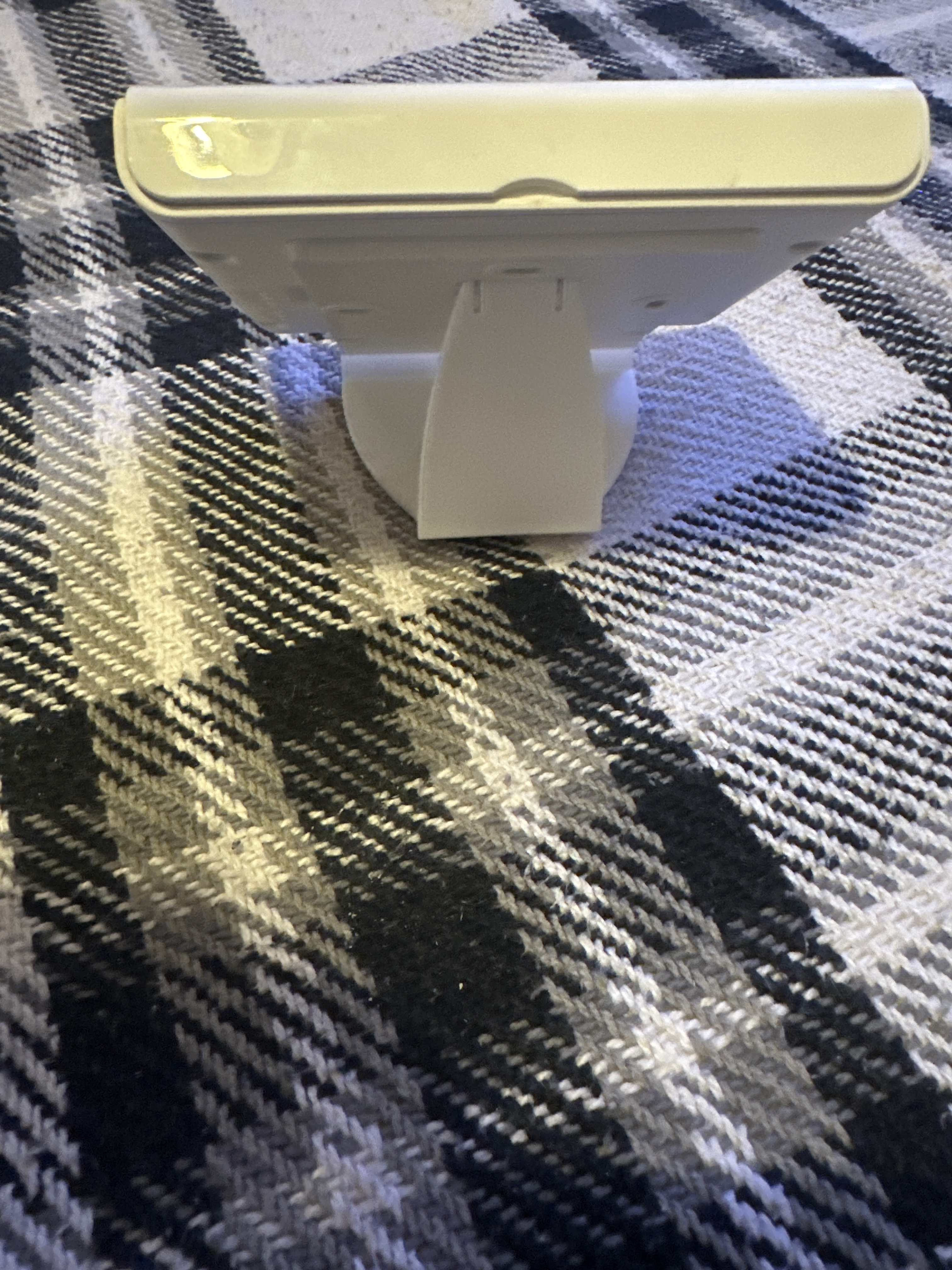

It would be your room (house) thermostat, the thing you are referring to moving with 30m of cable.
You can add a wireless one and leave the factory one in situ as just a dumb display / end user interface. Should be a 30 mins install max.
This you can take with you room to room, so if you want to be comfortable at night, take it to the bedroom and plonk it near an internal wall away from any doors or windows.
If you spend your day in the sitting room, plonk it in there all day. It's moveable as its wireless and battery powered.
This is my one.
image.thumb.jpg.7986c4795bb10f0aac999c6072b6452d.jpgimage.thumb.jpg.22165904adf87f0a76e1f0d4b28ff402.jpg
  • Like 1
