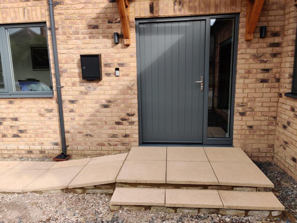

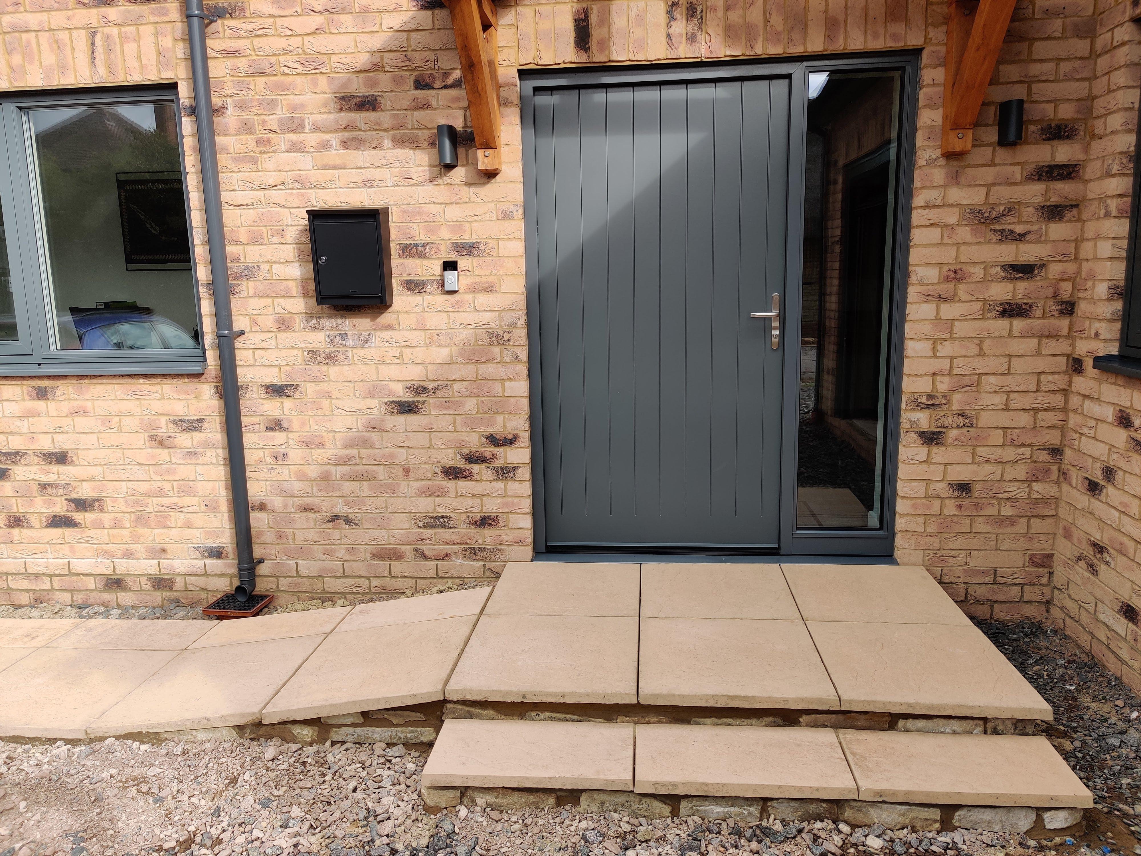

shuff27 Posted August 24, 2023 Share Posted August 24, 2023 Just finished mine last week - slabs on full bed of concrete ballast laid on thick layer of wacked type 1. Ramp slope is approx 10 degrees, I believe the permitted range is 7-15 degs. There's about a 5mm gap between the slabs & door cill to allow for drainage although the oak porch canopy keeps it virtually dry in any case. The slab path is 900mm wide & extends for 8m along the front elevation, so long enough to park parallel & get out of the car straight on to the path - final driveway finish will be 20mm stone chippings, i.e. not wheelchair compatible. Apart from the air tightness test this should be the final element before BCO completion sign off - probably a common situation for us self builders. Link to comment Share on other sites More sharing options...

Mr Punter Posted August 24, 2023 Share Posted August 24, 2023 10 hours ago, shuff27 said: Just finished mine last week - slabs on full bed of concrete ballast laid on thick layer of wacked type 1. Ramp slope is approx 10 degrees, I believe the permitted range is 7-15 degs. There's about a 5mm gap between the slabs & door cill to allow for drainage although the oak porch canopy keeps it virtually dry in any case. The slab path is 900mm wide & extends for 8m along the front elevation, so long enough to park parallel & get out of the car straight on to the path - final driveway finish will be 20mm stone chippings, i.e. not wheelchair compatible. Apart from the air tightness test this should be the final element before BCO completion sign off - probably a common situation for us self builders. I am afraid the ramp to the left looks like it may not comply. It seems to rise at about 150mm over about 1200mm, so about 1 in 8. Link to comment Share on other sites More sharing options...
Dave Jones Posted August 24, 2023 Share Posted August 24, 2023 could do with the fall spacing over a couple more slabs but all depends on how bad the BCO is. No bifolds round the back with level threshold ? They can do for disabled access. Link to comment Share on other sites More sharing options...
