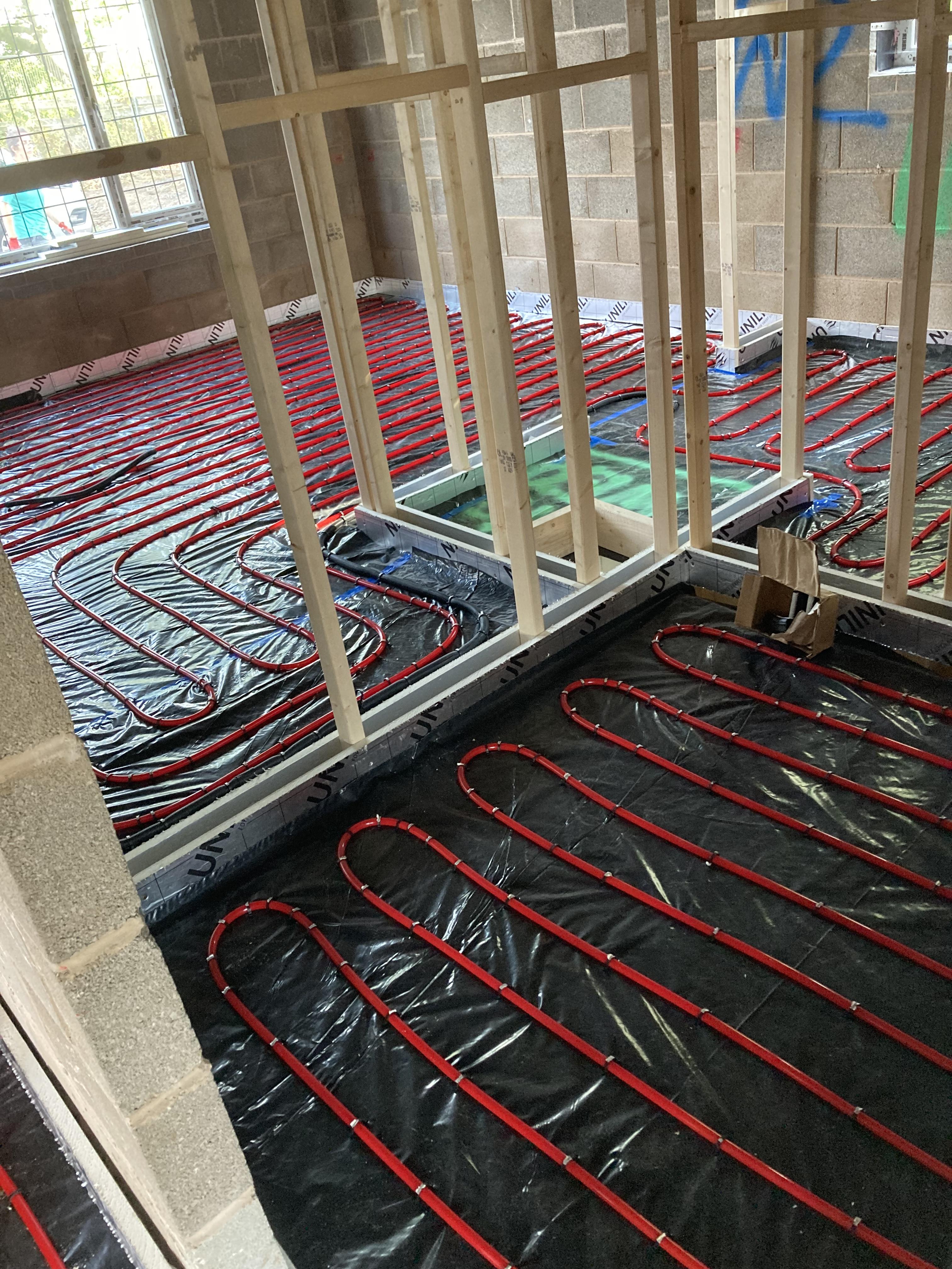

Post and beam Posted August 18, 2023 Share Posted August 18, 2023 To get around difficult( tight) spacing of pipe runs is it common to run pipes under a stud wall for an easier alternate route to any given room? Thanks in advance for all advice wise ones Link to comment Share on other sites More sharing options...
ProDave Posted August 18, 2023 Share Posted August 18, 2023 I did it in mine, easier if the pipes are there before the stud wall. Link to comment Share on other sites More sharing options...
nod Posted August 18, 2023 Share Posted August 18, 2023 (edited) It’s probably better to get your studs fixed down first Edited August 18, 2023 by nod 2 Link to comment Share on other sites More sharing options...
JohnMo Posted August 18, 2023 Share Posted August 18, 2023 I wouldn't put pipes under any wall. Someone will end up putting a nail or screws through a pipe. Plan it correctly there should be no reason to. You may get away with if you everything yourself, but if you are getting others to build it for you, good chance of them messing up. Link to comment Share on other sites More sharing options...
Conor Posted August 19, 2023 Share Posted August 19, 2023 I did this, but dropped the pipes down in to the insualtion then back out again, for added protection. And in flexible conduit. Link to comment Share on other sites More sharing options...

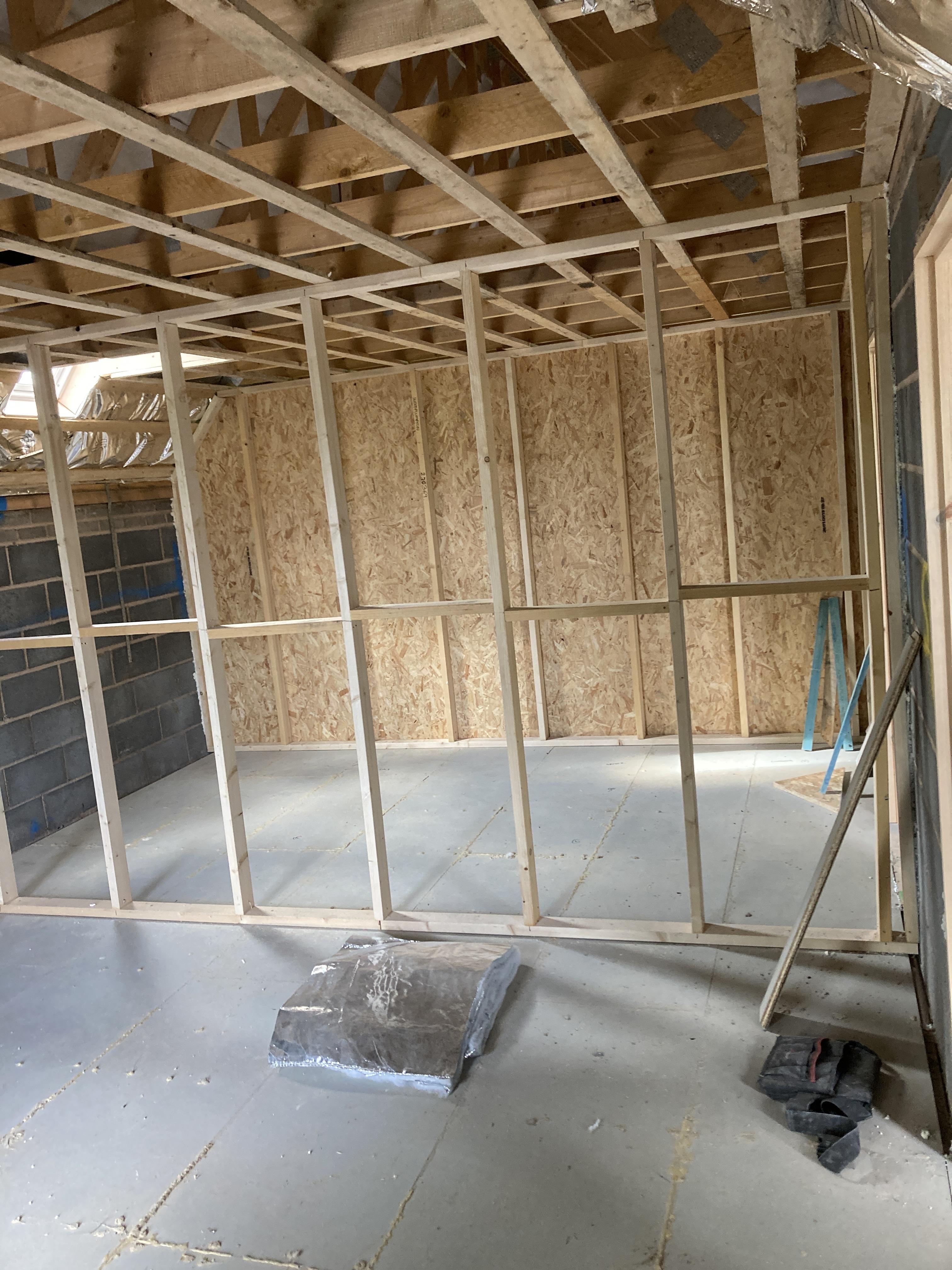

Big Jimbo Posted August 19, 2023 Share Posted August 19, 2023 @nod. That is super neat. I thought you were a plasterer ? ........................Plasterers = mess. Did you just crib that pic off the internet.😜 Link to comment Share on other sites More sharing options...
nod Posted August 19, 2023 Share Posted August 19, 2023 (edited) Since the first build I’ve become a multi tasker thanks though pluming first fix today 💪🏻 Edited August 19, 2023 by nod Link to comment Share on other sites More sharing options...
Mr Punter Posted August 19, 2023 Share Posted August 19, 2023 I am surprised to see you using timber studs @nod. I thought you were a convert to metal? Link to comment Share on other sites More sharing options...
nod Posted August 19, 2023 Share Posted August 19, 2023 Yeah I had a load of timber over from a job and had two timber 4x2 racking walls across the first floor So I did the lot in a day 1 Link to comment Share on other sites More sharing options...
