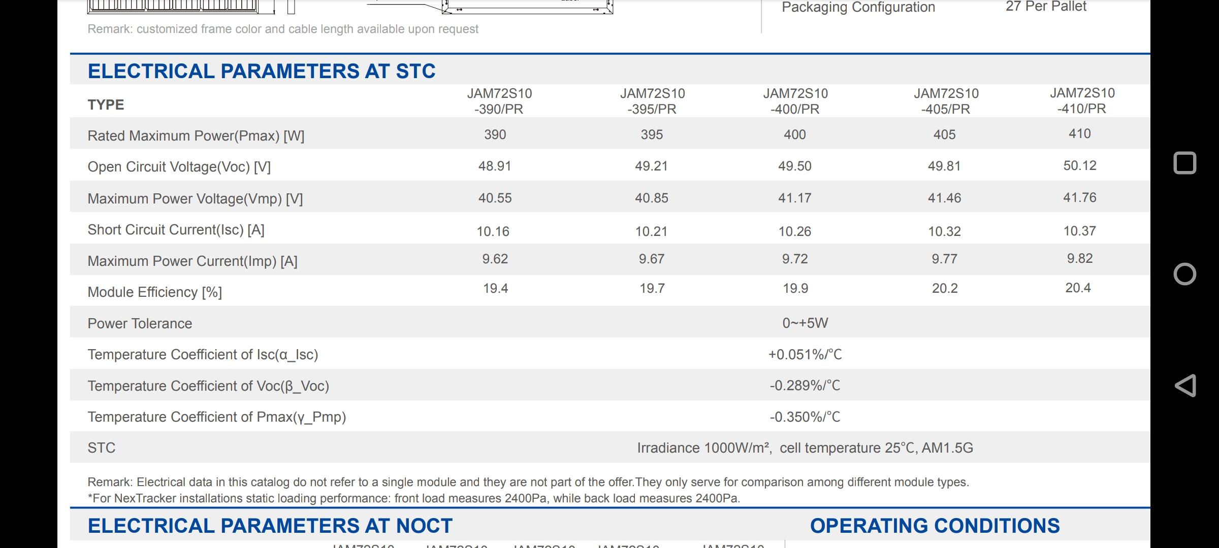

JohnMo Posted August 27, 2023 Posted August 27, 2023 Remember to check the max amps and voltage of each string doesn't exceed what the inverter can allow. Big panels need careful selection of inverters as the amps can be high. data for the 410W JA panels - a series string volts increases and amps remains the same.

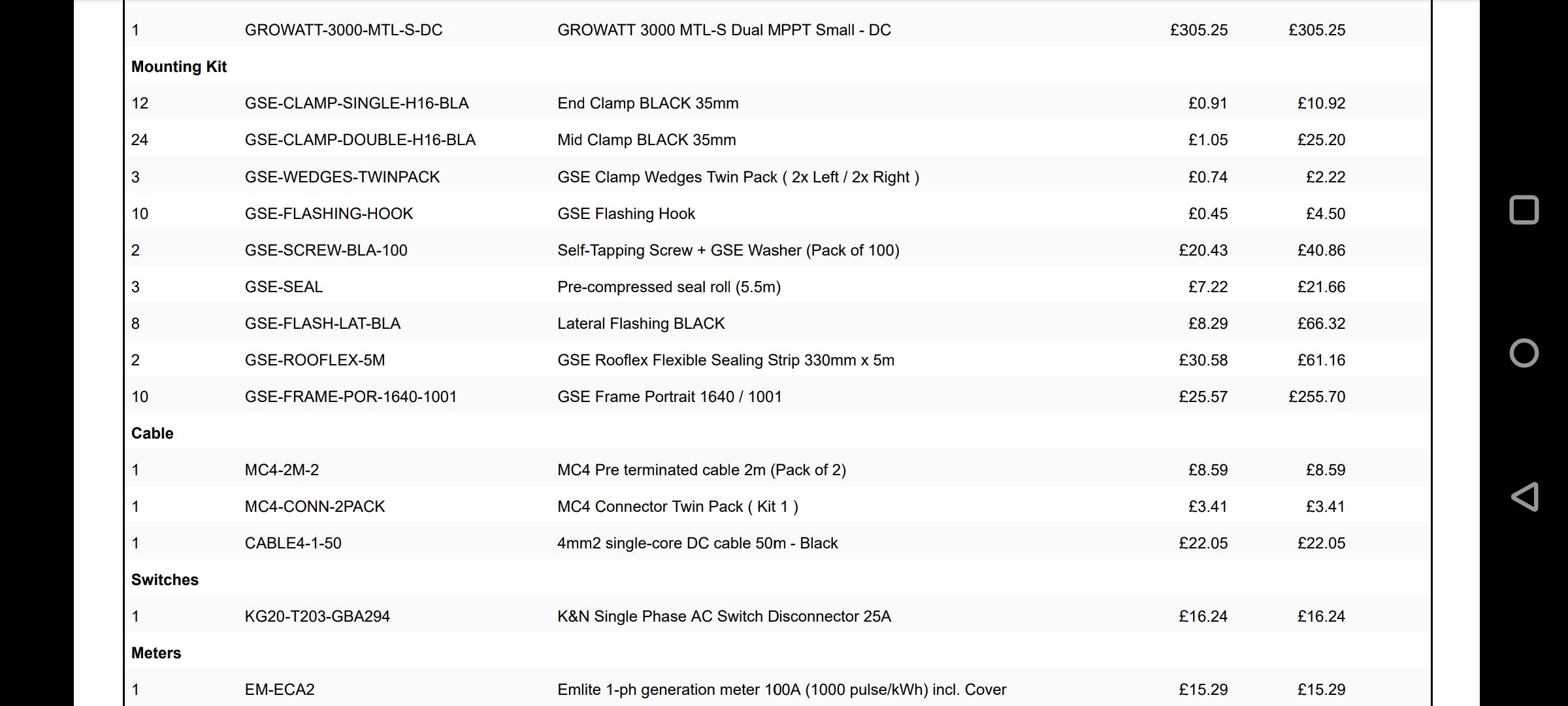

JohnMo Posted August 29, 2023 Posted August 29, 2023 I bought my GSE trays from ITS, they were £25 each. I would double check your quantity of the sundry bits from GSE. £98 for each panel doesn't sound right. Here is my list of bits for 10 panels
puntloos Posted August 29, 2023 Author Posted August 29, 2023 Basicaly GSE is now one kit - https://www.itstechnologies.shop/products/gse-in-roof-mounting-system-portrait?_pos=1&_psq=gse&_ss=e&_v=1.0 - 98 GBP. It is kinda outrageous that it's more expensive than a panel.
JohnMo Posted August 29, 2023 Posted August 29, 2023 (edited) Not here this panel is £29. But all parts available separately https://www.tradesparky.com/solarsparky/mounting/gse-integration/mounting-plates-frames/gse-halfport16501135-1610-1800x1130-1135?gclid=CjwKCAjwrranBhAEEiwAzbhNtYXjvlOJ8rSRX3slCB3ccQdXHEAiGgPUjaA15HDbvyw4lMClpprwBxoCH7oQAvD_BwE Edited August 29, 2023 by JohnMo
puntloos Posted August 29, 2023 Author Posted August 29, 2023 8 minutes ago, JohnMo said: Not here this panel is £29. But all parts available separately https://www.tradesparky.com/solarsparky/mounting/gse-integration/mounting-plates-frames/gse-halfport16501135-1610-1800x1130-1135?gclid=CjwKCAjwrranBhAEEiwAzbhNtYXjvlOJ8rSRX3slCB3ccQdXHEAiGgPUjaA15HDbvyw4lMClpprwBxoCH7oQAvD_BwE https://www.cef.co.uk/catalogue/products/5178047-half-portrait-frame-1650-1135 22.27 😃 But I still frankly haven't heard a good reason why to do GSE in the first place - what's your take on that discussion? Piece of plastic, nail the panels through it, Bob's your uncle?
JohnMo Posted August 29, 2023 Posted August 29, 2023 8 minutes ago, puntloos said: Piece of plastic, nail the panels through it, Bob's your uncle? You could - I wouldn't - it's a bodge. GSE panels have correct drainage and ventilation, cable routing and wind load design. They stop the ingress of water, and once you get your head around the install, very simple to install. If the panel flies off in high wind gse get the blame, bodge job you do. PV panel is basically a pane of glass in a frame, if it hits from a roof, leave that to the imagination. The GSE panel is £30, fixing and trim piece cheap also. Or don't integrate, install slates or tiles and roof bars and hooks. Do it properly once. 1
