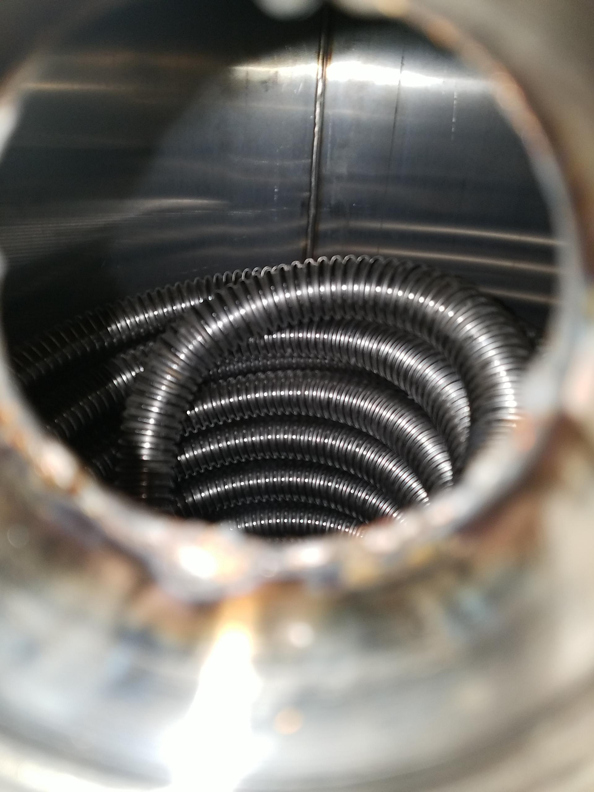

dpmiller Posted August 17, 2023 Posted August 17, 2023 Well I did it, and it works. Stores enough heat that the ASHP can start up and start recovering *before* temperature changes are noticeable at the tap. Whilst the COP mightn't be brill, it's a darned sight better than an electric shower. Recovery to setpoint gives a "burn time" of about 30mins after a -wifey's long hair approved- 15min shower. Tank sensor is halfway up and the tank is heated to 54C, the outlet tempering valve is around 48c. CH/UFH flow passes through the coil at all times so the stratification is somewhat reduced, the bottom of the tank tends not to drop below 40C during the heating season Additionally we've two immersions on PV- top to 65C, then bottom to 90C if and when there's plenty of sun, lol And a boiler stove can heat the vessel through a Laddomat I prefer to look at it as a "summing point" as all energy in or out of the system passes through the TS
JamesPa Posted August 17, 2023 Author Posted August 17, 2023 On 17/08/2023 at 06:53, dpmiller said: Well I did it, and it works. Stores enough heat that the ASHP can start up and start recovering *before* temperature changes are noticeable at the tap. Whilst the COP mightn't be brill, it's a darned sight better than an electric shower. Recovery to setpoint gives a "burn time" of about 30mins after a -wifey's long hair approved- 15min shower. Tank sensor is halfway up and the tank is heated to 54C, the outlet tempering valve is around 48c. CH/UFH flow passes through the coil at all times so the stratification is somewhat reduced, the bottom of the tank tends not to drop below 40C during the heating season Additionally we've two immersions on PV- top to 65C, then bottom to 90C if and when there's plenty of sun, lol And a boiler stove can heat the vessel through a Laddomat I prefer to look at it as a "summing point" as all energy in or out of the system passes through the TS Expand Well done! Can you share the sizes/temperatures, it would be good to calibrate my model to check if I've made a mistake in the logic.
dpmiller Posted August 17, 2023 Posted August 17, 2023 300l tank, filled to (IIRC) 270 to the expansion volume. It's a Worldheat cylinder 2050h x 550dia Both the DHW and recovery coils are 3m2 corrugated tube ASHP is a CoolEnergy IVT9. I have it configured to control on return temps and deltaT is 7C, and the circulating pump is under PWM control Heatup and UFH are mainly carried out during the E7 period. First the UFH as necessary, then the TS is boosted to 54C +0.5C (the IVT allows a variable overshoot to stop the compressor from doing a hard stop) just before morning showers . Cylinder hysteresis is -1.5C to cut in. Daytime recovery temperature for the cylinder is 52C + 0.5C CH return temp is 42C so flow can be briefly in the 49C region. The works well as we have some rads and towel rails upstairs and these get to the flow temp before the system trims back. the UFH sips from this and is blended to 32C or so. It's worth noting that as the cylinder sensor is halfway down the cylinder- midway between the coils- and the flow temp to achieve the required 54C is a bit higher, the tank seems to end up being around 57C at the top, 55C at the sensor, and never lower than about 37C right at the bottom underneath the coil 1
