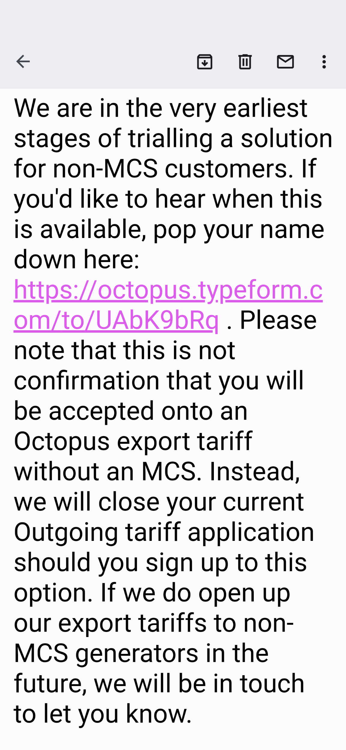

ToughButterCup Posted August 17, 2023 Share Posted August 17, 2023 On 15/08/2023 at 22:14, JohnMo said: I've applied let's see how it goes. This is how it's gone for me @JohnMo One small step for Octopus - feels like they haven't thought this through yet. Link to comment Share on other sites More sharing options...
JohnMo Posted August 17, 2023 Share Posted August 17, 2023 Sounds like tell the press and social media then think about. There is absolutely nothing to trial if the array is G98 or whatever approved, it's no different from an MCS install. 1 Link to comment Share on other sites More sharing options...
