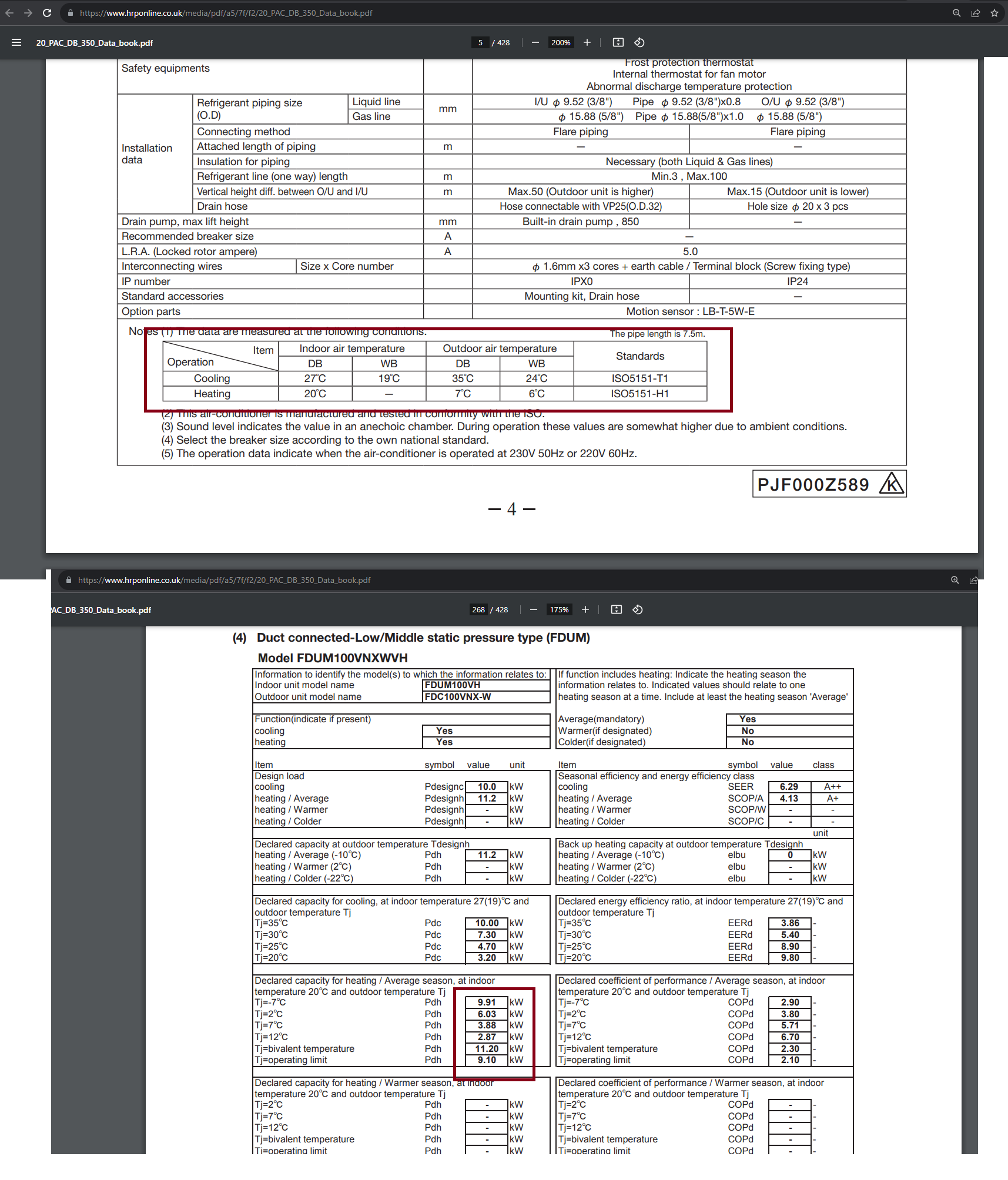

Archer Posted August 17, 2023 Author Posted August 17, 2023 43 minutes ago, SteamyTea said: Worth checking how the HP modulates, some just open or close the expansion valve, that just reduces output without saving any input. How would you check this in advance, I thought it was all about inverter power? Is it stated on the technical spec somewhere normally? 18 minutes ago, Beelbeebub said: The one thing I would caution about modulation range, which I noticed from A2W units and may (or may not) apply to A2A.... The modulation range is generally quoted as the max and min outputs at a given temp. For the ducted A2A units that we are looking at (Mitsubishi FDUM series) this doesn't appear to be the case. The min/max output is listed together as 1.1kw / 7kw with no temperature range. Interesting that there's so much variation between the type of unit though.
Beelbeebub Posted August 17, 2023 Posted August 17, 2023 4 minutes ago, Archer said: How would you check this in advance, I thought it was all about inverter power? Is it stated on the technical spec somewhere normally? For the ducted A2A units that we are looking at (Mitsubishi FDUM series) this doesn't appear to be the case. The min/max output is listed together as 1.1kw / 7kw with no temperature range. Interesting that there's so much variation between the type of unit though. The only way would be to get the data table showing output at min/nom/max for each outside/inside temp. The min/max output must be related to temperatures even if they don't mention it in the brochure. For example is that 7kw at 15C or - 15C? Given manufacturers always like to put a good spin on specs I'd bet it was the maximum in close to ideal conditions. Similarly of I wanted to show the lowest output I could (to make the modulations seem better) I would absolutely quite the output in fairly cold conditions.

DanDee Posted August 18, 2023 Posted August 18, 2023 11 hours ago, Beelbeebub said: The one thing I would caution about modulation range, which I noticed from A2W units and may (or may not) apply to A2A.... The modulation range is generally quoted as the max and min outputs at a given temp. So it may be a max of 12kw at - 5C and 3kw min at - 5C So 4:1 Except you don't use the minimum modulation at - 5C. Thatvs when you need max power! You need min modulation when it's warmer, say 10C or 15C. Thr minimum a HP (at least the ones I looked at) can modulate down to at the higher temps is higher than at the lower temps - which is obvious really. But that means the minimum you HP might be able to turn down to, when you actually need it to turn down, is higher than you might think. Say 5kw When I looked at the "max at minimum vs minimum at maximum" values I was seeing a modulation ratio closer to 3:1 Does that make sense? In all data sheets the rated output be that min/normal/max is always stated at the same 7outdoor/20indoor for A2A and 7out/35water or 55water. With other temp ratings specifically pointed out. I don't know where your -5 comes from. The lowest minimum output at lower temp also does not necessarily holds true, due to the safety minimum modulation of the compressor at freezing temps which is higher than at +7...+12. But spinning the compressor at the same speed will obviously put out more heat with every degree of outdoor increase. 1

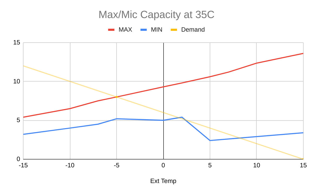

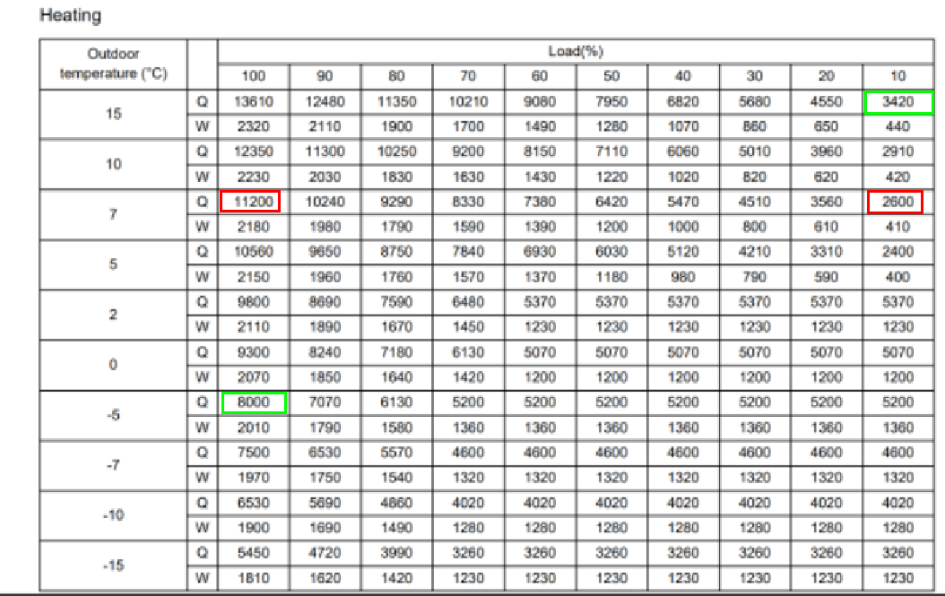

Beelbeebub Posted August 18, 2023 Posted August 18, 2023 2 hours ago, DanDee said: In all data sheets the rated output be that min/normal/max is always stated at the same 7outdoor/20indoor for A2A and 7out/35water or 55water. With other temp ratings specifically pointed out. I don't know where your -5 comes from. The lowest minimum output at lower temp also does not necessarily holds true, due to the safety minimum modulation of the compressor at freezing temps which is higher than at +7...+12. But spinning the compressor at the same speed will obviously put out more heat with every degree of outdoor increase. I picked -5C as the coldest you are likely to see in the UK therefore also the highest load you are likely to see. 15C was picked (again slightly arbitrarily) as the temp at which most houses don't need much extra heating to stay warm, some will be lower, some higher. But this is the point at which you want you HP to be running at it's lowest. So from the table you posted the 7C range (red) would be 2.6-11.2kw or 1:4.3 But in reality you are more interested in the max power at -5C (or maybe -2C or whatever you pick as the coldest day) which is 8kw (green) And your minimum requirement will be at around 15C which is 3.4kw So your practical modulation is more like 1:2.3 I did a rough graph.... The kink in min from 2 to 5C is interesting, my guess is the % modulation isn't true compressor speed, but % of available range, ie the compressor speed at 10% modulation isn't the same at every temperature. For reference this is the graph I got for an A2W (nominal 9kw) HP, which is worse than the other graph
Beelbeebub Posted August 18, 2023 Posted August 18, 2023 The important bit is (i guess) what the performance of the HP is cycling around the +10C range. If it can cycle with no major efficiency hit then no problem. The COP should be pretty high then anyway. But you do spend a awful lot of time in that region in the UK, alot more than the -5 point. So I guess that's where the undersize argument comes from, gaining more efficiency in the right hand side of the graph at the expense of a few days of poor efficiency on the left.

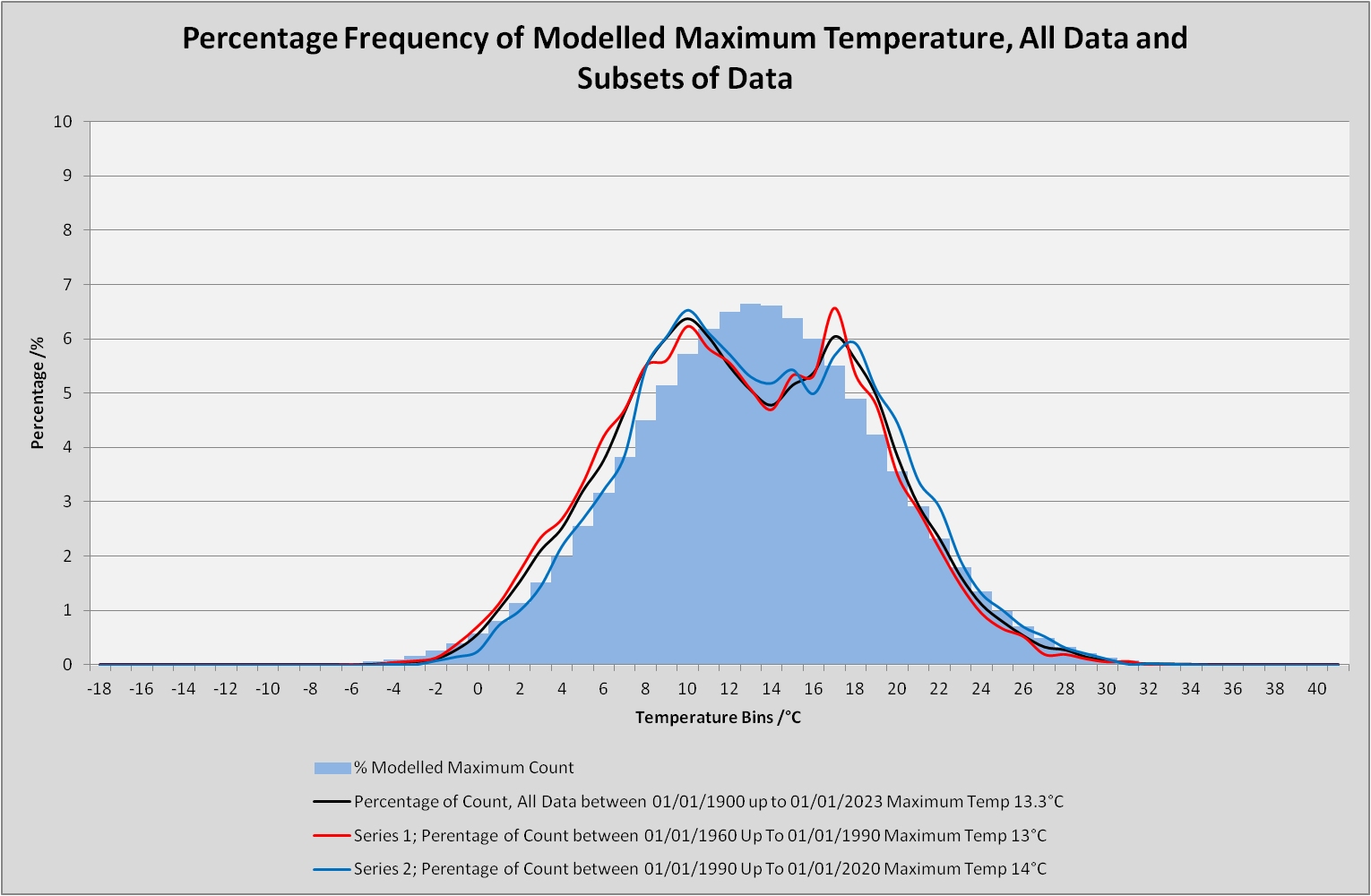

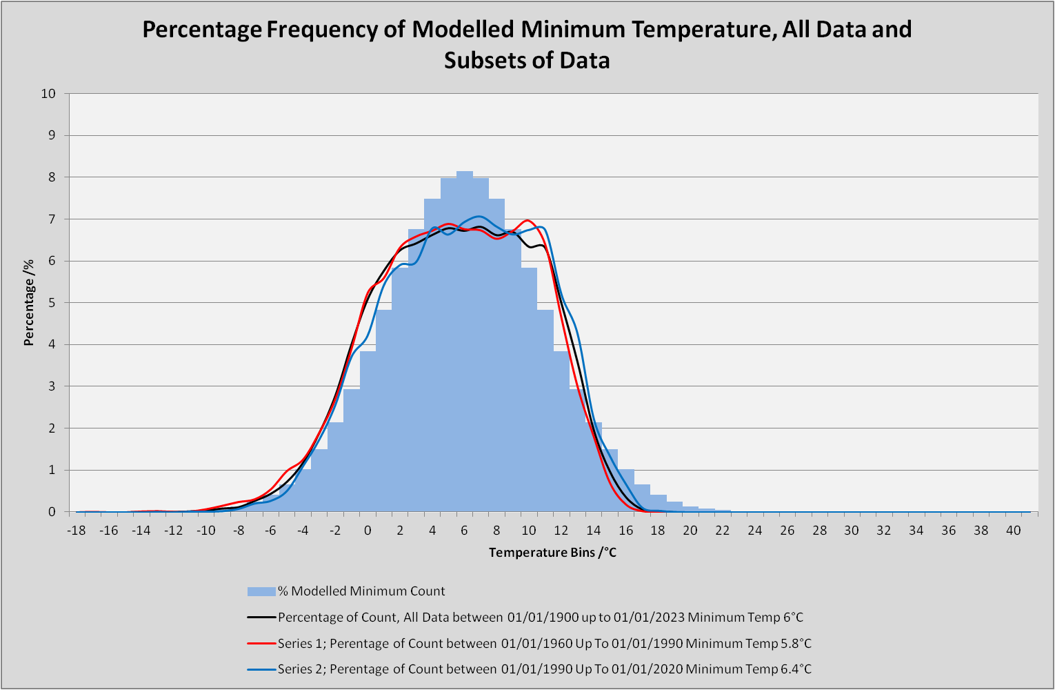

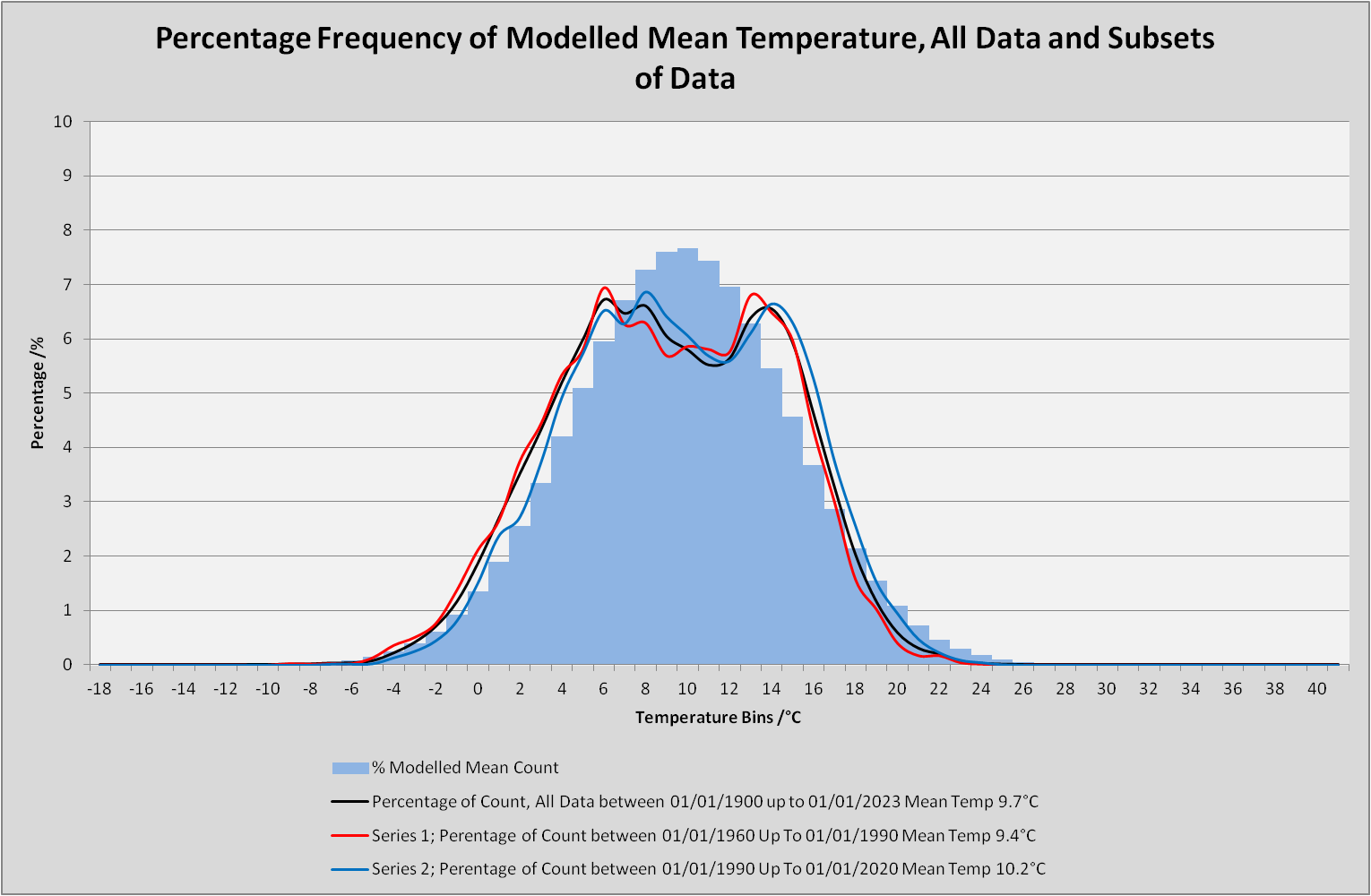

Beelbeebub Posted August 18, 2023 Posted August 18, 2023 where were they for, the top graph seems to be from somewhere pretty chilly! but in both cases time below -5 is much less than time above 10C
SteamyTea Posted August 18, 2023 Posted August 18, 2023 Just now, Beelbeebub said: where were they for, the top graph seems to be from somewhere pretty chilly! Met Office Central England Temperatures. Top chart is min temp, bottom max temp. Here is the mean temps (well actually the mean of the daily median temps) 1

markocosic Posted August 18, 2023 Posted August 18, 2023 4 hours ago, Beelbeebub said: But in reality you are more interested in the max power at -5C (or maybe -2C or whatever you pick as the coldest day) which is 8kw (green) And your minimum requirement will be at around 15C which is 3.4kw Not so. If the heating goes off at 15C (because solar gain and internal gains equal the losses) then your number is 0 at 15C and 8kW at design condition (excluding internal gains) This extends the modulation range required and means it's more likely that you spend longer operating at/near the minimum outputs.
Beelbeebub Posted August 18, 2023 Posted August 18, 2023 1 minute ago, markocosic said: Not so. If the heating goes off at 15C (because solar gain and internal gains equal the losses) then your number is 0 at 15C and 8kW at design condition (excluding internal gains) This extends the modulation range required and means it's more likely that you spend longer operating at/near the minimum outputs. Sorry, I meant the minimum heat requirement for the house (aka 0kw heat demand) will be around 15C and at that point the minimum the HL can output is around 3.4kw so the HP will have to be cycling. I don't know how much of an issue that will be from an efficiency, longevity and comfort point of view. If there are huge issues there, then oversizing might not be bad idea.
markocosic Posted August 18, 2023 Posted August 18, 2023 IME pretty uncomfortable to have 3 kW zero kW 3 kW Xero kW blowing at you.
