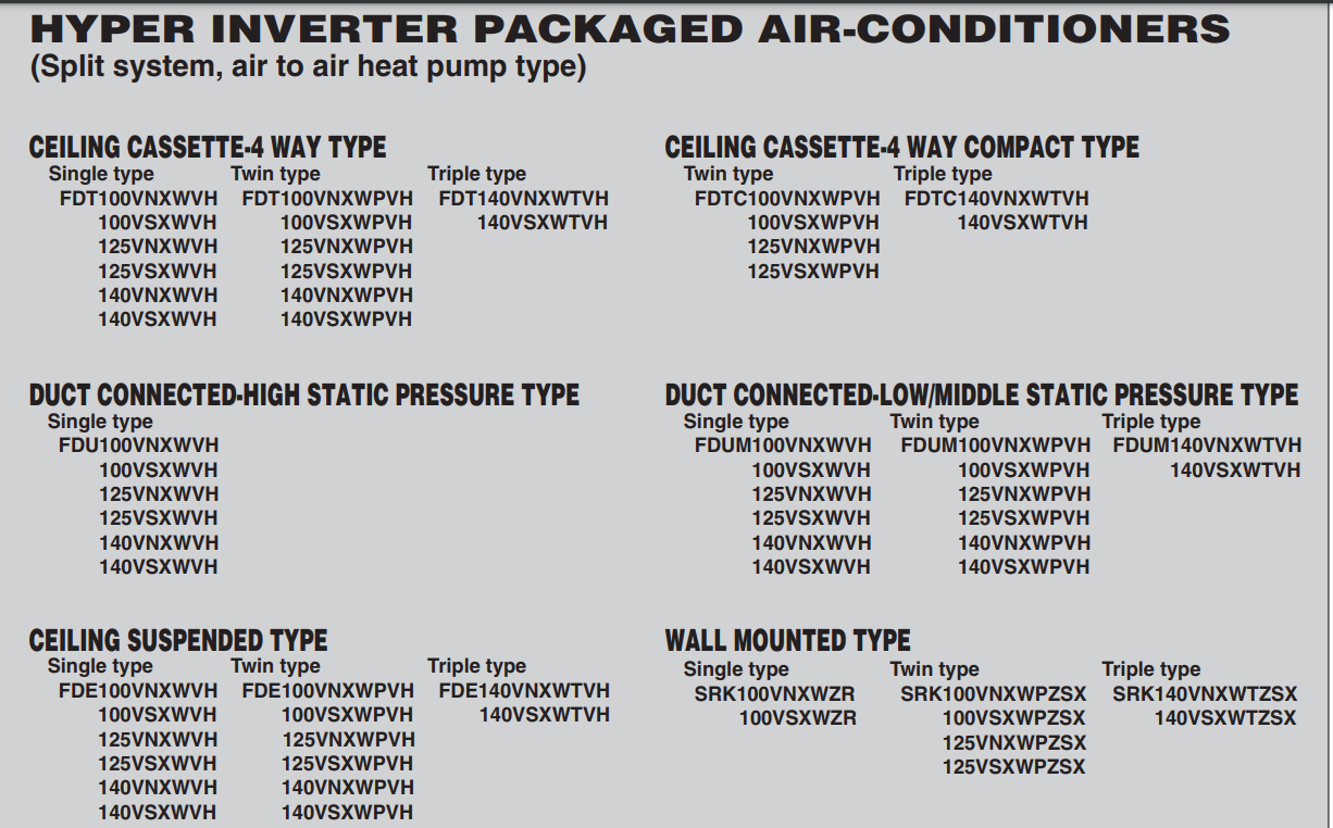

Hi All,
We're in the process of specifying a ducted A2A system for our house, for heating only (hot water supplied via a separate system). System setup is a little unusual and restricted because we are using the existing ground floor ductwork from a gas warm air system, with the upstairs/1st floor supply coming courtesy of new insulated ducts in our loft (ie. with ceiling diffusers).
Our engineer has specced a system from Mitsubishi Heavy Industries which he is happy will work in the existing GF ductwork, but has said that we need to split the system with 2x indoor units (one for each set of ducts/each floor). He also thinks - and I am not 100% sure about this, but it's the advice we've been given - that it's not possible to use a single outdoor compressor unit to supply both indoor ducted fan coil units. A google search sort of backs this up - the MHI ducted A2A units come packaged essentially with a specified indoor unit.
Ok so anyway - I have now completed a heat loss survey - through Heat Engineer and also through the Heat Punk app - they've come back surprisingly low and suggest whole house heat loss around 7.8kw @ -2.5 degrees OAT (and recommended a 8 or 12 kw pump for the whole house). As I said in a different thread, our engineer originally specified a whopping 26kw in total (1x 14 and 1x12); I queried this and he has revised to 17kw (1x7 and 1x10).
Looking for any advice on here  that people can give; I'll put the data sheets below, but the MHI pumps appear to have really excellent modulation outputs; the 10 can operate down to 1.7kw and the 7 to 1.1kw. So unless there are any "gotchas" to be aware of they both should be fine to operate without excessive short-cycling even if they are significantly oversized?
The other main difference between them is the efficiency, with the 7kw unit looking quite poor with COP @ 7degrees  of just 3.76 (only 2.73 for cooling). The larger pump is more respectable - around 9-15% more efficient for heating/cooling using the same parameters (COP 4.08). Confusingly the SCOP for both models is almost identical (4.13) which doesn't make much sense... Sorry about the long read - my main question is should I be asking for the the larger output unit(s) to be installed for both floors, even though they are significantly oversized because of the efficiency increase? Or is it bad to have the pump operating towards the bottom of its output and 2x7's might give better overall performance?  I trust the engineer and want to use them and there isn't a big cost difference between the difference size pumps, just thinking about what will be best in day to day use (ie. more affordable, more comfortable etc).
Any advice massively appreciated. Cheers -
In the brochure that I shared the link to, you have the outdoor unit with either 1 single indoor unit, 2 indoor units or 3 indoor units.
The system with 2 indoor units having a better COP than the one with 1 indoor unit, but this only when they work in tandem.
P.S. Yet it will be more efficient to run 2 separate systems, than one outdoor with 2 indoor(multisplit) if you need to run the upstairs and downstairs separate.

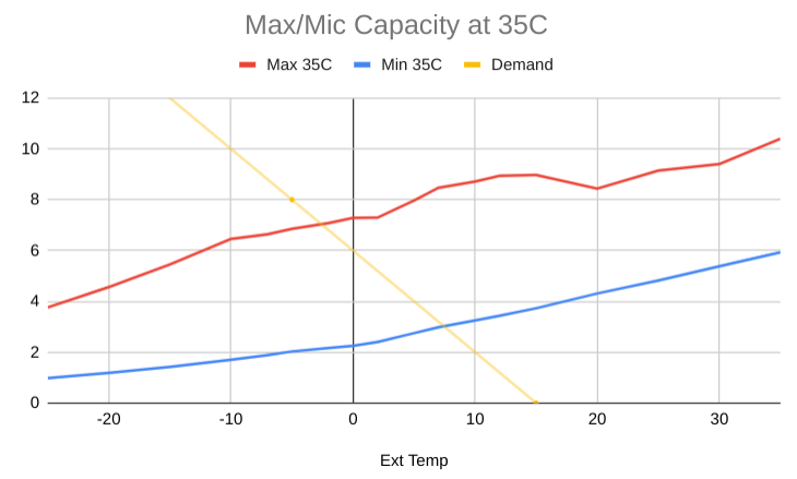

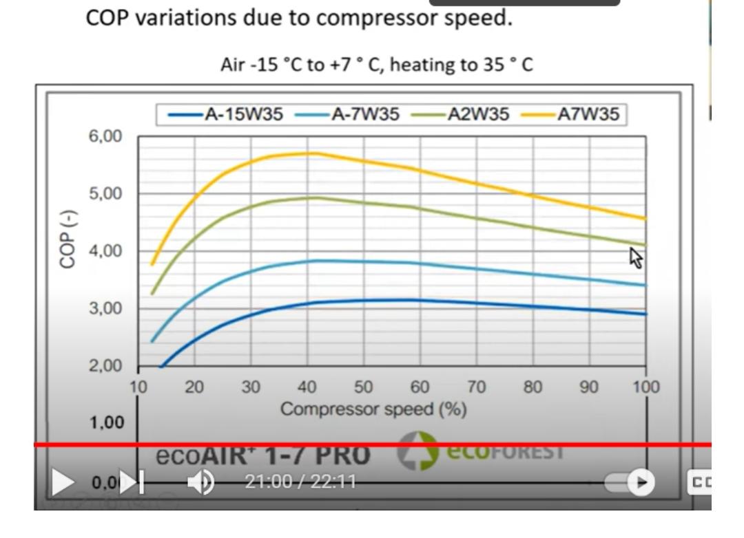

I've been doing some further reading online about this and I'm sharing here in case it's of use to anyone else in a similar position.
Just to be absolutely clear I am in no way expert - what I've read and am posting below may not hold true and goes against conventional wisdom on sizing so happy to be challenged/ corrected by other more knowledgeable forum members...
So to recap, the proposed system for our house is 2x outdoor and indoor A2A units with a total output of 17kw (1x10 serving ground floor, 1x7 kw serving first floor). The total estimated demand based on Heat loss is a little under 8kw @ -2.5 degrees OAT, our MCS design temp. So significantly oversized.
My concern was mainly that oversizing would lead to excessive cycling and inefficiency, but both HP's have a low minimum output - 2.8kw in total; so the question in my mind was why is oversizing a problem if the pumps can modulate down?
A few considerations from the info and chart below:
1. PDesign/ output @ -10 degrees;
Heatpumps lose capacity, quite significantly towards the lower end of their temperature range. In my case the total output drops from 17kw to 12.1kw @-10 degrees (presumably an exceptionally rare temperature north of London)
2. Inverter HP's run less efficiently at the higher end of their range (80-100% output capacity); they also seem to run more efficiently at the lower- to mid point of range (30-60% capacity). These differences can be quite considerable (the research paper below suggests from 10% to 40% efficiency increase in tests).
3. Manufacturers set a cut-off for the lowest output a compressor will operate at based on it's efficiency, but this tends to drop significantly at the very bottom of the range (less than 15-20% of max output). This concept is shown in the image below from the John Cantor presentation. I've found other similar ones online showing similar findings. The efficiency peak seems to be around 40% of peak capacity.
So what does this suggest (in my mind)?
- Pumps should be sized at least 25% more than the design load to ensure that inverter efficiency is maintained and to provide a safety factor for extreme weather;
- Use the minimum output as the key figure not just the maximum output; Heat Pump's with a high turndown ratio may be more suitable (for example, larger HP's can have better COP efficiencies than equivalent smaller pumps in the same range; lots of technical chat about this on Green building Forum - see links below.
Size to avoid or minimize excessive cycling using the minimum output figure - ie. What heat loss is there at 12 degrees OAT?
- The minimum output should be significantly less than 50% of MCS design heatloss (ie. 8kw heat loss, minimum output of less than 3 kw). This should avoid excessive cycling in most cases and ensure that peak inverter efficiency is achieved in most outdoor conditions.
https://aceee.org/files/proceedings/2014/data/papers/1-371.pdf
https://www.greenbuildingadvisor.com/question/how-does-efficiency-in-a-mini-split-vary-over-various-operating-levels
https://www.greenbuildingadvisor.com/question/oversizing-a-multi-zone-inverter-heat-pump-does-it-matter
Any thoughts...?

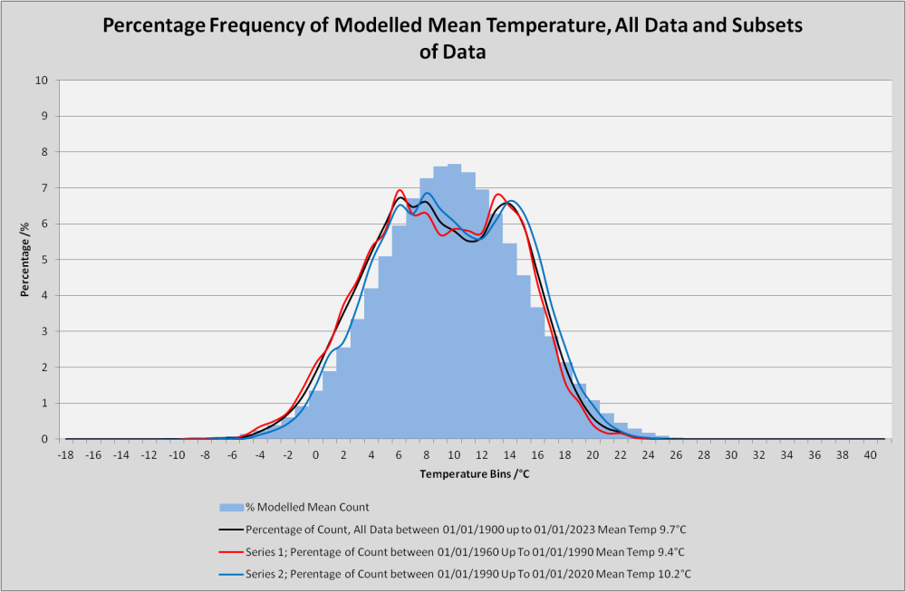

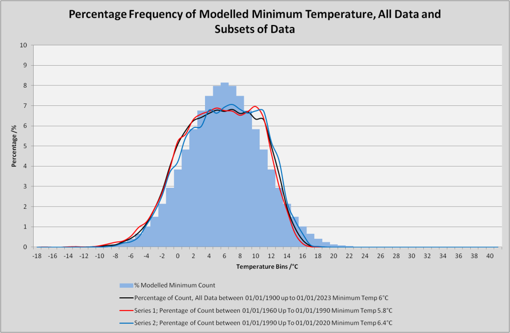

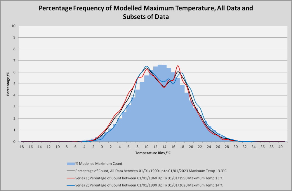

I don't think so.
The time spent at full load is very small. (plot the temperature difference each hour of the year as a load duration curve)
Lots will be spent in the happy 25-75% range if your unit is sized at 100% of design load.
E.g.
Annual-duration-curve-for-space-heating-and-DHW-demand_ppm.png.bfc43120c90a964fa3d4af61d7971e8a.png
From:
https://www.researchgate.net/publication/291352700_Stochastic_Modelling_and_Simulation_of_Energy_Flows_for_Residential_Areas
With VDI reference method from:
 VDI, “4655 Referenzlastprofile von Ein-und Mehr-
familienhäusern für den Einsatz von KWK-Anlagen,”
Verein Deutscher Ingenieure (VDI), pp. 3–18, 2008.
You can use hourly temperature data and a "balance point" to get similar curves for your choice of climate and building fabric standard.

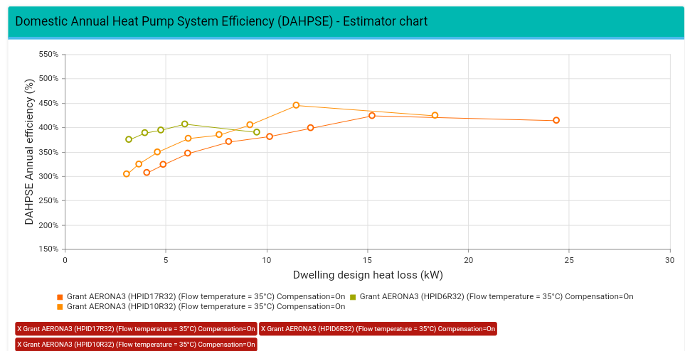

I'm beginning to wonder if there is a good argument for undersizing a (A2W) heat pump, particularly one with poor modulation range, or if not for deliberately undersizing, at least for erring towards undersizing, rather than the 'received wisdom' of erring towards oversizing then adding 20% for (insert your reason here).
The BRE model
 https://tools.bregroup.com/heatpumpefficiency/index.jsp and data seems to suggest their might be in at least some cases, although until I understand it I remain sceptical about some of the figures it throws up.
Without more robust data on the degradation due to both short and normal cycling, it's difficult to be certain.  However it's entirely plausible that having a supplemental electric heater and suffering a cop of 1 for 20% of the load 10% of the time (when the cop would otherwise be only about 2-2.5 anyway) is a good trade off vs compromising the performance for much of the heating season.

BRE have looked at this topic.
They have an online calculator/simulator you can play with.
TLDR, the simulator implies slight undersizing is beneficial mainly due to lower cycling most of the time outweighing the use of booster heating occasionally.
On 11/08/2023 at 09:20, Beelbeebub said:
Not sure if this has been posted before
Appears BRE have developed an efficency predictor tool based on more typical UK conditions than the SCOP calculation that manufacturers use in their literature.
Their calculation also includes system loads like pumps and backup heating as well as hot water loads.
Graph of HP efficency
One curiosity and I have to dig into the details) is that it appears the seasonal efficency (their version of SCOP) improves with undersized units using direct electric backup heaters for the few occasions needed. Their explanation is the reduction in cycling for the rest of the year more than compensates for the few days of inefficient direct heater use.

I think from what you've said, and other comments above, oversizing shouldn't be a huge issue hopefully on our system (because of the high modulation range) but could be on others. Seems like there is a key distinction between A2A systems (which generally have a higher ratio) and A2W; even more so with non-inverter systems. In both cases it may be preferable to undersize if anything and rely on a backup heat source for extreme conditions.
Worth checking how the HP modulates, some just open or close the expansion valve, that just reduces output without saving any input.

The one thing I would caution about modulation range, which I noticed from A2W units and may (or may not) apply to A2A....
The modulation range is generally quoted as the max and min outputs at a given temp.
So it may be a max of 12kw at - 5C and 3kw min at - 5C
So 4:1
Except you don't use the minimum modulation at - 5C. Thatvs when you need max power!
You need min modulation when it's warmer, say 10C or 15C.
Thr minimum a HP (at least the ones I looked at) can modulate down to at the higher temps is higher than at the lower temps - which is obvious really.
But that means the minimum you HP might be able to turn down to, when you actually need it to turn down, is higher than you might think. Say 5kw
When I looked at the "max at minimum vs minimum at maximum" values I was seeing a modulation ratio closer to 3:1
Does that make sense?
