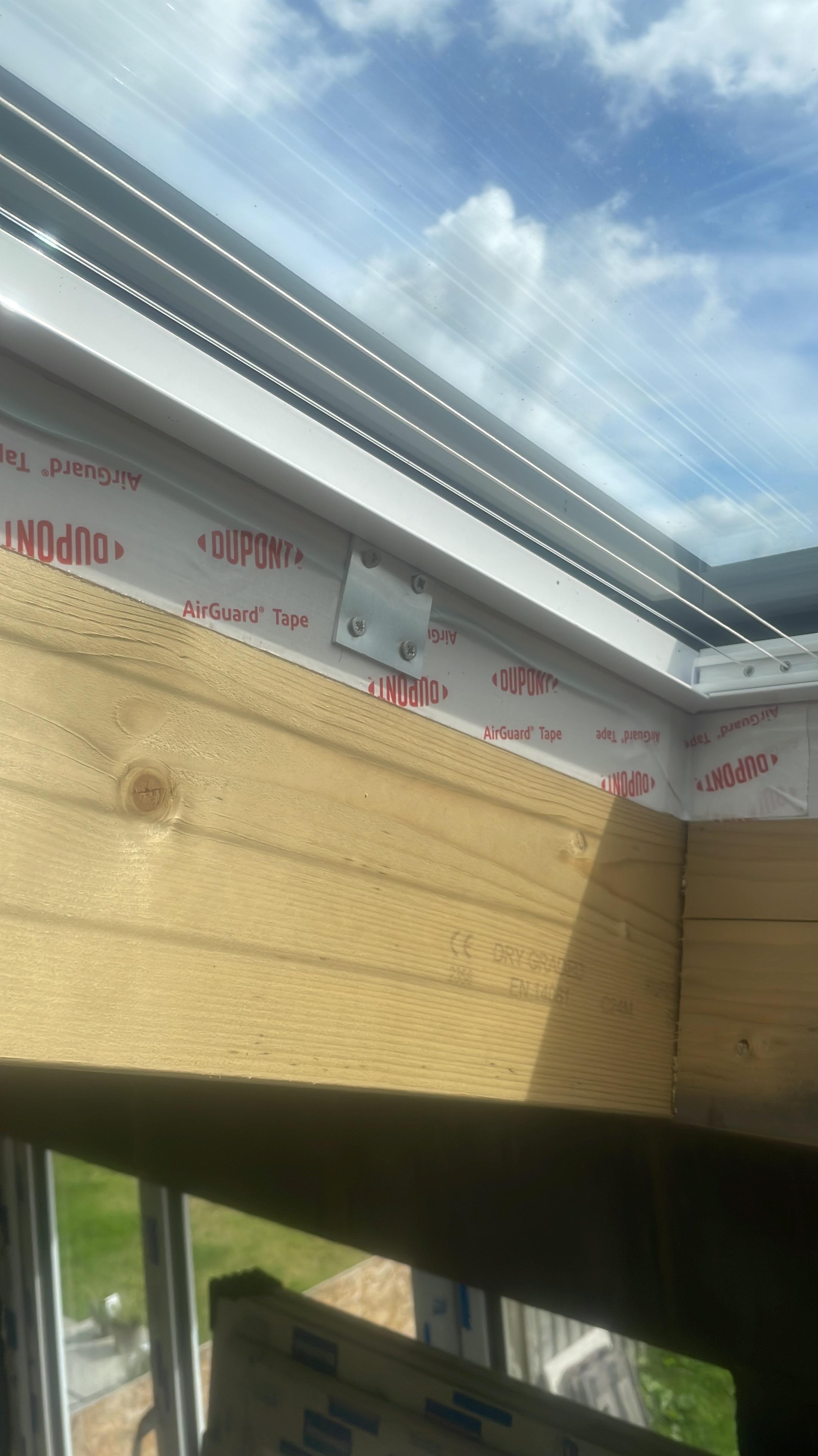

HughF Posted August 10, 2023 Share Posted August 10, 2023 I'm looking for a 2" wide air tightness tape to seal the corners joints of my cavity closers, and seal the front edge of the closer to the internal blockwork. From the numerous types available on greenbuildingstore, which one should I go for? It will need to live happily underneath d&d plasterboard reveals... Link to comment Share on other sites More sharing options...

HughF Posted August 25, 2023 Author Share Posted August 25, 2023 I got some tyvek stuff from Amazon, looks ideal. Very very sticky! Link to comment Share on other sites More sharing options...

HughF Posted August 26, 2023 Author Share Posted August 26, 2023 12 hours ago, Thorfun said: link would be useful to others looking for similar stuff. Tyvek Dupont AirGuard Single... https://www.amazon.co.uk/dp/B07VP4H2Z1?ref=ppx_pop_mob_ap_share 1 Link to comment Share on other sites More sharing options...
HughF Posted August 27, 2023 Author Share Posted August 27, 2023 Blimey this is tenacious stuff… anyway, it sealed where it needed to seal. Link to comment Share on other sites More sharing options...
Thorfun Posted August 28, 2023 Share Posted August 28, 2023 14 hours ago, HughF said: Blimey this is tenacious stuff… anyway, it sealed where it needed to seal. I needed an extra roll of airtight tape and bought this stuff to a) see what it's like b) didn't want to wait for tescon Vana delivery! it is very sticky and certainly does the job but, tbh, I prefer the Tescon Vana tape as I like the feel of the material type finish rather than the very plastic feeling AirGuard tape. but it seems to stick well. Link to comment Share on other sites More sharing options...
HughF Posted September 21, 2023 Author Share Posted September 21, 2023 Ended up sealing all the cavity closers back to the inner leaf and all the corners. It’s horrible stuff to apply into a corner as the release liner is paper, so you can’t easily pull it out from between things without it tearing, and it’s not a split liner. I foamed all the windows inside and out with fm330, didn’t tape the windows back to the closers because I ran out of time before the builders came back and boarded. What’s done is done…. Link to comment Share on other sites More sharing options...
