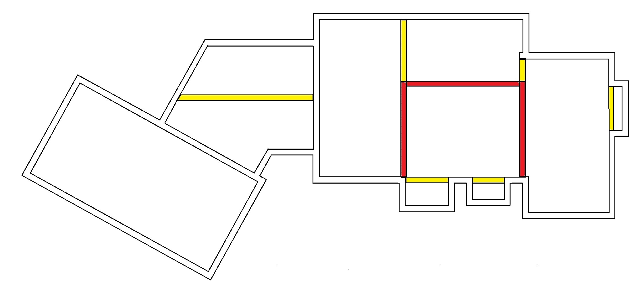

Vijay Posted August 23, 2017 Author Share Posted August 23, 2017 Is there any noticeable difference on soundproofing/deadening between the different blocks when used for internal walls? I've attached a basic sketch of the internal walls I need to build. The yellow are sleeper walls to support the B&B floor which I've been told I can do in 100mm blockwork apart from where 2 beams meet where it needs to be a 200mm wall (so I was just going to double up the block on those points). The red are internal load bearing walls which go up 2 floors. I'm going to use concrete blocks for the internal rising and sleep walls. I need to build up to between 270 and 300mm so how do I do that with standard sized blocks? I assume I'd have to cut the blocks? Link to comment Share on other sites More sharing options...
bassanclan Posted August 23, 2017 Share Posted August 23, 2017 You want some concrete coursing bricks. They are the same size as bricks, but made of the same material as your concrete blocks. Alternatively use engineering bricks, which are generally a bit cheaper. 10mm mortar block laid flat 10mm mortar block laid flat 10mm mortar 65mm brick = 285mm with no cutting 1 Link to comment Share on other sites More sharing options...
Vijay Posted August 23, 2017 Author Share Posted August 23, 2017 (edited) Thank you So can I just increase/decrease the mortar joint depending what I need? (between 270 and 300mm) Is there any other way of doing this in single skin/block upright (as it's less blocks for me to lay) or would that involve cutting blocks? I have a Stihl cut off saw if I need to cut blocks Edited August 23, 2017 by Vijay Link to comment Share on other sites More sharing options...
PeterW Posted August 23, 2017 Share Posted August 23, 2017 For the sleeper walls just lay them on the flat. Easier and quicker than cutting As @bassanclan says, concrete commons will help you build the levels up too at 65mm depth. Link to comment Share on other sites More sharing options...
Vijay Posted August 23, 2017 Author Share Posted August 23, 2017 Worked out I've got just over 40m of sleeper/internal rising walls which is approx 94 blocks. Do you think it would be quicker to lay 188 blocks and 188 bricks or 94 blocks (upright) and a course (188) of engineering/coursing bricks which would give me 300mm and cut down and blocks where I need to? Link to comment Share on other sites More sharing options...

bassanclan Posted August 23, 2017 Share Posted August 23, 2017 10mm mortar 215 block 10mm mortar 65mm brick =310mm which is too thick You mentioned doubling up to 200mm thick walls, laying blocks flat solves that problem. I personally would not use aerated blocks underground, nor if a wall was being rendered. I don't much like them for fitting kitchen wall cupboards to, but they are ok. Lightweight obviously have better insulation properties than denser blocks Link to comment Share on other sites More sharing options...
Declan52 Posted August 23, 2017 Share Posted August 23, 2017 Think you need to get your calculator out again. 1 10mm bed 1 215mm block 1 10mm bed 1 65mm brick 300mm. You use a standard block if price is an issue, they are the cheapest and the thermal properties don't matter. You use thermal / lightweight/ aerated if you want to boost the u value of the wall you are building or to provide a thermal break as you come out of the ground. I used aerated blocks on all my inside skin of my cavity build but every single internal wall was just a standard block. You won't need to use anything stronger than 7n blocks. Link to comment Share on other sites More sharing options...
Vijay Posted August 23, 2017 Author Share Posted August 23, 2017 Yeah in some places I need to have a 200mm wall but it doesn't make sense to build a 9m long wall at 200mm wide where I only need 200mm in a few places - so the idea is to build the whole wall at 100mm wide and double it only where I need it, as it's only to support a floor beam. Thanks Declan 46 minutes ago, bassanclan said: You mentioned doubling up to 200mm thick walls, laying blocks flat solves that problem. Yeah in some places I need to have a 200mm wall but it doesn't make sense to build a 9m long wall at 200mm wide where I only need 200mm in a few places - so the idea is to build the whole wall at 100mm wide and double it only where I need it, as it's only to support a floor beam. Thanks Declan. Plan is to use a Thermomax board for the thermal break and then I'll carry in in lighter 7n block Link to comment Share on other sites More sharing options...
