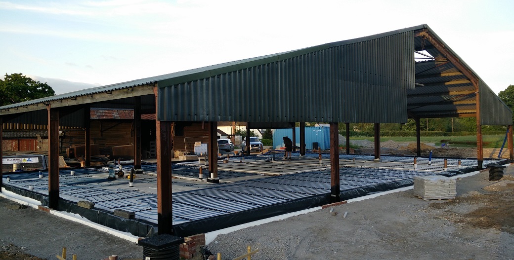

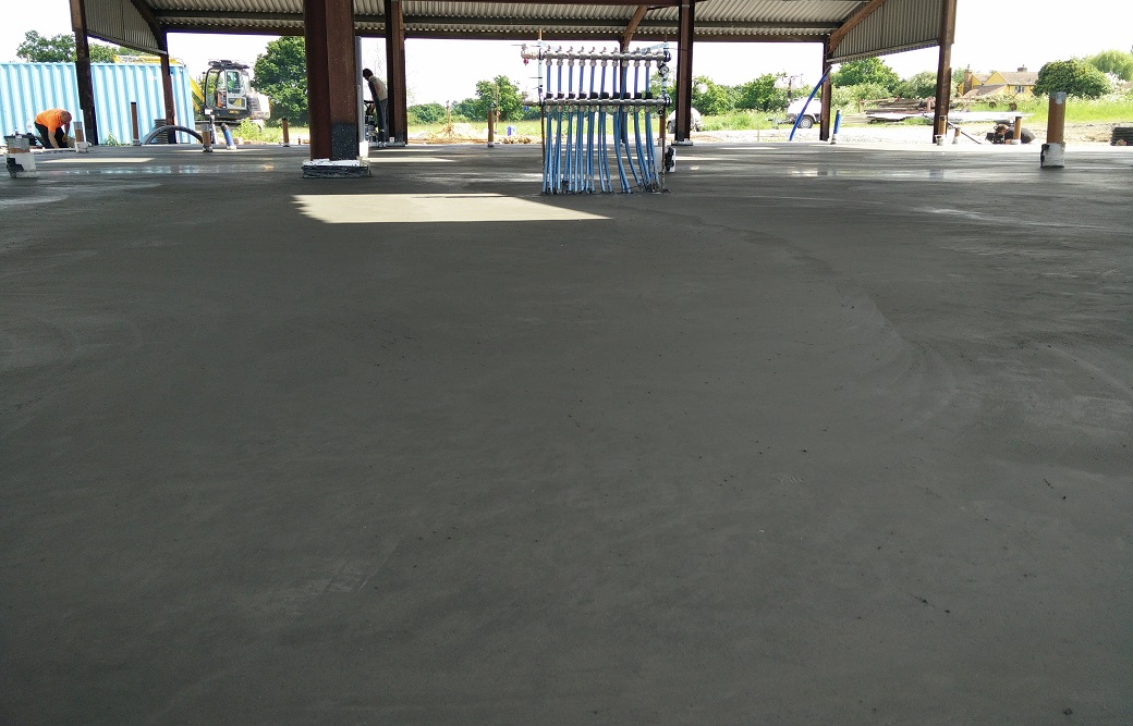

IanR Posted August 7, 2023 Share Posted August 7, 2023 (edited) 1 hour ago, Dunc said: I came across AFT: https://www.advancedfoundationtechnologylimited.co.uk/ I have an AFT raft, and can thoroughly recommend them. Engineered and supplied via Springvale, UFH Design and Supply included. They'll help with the Install if you wish to self-build or support your groundworks contractor. There's more on that list than when I was researching, which is good to see. I found a number of companies were over-Engineering their rafts though, and specifying much thicker rafts than were required. Here's mine Edited August 7, 2023 by IanR 1 Link to comment Share on other sites More sharing options...

IanR Posted August 7, 2023 Share Posted August 7, 2023 (edited) 59 minutes ago, Barny said: Has anyone come across one that can be used with piles? I am liasing with Abbey Pynford re their passive home safe foundations at the moment (having not been able to use MBC as we need piling due to soil and trees). Would like someone who can engineer, supply and fit. thanks Yep, AFT do a version of their "MonoBeam" Raft that can be supported on Piles https://www.advancedfoundationtechnologylimited.co.uk/our-products/ecoraft-monobeam/ You'd need to check about Install, I'm not sure they'd do the Piling, but would have thought any piling company could do that. They will do the Install of the Raft, but the way they'd do it is with one guy coming to your site and you providing two labourers to work with him. Edited to add: And their "Type L" Raft will go on piles. If you plan a timber-framed structure, I'd probably go with this, It's a simpler solution and is close in performance to their Passive Raft, which I have. https://www.advancedfoundationtechnologylimited.co.uk/our-products/timber-steel-icf-framed-building-foundation/ Edited August 7, 2023 by IanR Link to comment Share on other sites More sharing options...

Lee33 Posted August 7, 2023 Share Posted August 7, 2023 4 hours ago, IanR said: I have an AFT raft, and can thoroughly recommend them. Engineered and supplied via Springvale, UFH Design and Supply included. They'll help with the Install if you wish to self-build or support your groundworks contractor. There's more on that list than when I was researching, which is good to see. I found a number of companies were over-Engineering their rafts though, and specifying much thicker rafts than were required. Here's mine I’m curious, when they installed your UFH, did they separate the rooms into different zones, or is the whole slab being treated as one single zone? Link to comment Share on other sites More sharing options...

IanR Posted August 7, 2023 Share Posted August 7, 2023 1 hour ago, Lee33 said: I’m curious, when they installed your UFH, did they separate the rooms into different zones, or is the whole slab being treated as one single zone? I've split my area up into Zones. I can get quite a lot of solar gain in certain areas, so zones are good for me, allowing those rooms benefitting for the solar gain to not be heated by the UFH. 1 Link to comment Share on other sites More sharing options...
