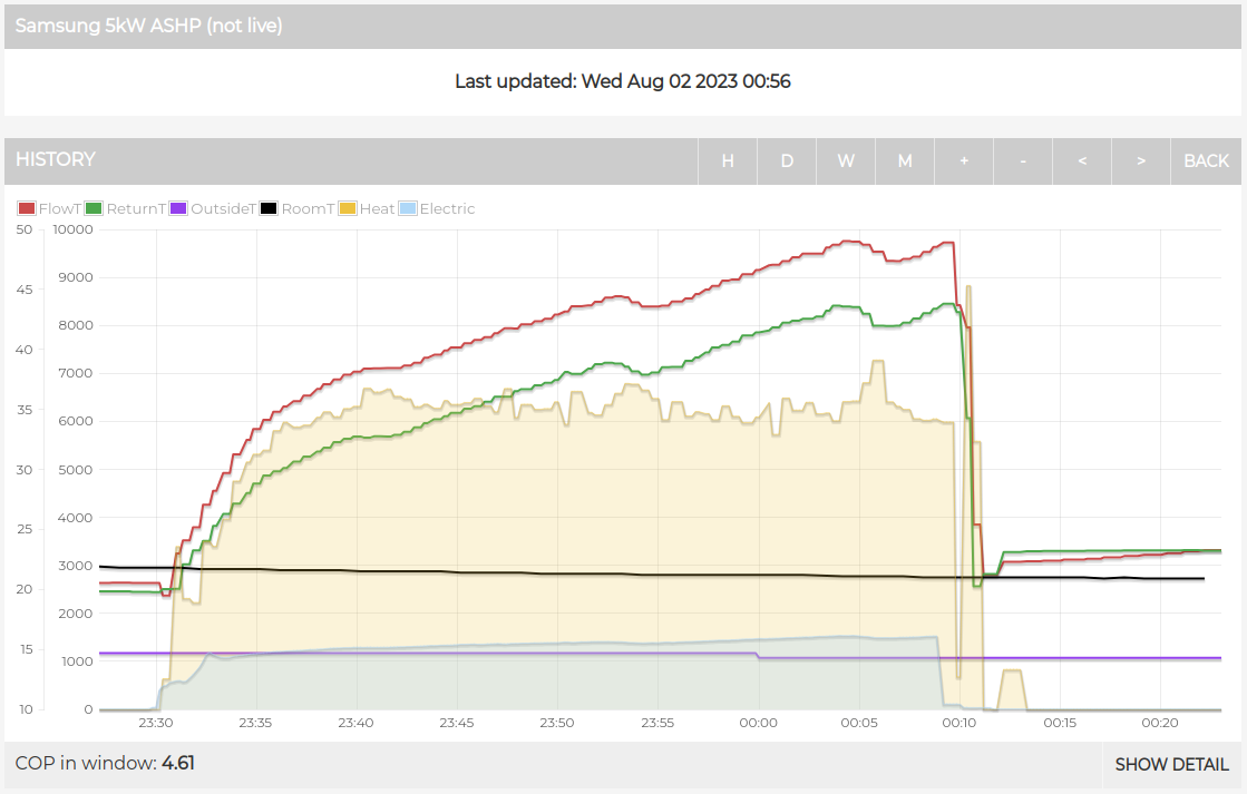

5kw Samsung with PWM pump doing a DHW cycle into a 1m2 coil.... The 150ltr slimline Vaillant HP cylinders that were £500 on ebay last year (I've got one waiting to go in, driven by a CE iVT-9)...
Just for relevance to the thread...
This is Glyn Hudson's DIY install, plenty of details on his YouTube channel. Replaced an LPG combi...
Hmmm!
Thoughts out loud:
This is:
- A 6 kW could input from a standard "low temp" F-Gas heat pump
- A cylinder setpoint of 42 degC, which best case gives 150 litres of shower water (allowing for some destratification), and then reheats at 6 kW
- And a NEW cylinder with decent insulation but perhaps more importantly a completely clean 1m2 coil that runs halfway up the cylinder.
Looks like it works nicely; heat pump wise; and it'll also have low standing heat losses etc. I'm sold on this being a functional option
The capacity is miniscule though due to the temperature it is being operated at. Works for a self confessed hair shirt. I perhaps wouldn't want to be the father selling this to a wife and 2.4 long haired daughters though. I would roll my eyes at it if buying the place.
If it were a more modern heat pump you could perhaps have 50C for the same COP; if reheated at the same rate. Still a relatively low capacity cylinder.
Now to the "miscellaneous old cylinder" option for a "typical retrofit" (rather than a brand new cylinder, purchased independently of the heat pump, either for reasons of necessity or due to poor planning)
It's for sure gonna have higher heat losses.
What is the coil? 0.6 m2 is quite different to 1.0 m2. Is it in the bottom of the cylinder only (trying to stir the thing up using convection currents) or does it extend through more of the cylinder? Is it clean, or has it been heated to 80C in the southeast of England and is there the usual 20 of scale on the coil / in  the  bottom of the cylinder? Was it ever big enough at 60C? Is it gonna be big enough at 42C or 50C? Did you want an invented to sack off all the roof tanks and pumps etc?
Given the small material cost of a cylinder vs a paid heat pump install, and the opportunity to get it all without VAT, would you be daft not to swap it? Probably.
Retail (what the fitter would charge) on those slimlines is 1165+VAT
https://midsummerwholesale.co.uk/buy/vaillant-heat-pumps/vaillant-cylinder-150l
Retail on the biggest baddest cylinder in that range is 1605+VAT
https://midsummerwholesale.co.uk/buy/vaillant-heat-pumps/vaillant-cylinder-300l
Some will say fuggit; do it. I think this is the reality of anybody serious about an upgrade.
Some will ask to reuse an old piece of shite with the potential to be a scale filled liability that was last touched by the fitter etc. Or cause complaints due to low stored volume.
The fitter will say naah, not worth the risk.
Now say the cylinder is relatively new. Say it might / will probably actually work.
If fitters are looking for work, and price is a consideration, they might entertain taking the time to check if they can use that and the risk of touching it last.
Reality: they're not looking for work. Demand exceeds supply. They're going to choose the jobs which pay the most. If you're interested in a new cylinder you'll get a fair price for a new cylinder. If you're not interested in a new cylinder you're going to get much the same price.
This only changes once supply exceeds demand.
The big boys and girls have additional constraints. BG evidently won't install ANYTHING other than in accordance with the manufacturer's backside covering instructions. Fitters won't get the leeway.
You can't DIY this because of the f**king MCS cartel. Not just the grant. It's not even legal. (planning)
Nor can you MCS space heating only. Not grant eligible.
And that's perhaps the kicker. Don't blame the installer for wanting to include hot water. They're obligated to otherwise the job costs £5k more. And if they're gonna do hot water to get the grant - you automatically increase costs by £5k by not doing hot water - to then they think you're daft for not going all out on maximum performance and pleasure and resale value, but perhaps can't articulate this in the best way?
I think MCS are f**ks and HMG are fools for promoting them. Just in case that wasn't clear before!
