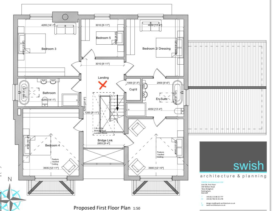

IanR Posted July 26, 2023 Share Posted July 26, 2023 (edited) 1 hour ago, richo106 said: It seems quite expensive, is this worth the extra money? What are the benefits? Can i use Ubiquiti AP's with any PoE switch? Ubiquity hardware is Enterprise level and therefore a little more expensive than consumer hardware but generally worth the money. Mine has worked seamlessly for 6 years needing only 1 or 2 reboots. But, maybe not that switch. It's a managed switch with loads of functionality that you are unlikely to use. Ubiquity APs will work fine attached to an unmanaged PoE switch, but, not all PoE are equal. I was just about to describe the 3 PoE types, but grabbing a suitable image highlights a fourth that I wasn't aware of: I believe the Unifi APs would work off a standard PoE connection, but I've not looked at the newer WiFi6 ones. Even if they did, I'd still recommend at least PoE+, as some CCTV cameras require that power level. When looking at the spec of a switch just check that all ports can be run at the power rating at the same time. Cheaper switches may not allow this. It's not clear on the marketing, but the Ubiquity UniFi range requires a Gateway console in order to set up the hardware, integrate them and give you all the functionality. You can install the software on a PC and use it that way, but the Gateway needs to be running if you want to use the smartphone apps, so it's better if it's on an always-on device. Some of the Ubiquity hardware includes the Gateway Console, but not the normal APs unfortunately. It may be worth considering a Ubiquity Dream Router (UDR), which will act as one Access Point, includes the Gateway Console and will supply x2 PoE outputs to drive 1 or 2 additional APs. It will need a little more planning though, as the best setup would be to turn your Sky Router into a bridge (assuming that can be done), and then route the WAN (broadband) connection through the UDR WiFi. That way all your WiFi will be under UniFi management . Re. CCTV. Simplest would be to have an NVR with integrated PoE Switch to control all the Cameras from. Makes that side of the install completely plug and play. Edited to add: If you go for a PoE+ Switch, something like this: https://www.netxl.com/poe-network-switches/netgear-16-port-network-switch-gs116pp-100eus/ I've not used this one, but I've found Netgear switches to just run and run. This is fanless also, which I struggled to find when installing my own network. Edited July 26, 2023 by IanR Link to comment Share on other sites More sharing options...

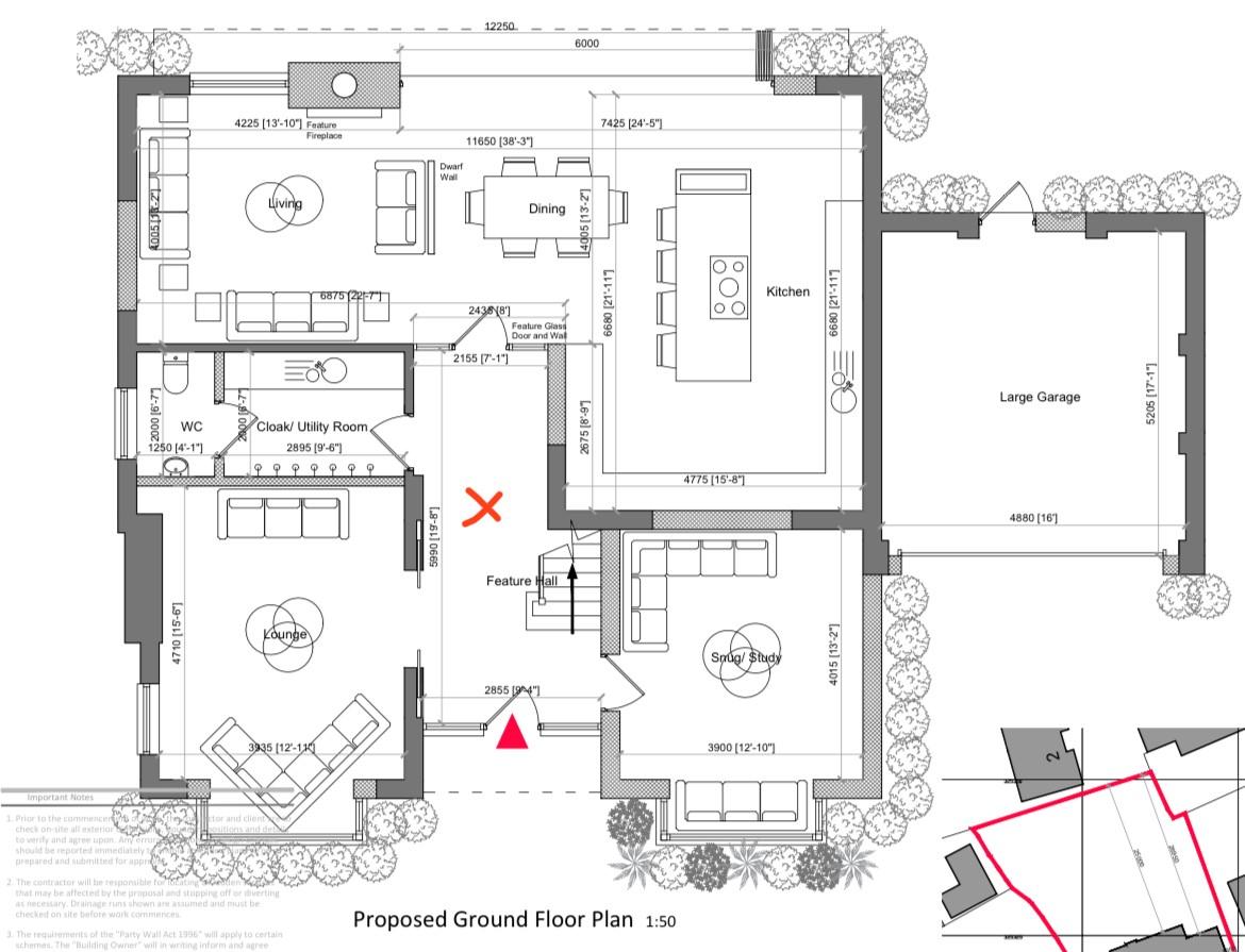

joth Posted July 26, 2023 Share Posted July 26, 2023 3 hours ago, richo106 said: I have been looking into Ubiquiti and have been recommended these: https://www.4gon.co.uk/ubiquiti-unifi-uap-ac-pro-indoor-outdoor-access-point-uapacpro-p-6638.html If i put one on the ground floor and one on the first floor in a central location...would this be sufficient in peoples opinions? I have tried to find details on range/coverage etc and it says 122m...that seems a lot (to me anyway) Personally I found the unifi design tool fairly useless, it seems to want one WAP per room, I wonder why 🤔 My standard approach is 2x on ground floor in opposite corners and 1x on the top floor high up centrally. This way viewing it as a 3D object you get less overlap (more total coverage) in the spherical balls of signal out of each WAP. Put the ground floor pair to maximise coverage (minimise distance) to places people will spend most time - so in dining /living room and snug, or kitchen and lounge. Secondarily position them to give best use of outdoor coverage, front door, driveway and back garden. Position then high up both to give better range on the floor they're on, and reduce distance to people lying in bed above. And the disc shaped unifi WAPs should alway be horizontal. So ceiling mount is great, maybe slightly hidden above high kitchen units or fitted furniture. If you find this is insufficient make sure you have plenty of wall ports and any of these can be swapped to a wall mount wap to fill in dead spots or reduce congestion. Putting one in an office for example. HTH Link to comment Share on other sites More sharing options...
