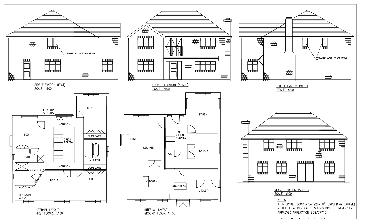

flanagaj Posted July 23, 2023 Posted July 23, 2023 So the plot we are in the process of trying to secure has planning permission for a 4 bed property. I personally, think the design and interior layout is pretty naff. There is a 1960s chalet bungalow property next door and on the other side of a pedestrian walkway is a 1970s style development. Just wondering whether you could potentially get away with something more aesthetically pleasing on the eye and what basis the planners could refuse the revised application on? Ideally, we'd like something a little more contemporary than what has been granted.

Alan Ambrose Posted July 23, 2023 Posted July 23, 2023 My feeling is that the architect will have done whatever he or she thinks will get through planning with the highest probability to secure the landowner their £ prize. That establishes the principle and a min GIA etc. If you don't like that, you can reapply with something you do like. A quick pre-app or informal chat withe the LPA if you can arrange it with an idea of what you would to get a reading. Even better if you can do that before purchase. Once you have drawings for planning, it might take anywhere between 8 weeks and a year for the LPA to process your application.
Alan Ambrose Posted July 24, 2023 Posted July 24, 2023 BTW the LPA don't care about the interior layout - assuming it's fairly 'home-like'. You can probably change that without a full application.
Papillon Posted July 24, 2023 Posted July 24, 2023 (edited) Mate, if a customer came to me with that as a site to design you a new house I’d be kissing the ground you walked on. They have really done you a solid there, that’s massive and ugly so you’re probably going to get something great there. I wouldn’t see any issues for you even not knowing the area to be honest. By looking at that circulation, you could improve your layout and get massive rooms. I wouldn’t bother with a pre-app. Just go in with a nice contemporary design on that footprint (you could maybe move the gable to the middle if you like). Full planning, go for it. Edited July 24, 2023 by Papillon 1
Thorfun Posted July 24, 2023 Posted July 24, 2023 20 hours ago, Alan Ambrose said: My feeling is that the architect will have done whatever he or she thinks will get through planning with the highest probability to secure the landowner their £ prize. That establishes the principle and a min GIA etc. If you don't like that, you can reapply with something you do like. A quick pre-app or informal chat withe the LPA if you can arrange it with an idea of what you would to get a reading. Even better if you can do that before purchase. Once you have drawings for planning, it might take anywhere between 8 weeks and a year for the LPA to process your application. +1. if you like the plot then buy it and apply for planning for something you like. the existing planning will still remain if they refuse your new design anyway so you can either cut your loses and sell the plot with that planning or build the house as is and then flog that and move on. 1
