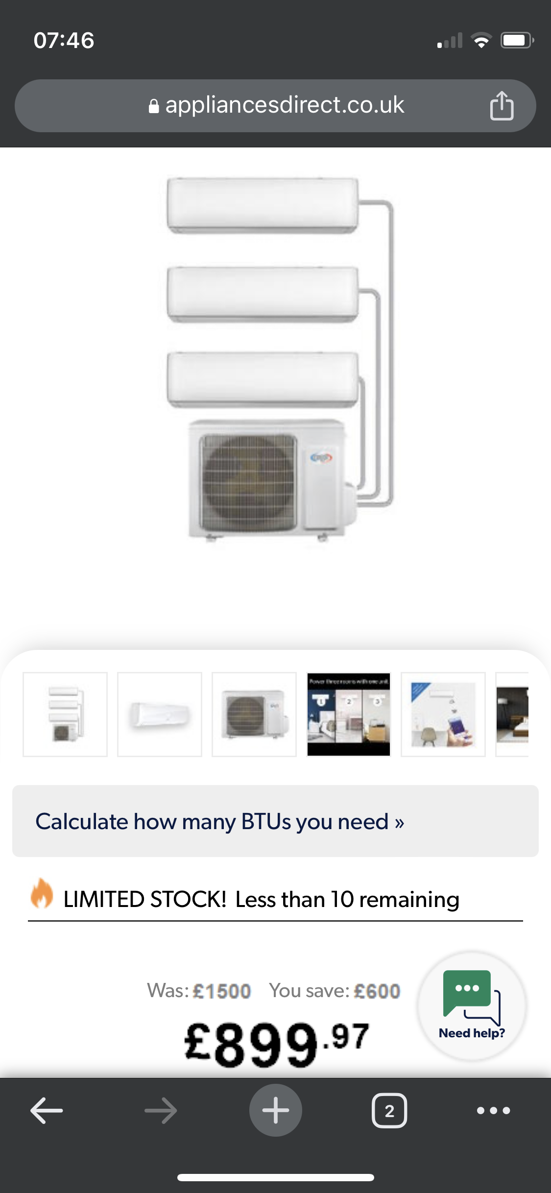

HughF Posted August 5, 2023 Share Posted August 5, 2023 Meanwhile, over in air-air land…. This would heat your average terraced house no problem at all… sunamp for the dhw, job done. 1 Link to comment Share on other sites More sharing options...
JohnMo Posted August 5, 2023 Share Posted August 5, 2023 14 minutes ago, HughF said: Meanwhile, over in air-air land…. Or possibly the "real world" this is the real solution to the mass roll out of heat pumps. Easy to install, not expensive, no piss poor CoP to worry about. Competitive price wise with a normal boiler. Issue is general public perception, they think Aircon, expensive to run and cooling only. 1 Link to comment Share on other sites More sharing options...

JamesPa Posted August 5, 2023 Share Posted August 5, 2023 (edited) 4 minutes ago, Beelbeebub said: A2A has real potential if a few hurdles can be overcome. FGas certification - we need either low cost, effort certification so ordinary plumbers can add it to their offering with minimal outlay. Or we need DIYable systems. The issue is wemeither have FGasses like r32 where the problem will be DIYers venting it left right and center or hydrocarbons like r290.wjere there may be issues with safety. That said, r290.has been used been used in Chinese and Indian markets for a decade and I don't think there has been a major issue. R744 (CO2) has potential but I don't think anyone makes A2A splits. Not suremif it's a technical thing or a demand thing. Is there any reason why gas safe plumbers can't do R290. Isn't it just propane, which surely at least some do for both commercial and domestic where mains gas is not available (eg off grid or mobile vans, boats etc). Have I got this wrong. Maybe the caravan and boat plumbing industry has a new lease of life? Edited August 5, 2023 by JamesPa Link to comment Share on other sites More sharing options...
Beelbeebub Posted August 5, 2023 Author Share Posted August 5, 2023 The development of a really easy to DIY/handyman level ecosystem for A2A would be crucial. If you could get trained on fitting a unit on a.£200nday course, the equipment was a few hundred £ and the units were £2-3k, plus relaxed planning. It would take off. The priority would be for electric only properties, you would get an instant cost saving and you can leave the DHW as is for later. Maybe when the appropriate cylinders become available. That's a big market. Link to comment Share on other sites More sharing options...
Beelbeebub Posted August 5, 2023 Author Share Posted August 5, 2023 8 minutes ago, JamesPa said: Is there any reason why gas safe plumbers can't do R290. Isn't it just propane, which surely at least some do for both commercial and domestic where mains gas is not available (eg off grid or mobile vans, boats etc). Have I got this wrong. LPG I think. If they just added it as an add on for gas safe qualified, like £100, an online course with a few videos and questions at the end. Would be an easy way to "train up" the workforce. Link to comment Share on other sites More sharing options...
Beelbeebub Posted August 5, 2023 Author Share Posted August 5, 2023 Planning would need to change so sticking a (certified) box on the wall is totally allowed. The certified boxes would have already met noise standards etc.aybe lock off the cooling function to high 20's to prevent extra consumption form people running cooling too much. Need to get aesthetic options out there, eg offer case colour options other than white (or just make them easy to spray paint, provide masks in the box for grilles etc). Link to comment Share on other sites More sharing options...
JamesPa Posted August 5, 2023 Share Posted August 5, 2023 (edited) 24 minutes ago, Beelbeebub said: LPG I think. So far as I can tell 'LPG' = either propane or butane. The red bottles, typically 6-13kg, for boats and caravans are propane. There is a separate lpg qualification, but it's advertised as being an easy conversion from gas safe. Doesn't sound like an insuperable problem and, AFAIK, A2A with its wide modulation ratio doesn't require accurate sizing. In a commercial environment I've seen installers walk in, take a look at the room, decide on a unit, fit it, and you get a cop of 4 no problems. Perhaps this is a more natural route for plumbers than A2W with its requirement for accurate sizing? Edited August 5, 2023 by JamesPa Link to comment Share on other sites More sharing options...
HughF Posted August 5, 2023 Share Posted August 5, 2023 R290 a2a doesn’t require any certification iirc. As long as the refrigerant charge is sub 900grams. Apart from the fact that the uk will end up looking like the back streets of Changhai, with a box hanging off the wall, I don’t think there’s anything holding the technology back apart from chronic lack of understanding by most people about how good they are. 1 Link to comment Share on other sites More sharing options...
JamesPa Posted August 5, 2023 Share Posted August 5, 2023 (edited) 19 minutes ago, HughF said: Apart from the fact that the uk will end up looking like the back streets of Changhai, with a box hanging off the wall, I don’t think there’s anything holding the technology back apart from chronic lack of understanding by most people about how good they are. That's a real issue, particularly for flats, terraces and rows of otherwise similar houses where multiple different units placed at different locations relative to the architectural features have the potential to look truly awful. Having said that it's not necessarily insuperable with some intelligent thought. Solving it however limits personal choice, puts prices up and most likely would end up requiring MCS or equivalent to 'guarantee' that the visual standards are met. In fairness the same problem arises, in those locations, with a2w so we have to solve it or just suck up the changes in appearance. Flats are more common in parts of continental Europe than here, and ashp installation is proceeding faster. So it's not improbable others will show the way. Edited August 5, 2023 by JamesPa Link to comment Share on other sites More sharing options...
HughF Posted August 5, 2023 Share Posted August 5, 2023 15 minutes ago, JamesPa said: That's a real issue, particularly for flats, terraces and rows of otherwise similar houses where multiple different units placed at different locations relative to the architectural features have the potential to look truly awful. Having said that it's not necessarily insuperable with some intelligent thought. Solving it however limits personal choice, puts prices up and most likely would end up requiring MCS or equivalent to 'guarantee' that the visual standards are met. In fairness the same problem arises, in those locations, with a2w so we have to solve it or just suck up the changes in appearance. Flats are more common in parts of continental Europe than here, and ashp installation is proceeding faster. So it's not improbable others will show the way. I’ve been spending a lot of time in Northern Europe for work this year. Air-air units installed on balconies of flats seem popular. 1 Link to comment Share on other sites More sharing options...
Beelbeebub Posted August 5, 2023 Author Share Posted August 5, 2023 It's the visual aspect that's the problem, particularly for flats. The servicing issue when they are 7 floors up is not trivial either. If the flats have balconys (as quite a lot of purpose built do, then that might be an option. In the block I look after there are two stariwells next to each other with a party wall (was a Victorian spa, apparently they had seperate mirror wings for men and women including lobby and stairs!)I have wondered about placing the units in the stairwells (they are huge) with one stairwell "intake" and the other "exhaust". Would be very convenient for flats and servicing, no planning either. Noise would be an issue, plus one stairwell would be warm and the other cold! Link to comment Share on other sites More sharing options...
HughF Posted August 5, 2023 Share Posted August 5, 2023 You can ignore servicing with air-air, they’re basically unserviceable. Run it till it breaks then install a new one utilising the same line set. Link to comment Share on other sites More sharing options...
