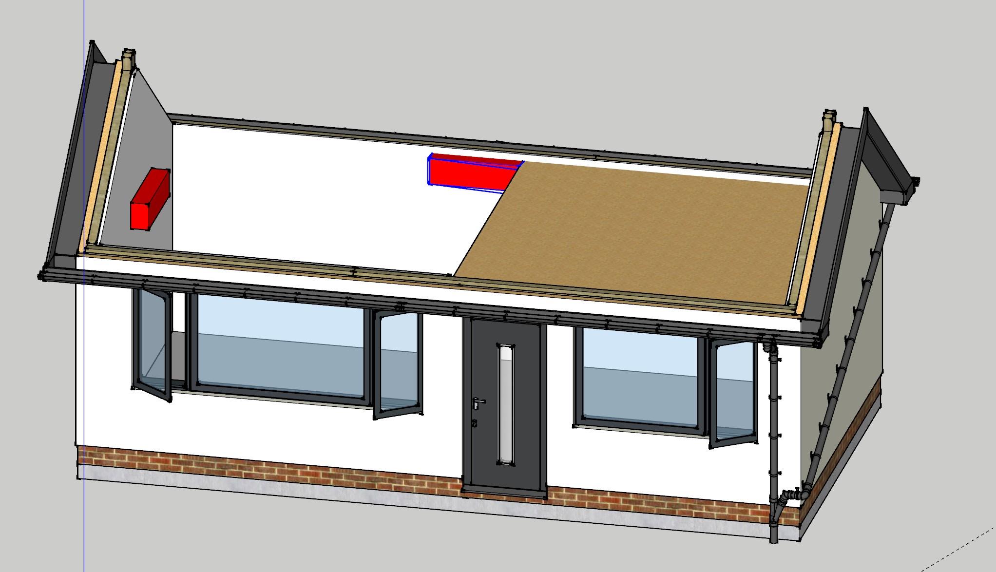

anarres Posted July 19, 2023 Share Posted July 19, 2023 Hi, I have built an office in the garden (32sqm) and I am looking for advice on how best to heat it in the winter. I'm leaning towards electric UFH but maybe this isn't right. If UFH is the right choice I'm not sure on if my proposed construction would work (and I can't easily find info on this online). There is a concrete slab base with good insulation underneath, and I have 70mm - 75mm to the final floor height. I was looking at levelling the slab base (it's up to 10mm low in a couple of places but generally pretty flat) putting 50mm XPS insulation down, an electric heating mat on top, with floating engineered or laminate floor to finish. The first question - is electric underfloor heating so slow to heat up that I'm better off with wall mounted IR heaters or something else? I'll be using the office for 8 hours a day, 5 days a week so super-reactive heating isn't really required, and I don't mind it a bit chilly in winter as long as it's not totally freezing. The office itself is fairly well insulated (see below). My second question is can I put an electric mat straight on top of 50mm insulation, or do I have to use thinner insulation board with a screed on top? I'd prefer the first option because it's both easier to do (by myself), and more importantly would push more of the heat into the room rather than heating the slab below. If it helps the office construction is: 8m x 4m external size 7.6m x 3.6m internal size Built on concrete slab 170mm thick (reinforced), with 200mm XPS insulation underneath. Wall construction: plinth of 3 courses engineering brick (225mm high), then 100mm timber frame construction with glasswool insulation between and 80mm wood fibre and render externally, and 25mm PIR + plasterboard internally. Roof construction: 125mm rafters with glasswool between and 25mm PIR + plasterboard internally, tiled externally Final note - there is no hot water or gas out here (40m from the main building) so electric is the only option for heating one way or another. Link to comment Share on other sites More sharing options...

anarres Posted July 20, 2023 Author Share Posted July 20, 2023 (edited) Thanks for the responses everyone, much appreciated. 😀 I've been down an A2A heat pump rabbit hole the last day or so and it looks very promising. If it's ok I have some follow-up questions... Near the top of the list of requirements for me is noise followed by reliability and then cost - are there any brands which you would recommend or avoid? Are there websites you would recommend or avoid? I read that you should take cubic volume and multiply by 5 for a BTU rating which gives me about 15000BTU. Looking at an 18000BTU unit the max amps are under 10, so I'm guessing running it on a dedicated 16A line would make sense? I also read you must have a split unit professionally installed - is this correct? Is there an actual danger to doing it yourself if you are a competent DIY-er (like refrigerant gas leaks??)? I guess it's going to add a few hundreds to the price to get it professionally done and I've not needed any assistance so far with building the office (other than having to get electricial sign-off). I have a question about placement - my room is a rectangle (approx 8m x 4m), with a standard gable roof (2.4m room height with another 1.6m height on the roof). Half the space has a ceiling and the other half is open to the roof. The door (and 2 windows) are all on one of the long sides. I can either place this unit in the middle of one of the small walls (@2.4m high) - this wouldn't look great TBH but circulating air would probably move around the space better. The other option is to place it in (near?) the middle of one of the long sides, opposite the door, and just on the corner where the half-ceiling ends (so just under 2.4m). I'm guessing in the middle of the short wall where it can blow in to the open roof space as well as down the long room is better, but would the other position not work or is it possibility an acceptable trade off? I've attached a pic of the office with roof removed and the two positions marked. Edited July 20, 2023 by anarres Link to comment Share on other sites More sharing options...

TonyT Posted July 21, 2023 Share Posted July 21, 2023 Put the indoor unit so it isn’t blowing directly at you. high level wall mounted with the exterior unit through the wall to keep the pipe runs nice and short Link to comment Share on other sites More sharing options...
