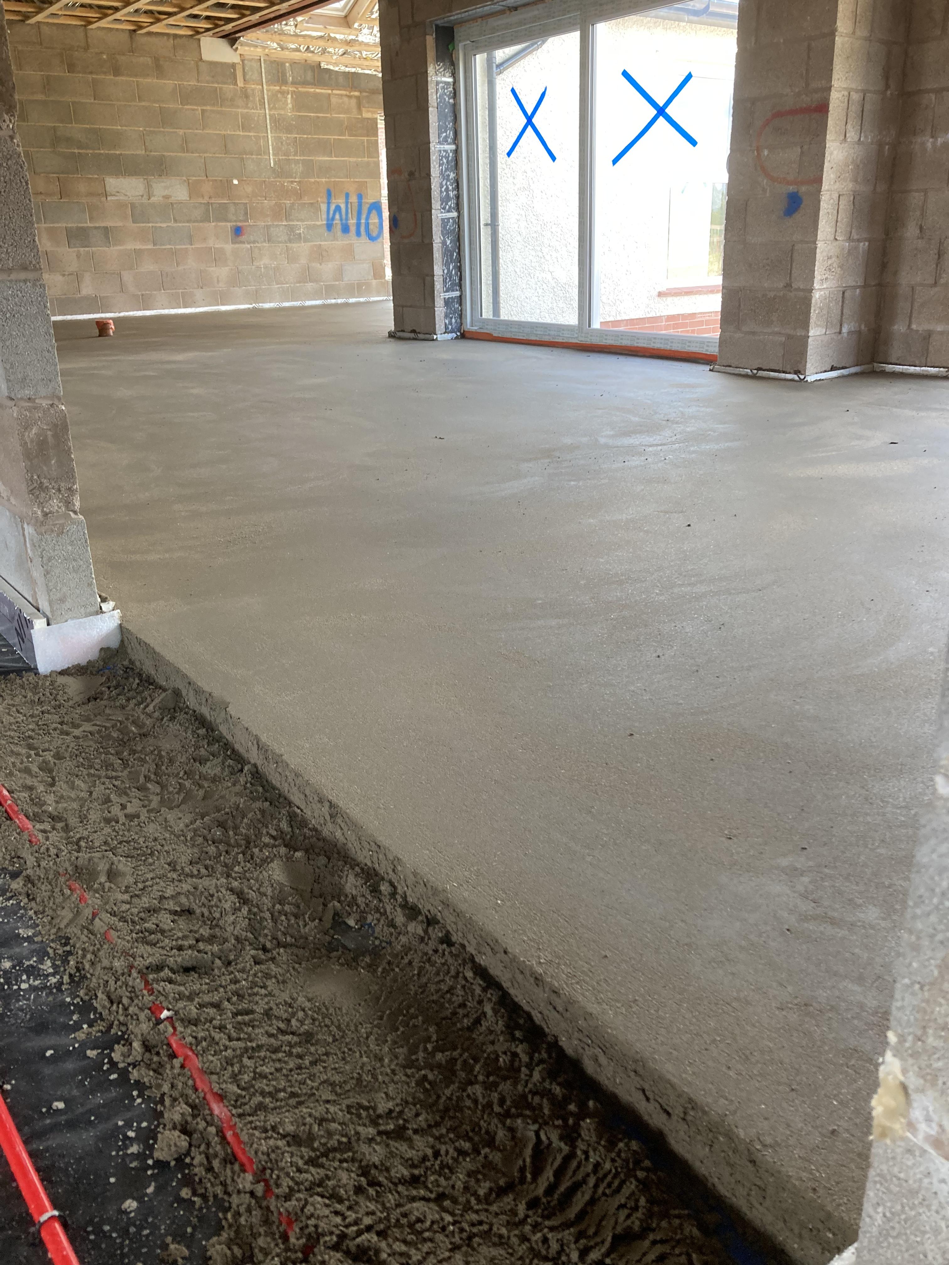

nod Posted July 17, 2023 Posted July 17, 2023 14 ton down today another 14 tomorrow and the screed out of the way I going to bring a company in to do a flow screed But I’ve been on a couple of job’s recently where they have lifted I went with what I know in the end Shame really as I don’t bother putting matting down with flow screed Unless it’s specified 4

nod Posted July 17, 2023 Author Posted July 17, 2023 36 minutes ago, Dave Jones said: not a fan of flow screed either. Yeah Dave I fully intended using flo screed as it great for tiles and great to let someone else do it Nearly 62 now 😁 The problem with flow seams to be it getting under the insulation I think the trick would be to let the screeding company do the membrane and taping up
Thorfun Posted July 17, 2023 Posted July 17, 2023 8 minutes ago, nod said: The problem with flow seams to be it getting under the insulation I think the trick would be to let the screeding company do the membrane and taping up or do the membrane and taping yourself so you know it's done right! then get someone to do the flow screed. 😉
Dave Jones Posted July 17, 2023 Posted July 17, 2023 33 minutes ago, nod said: Yeah Dave I fully intended using flo screed as it great for tiles and great to let someone else do it Nearly 62 now 😁 The problem with flow seams to be it getting under the insulation I think the trick would be to let the screeding company do the membrane and taping up screeding is a trade and a skill i think. pumping liquid just doesn't seem the same.
Kelvin Posted July 17, 2023 Posted July 17, 2023 1 hour ago, Thorfun said: or do the membrane and taping yourself so you know it's done right! then get someone to do the flow screed. 😉 I did all of mine. I also ran it up the walls a bit and up the windows which impressed the screeders as most folk don’t bother and it can make a right mess. No problems so far. The screeders showed me pictures of some right disasters though that they’ve had to try and fix. What a mess some of them were. The worst was straight onto the foil backed insulation. Bubbled up and lifted everywhere.

Thorfun Posted July 17, 2023 Posted July 17, 2023 17 minutes ago, Kelvin said: I did all of mine. I also ran it up the walls a bit and up the windows which impressed the screeders as most folk don’t bother and it can make a right mess. No problems so far. The screeders showed me pictures of some right disasters though that they’ve had to try and fix. What a mess some of them were. The worst was straight onto the foil backed insulation. Bubbled up and lifted everywhere. Did all ours too. Screeders said it was all top notch. Also regaled me with tales of horror preparation work!
