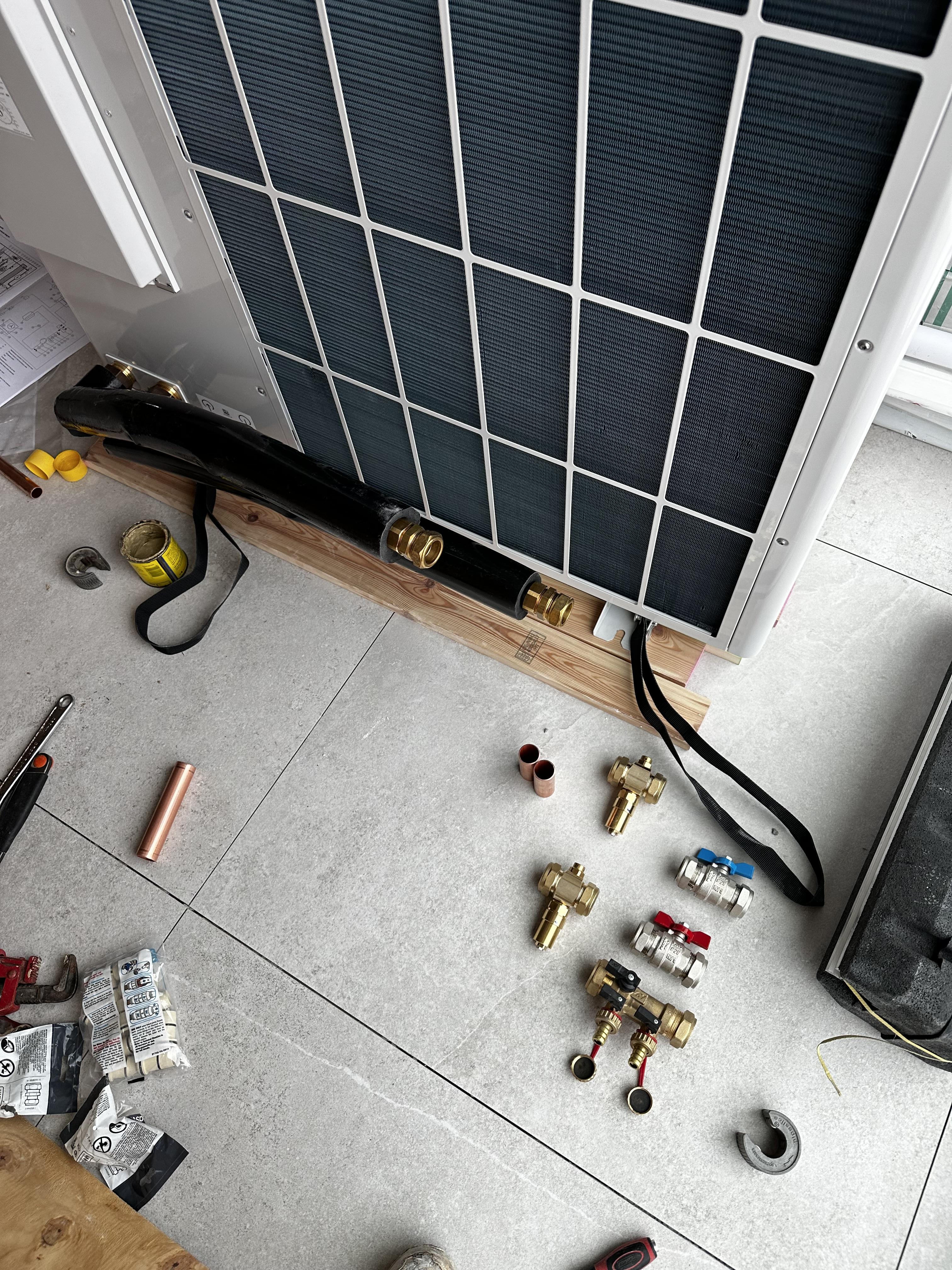

Hi all,
as titled.
installing AeroTherm Plus.
daft question but what order and where do I install the:
- antifreeze valves. Outside last point before the heat pump ?
- y strainer just behind antifreeze in flow?
- flush fill valve in flow presumably inside?
- flow and return stopcocks presumably inside?
i tried researching but there is no diagram anywhere. Clearly, if you know you know…
pic for reference:
also on the pressure reducer do I just blank two tappings out of 5?
As far as know anti freeze valve are basically anywhere in the outside pipe work. I would place close to the ASHP though.
I know the advantages of anti freeze valves, but I chose to just install 20% antifreeze. Worst case for me was, I was away, anti freeze valve opens, heating system depressurised, wife can't, repressurise heating system, so heating remains off until I get home. Me in dog house.
Strainer should really be inside not outside. But accessible for cleaning. Same for fill valves.
I have my isolation valves direct to heat pump. But depending on pipe length outside, they could be immediately inside house.
Remember you need an expansion vessel.
What's the pressure reducer for?

One anti-freeze valve, on the lowest point, by the heat pump itself. Sell the other one on eBay.
Ditch the fill/flush valve, they are chronically restrictive. I bought one then promptly put it in the scrap pile.

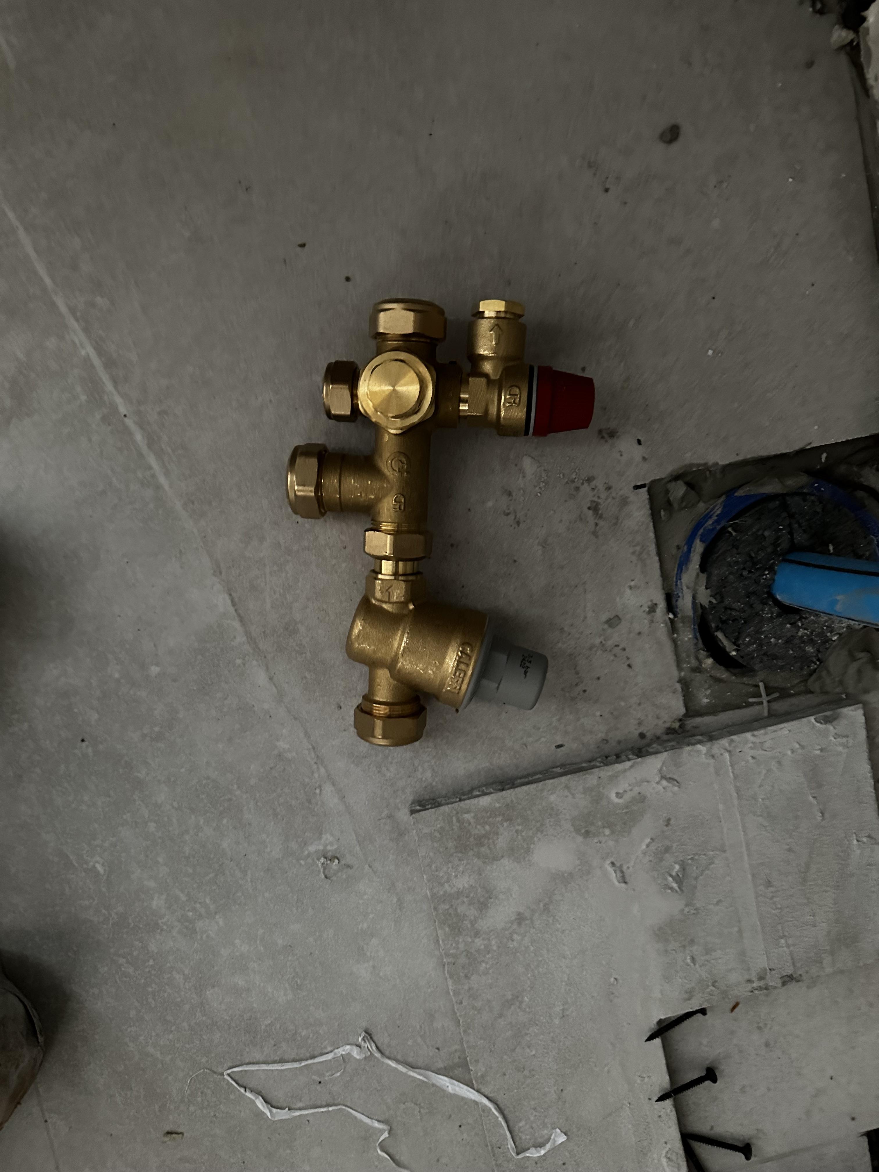

I am using Unitower and that has an expansion vessel on the intake of cold water to the system. I think there is also a built-in expansion vessel for the central heating circuit.
The pressure reducer is for the water inlet, and looks like the below (and I could not work out why so many outlets):
How do you then fill it?
Fit a filling loop.
Just now, Triassic said:
Fit a filling loop.
I would find the valve a lot cleaner solution (and quicker, and I have already bought it...)
If it restricts the flow don't use it. Look at the specs of the valve vs the flow/pressure and take a decision. There is more to this job than just connecting pipes/valves without leaks.
runs on 28mm diameter which is full bore. I think I will triple check .
I have what looks to be same filling valve, circulation pump doesn't seem to have any issues flowing it's duty rate of 1m3/h through 9 UFH loops, and 12m underground before getting to the house, using 28mm pipe. (No other pumps in the UFH system).
Is that the safety group for your cylinder, so you may need G3 installer?
yes, and yes I will no doubt need someone to sign it off.
If you can’t find a plumber to sign off your work (not many will) then you’re left with either the ignore option, or the ‘pay the local bc to inspect’ option.
