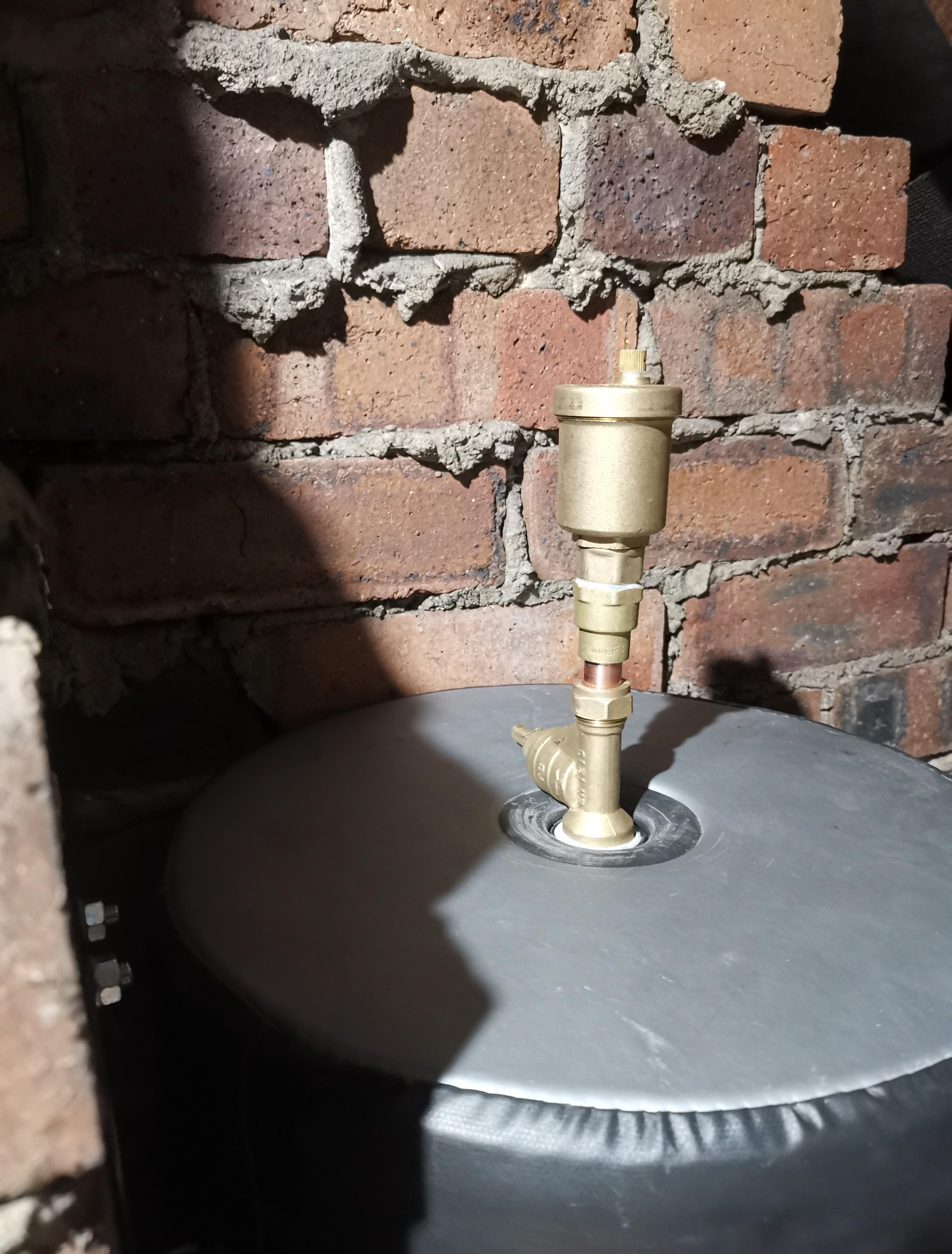

Super_Paulie Posted July 15, 2023 Author Share Posted July 15, 2023 Actually don't have the room underneath the tank now, the tap and drain will hit the floor. Jesus, what an ordeal. Ok so I can flip the tank and have the stupid tap/air valve combo on top, just need a 15mm - 1/2 adaptor. Been a crazy time this... Link to comment Share on other sites More sharing options...

Super_Paulie Posted July 17, 2023 Author Share Posted July 17, 2023 NTP fitting... No joy, still binds up immediately. Ok so that's pretty much every fitting available so it's obviously got a thread issue. I'm going to go with the tap on the top, going into a 15mm and then the air valve. @Nickfromwales I hope you think this will do the job? 1 Link to comment Share on other sites More sharing options...
Nickfromwales Posted July 17, 2023 Share Posted July 17, 2023 Have you not tried a 1” tap to recut the thread? I can’t remember where we got to with that. If the stopcock works then crack on. They’re good for 10bar and that’ll rarely see north of 2bar. 👍. It’s time to end this madness, so “make it so, number two”. 🫡 Link to comment Share on other sites More sharing options...

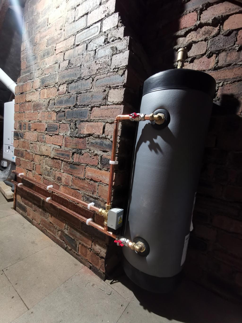

Super_Paulie Posted July 18, 2023 Author Share Posted July 18, 2023 Just a mock up with old bits of pipe but I think it'll go in just fine. Been a long road, but fingers crossed, never even thought about the diverter valve before so hopefully that'll be dandy once rigged up to the rad zone valve. Link to comment Share on other sites More sharing options...
Super_Paulie Posted July 24, 2023 Author Share Posted July 24, 2023 Just to finish this whole drama and say cheers to you guys for the help, the tank is in and pressurised. Although I have a daft tap on the top (I reversed the tank) going into a compression-solder-1/2 bush it holds just fine. No idea what the problem was but I have no doubt that this will work out ok. The tank is wall mounted, even though I could have had a free standing one, the Cordivari was the exact width I needed to go in this location without jutting out and meant my pipe work was a lot simpler. I've tested the diverter valve and it works, just need to rig it to the rad 2 port in the room below. So I can move on finally, cheers guys and thanks. 👍 Link to comment Share on other sites More sharing options...
