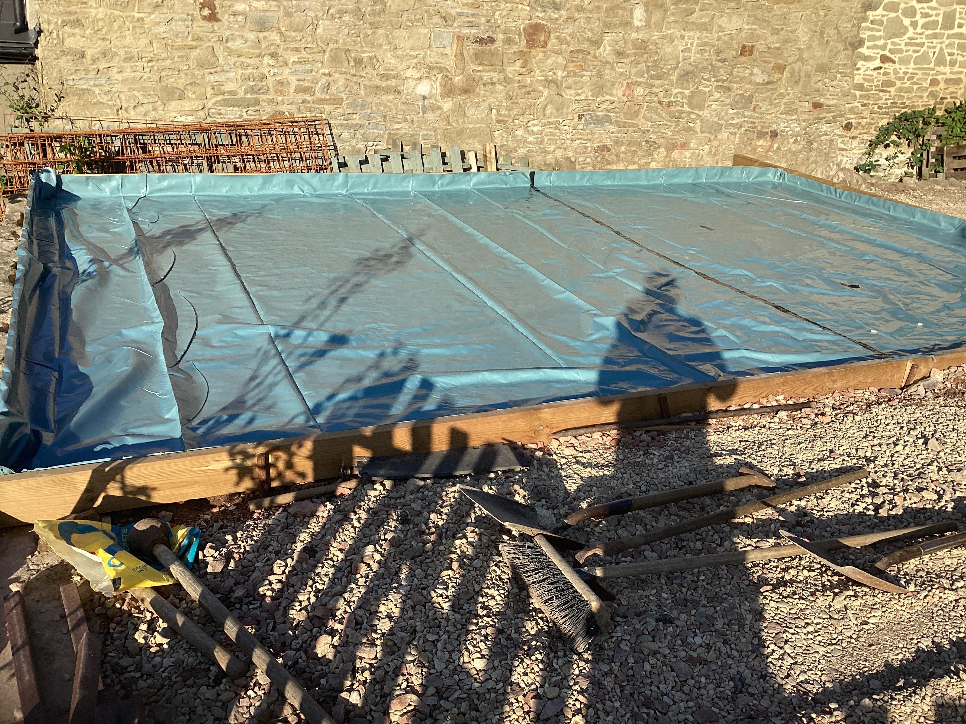

joe90 Posted June 29, 2023 Author Share Posted June 29, 2023 Not putting DPM down till nearer pour day, end of next week, so it does not fill with water when it rains. Link to comment Share on other sites More sharing options...

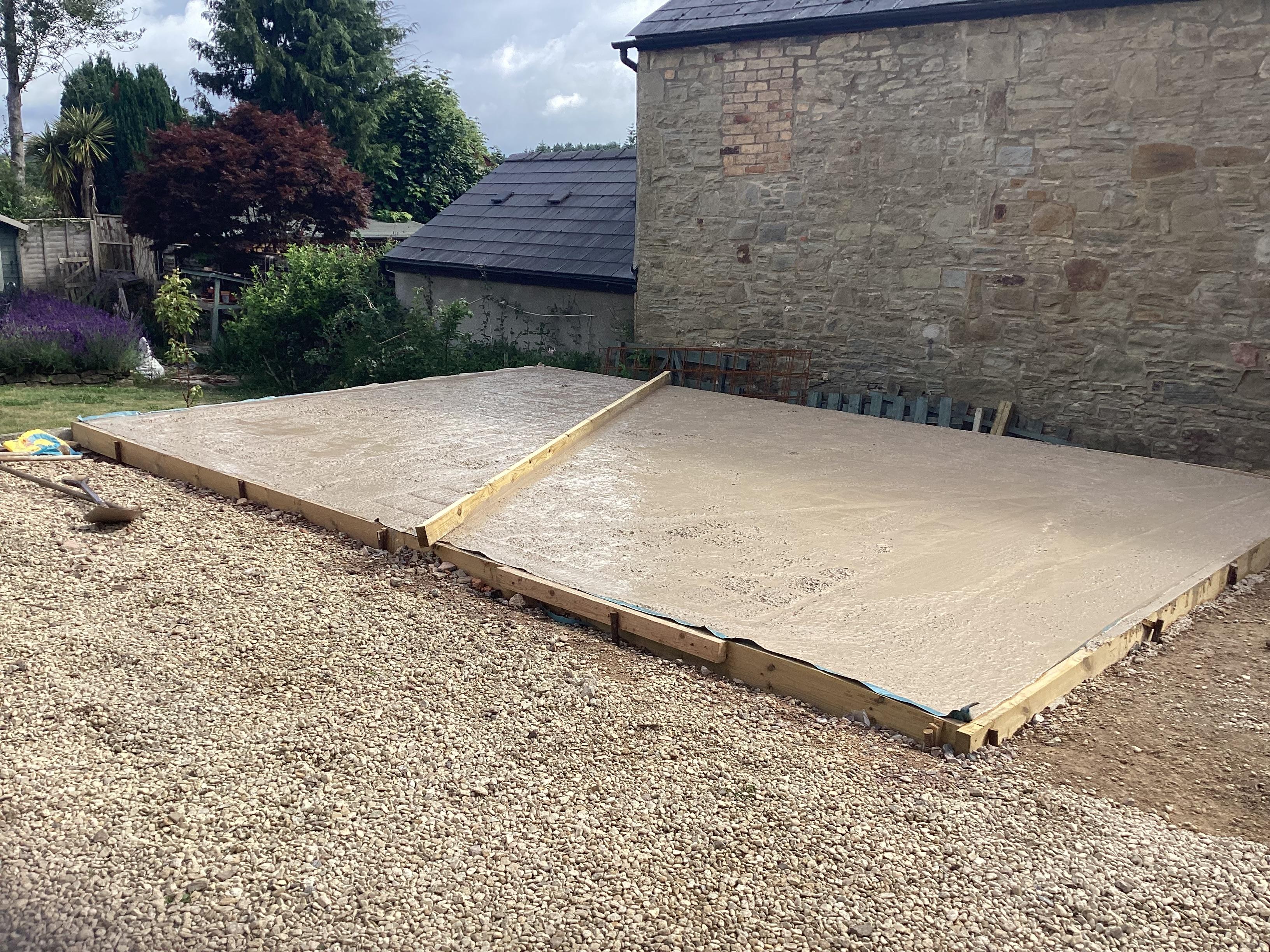

joe90 Posted July 5, 2023 Author Share Posted July 5, 2023 Already for concrete being delivered in the morning. I roped my daughters boyfriend and his mate to shovel it for me whilst I “project manage “ (make the tea) and trowel it off with an “easy trowel” on a long pole. 4 Link to comment Share on other sites More sharing options...

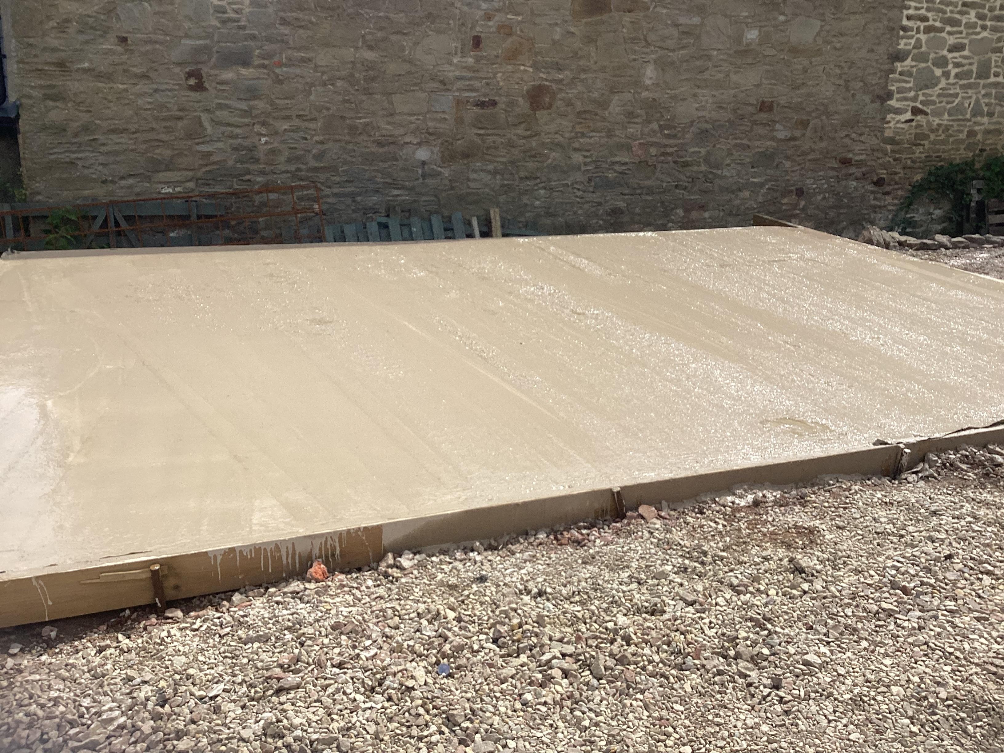

joe90 Posted July 6, 2023 Author Share Posted July 6, 2023 No time to arrange time lapse photo because concrete arrived an hour early 🤯, still down and tamped, just waiting for the bleed water to evaporate and get on it with an easy float. 2 Link to comment Share on other sites More sharing options...
joe90 Posted July 6, 2023 Author Share Posted July 6, 2023 The easy float does a good job, still trowelling away ….. 1 Link to comment Share on other sites More sharing options...
saveasteading Posted July 6, 2023 Share Posted July 6, 2023 You were lucky getting it early. That should be stiffening up nicely by now. Don't overdo the floating or you will get too much cement paste. Link to comment Share on other sites More sharing options...

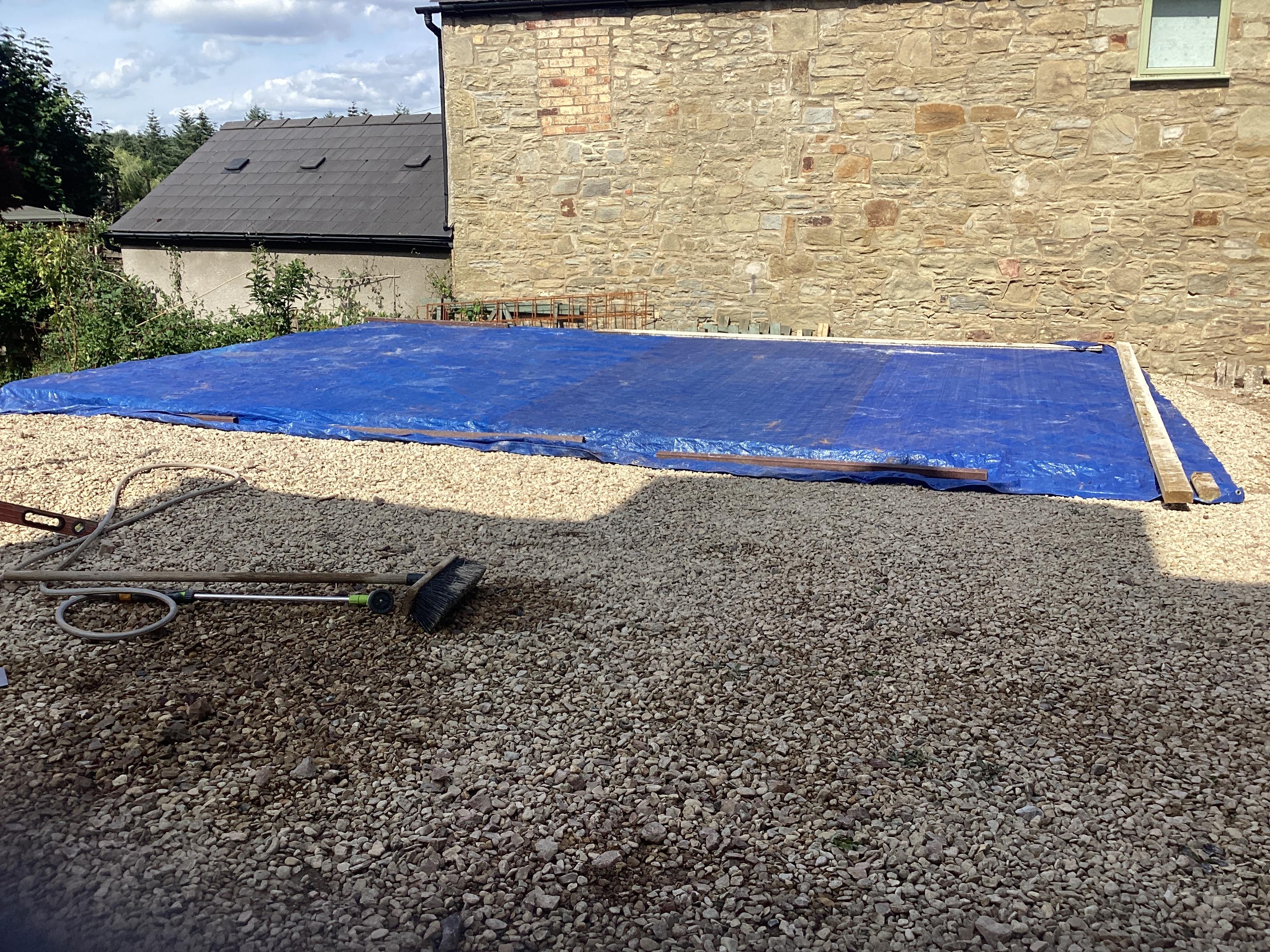

joe90 Posted July 6, 2023 Author Share Posted July 6, 2023 All put to bed now…… 2 Link to comment Share on other sites More sharing options...
joe90 Posted July 12, 2023 Author Share Posted July 12, 2023 After uncovering and removing the shuttering, the answer to this OP is. YES. I should have power floated the slab. It’s very flat but the surface is not what I wanted (yes I can be OCD ) it’s only a garage and I will be painting it I guess but hey it’s too late now. Thanks everyone for their input. 🤷♂️ Link to comment Share on other sites More sharing options...
