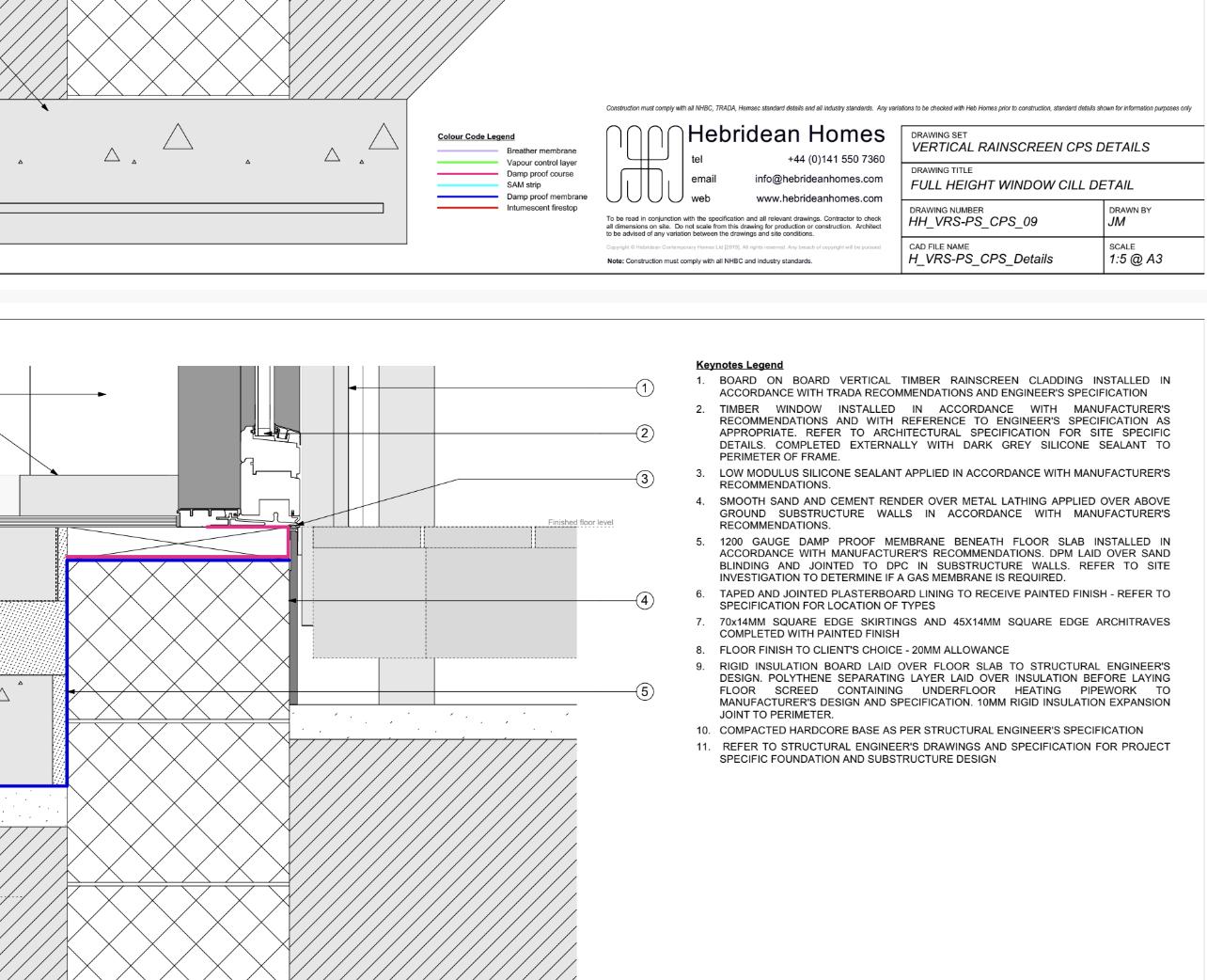

My ongoing house build saga where nothing seems easy turns to the full height windows, sliding door and French Doors.
Our foundation wall is rendered up to a render stop. The windows are fitted flush with the kit. This is the detail. My renderer chap is saying he doesn’t think this will provide a good enough seal and he’s suggesting some kind of flashing under the window and over the render. We’ll have a patio slabbed up against this. Heb Homes are saying this will work and is there standard detail. They have also suggested using an EPDM apron lapped under the window and down the foundation. They’ve had three goes at fitting these windows and they still aren’t right. Any suggestions? 1987144C-C6C7-4F59-985D-083E0B026956.thumb.jpeg.36d00dbf696c1e9bdf8a18c2a0359f10.jpeg

My concern is this flush with the kit fitting as it means the leading edge of the windows are sitting on the edge of the foundation at the moment whereas this detail shows it should be over the edge of the render. I am at my wits end with HH and their builder.

what is the window manufacturer design for the cill detail ?
They are the ones you will be claiming against should it go wrong.
The HH detail looks pants for both durability and heat loss.

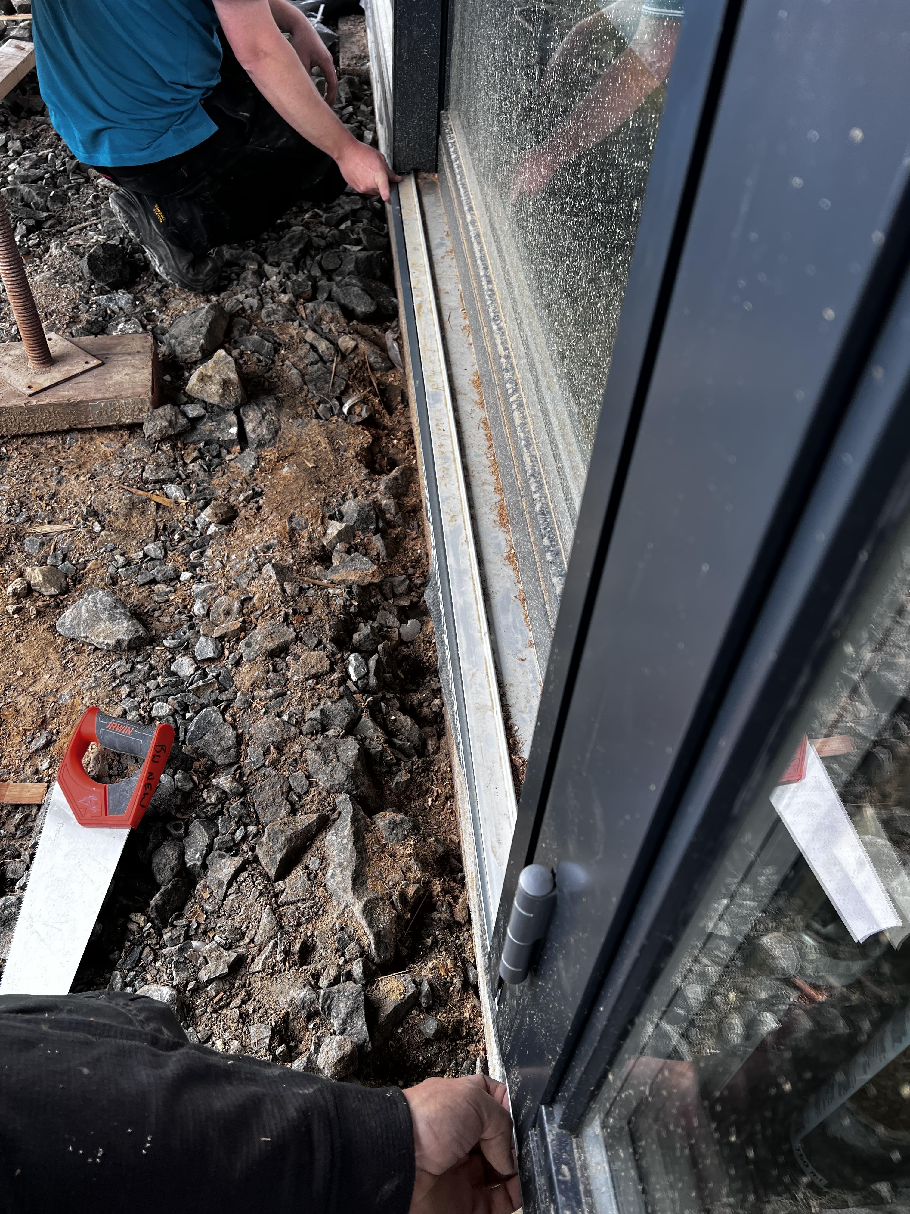

Normally there are holes and pathways built into tracks that route water down and out.
Here is an example from another manufacturer...
https://www.iqglassuk.com/technical-advice/how-to-prevent-water-ingress-on-sliding-doors/s88710/
A very good point. Water gets through gaskets more than you would hope. It also gets in at joints in aluminium sections. Then it channels to the bottom where there may be a hole in the bottom section, perhaps with a plastic spout in it. That needs to be allowed to drip.
There’s no issue with the windows themselves. It’s how they are fitted and sealed that’s the problem. Nordan are visiting site next week to replace an IGU that the scaffolders smashed. I’ve asked them to look over the installation. Separately I’ve told HH I want them to provide a detail for the window install and for their builder to apply it. I paid them to do it so they can do it.

I agree with your renderer. It might be their standard detail but is it the window manufacturers recommended detail? Needs a flashing to protect and deal with water run off to be honest.
I can’t see anything on Nordan’s website on how to detail this.
What is the product reference? I'll see if I can find the relevant information. This document, doesn't have balcony door details, just window details. https://nordan.co.uk/flowpaper/Operations-Manual/index.html?reload=1620723728428#page=98

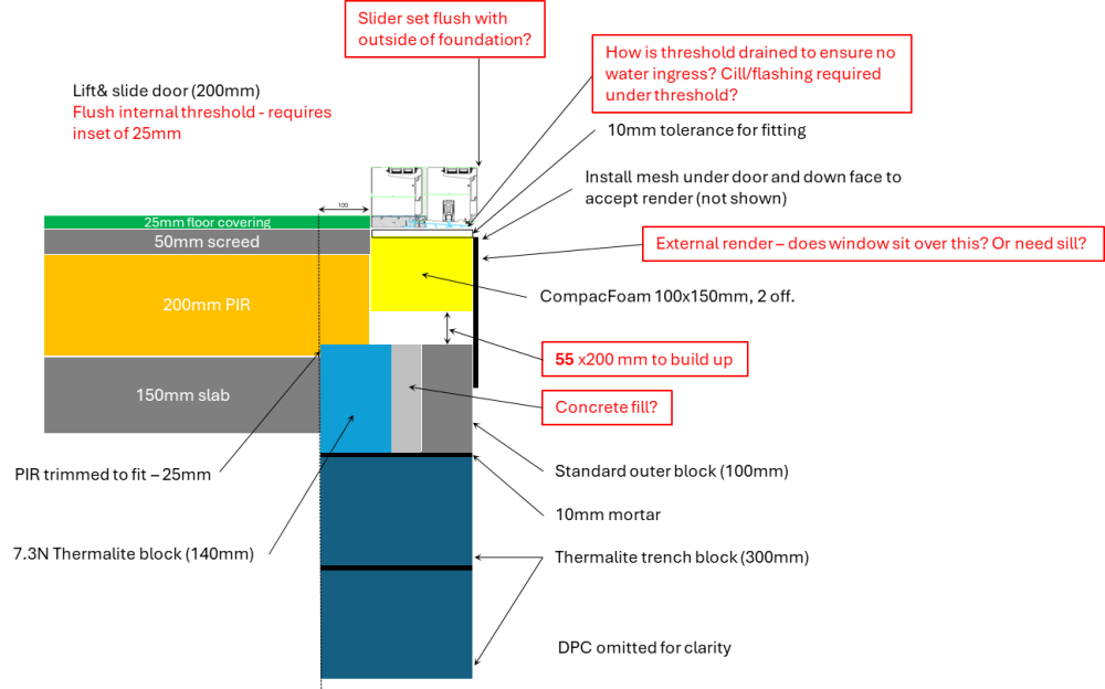

@Kelvin Did you solve this? I have a very similar detail to complete and no great ideas...
On 26/06/2023 at 20:15, Dave Jones said:
What we did with our bifold was have a normal 150mm cill then tiled (porcelain) over the top of the cill to give a level threshold, put an aco linear drain under the cill to takeaway anything that found its way there. Never leaked once in 5 years and only had a 15mm lip to walk over.
Do that myself, as I couldn't think of a better way of doing it. I agree with @Dave Jones. I works well.
@Big Jimbo not sure I can envision this - is this a cast concrete (or similar) cill with the door sitting on top?

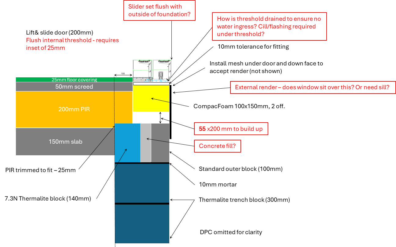

This is where I've got to at the moment. Suggestions welcome!
