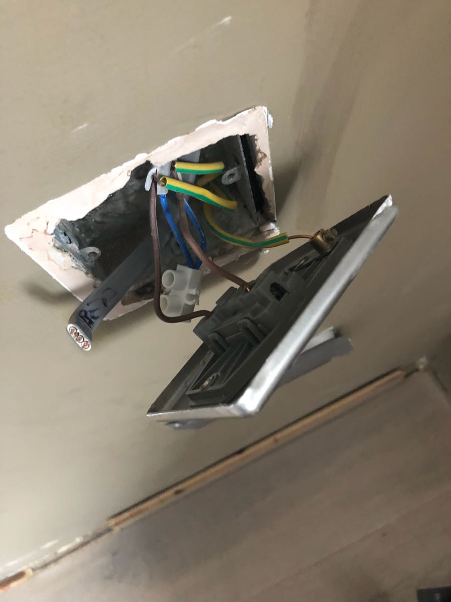

daiking Posted April 12, 2018 Author Posted April 12, 2018 Today’s surprise when trying to raise a single switch...

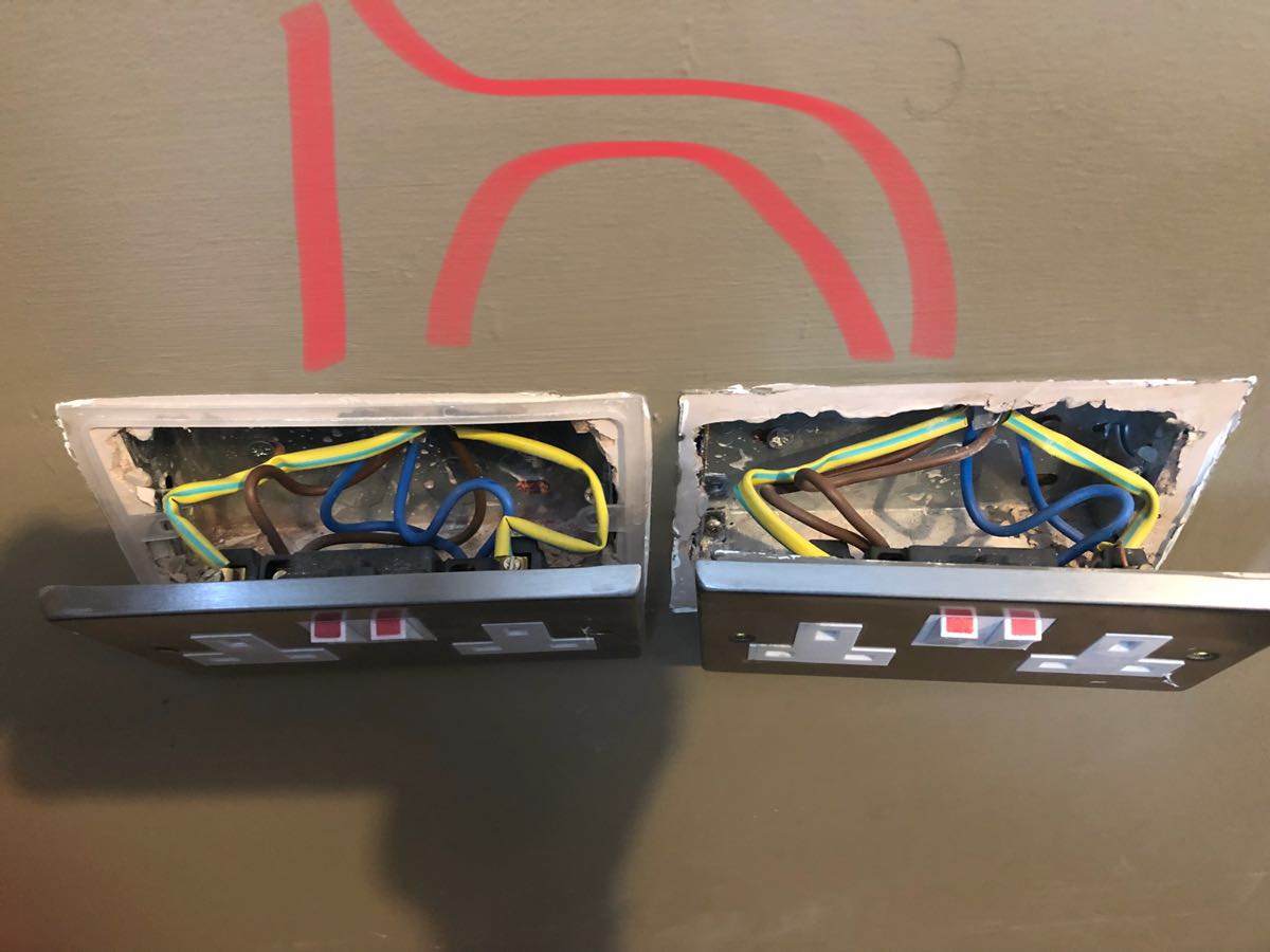

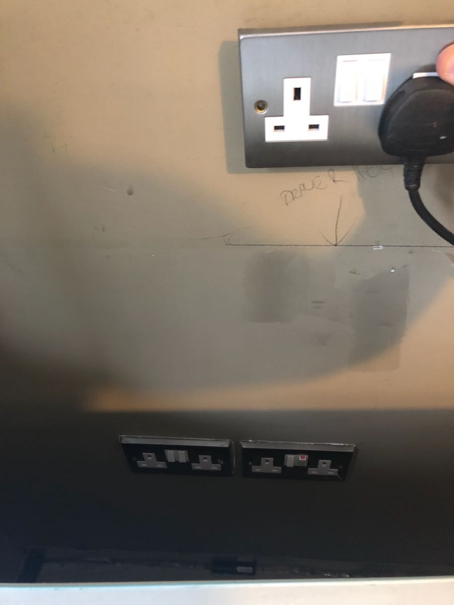

daiking Posted April 12, 2018 Author Posted April 12, 2018 (edited) Real electrics now, 13A ()... I thought there was a double socket behind a piece of furniture at normal socket height and I need it higher so I was going to add a spur. Turns out there’s 2 double sockets and it looks like they are separate themselves, not one a spur off the other. Is there any harm in doing what I’ve done with the light switches? Chasing the wall and cutting the wires back where I want them? Edited April 12, 2018 by daiking
daiking Posted April 12, 2018 Author Posted April 12, 2018 Except further up the wall where I have dug a hole there are only 2 wires so I’m now guessing it was wired in a fashion like this. Which makes things a little trickier... wife will not be pleased
Onoff Posted April 12, 2018 Posted April 12, 2018 28 minutes ago, daiking said: Real electrics now, 13A ()... I thought there was a double socket behind a piece of furniture at normal socket height and I need it higher so I was going to add a spur. Turns out there’s 2 double sockets and it looks like they are separate themselves, not one a spur off the other. Is there any harm in doing what I’ve done with the light switches? Chasing the wall and cutting the wires back where I want them? No problem doing that whatsoever. Lets hope you don't find any oddity like those two sockets are actually interconnected a little higher up. You could disconnect the wires in those two sockets and start belling out but you'd need a proper electrician to do that... Don't suppose you can get into the loft/floor above and see the cable drops?
daiking Posted April 12, 2018 Author Posted April 12, 2018 (edited) 2 minutes ago, Onoff said: No problem doing that whatsoever. Lets hope you don't find any oddity like those two sockets are actually interconnected a little higher up. You could disconnect the wires in those two sockets and start belling out but you'd need a proper electrician to do that... Don't suppose you can get into the loft/floor above and see the cable drops? Have you seen my latest post? I think I’ll need to climb up the loft to check and I’m going to need a plasterer as well as an electrician. Edited April 12, 2018 by daiking
daiking Posted April 12, 2018 Author Posted April 12, 2018 So now I have only 2 cable drops and a lungful of rock wool. most expeditious way out of this hole is to cut the cables half way up the wall to stick a new double socket leaving the existing sockets In the lower position but not connected to anything.
Onoff Posted April 12, 2018 Posted April 12, 2018 The cable is POSSIBLY routed how you've sketched. It may be though that those drops just feed one of the double sockets and the other is fed from say another socket on the other side of that wall! Belling it out is the only real way to tell. Assuming it is how you've sketched then why not keep both sockets. Fit the new back box then just chase between that and the lower original one. Renew the lower cables. Tbh I'd have used the knockouts in the boxes to link them together rather than a loop over the top.
daiking Posted April 12, 2018 Author Posted April 12, 2018 Extremely unlikely it is fed from anywhere else. This wiring was part of ‘new build’ and not connected to wiring in room next door. Not it sure whether to keep making a mess to find out or stop here
daiking Posted April 12, 2018 Author Posted April 12, 2018 31 minutes ago, Onoff said: The cable is POSSIBLY routed how you've sketched. It may be though that those drops just feed one of the double sockets and the other is fed from say another socket on the other side of that wall! Belling it out is the only real way to tell. Assuming it is how you've sketched then why not keep both sockets. Fit the new back box then just chase between that and the lower original one. Renew the lower cables. Tbh I'd have used the knockouts in the boxes to link them together rather than a loop over the top. “Renew the lower cables“ ??? can I run a cable from the new position down to the lower socket and come off that directly?
Dee J Posted April 12, 2018 Posted April 12, 2018 1 hour ago, daiking said: “Renew the lower cables“ ??? can I run a cable from the new position down to the lower socket and come off that directly? Yes. Assuming the wiring format and circuit protection are ok. I.e the two lower sockets are on a ring circuit protected at 32Amps or less or a radial circuit protected at 20 Amps or less. Your new socket becomes a spur to one of the lower sockets.
daiking Posted April 12, 2018 Author Posted April 12, 2018 16 minutes ago, Dee J said: Yes. Assuming the wiring format and circuit protection are ok. I.e the two lower sockets are on a ring circuit protected at 32Amps or less or a radial circuit protected at 20 Amps or less. Your new socket becomes a spur to one of the lower sockets. I’d go with yes as it’s a new install with recent CU
