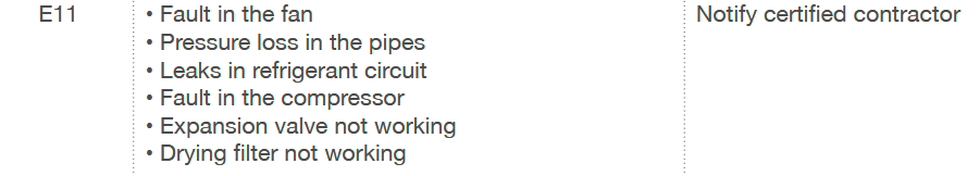

What exactly does the error message say?
Are these the right instructions for yr Joule Aero? See 1. interpretation of error codes p 36, 2. configuring the legionella cycle p32. What happens if you disable it temporarily to eliminate it as a factor? Or try a factory reset (note all the settings first, then add them back one at a time and re-test as you go)

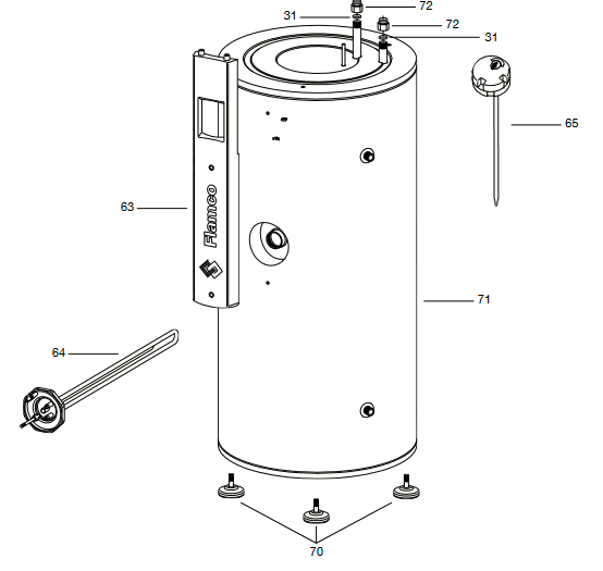

There doesn't seem to be anything about fitting the second immersion in the text or the exploded view on p41. Is it external like a Willis heater? Can you post a pic of how/where it is installed and the wiring to it.

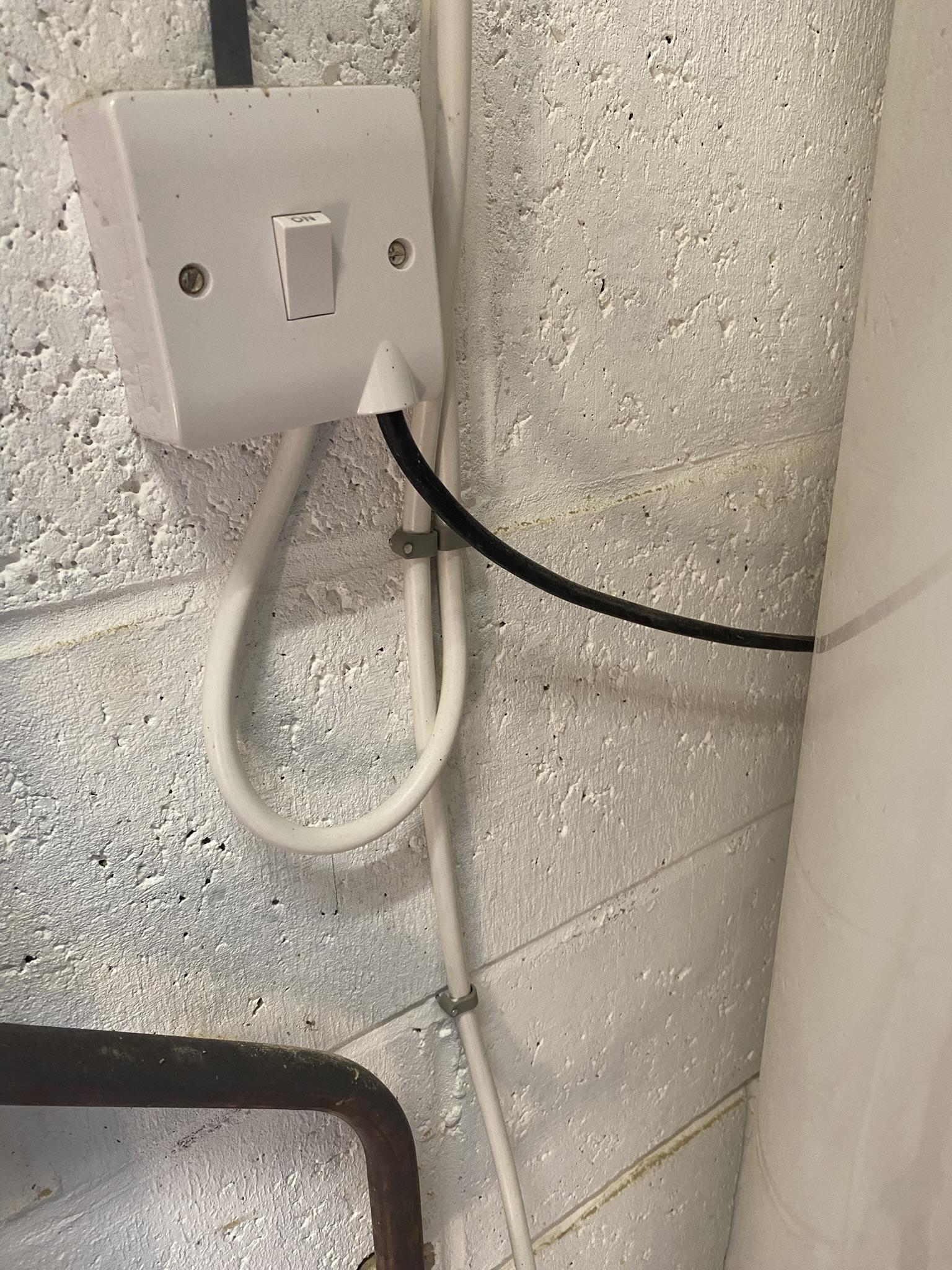

The second immersion is not external. This is the only photo I can take that might give you any information. I suspect that the black flex is the usual feed to the unit, while the white one that bypasses the switch and goes into the back of the machine comes from the iBoost.  image.thumb.jpeg.ecdb90467a557e8dd60f47fd5754d09a.jpegWe are in Brighton. Many thanks for your advice.

If these are right for your unit then E11 denotes a fault in the refrigerant circuit so it may need re-gassing.

Looking at that pic I wonder if there is no physical 2nd immersion and what he has done is wire a second direct connection into the original immersion heater. This might be OK but either piece of kit might object to the other.

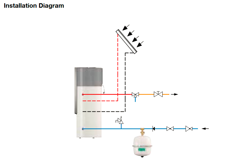

The illustrations in the above handbook don't show any port for a second immersion. The diagram on p17 for solar heating appears to be connections for solar thermal pipework, not electrical connections:

So where/how was it installed? The tank in this illustration has only one boss for the immersion heater 64, about half way up behind 63 the front cover. 65 is the thermostat not a second heating element.
Can you take a pic which shows where the black and white wires go into the tank?

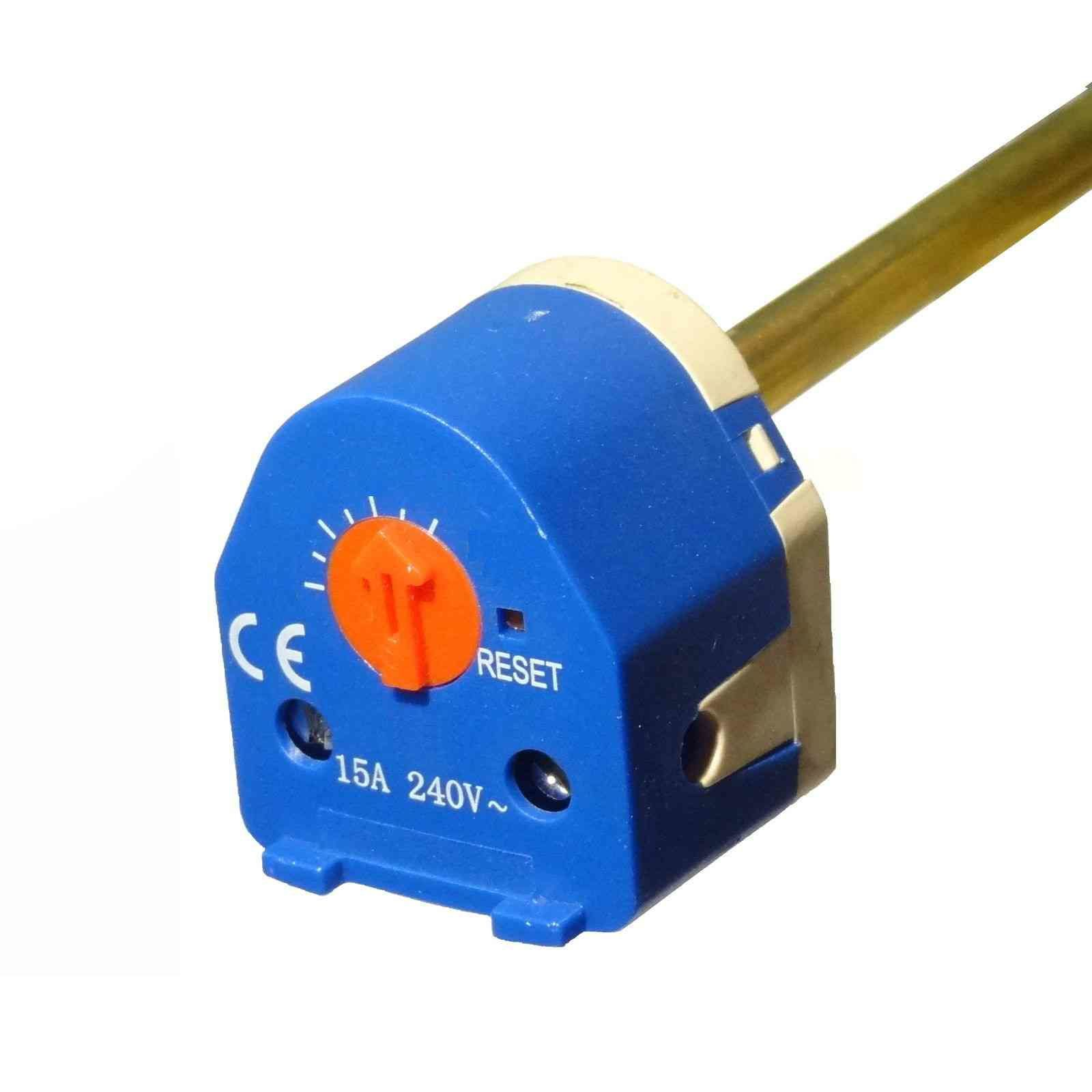

he says it looked like "a long piece of copper".
Sounds more like a thermostat than a heating element.
Most thermostats have a safety cut out, could be that has tripped. Some are resettable.
It may look a bit like this.
Yes, in the diagram compare 65 which is the system thermostat and has a single prong with 64 which is the immersion heater and has a folded element (and usually a separate single probe which is its own thermostat).
More pictures are required
the only picture showing the switch looks questionable, and love the grey t&e clips on the flex. Another quality install!
