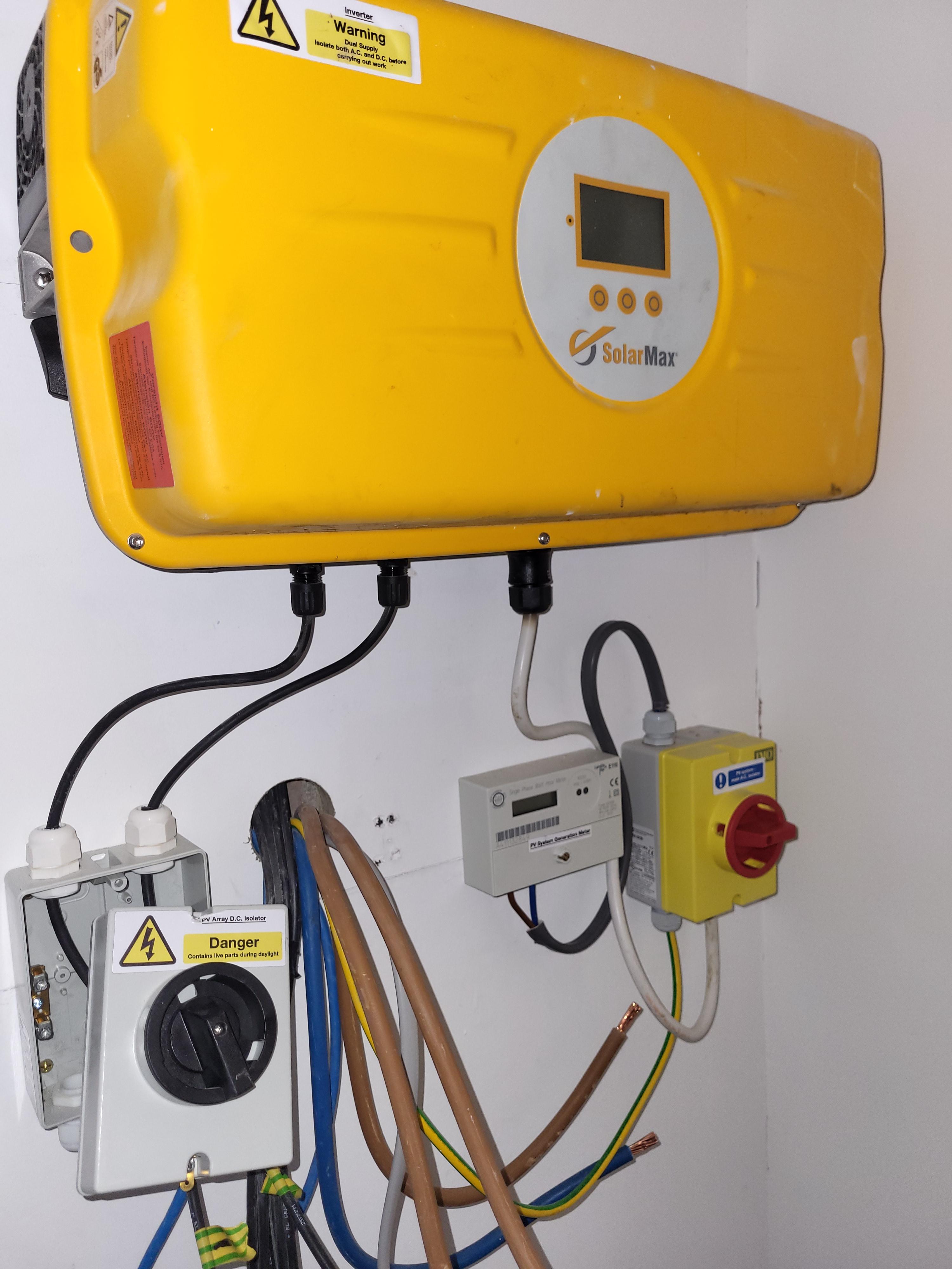

Andehh Posted June 3, 2023 Posted June 3, 2023 Our electrician thinks we need a switch to divert the power between PV & mains into the fusebox. Ie when the day is sunny we switch the PV on to feed the fusebox, then at night switch it so that its 'off' and the mains power is 'on'. He says manual ones are cheap and automatic ones are £80 to £400. It's a old 13 year old system we are keeping due to the favourable FiT, and he dismantled it off our original roof 2 years ago (i know FiT rules have changed, but we dont have the funds to upgrade it). The system consists of a old Solarmax 4200s, couple of large isolation switches and a grey meter box. I couldnt get my head around this, as I have never heard of anyone needing to manual engage their solar system & switch back & forth from manual grid. He brought up a couple of google image search showing 'control boxes' connect to solar installs, but wasn't totally sure either way. I dont feel like he is up selling me & he is happy to connect it all in and see what happens. He is a good guy, albeit it bloody expensive! Any advice, or suggestions as to what he is referring to?

Andehh Posted June 3, 2023 Author Posted June 3, 2023 Thanks Steamy. Yes, he is not a solar expert, just a good electrician reconnecting the system up. So the Solarpanels feed just flows into the fusebox? As we have 3 phase, and this is a single phase inverter....he is just going to connect the Solar into our 1st Phase (which feeds the house)... is that all that is required?

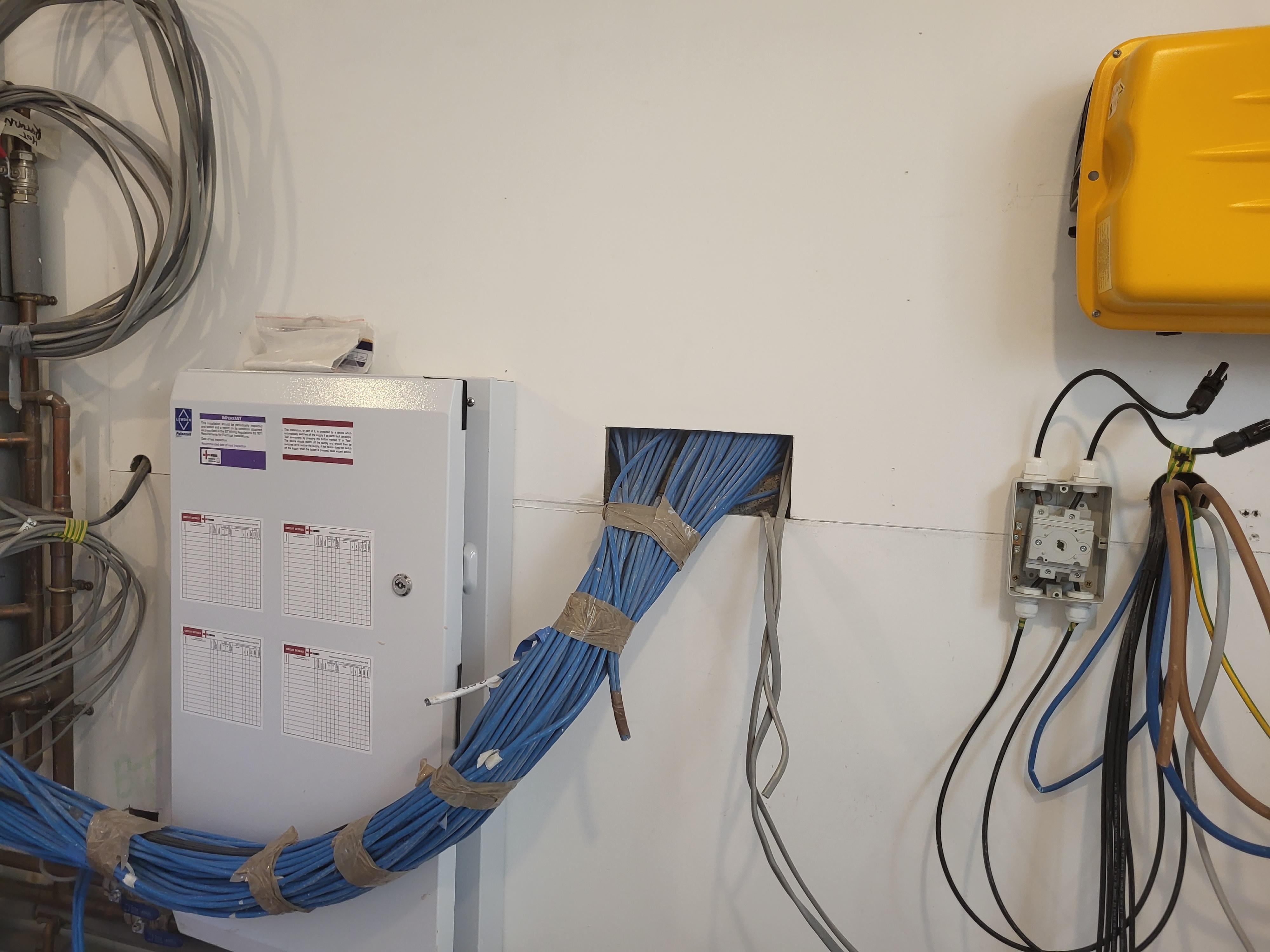

Andehh Posted June 3, 2023 Author Posted June 3, 2023 Best I have right now. We think the inverter packed up, so have replaced it with a new one due to be delivered today and fitted tomorrow... Hence it all looking messy.

SteamyTea Posted June 3, 2023 Posted June 3, 2023 The left hand side switch (black) is the DC isolator, right hand side one (red) is the AC isolator, yellow box is the inverter and the little grey box with the LED display is the generation meter. 1

ProDave Posted June 3, 2023 Posted June 3, 2023 Since you have novices working on this, it is far to warn you the DC side will still be live even without an inverter. The black wired coming from the panels and entering that grey DC isolator switch will be live. So pest screw the switch back into it's box ans ensure that switch remains OFF until you connect your inveter. And yes the inverter needs to be connected to the mains otherwise it will not work. Find an electrician who understands solar.
Dillsue Posted June 3, 2023 Posted June 3, 2023 Take note of the Danger sign on the front of the grey and black isolator hanging loose. If its connected to the panels there could be several hundred volts on the isolator. If your electrician left the isolator like that and doesnt understand solar, then get a new electrician!
