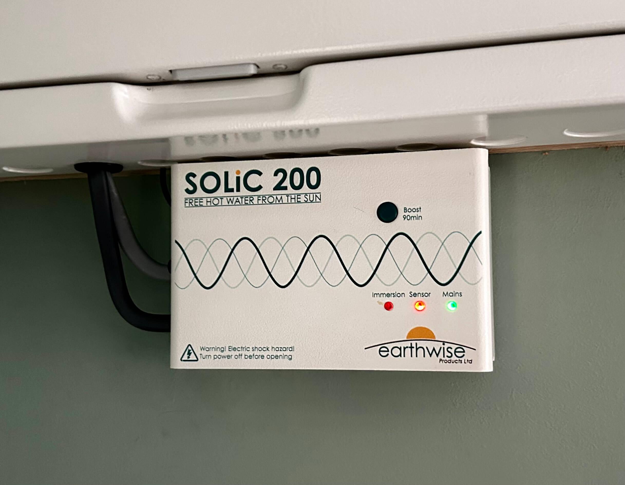

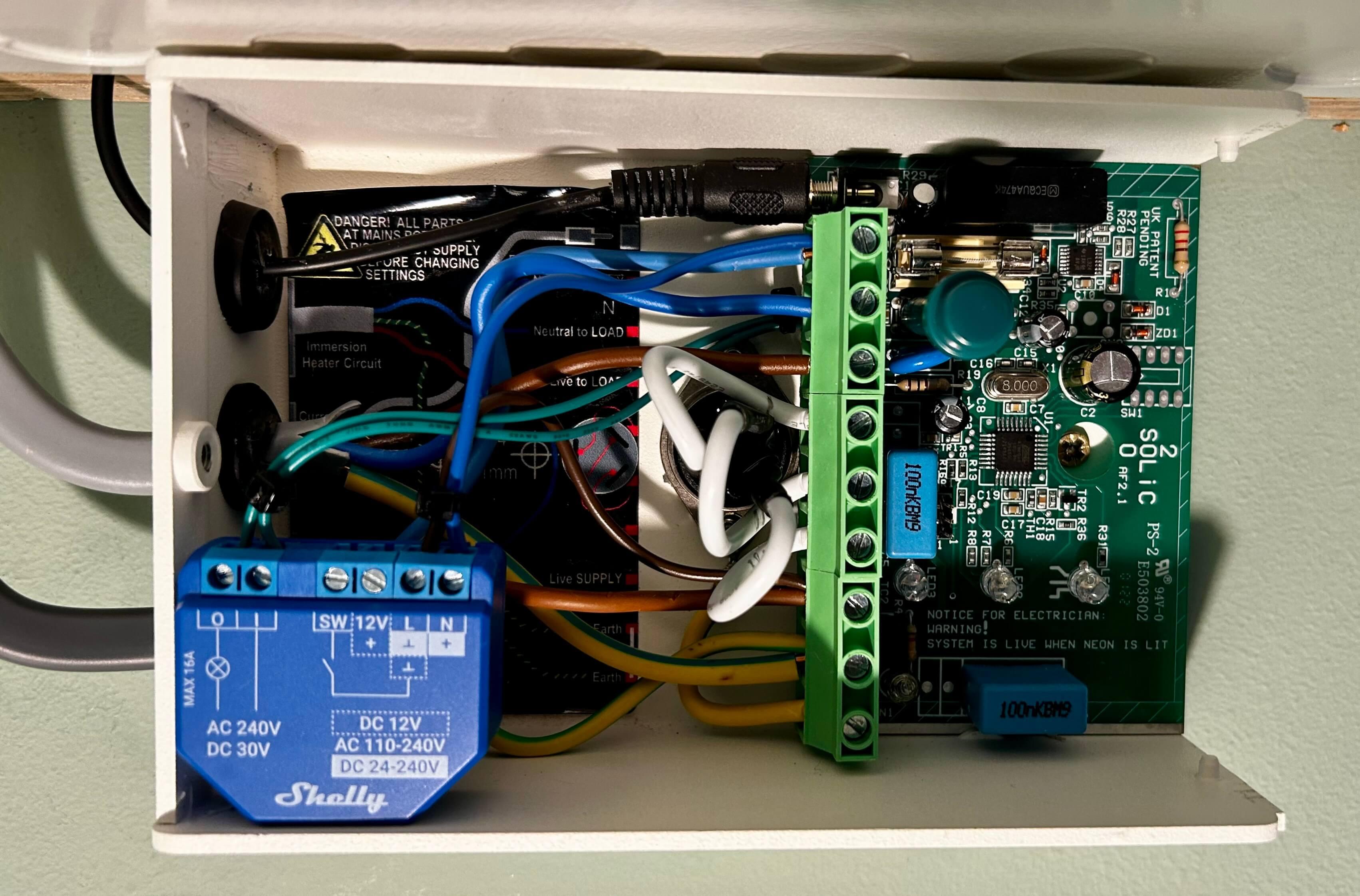

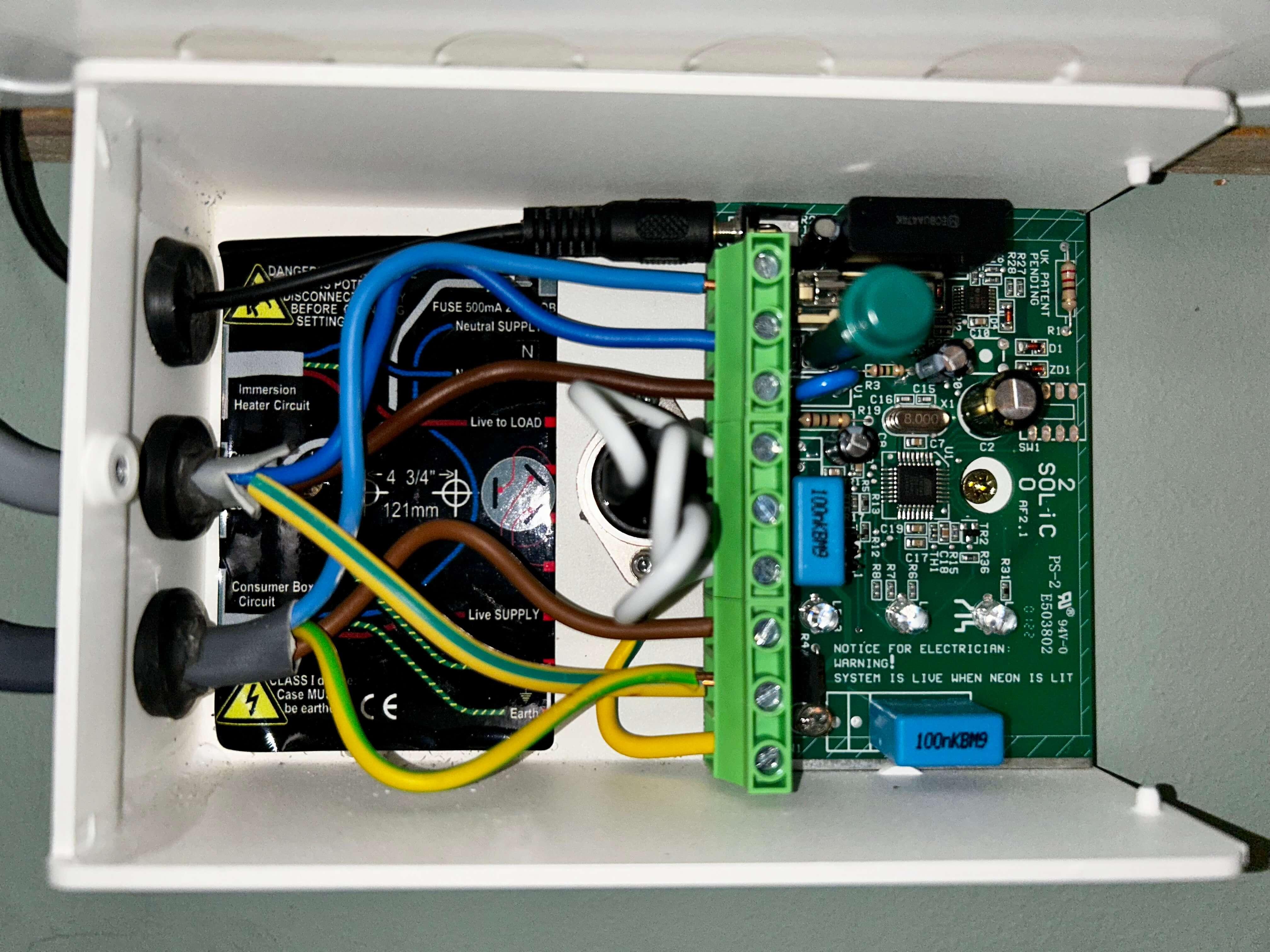

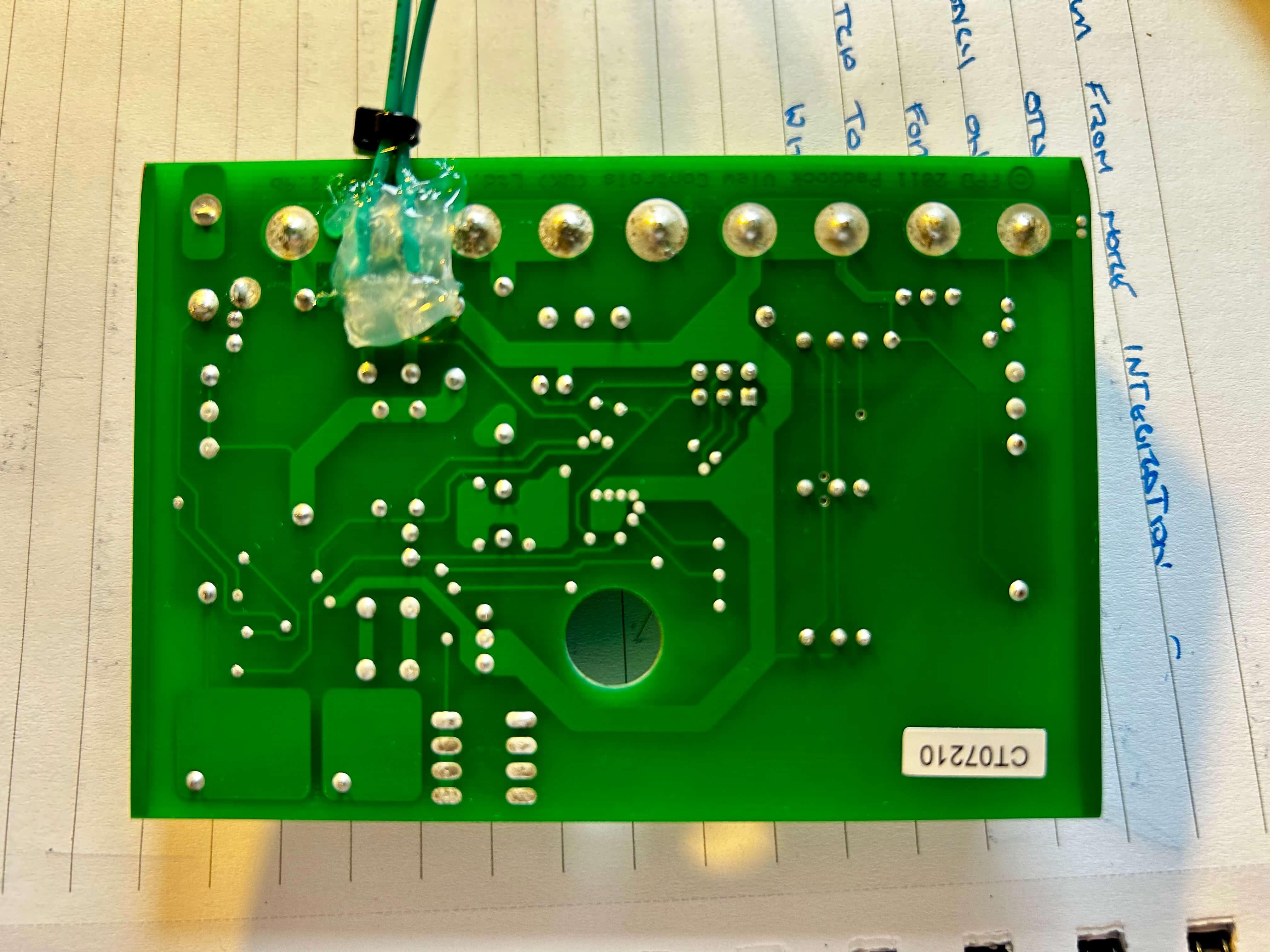

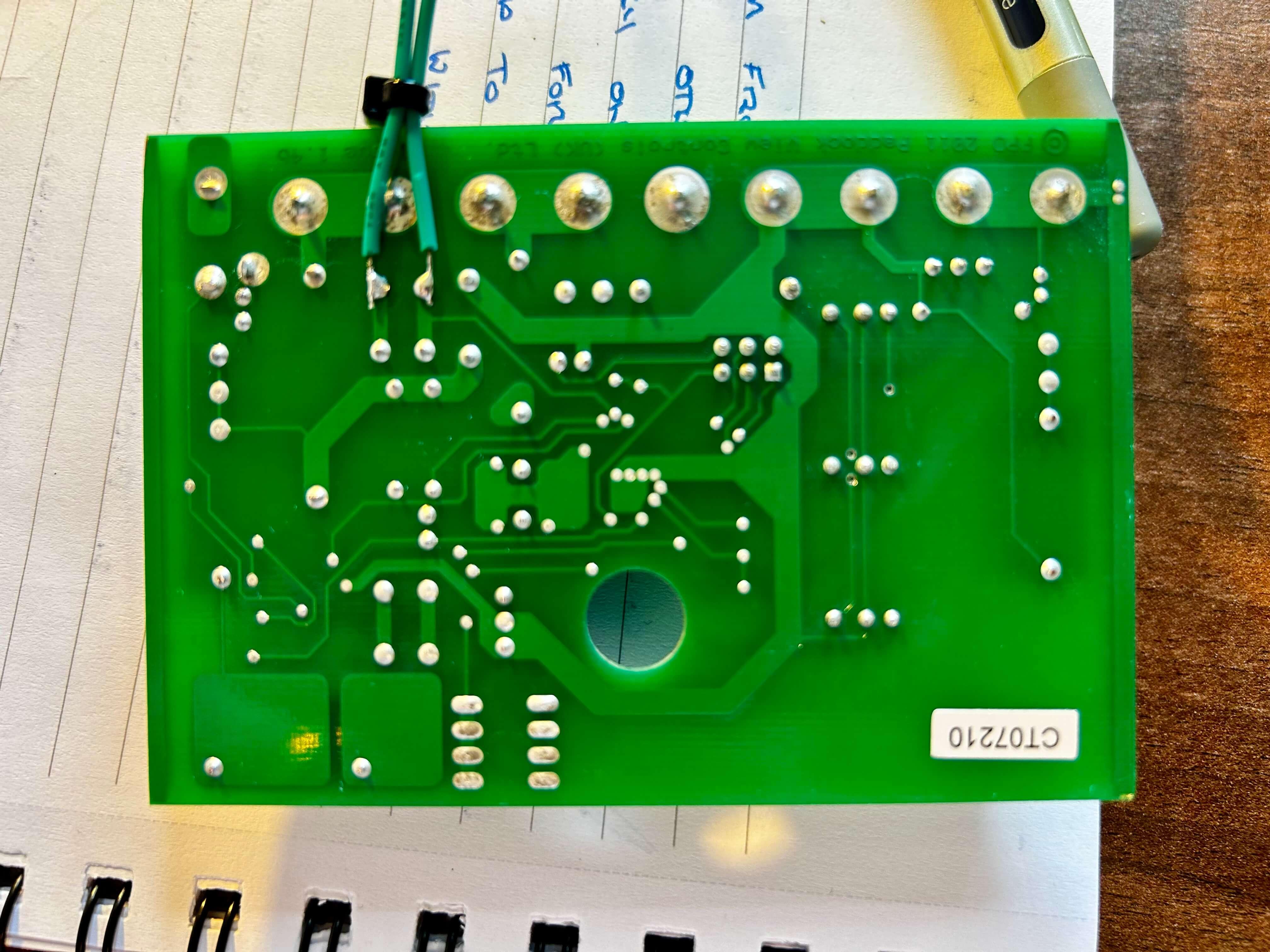

RichardL Posted June 1, 2023 Share Posted June 1, 2023 The end game is probably a combined air source pump/cylinder. In the interim, to get off oil, I'm going with solar excess immersion via a Solic 200 & off peak top up when there's no solar. I've read the threads on expensive to install/cheap to run heat pump cylinders vs. cheap to install/expensive to run immersion - and on the latter for now. Shelley schedule My first try is a Shelley module which has built in scripting, but in this case just needs the schedule to close dry contacts and hit the boost button. Boost on a Solic turns on the immersion for 90 minutes - that should be plenty if timed on key days to top up the cylinder hot water. Relatively simple, non destructive, mod to let the Shelley push the boost button - i.e. low voltage switching. Bonus - the solic is a nice steel case - so relatively contained if there were any issue. Programming Merely a Shelly schedule to push its button and a timer on the same button to turn if off after 1 second. Thinking Keeping this super simple - i.e. if there was sun during the day the tank will already be hot and the immersion cut out, if no sun, or winter, then off peak will do most of the work. Not perfect in terms of efficiency - but on the side of KISS for now. No cloud - not even network required for it to work, other than NTP now and again to sync it's clock. No questions - just sharing. Before Getting the board out needs the vice to spread the case sides - it won't just slide out. Mods After 1 Link to comment Share on other sites More sharing options...
