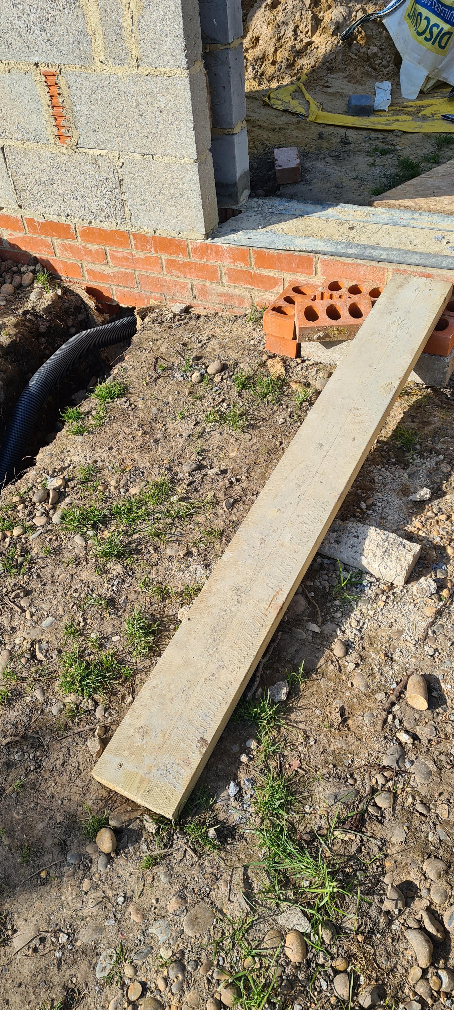

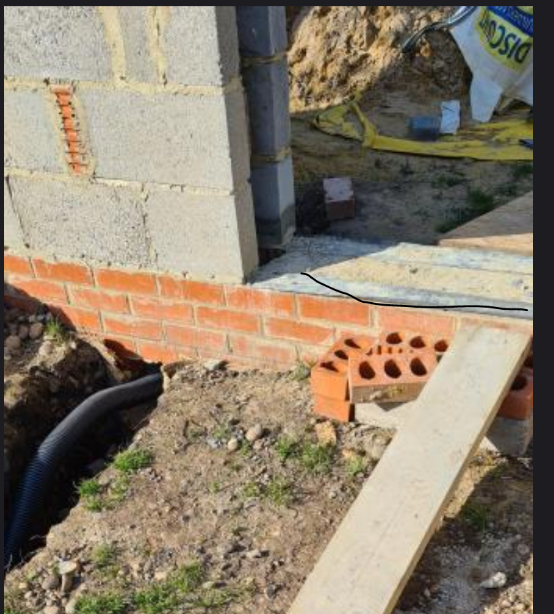

The DPC has not been lapped as specified by the architect.  A 100m DPC was used instead for the inner leaf of the cavity.
Is this ok and what can be done to make sure that there are no damps .  Can it still be lapped with the DPM any other way

The DPM under the floor slab should really go up the wall and lap over onto the DPC. I can't guarantee it will be OK but I suspect as long as it's lapped up the wall to a point a few inches above the DPC it will be OK.

No, it's not OK.
I'd apply a couple of coats of liquid DPM for (Aquaseal Hyprufe of similar) for 100mm or so above the slab, thoroughly sealing along the DPC, and along the edge of the slab itself, so that the DPM laps with that. Make sure the joints between blocks are pointed first if they're not already 100% full.
This is something to discuss with your Building Control Officer as it's a stage they should be checking.

you'd normally leave some DPC overlap inside, around 1ft, to be able to connect it to your damp proof barrier. having said that, I'd agree with @Temp, it's not the end of the world. what you're basically doing with the DPM is to create a "tray" or a "bag" that seals your floor from touching anything wet/damp. since it goes above the DPC, the wall directly opposite the screed should not be wet anyway, so I guess you'll be ok.

These appear to be engineering bricks, so won't absorb much water.
So in reality it will probably be OK, but it should not have occurred.
The suggestions above are good.
It is essential that the bco sees this before it goes further.
