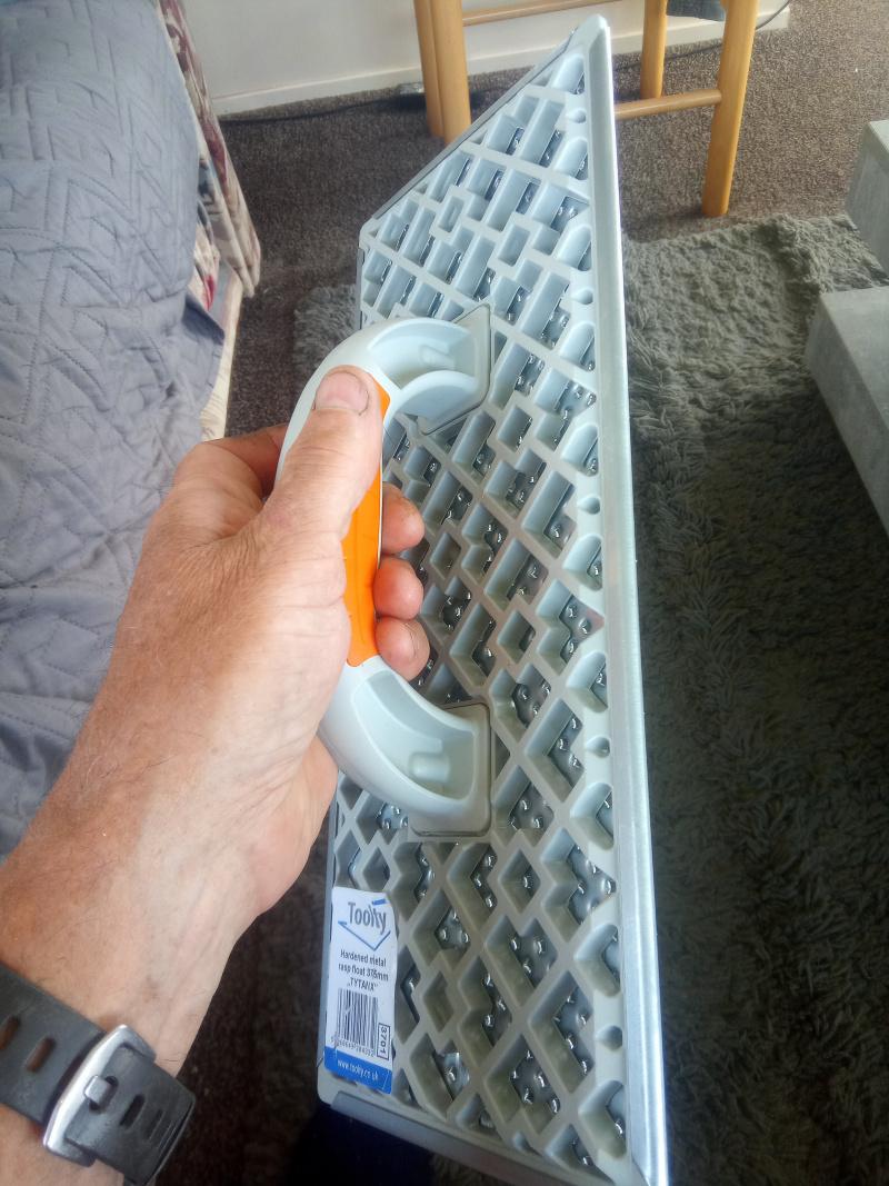

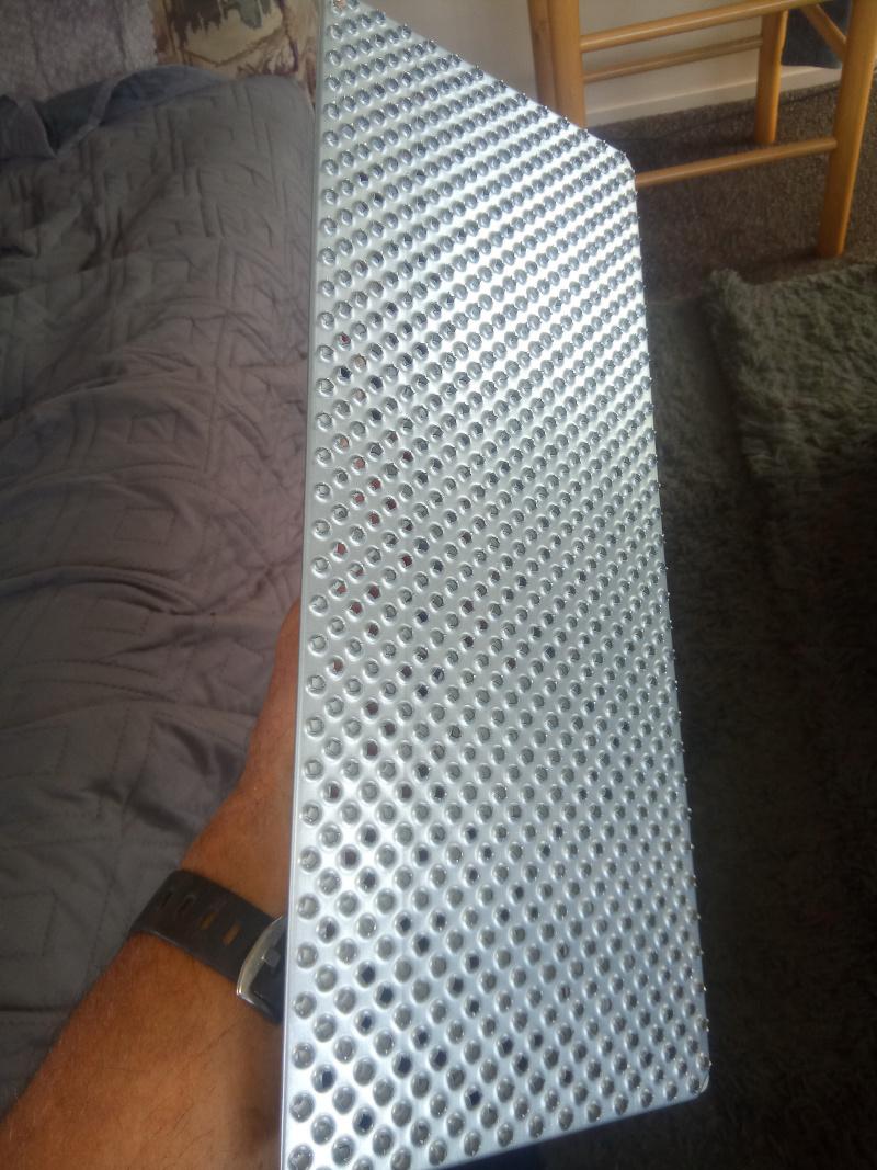

Jenki Posted July 6, 2023 Author Share Posted July 6, 2023 On 02/06/2023 at 09:38, FM2015 said: We use an EPS rasp and a leaf blower or handheld vacuum on each opening as required Refina do a tungsten carbide rasp with the awesome name of TigerClaw. @FM2015 cant stretch to that TigerClaw rasp, but found a considerably cheaper knock off version that should get me through. - thanks for the info👍 Link to comment Share on other sites More sharing options...
Nickfromwales Posted July 6, 2023 Share Posted July 6, 2023 TigerClaw vs Screwfix 2 hours ago, Jenki said: found a considerably cheaper knock off version Can you post a link please? Link to comment Share on other sites More sharing options...
Jenki Posted July 6, 2023 Author Share Posted July 6, 2023 On 06/07/2023 at 12:04, Nickfromwales said: TigerClaw vs Screwfix Can you post a link please? I've not seen the Tiger Claw so would assume much superior to this, but I'm only doing this once😂 https://www.amazon.co.uk/dp/B07K6MTSKT?ref_=cm_sw_r_apann_dp_ANBM4JX1D0QKZ60ZD3CT The Screwfix link is more a k rend float? I'm hoping this will be smoother,my K rend float would destroy polystyrene. 1 Link to comment Share on other sites More sharing options...
Jenki Posted July 7, 2023 Author Share Posted July 7, 2023 On 06/07/2023 at 12:04, Nickfromwales said: TigerClaw vs Screwfix Can you post a link please? @Nickfromwales. Turned up today. Impressed. 1 Link to comment Share on other sites More sharing options...
Chanmenie Posted July 7, 2023 Share Posted July 7, 2023 I have one of those, works great 👍 Link to comment Share on other sites More sharing options...
FM2015 Posted July 8, 2023 Share Posted July 8, 2023 Not going to lie, the TigerClaw is the Rolls Royce of EPS rasps and if you use it for a living, well worth the expense. The finish is beautifully fine whereas the alternatives, like those shown above require a lot more effort to achieve the same finish. They can leave a more "open" finish. 1 Link to comment Share on other sites More sharing options...
