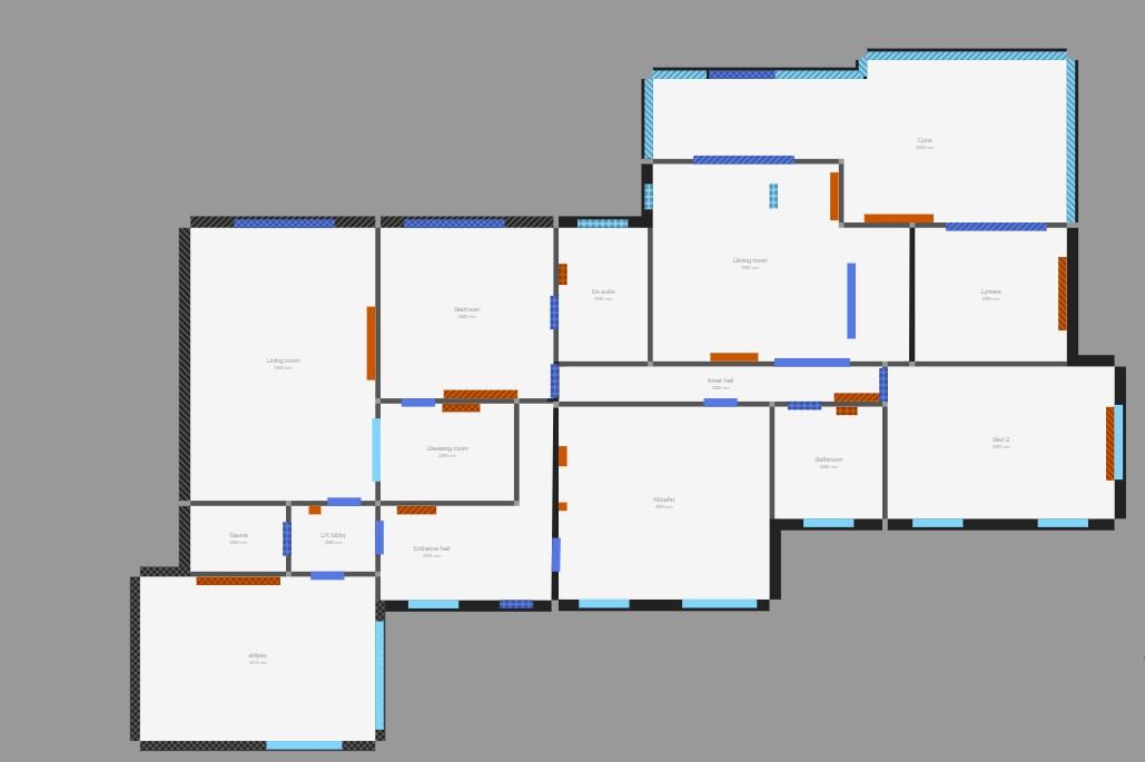

This is a rough plan of our house. The room on the bottom left has solid brick walls with no insulation, a solid floor with no insulation and a pitched roof with no or very little insulation. Those elements can all be modeled in the HeatPunk calculator. You can create your own element if you need to. The room on the top left is the most recent and has 50mm insulation in the solid floor 75mm in the cavity walls and 200mm in the ceiling. The room on the bottom right has a suspended wooden floor, cavity walls with some blown in insulation and 200mm insulation in the ceiling. All the elements can be specified individually, there's no need to guess and use approximations.

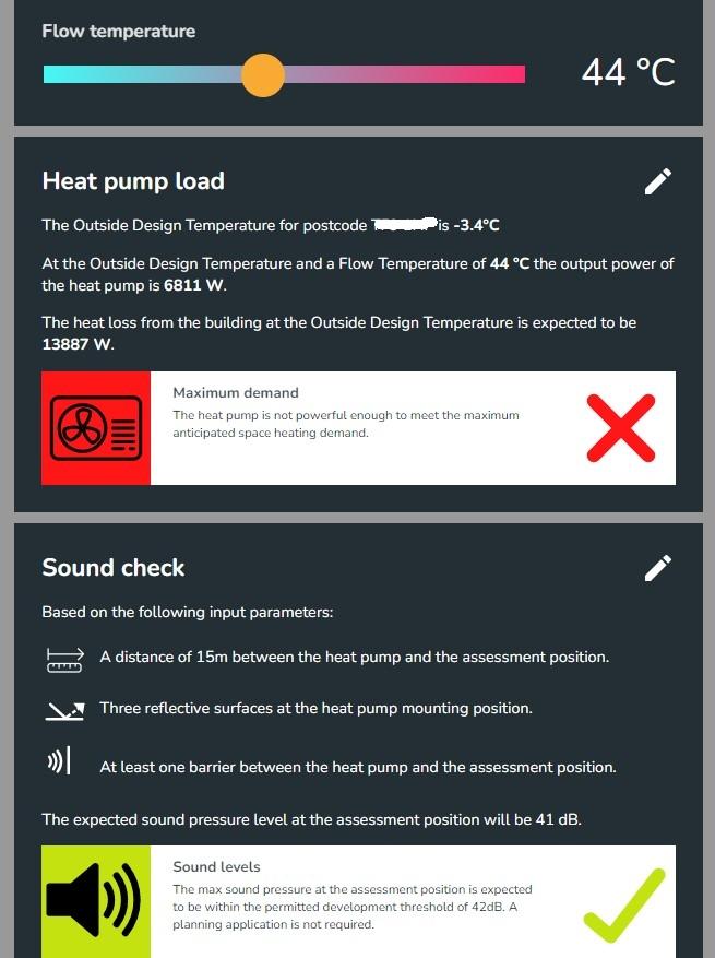

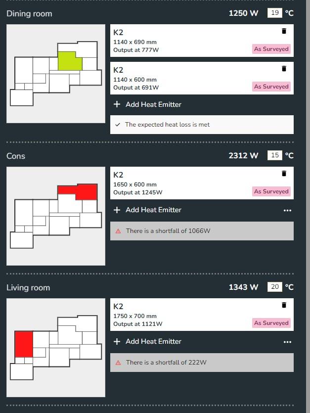

The best thing about the software is the result page. You can choose a heat pump and play around with the flow temperature. It will show if the heat pump has enough output or not.
And it tells you if the emitters can reach each rooms design temperature at the specified flow temperature.

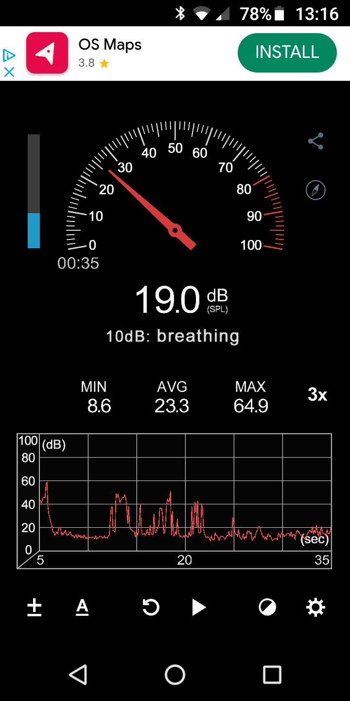

I held my phone at arms length, the peaks in the middle is me breathing.
